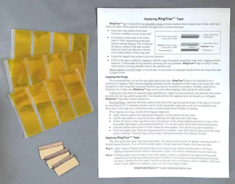

You’ll still have dissimilar metals, it will just be between your stainless rings and aluminum scope tube now. Regardless, the surface treatments should control the galvanic corrosion as several people have said.
Ring True Tape
