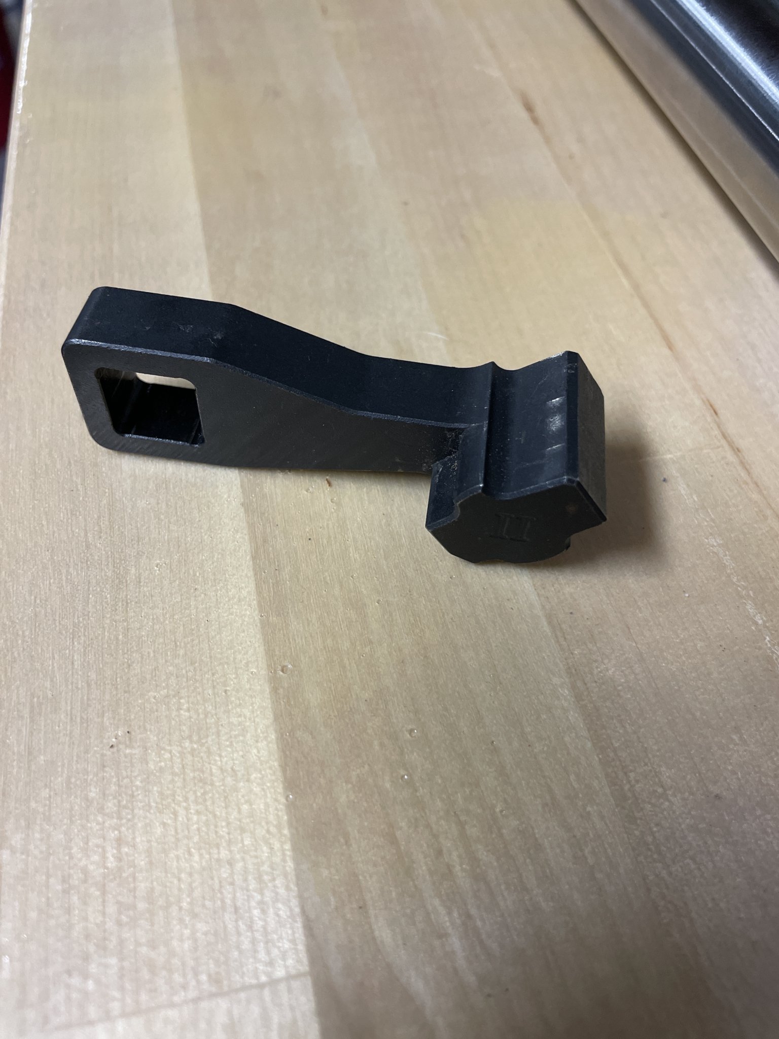

    I recently acquired a 308 barrel (Yes, the caliber of the gods.)
    It’s for a Surgeon action.
    I have the Surgeon action wrench, but it seems the action wrench is only intended for the installation of a barrel. Not removal.
    Is this correct?
    I have never used a Surgeon action wrench, but if I understand it correctly, it goes in the bolt (lugs) raceway between the action's locking lugs and can be used for either removal or installation.
    I have a bunch of Rem 700 pattern wrenches and that's how they work. They are different from the Surgeon, but I think they all work the same way.
