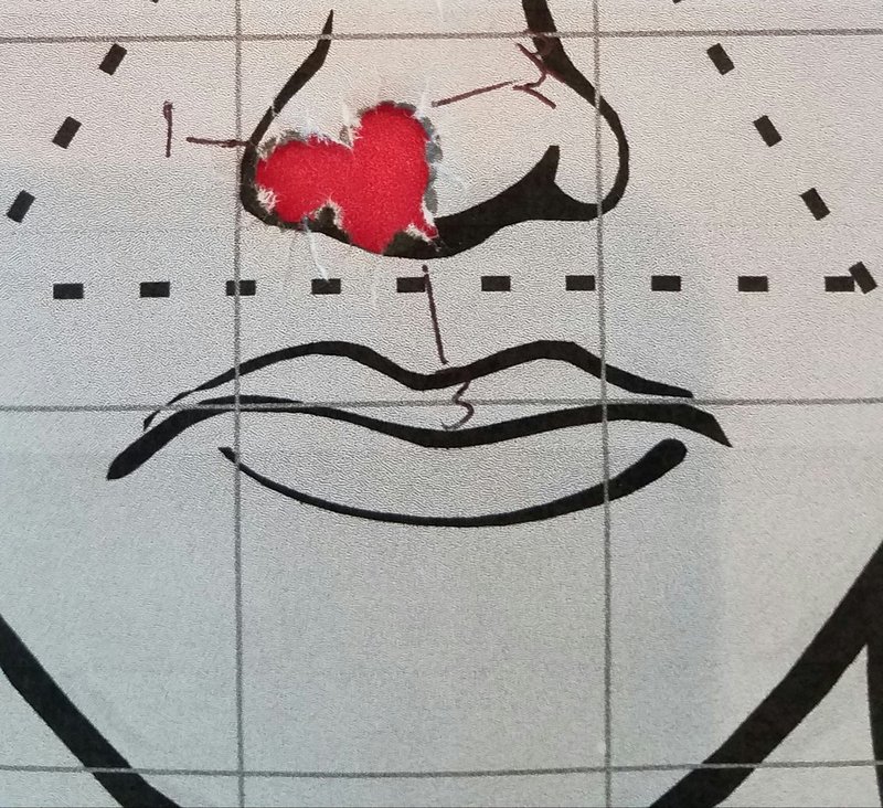

Went to the range today and shot this 3 shot group. The grey square is 1 square inch. I measured this group to be 0.489" in largest dimension and then subtracting 0.308" for the caliber of my bullet gets me 0.181" grouping. Is this correct? This doesn't look that tight to me.
If you put a quarter (for reference) then hopefully someone with Ontarget software will measure it for you. For me looking at it I am going to question the .489.
Still the group is well under .25 and if you can replicate those results with five shot groups then you have a very nice rifle, and you are using it very well.

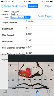

A quick calculation in Ballistic AE says 0.263". Try measuring with calipers from the gray edge of the holes as opposed to just the missing paper.

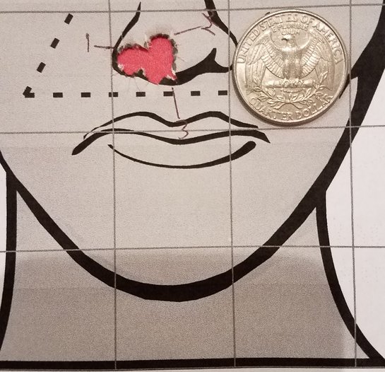

Thanks for the responses. Here is a photo with a quarter for scale if anyone has Ontarget. I will check out the range buddy app too!
This is from my first time shooting from a bench unsupported in a seated position so I'm pretty happy with the result.
Edit: Rifle is a Ruger Precision Rifle Gen II in .308 with a Vortex Viper 6-24x50 scope. This is only my third time shooting it and I couldn't be happier with it.
