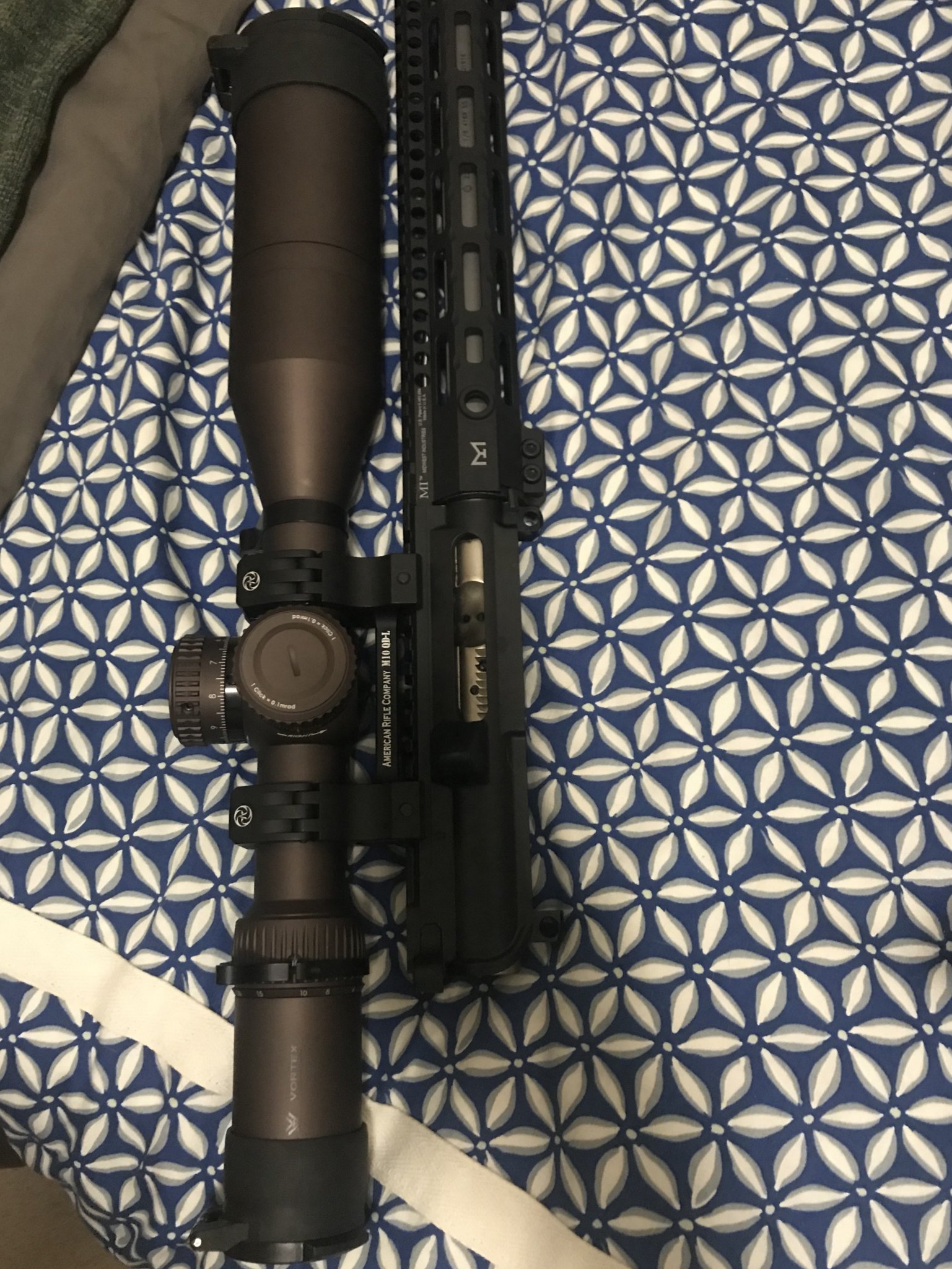

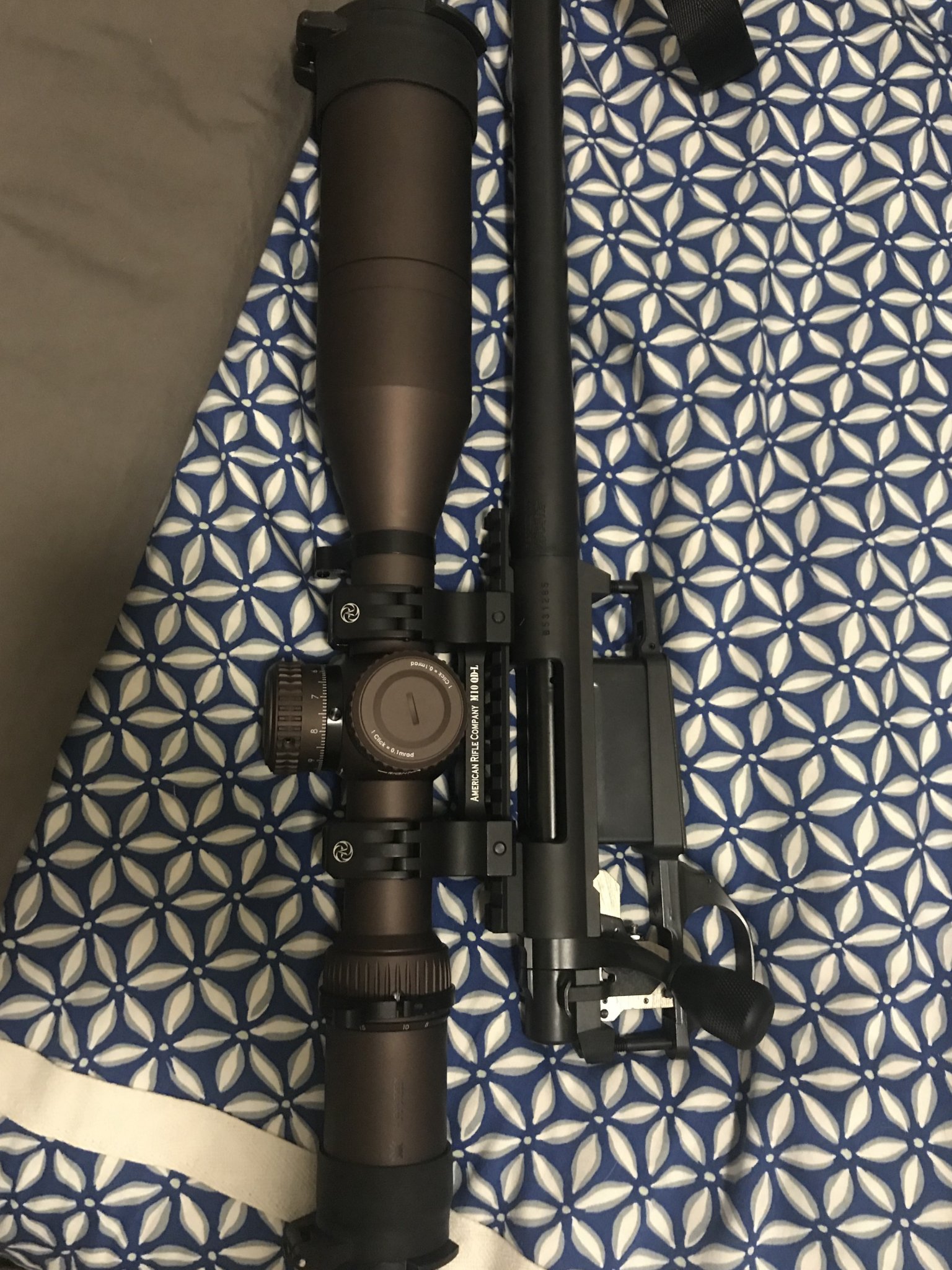

Im just getting into PRS shooting. I have a vortex razer gen 2, 4.5x27x56 on order. Im looking at a spuhr mount for it. I currently have a tikka ctr in 6.5cm with a 20 moa base. The SP-4001 1.18" high rings will fit perfectly. I was thinking that I want this scope and rings to last and potentially go on another gun that I get. Is it worth considering a 1.35" or 1.5" high Spuhr mount so I can run it on a gun with AI rails or even a ar10? Or will It just look goofy? Does anyone have any suggestions?
I swap a Razor G2 between multiple rifles, including a two bolts and a couple AR uppers, via a high QD mount. The high mount is needed in order to get it to fit on everything, but it works just fine for me (adjustable cheek pieces on everything helps or course, but you probably already have those). Can't afford to put $1,600 glass on every rifle at the same time but I can afford $1,600 glass on one rifle at a time with a great QD mount to swap between them 🙂

ARC M10 High (AR height) mount gives a little over a quarter inch clearance on a standard AR rail with a 56mm objective with caps:
And a little over 5/8ths inch clearance on a 25MOA Burris rail on a Howa with factory heavy barrel for the same scope:
The M10 rings in Xtra-Hi are like a tenth of an inch shorter if I recall.
I just use (or will use in the case of the Howa build) an adjustable cheek piece and it's no issue.
That really doesnt look that bad!
It really isn't. The mount is supposed to be good to 1 MOA (and damn if it doesn't feel like it) between swaps, so as long as my windage is within a few clicks between these three rails/uppers all I have to do is keep a dope card on my drops between 6.5CM, 6.5G, 6ARC and .223W and I'm good to save about $5k in scopes.
