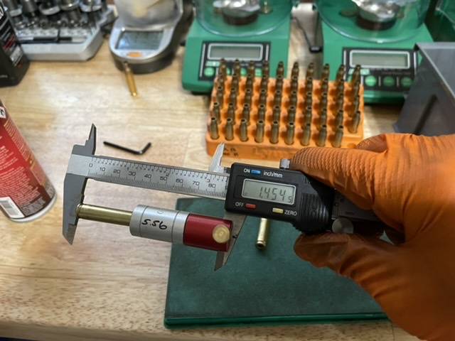

I measured 5 random cases from the lot with my Hornady head spacing gauge for the caliper(used the proper attachment c375). They measured anywhere from 1.557 1/2 to 1.559. I measured the same 5 cases after full length resizing and they came out at 1.562. I think stuck them in a Lyman ammo/headspace tool and the head of the case sticks out just over the maximum.

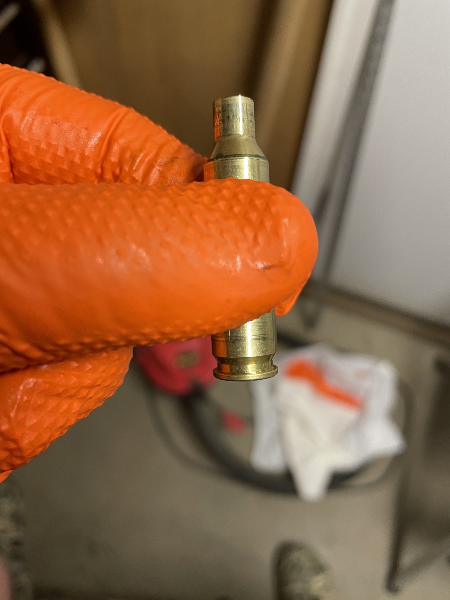

I noticed after running them through the die that I was getting a ring on the bottom of the case, close to the head. I’ve attached a picture below.

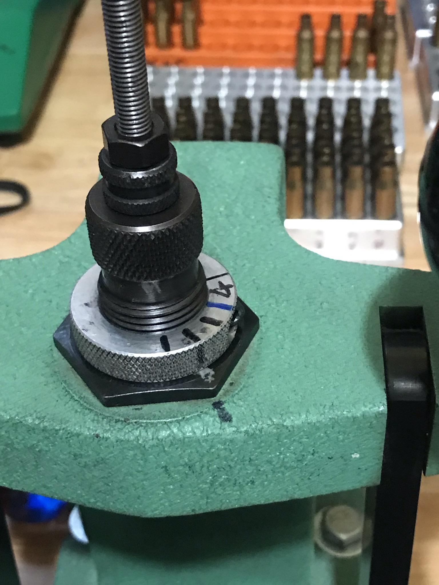

seems like your not bumping the shoulder yet so as said id slowly work the die down until your bumping shoulder back .002" from fired. Die will not always touch the shell holder.
Reactions: ShtrRdy
How do you know you’re bumping the shoulder back?
I ended up having to screw the die in about 5/8 more of a turn, going in 1/8 turn at a time. I grabbed the rifle that they are for and kept turning the die 1/8 a time until the case chambered nicely and not hard.
you'll know when your shoulder measurement is .002" less than your fired case. Once you start going down on the die you will notice that right at the bottom of the stroke you'll feel a little more resistance and that's when your contacting the shoulder.
Im not familiar with the hornady comparator as I use Sinclair ones but you have the one that indexes on the shoulder correct?
Reactions: Baron23
Use the Hornady headspace tool like so
Once you have the die set such that its bumping the shoulder to the extent required, index the die body, lock ring and press to ensure it goes back in the same position each time
Yes I do believe so. These are the ones I have. That look correct to you?

Not that it matters a whole lot but, the closest gage to measure the headspace would be the D400. It will probably give you 8 or 10 thou lower headspace reading than SAAMI specs.
The line at the bottom of the case is good. You want to see that. Depending on the chamber to FLD dimension differences, don't assume that resistance felt when closing the bolt is always the shoulder of the case. With factory chambered barrels, it is more often than not the web that gives the feeling of resistance if the headspace measurement comparison is 2 or 3 thou less than your fired cases. So, if your chamber is on the short end of SAAMI spec, off the shelf FLS dies will be hard pressed to size the web enough because you can't get the case deep enough into the die while still obtaining minimum shoulder bump (-0.002 to -0.003) Don't be surprised if you feel a little resistance on some cases even when the headspace comparator is telling you the base to case datum is less than the unisized cases because it can be the web that is just a bees dick larger OD.
Once you're sure the base do datum is where it needs to be, you have 2 choices if the web is rubbing.
1) Run the cases deeper into the die to size the web down a little more which, as a result will increase the headspace. (reduce base to datum)
2) If the resistance at the web is minimal & no obvious bolt click, load em & shoot.
Comparator reading is more accurate than how it feels closing the bolt.

Also one other question, why do you say the d400 will give the closest reading? Just curious as Hornady says the c375.

Hornady lists .375 as the proper insert. The actuall datum line on a 6.5 Creedmoor per the specification is .400, and most people use the .400 insert. Truth is, it doesn't matter one bit.

Regards the Hornady comparator, I use the 400 but, as Supersubes said, it really doesn't matter cause it only compares.
