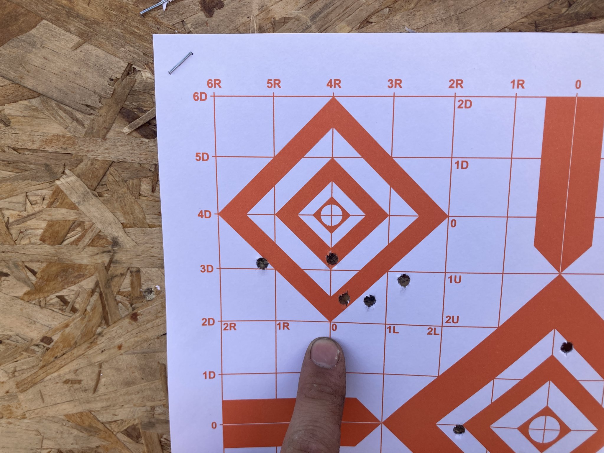

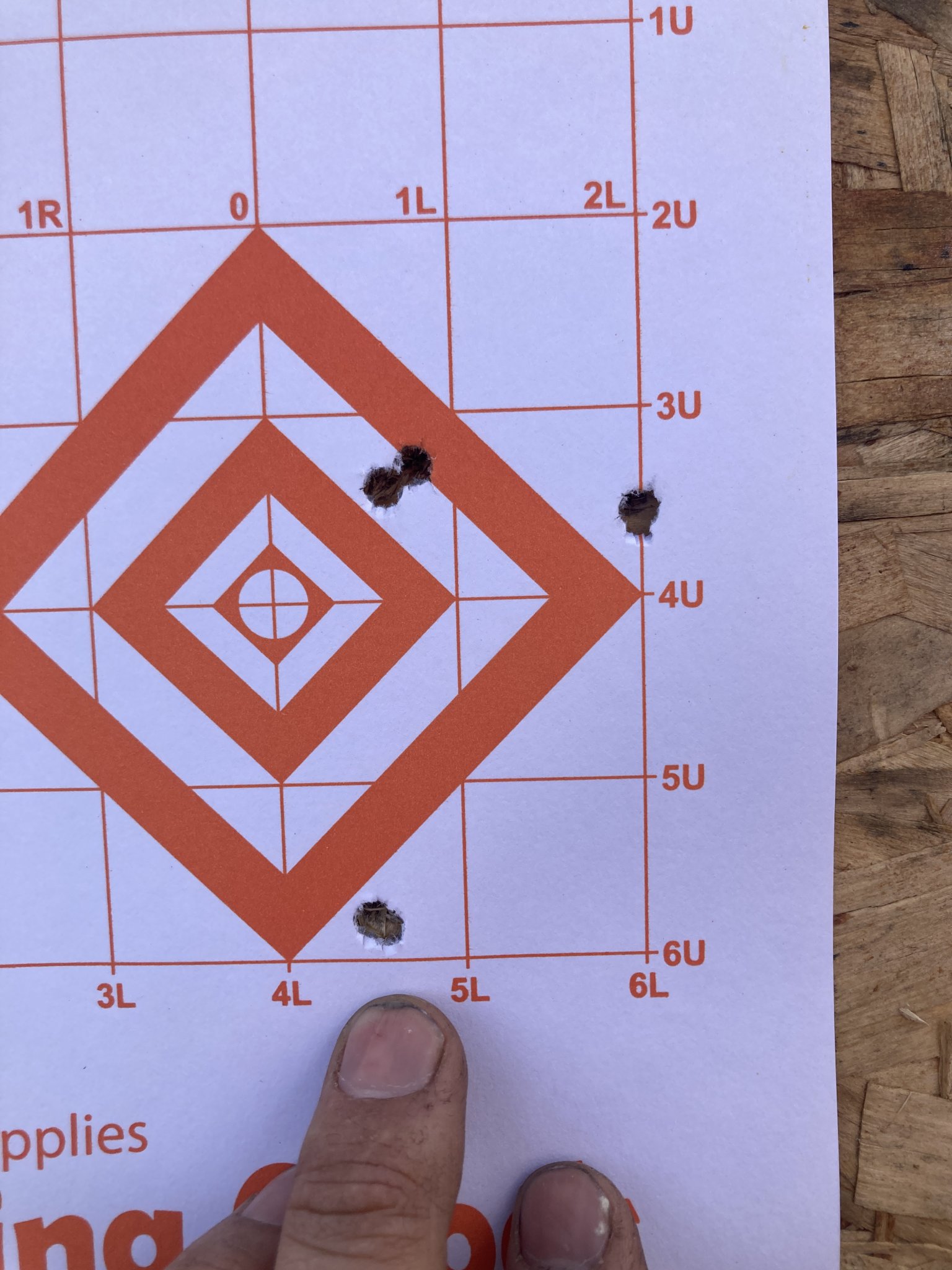

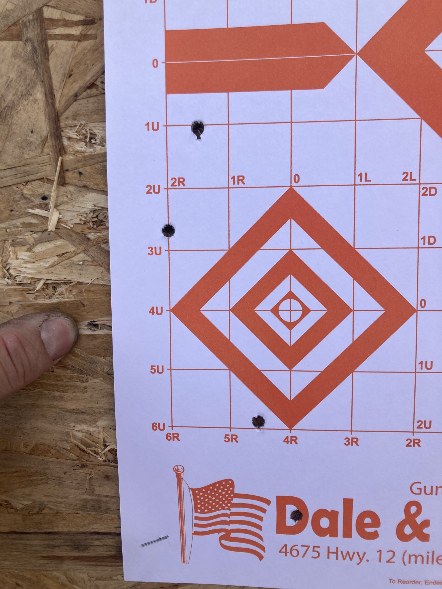

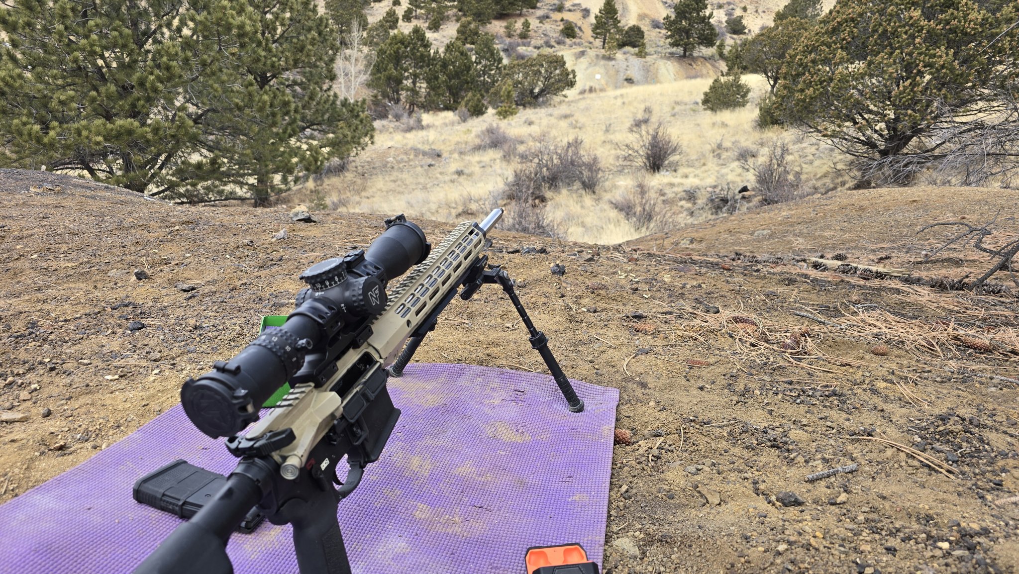

I'm having some real struggles with shooting groups. I'm slowly realizing that I just might be trash at shooting.

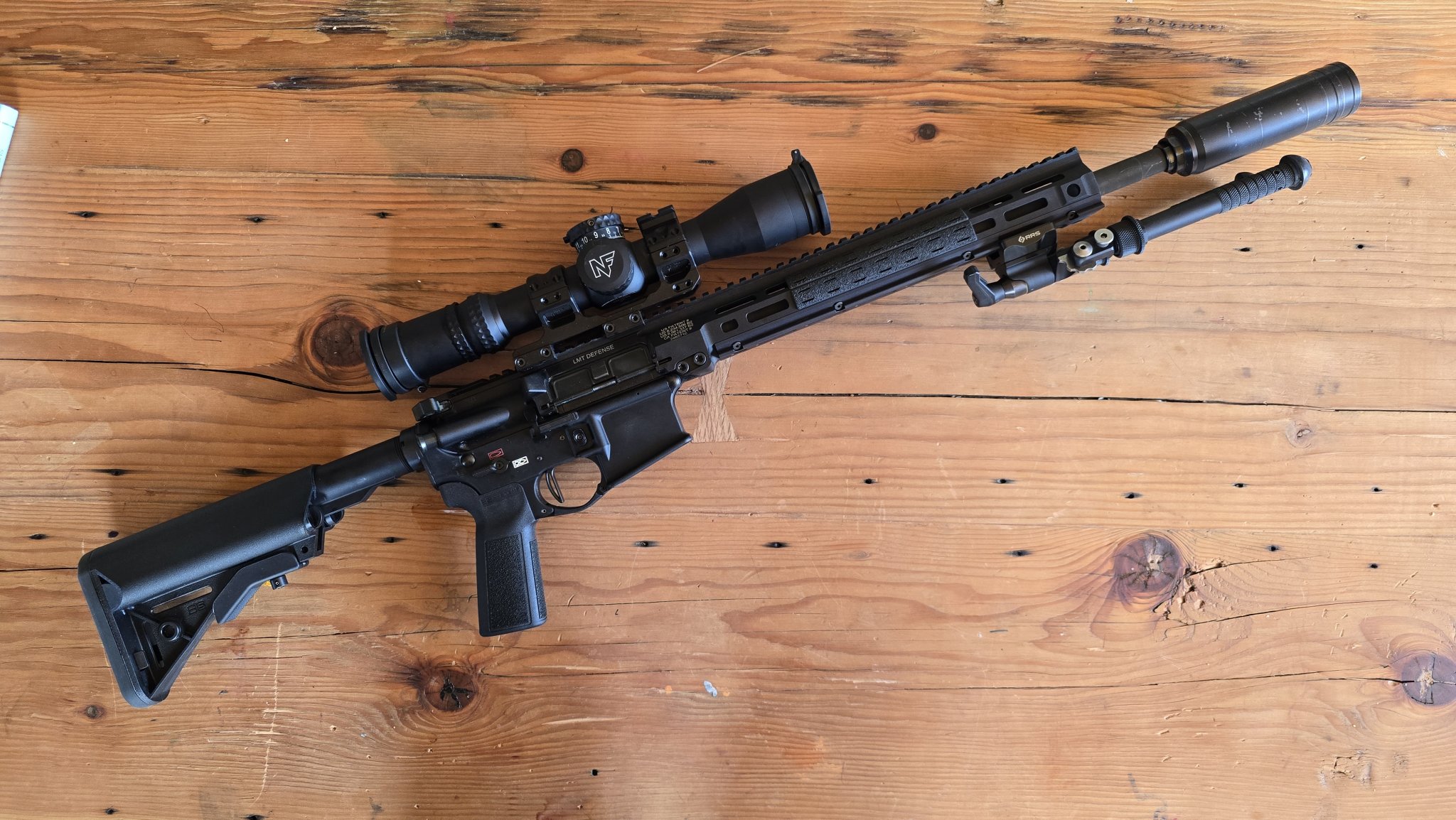

This is my first attempt at building and shooting a precision small frame AR. The plan was to get a barrel in and test it before sending it off to D.wilson to have it converted for the LMT MRP.
This is where it went sideways. The barrel shoots like crap. My first outing I had shot the 75gr RMRs in to a laughable 6" group (didn't measure). The 69gr SMK and N140 shot a lot better but still big.
The second outing wasn't much better. I was testing a different load and was removing muzzle devices changing bolts etc.
The groups had a totally different shape with a lot of horizontal stringing.

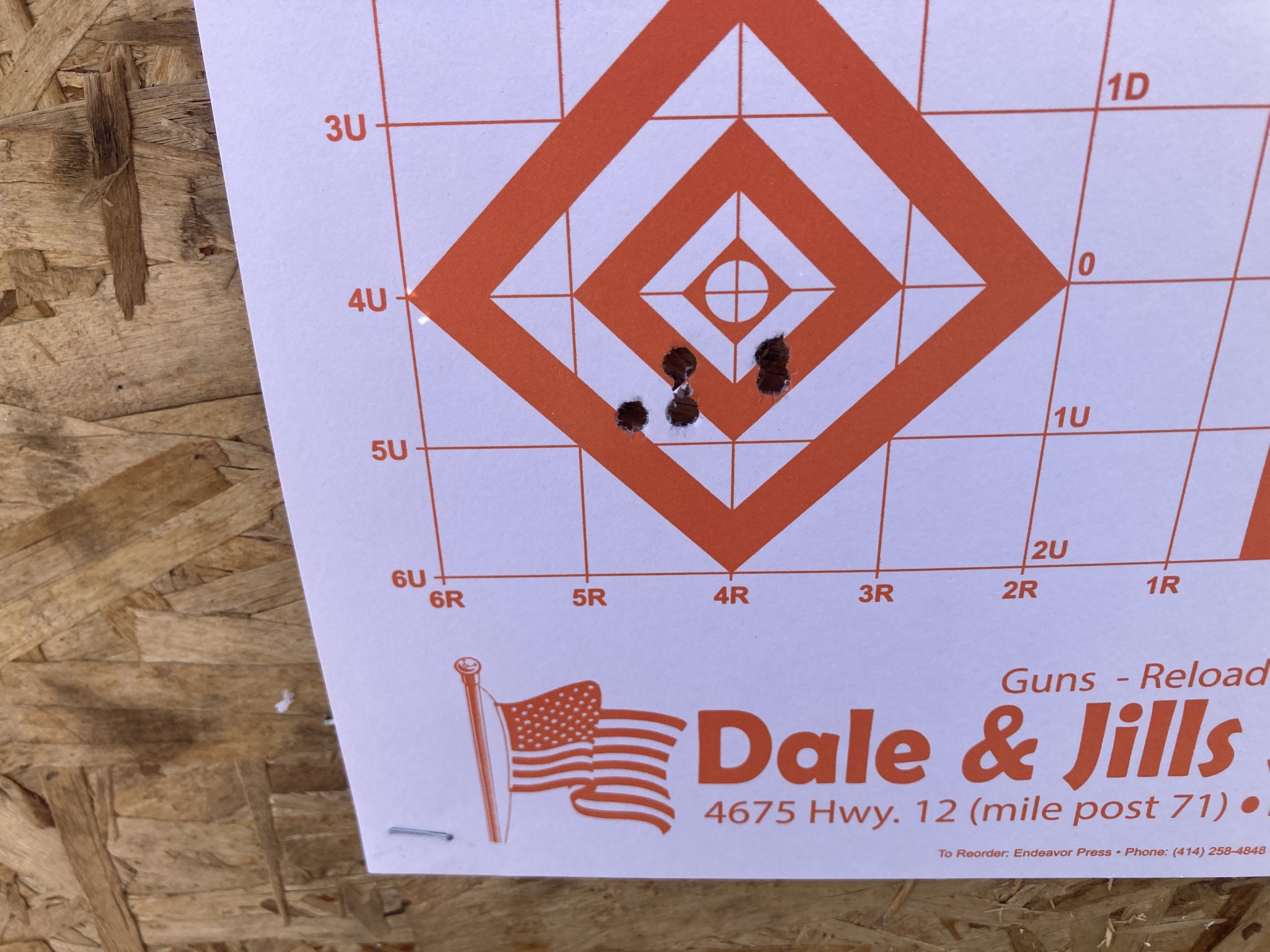

After getting off the rifle, I shot Black #2. I noticed a POI shift and figured I'd change my bags out (ended up stacking a fortune cookie on my Wiebad rear bag (I don't like that bag, but it fit under the B5 sopmod stock)
Do I just need to get a different stock? New rear bag? Is this barrel trash? Am I trash?

It's a WOA 18" SPR 1-8" rifle length.

On the second picture are those stickies 1" or what? No reference to size. If they are 1" then your results could be a combo of fundamental problems, as in cheekweld, follow-thru, NPA, trigger control, don't reset trigger 'till you have impact. Is that a 4-16x42 ATACR? What mag are you trying to shoot groups with? What's with the bipod stretched out so tall? I'd have to be on my hands and knees to have a bipod that tall.

The stickers are just under 1".
It is a 4-16 ATACR @16x. I don't have any issues seeing the target and felt good about POA throughout. The mount is a 1.54" and I generally have more contact with the stock, so cheekweld could be an issue but I'd assume parallax adjustment would solve that (?).

Your first pic shows predominantly vertical errors in the group. That is breathing control and poor check weld.
Your second pic shows more horizontal error which is trigger control and body/target index error(not straight behind the rifle).
As mentioned above, the bipod is a too high and collapsible stocks are a bit loose and these will just plain open a group up.
So, add a check riser and some tape to make the stock tighter and fit you or get that PRS you mentioned. (I prefer the UBR, a little less stable but it adapts to more different positions). Get yourself straight behind the rifle. Frank has an old video here somewhere that he demonstrates this using a pencil analogy. Imagine two pencils inline lying on a desk and you have to push the second one forward by only holding the first. If they are not inline the second slides at a tangent, like the bullets. Also, draw that trigger straight back and follow through (hold it.) Semi auto exploits poor NPOA (natural point of aim) more as the internal ballistics take more time.

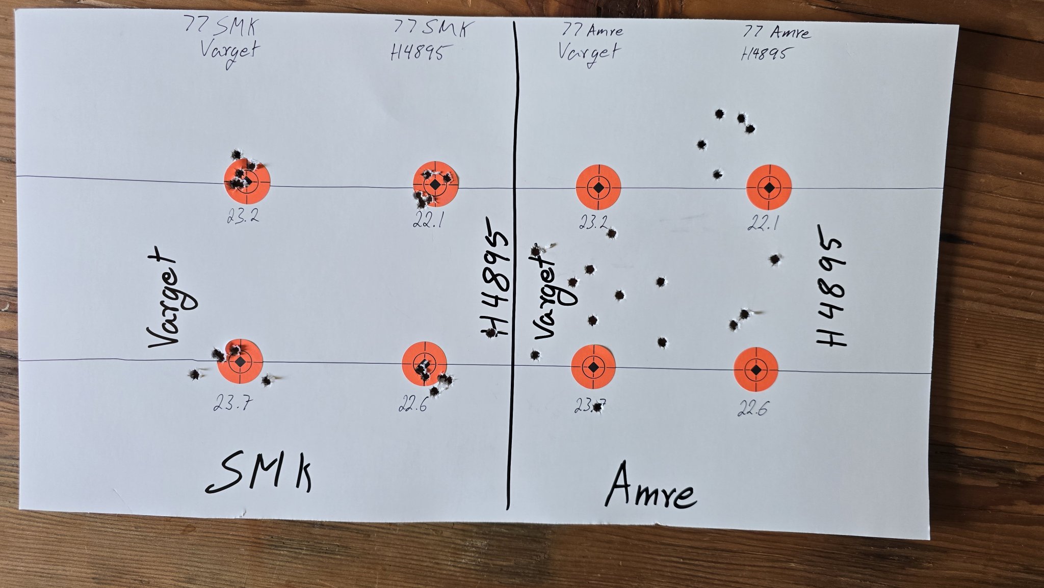

Update.
Thanks for all the comments and suggestions. I made two changes.
First, I changed the B5 bravo out for the Magpul DT PR. I felt much more stable and the gun had a predictable recoil impulse straight back.
Second, I tried a couple more types of bullets. This is really where the issue was. This barrel is laughably picky but it likes 77gr SMKs so that's ok.
My calipers batteries are dead so I'll have to run to town and get some more but it looks to be shooting 1/2-3/4" (5/8" with a tape).
The 77gr American reloading blems were impressively bad but they don't seem to be AR bullets at all. And yes, that's 4x 5 shot groups...

Update.
First, I changed the B5 bravo out for the Magpul DT PR. I felt much more stable and the gun had a predictable recoil impulse straight back. View attachment 8646693
This also gave me the opportunity to video myself from various angles. I'm happy with my fundamentals.
Again, thanks for all the responses.
