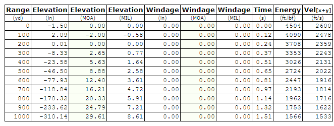

Trying to understand the world of long range to expand my horizons. One thing I'm not sure I understand is how to be able to tell when you need a tapered mount. For example, according to this chart this projectile would drop 8.61 mils at 1,000 yards.
Assumption #1: a mechanically zeroed scope's POA would not match the POI at that range, but if you dialed the scope by X clicks to adjust by 8.61 mils, then the center point would then be aiming directly at the POI at 1,000 yards.
So if a scope advertises, say, 30 mils elevation adjustment meaning you could adjust by 15 mils downward, is that scope then capable of zeroing at 1,000 yards on a 0moa mount as 8.61 mils is within that 15 mil adjustment range?
Assumption #2: If a scope's internal adjustment range matches or exceeds the predicted drop of a projectile (such as the projectile that drops 8.61mils used with a scope with 15mils adjustment) you are perfectly fine with a zero taper mount. But if a round dropped (exaggerated) 30mils, and your scope only adjusted 10mils downward, you would then need a 20mil taper mount before the POA and POI would match?
I don't know if I'm explaining this question properly, but a lot of noob articles I've seen blankly state you "need a 20moa mount before you think about 1,000 yards" but then either omit info about the scope entirely or plug in an amazon link to a $100 scope.

The example I'm using is based off 338 lapua with a nightforce 7-35x. If I wasn't going to dial in every shot, and wasn't going to shoot at a variety of ranges using a reticle with mil marks instead of a plain ol' crosshair, would adjusting that full 8.61mils even be necessary if one were to use the reticle to its potential? For example, only adjusting the scope 2.5 mils down to be zeroed at 500 yards but know the POI at 1,000 is X number of hash marks down from the center of the crosshair- would a taper mount be even less necessary then?
I guess a better version of my question is what specific numbers do you look for when you're shopping around for optics and calibers where you "know" if you need a taper mount or not

Assuming that the zeroed scope at 100 yards is near its central adjustment on a 0 moa mount, then to get to 1,000 yards you would dial in the necessary elevation, in your example 8.6mils. On a scope with 30mils total internal travel, that would cause the reticle to now be 15 + 8.6 = 23.6mils. You would therefore have 6.4-ish mils of elevation remaining. That is, the front of the erector tube would be only 64 clicks from the bottom of the scope tube.
Were you to desire to zero at 1,000 yards, this would be its permanent position. Therefore to zero at 1,000 yards seems easily feasible in your example with a 0 moa mount.
I assume you understand that at ranges closer than that - should the need arise - being zeroed at 1,000 yards would require you to hold ABOVE the crosshair, NOT BELOW. The bullet would be leaving the barrel on a trajectory so far above the line of sight (PoA) that at 100 yards it would be almost 9 MILS above Point of Aim, which works out to 1000h=Dm: rearranging (100*9)/1000 = 0.9 yards or 32 inches or 2 feet 8 inches ABOVE point of aim at 100 yards!!
So in order to hit at 100 yards (in whatever scenario that might be) would require you to hold the crosshair UNDER the target by 9 mils.

Zeroing at 500 yards might be a better choice because then you can use the reticle UNDER the crosshair to hold for extra elevation to get you to 1,000 without having to hold off in space somewhere in the top of the reticle for any closer shots. And this would also be usable with a 0 moa incline: 15mil + 2.5mil = 17.5mil, which is close to the optical center of the lens set, which would minimize any optical aberrations from the periphery. A 500 yard zero is a better choice, and with the Nightforce reticles you'd only need that 2.5-ish mils ABOVE the crosshair for closer shots, which the reticles DO have. Plus, it would lessen the many confounding factors.

I'm' surprised no one has noticed the chart above assumes a 200 yard zero. More adjustment is already eaten up before dialing to 1K. Given that most scopes are already into the drop, it'll never make it. It's more than likely too far off center to begin with.
