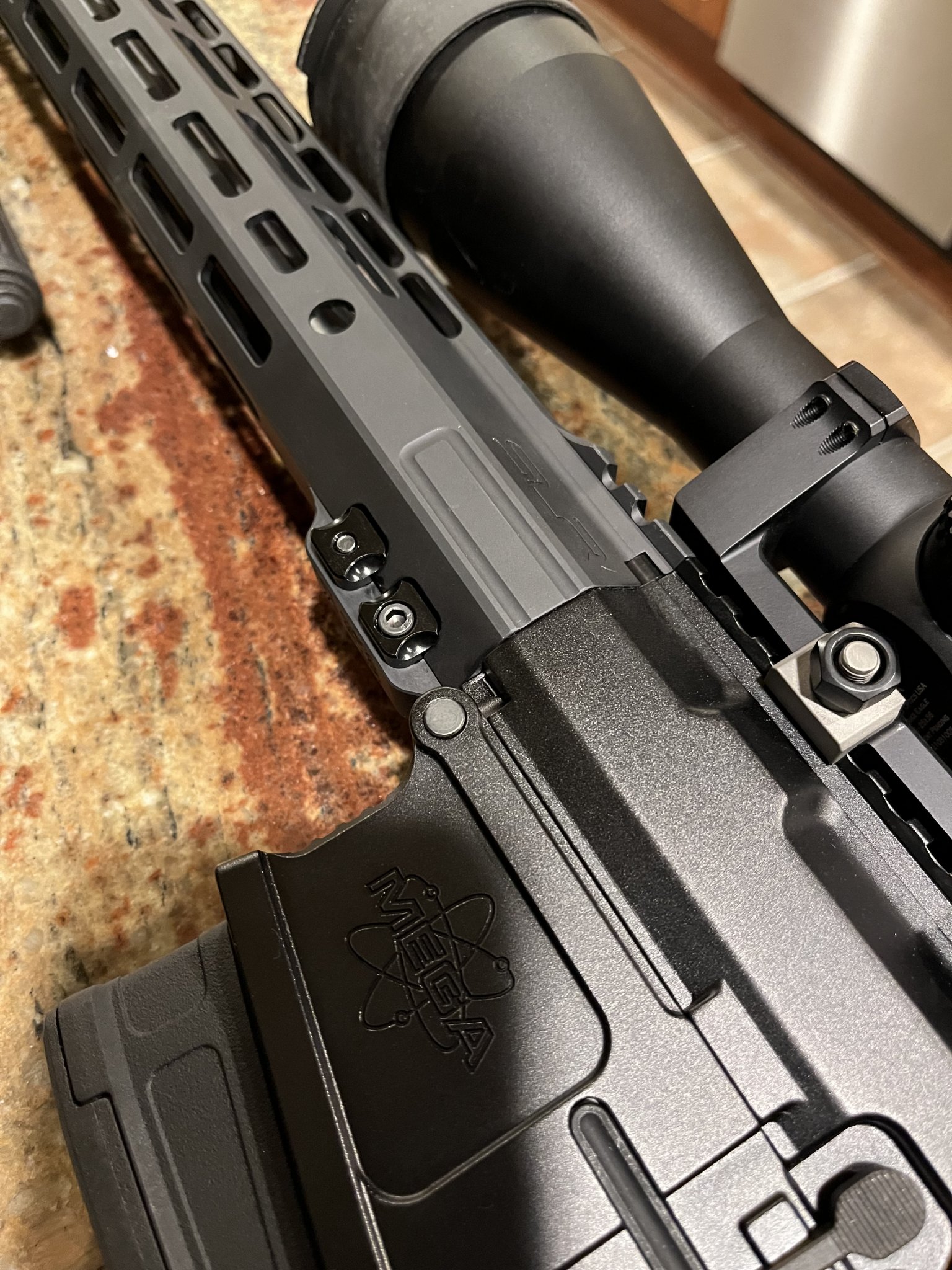

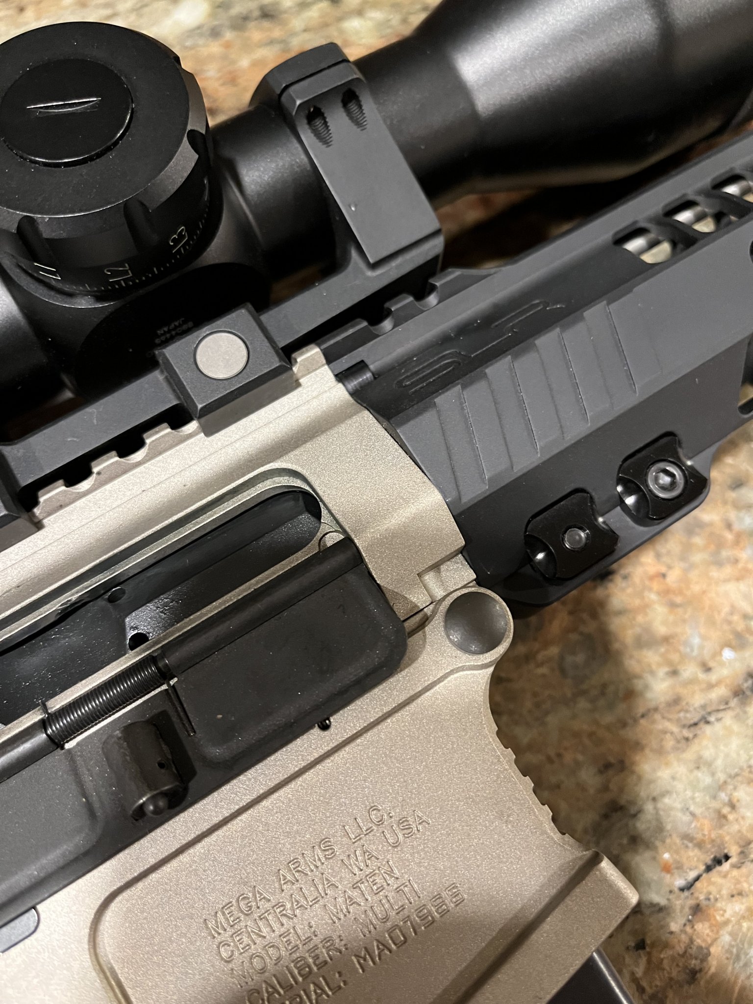

I'm up to speed on the high profile and the pic rail. I'm wondering about the Maten hex shaped receiver and don't want a handguard that does not fit that shape where they come together. The Maten handguard fits perfect of course and I hate to lose out on that if I go with another brand. You said the SLR fits good. Do you mind posting a pic of that combo? Side view closeup where the handguard and receiver come together?
