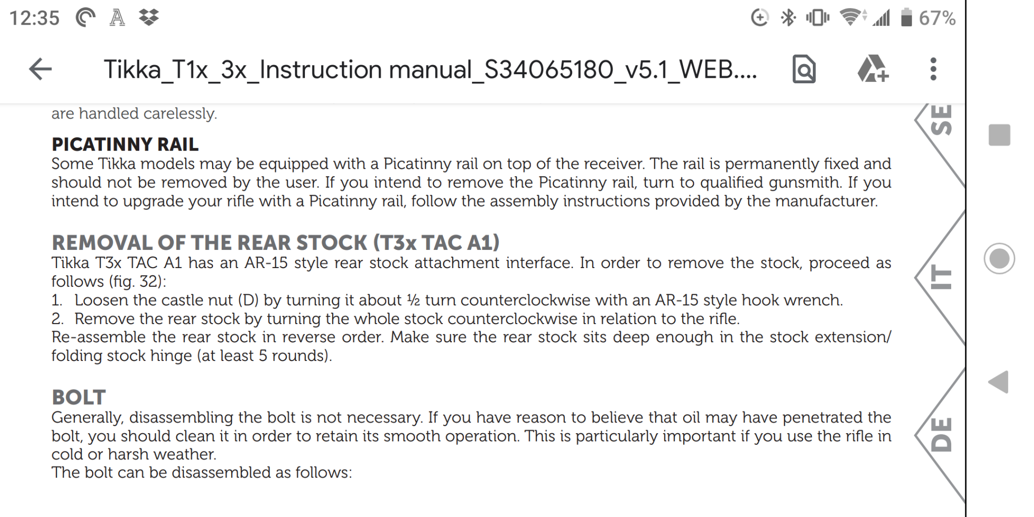

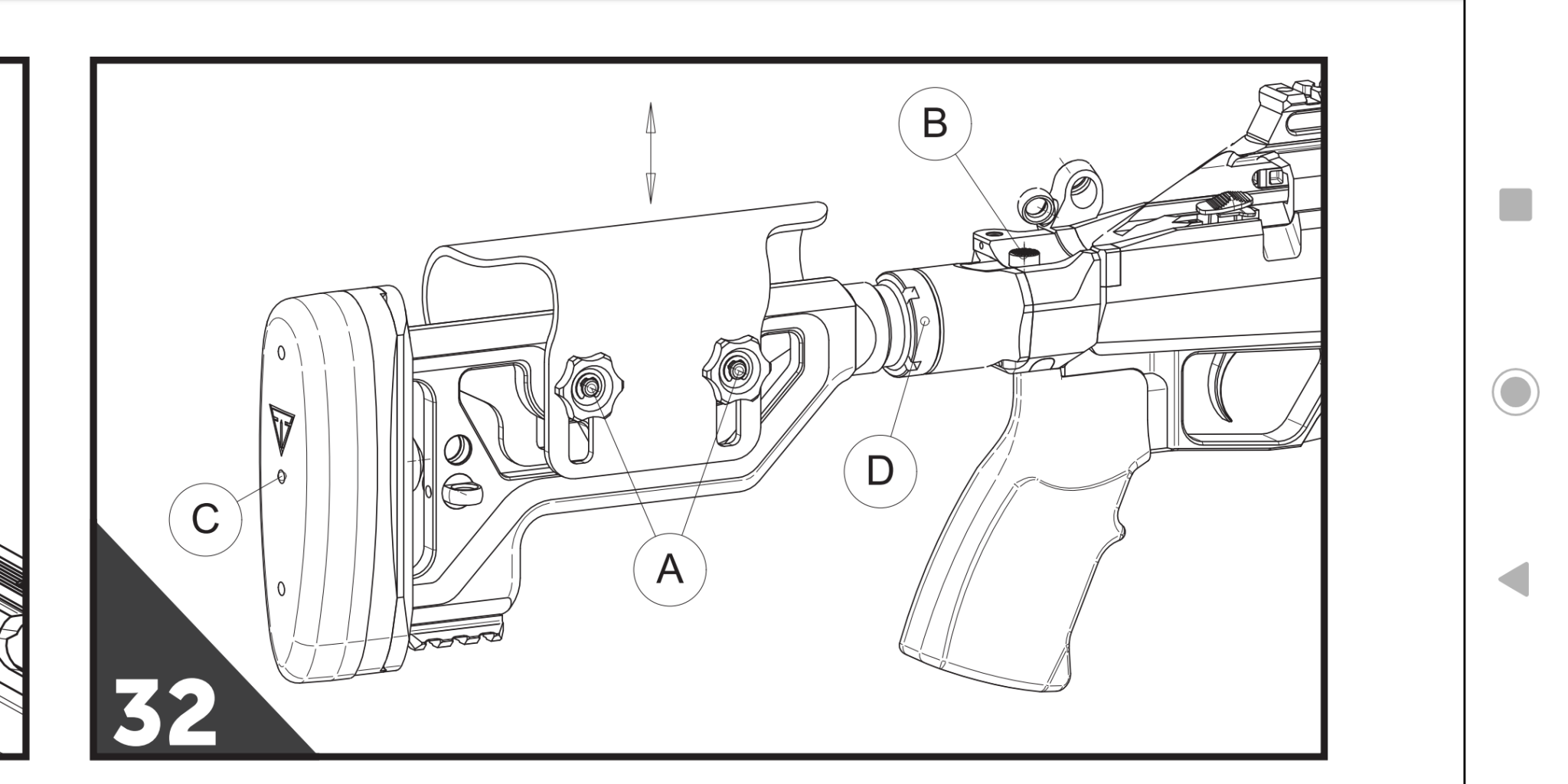

Got it. So what wasn't working? Removing the stock is explained in the manual.
