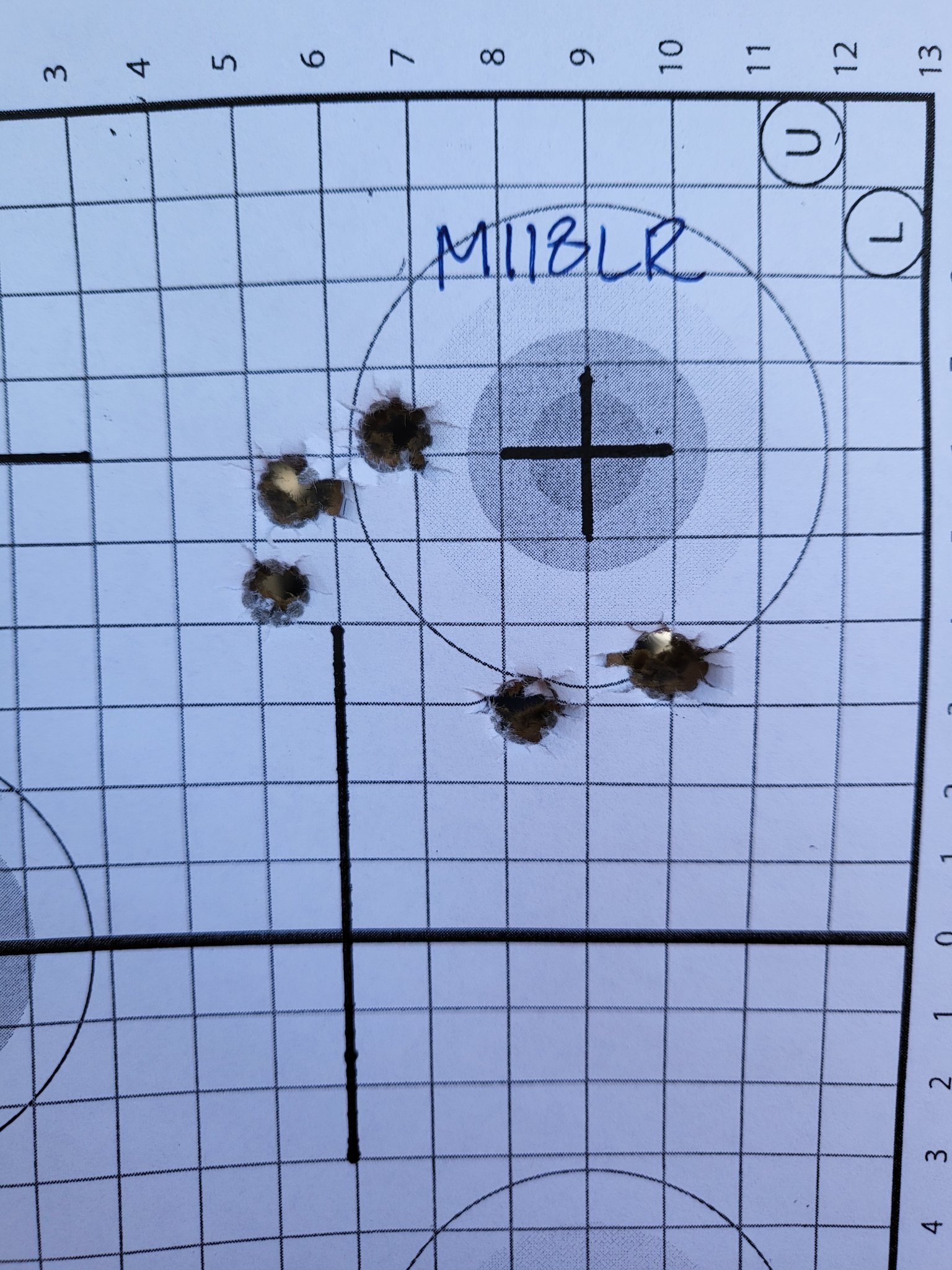

I just tried some of the AG M118LR and it was just meh for me. Rifle is a Desert Tech SRS with a 22.5" barrel and Silencer Tech suppressor. Avg MV was 2614, but only for five shots. ES of 26 and SD of 11.6.
I didn't think of it until I started writing, but of the 5 shots, 3 were LC18 brass and 2 were LC19. I had an odd group, where 3 shots were grouped together about 0.3 left and about 0.1 low, and 2 shots grouped about 0.3 low. I'm wondering if the 3 LC18 grouped together to the left and the two LC19 grouped low. Accuracy was about 0.75" to 1", so nothing special, in my opinion, but for the price ($1.05 to $1.09 a round, depending on how many you buy), it's not bad to have on hand.
I'll separate by head stamp and see if I can confirm my suspicion that head stamp year sorting, as someone else mentioned above, will lead to better results.

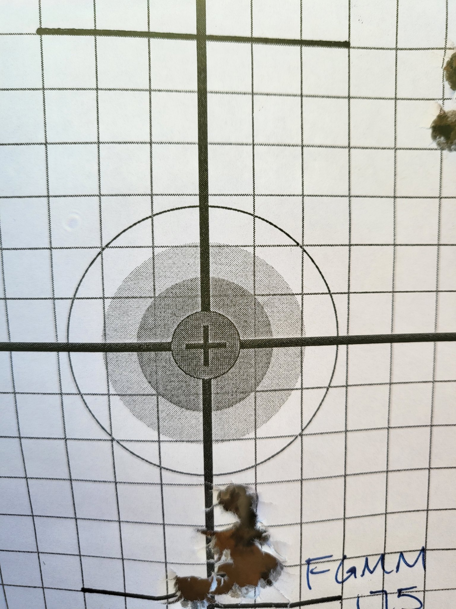

Update:
I sorted the rest of the rounds I brought with me by headstamp years and shot significantly better.
LC19 put together a decent group. Ignore that shot on the low left that was a part of some FGMM 175. Also, my scope was still zeroed for 6.5 Creedmoor
I was limited to 612 yards today, but it held about 1 MOA, maybe just a little under. It won't replace handloads, but after sorting by headstamp, it did seem to shoot quite a bit better, albeit with a limited sample size. I find the bang for the buck (pun intended) is pretty decent, so I'll buy more just to keep in hand for range days.
