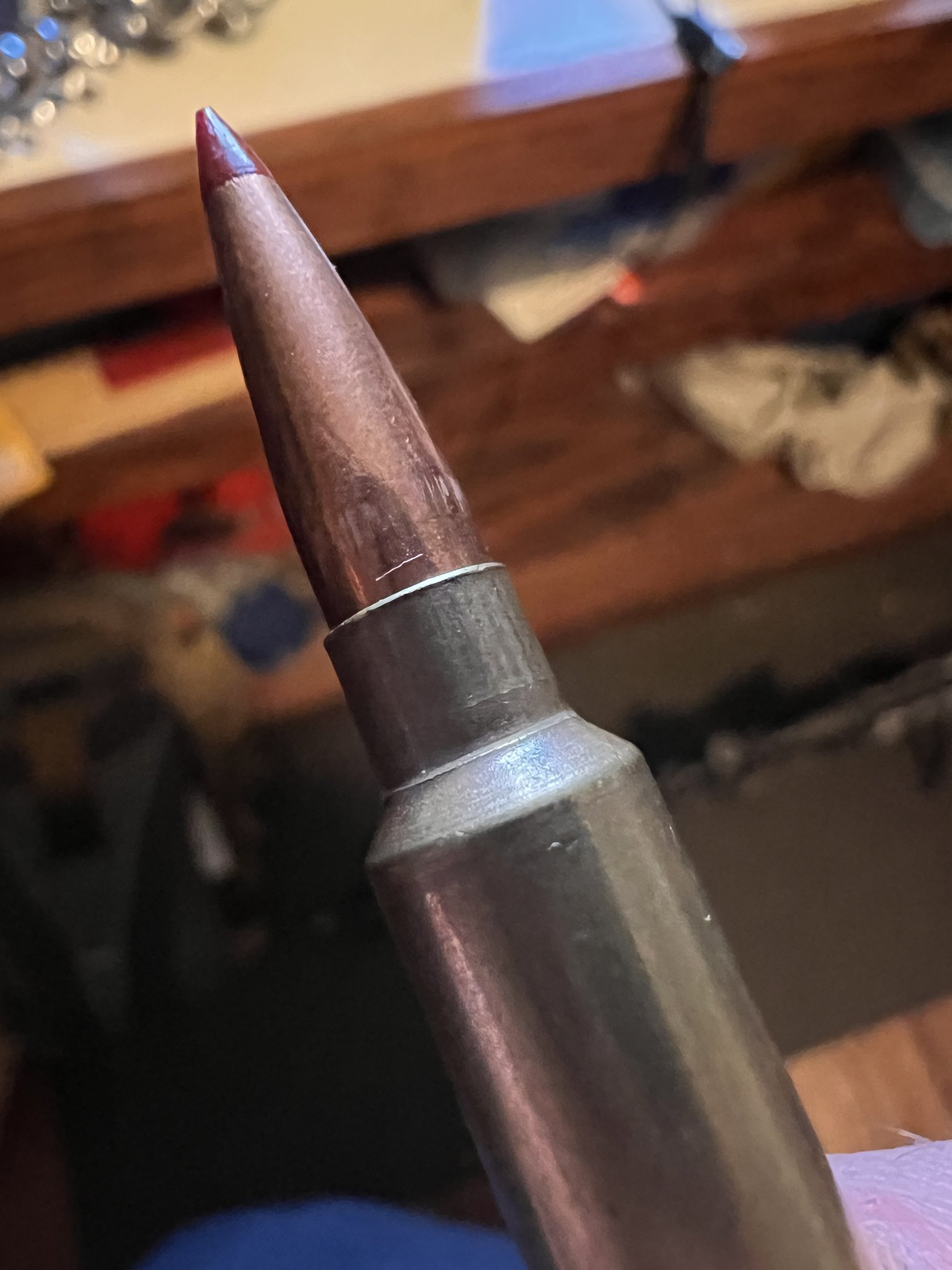

Took a video of how the AI feeds and where it catches.
As you can see in the video the round strips from the magazine and goes into the chamber easy. Then it hits a hard stop where I have to utilize more force to get it to go all the way in the chamber. After analyzing the bullet, I am seeing where it is hitting. Running the bolt fast you don't notice it BUT I would like it to feed smoother.

I'm using 700 action and if I run the bolt slow, it will hang almost every time, if I back off a bit and jam it in, it sometimes goes on in but damages the cartridge some. I can't tell that it has any detriment to the accuracy of the shot. But if I run the bolt fast, no issue and when I inspect the unfired cartridge, there aren't any dents or such.
