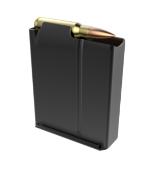

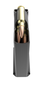

Anyone else stoked for the release of the ARC mags?
Here is the Pre-order: http://patriotvalleyarms.com/american-rifle-10-rd-magazines/
American Rifle Company MAG 10-ROUND MAGAZINE
Compact
Double stack (Comparable to AW magazine size)
Receivers do not require an AW cut for proper function
308 and similar cartridges
Center feed design for exceptionally smooth feeding and operation in all actions
Designed specifically for round body, Rem 700 style actions for double stack use
Made from high strength, stainless steel and coated for long life and lubricity
Long internal (2.97") length for the latest long range competition bullets
