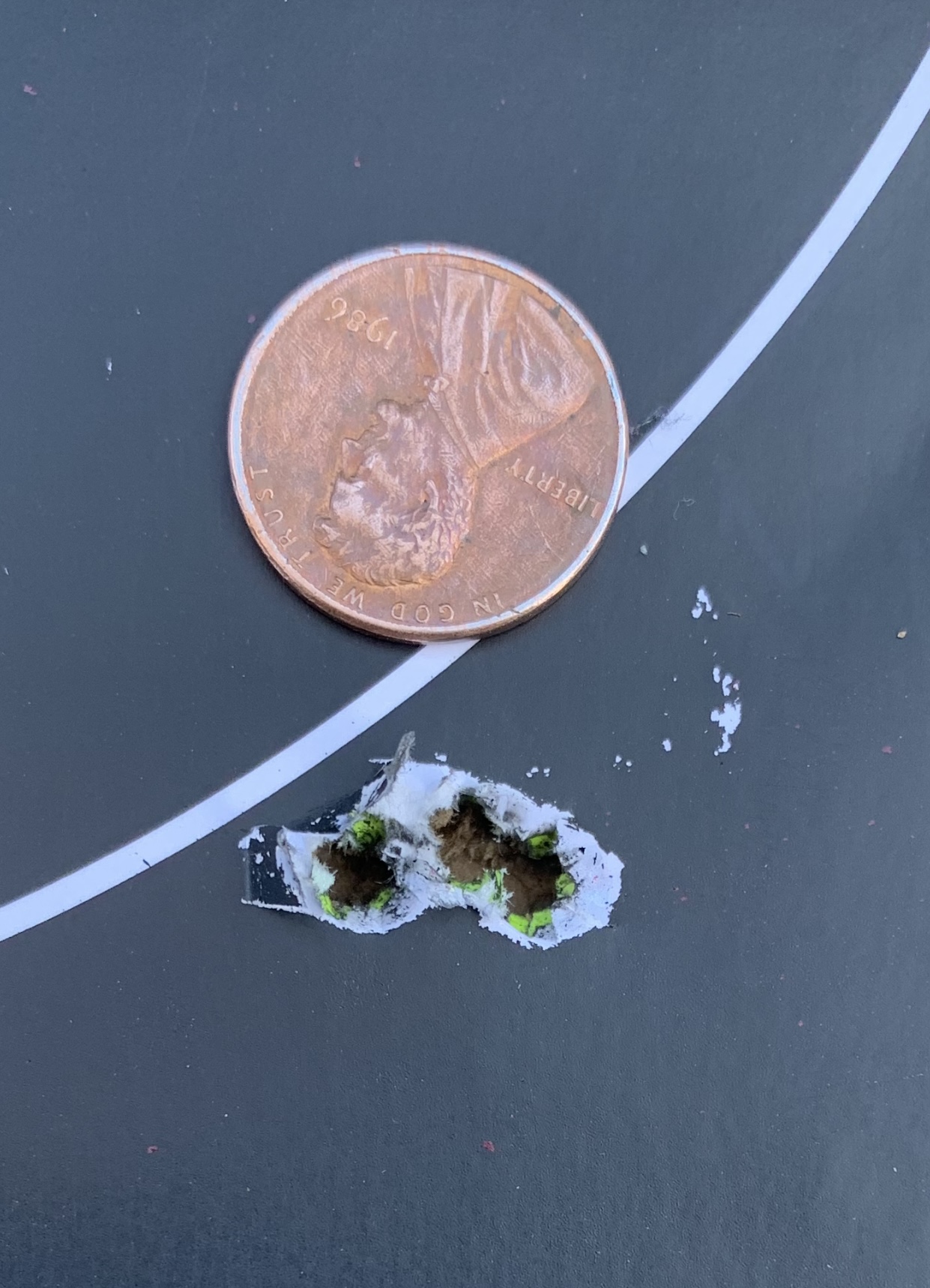

The ammo came in today and I shot sub moa with Hornady black 75 bthp after I took off the 7.62 suppressor. About 2 moa with it. My Psa 308 loves the suppressor but the ar15 doesn’t
The pmc 77 grain otm was real close to moa. It’s windy today.
At least I figured out the the barrel is ok.

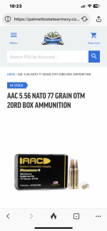

I would suggest you try some of the PSA / AAC 77gr ammo as well.

After today’s testing I found out that the barrel is ok. I was able to get several good sub moa groups but I am very confused as to how my 7.62 suppressor that works great on my 308 can open up the groups on the 223. It’s a rugged razor with the proprietary rugged muzzle adapter that you screw the can on that and then twist the locking ring. It works great on my 17hmr and my 308.

there is also the aac, but they are not consistent and the QC is not so good.
PSA has some great 77 grain hp on sale for 10.99 a box. Try ten boxes and get back to us.
That is more than likely barrel harmonics.
