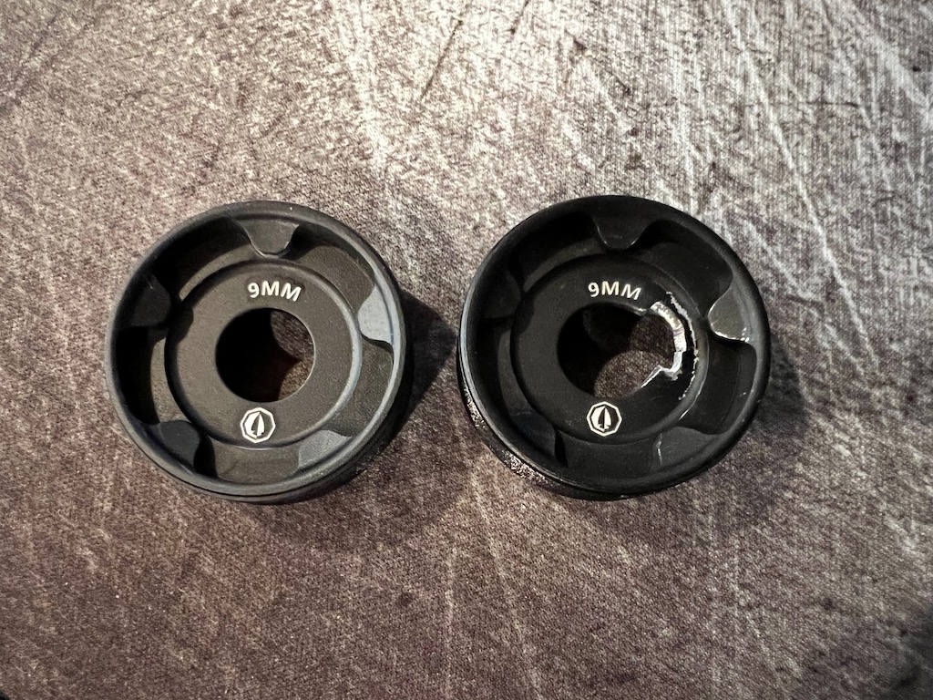

The bullets will work fine, but do yourself a huge favor and get the Cam Lok.

Man. I shot it over the weekend and suffered an end cap strike in my first 15 rounds through the silencer. Rugged sent me a new end cap. They advised to use teflon tape on the threads when securing the silencer on the host and to tighten it during use. I'll check out that cam lock thing you mentioned.
