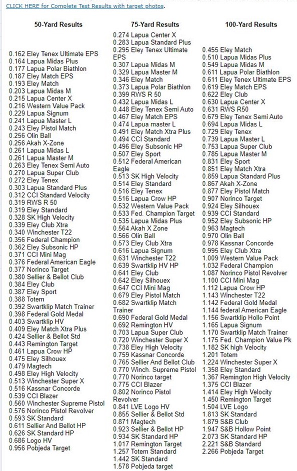

Here's some more that might help:
Reactions: 338dude

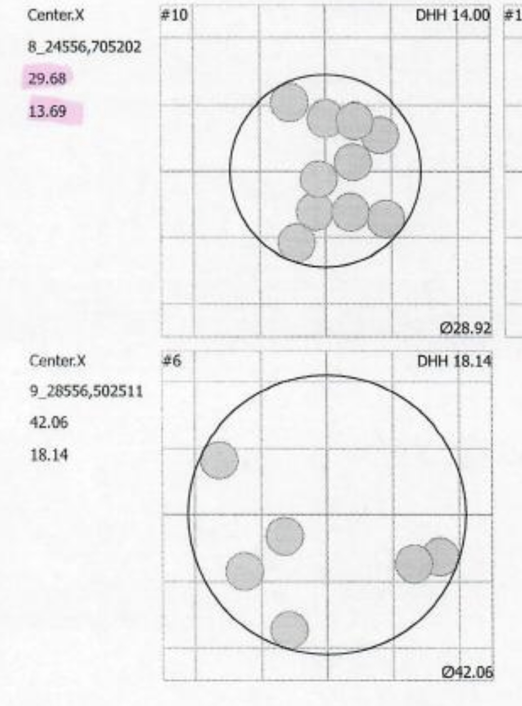

If you can afford to buy a case for around $1,250, the Lapua test center cannot be beaten. They will test various lots of center x and other ammo if you choose. The report out is super clear on who the winners are at 50m and 100m. I have bought 4 cases for our match ammo in the last year from them. 2 for my Vudoo, 1 for my super grade Kidd, and 1 for my daughter’s b14r.

My Vudoo V22 results shown below. Two different lots at 100m. The bottom group is 50% larger than the top group. This is from the test center when my rifle was there last fall. The rifle is a hammer.
This test has been on the internet for quite some time now. I believe I saw it or one just like it several years ago. For the most part it's useless information! What it does show is that " the cream always rises to the top" Eley,Lapua and RWS. Everything else is just 22ammo.
Yeah I think the sub-MOA CCI SV alone on that list made me disregard it. No way will that stuff hold sub-MOA at 100 over a full box.
At 100 yards the CCI SV aggregate spread was well over 1 inch.
It averaged 1 inch at 100 yards and as I said, averaging hides problems.
AM-JKLVdQcOmJAqKWWUzDvpUtFbRBqy8_j89E_fwtURFiod_r5q6vcVjwYIn1wxh5iJe07rUQczlTnA7xrDT48GoLqmZlPsM7DkPishXzWhwgvXQSBf2-ofA9ajfeDTXu294zM2nlugK2AC6lADnry9M0jk1=w496-h581-no
Another 25 shots and the aggregate would likely be 2 to 2.25 inches.
Small sample sizes allow for incorrect conclusions.
Averaging groups is useless when the groups are shifting relative to point of aim.
Try using CCI SV for score and let us know if it does the job.
Will it punch center or wander off randomly?
