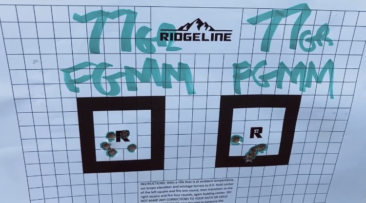

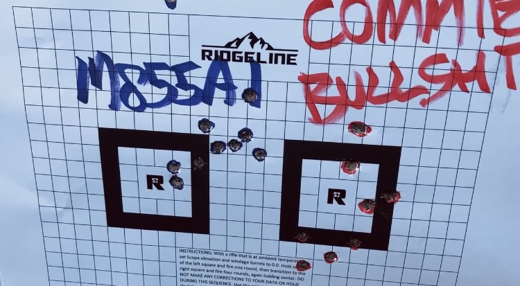

POI shifts has mostly to do with barrel harmonics. Some barrels like yours are going to be sensitive due to barrel profiles/materials. I’ve found Proof CF AR barrels to be finicky and inconsistent in this manner but steel barrels tend to follow the general rule that the heavier the profile the less effected the POI will be. My current DMR runs a fluted 16”HBAR, this is its 3rd barrel with this profile only difference between them was length (14.5” and 18”) Pretty much no major shift (maybe a slight shift) with between jacketed bullets, but solids are another story.
As you can see the POI between the 77gr SMK and the random 55gr Russian garbage is practically the same. M855A1 always seem to be up and to the right even with other rifles.
