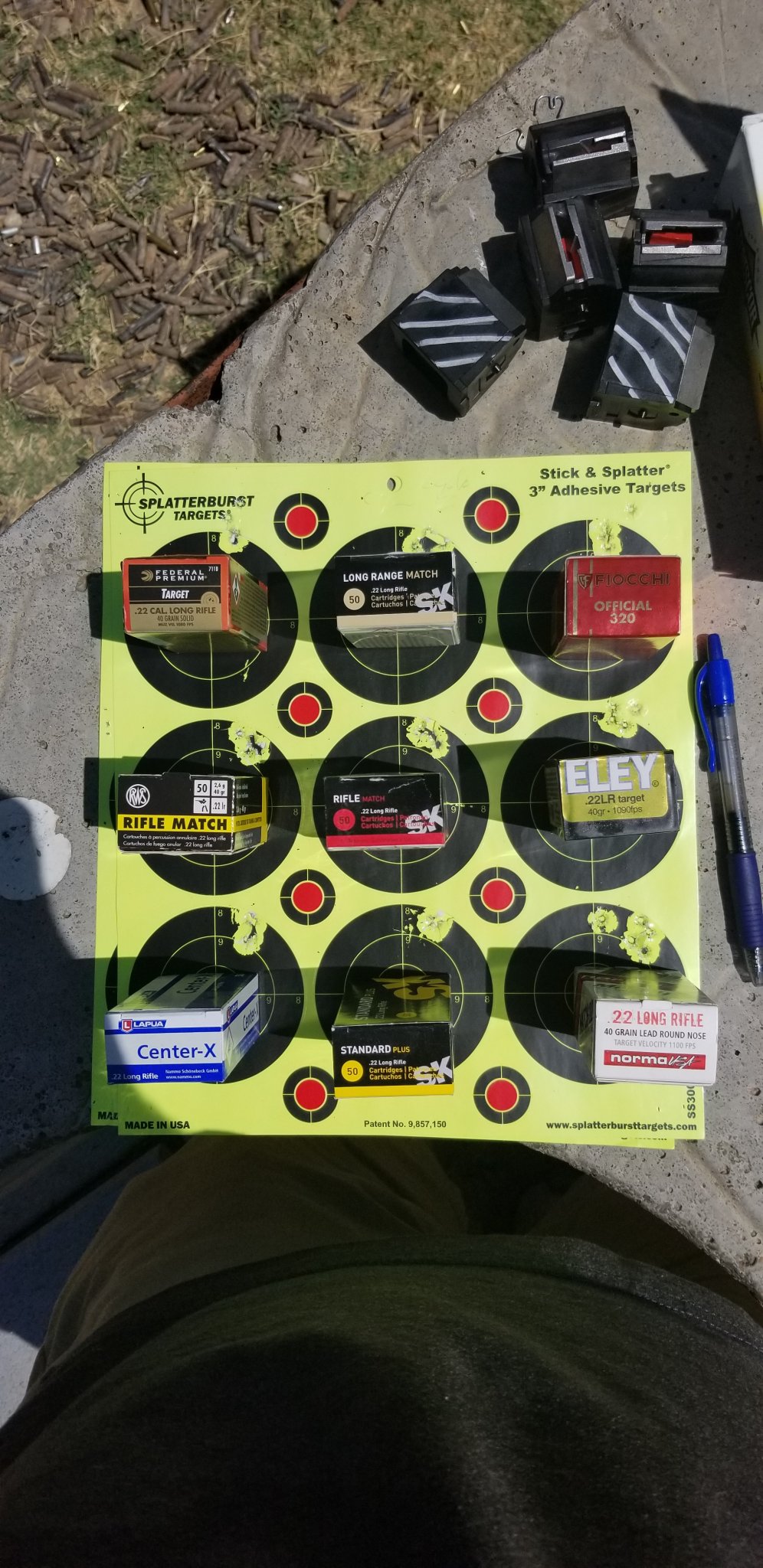

You need to determine what is acceptable accuracy for a given price of ammo. I'd buy a few boxes of Wolf Match Extra (now made by Eley), SK Rifle Match, and Lapua Center-X and see which of them works better in your rifle. They're all a good grade of ammo. You can always move up to the more expensive ammo if you find the accuracy not meeting your standards in those 3.
To the OP, if you are really serious about this you should buy your ammo from someone who can provide more if it works for you. I have a few rifles so I don't mind buying in bricks and sometimes cases because I know I will find a rifle the ammo likes instead of the other way around.
But, if you are only working with one rifle and don't want to buy by the brick, I would buy two boxes of ever how many types you want and make sure if those shoot well you can buy more of the same lot number.

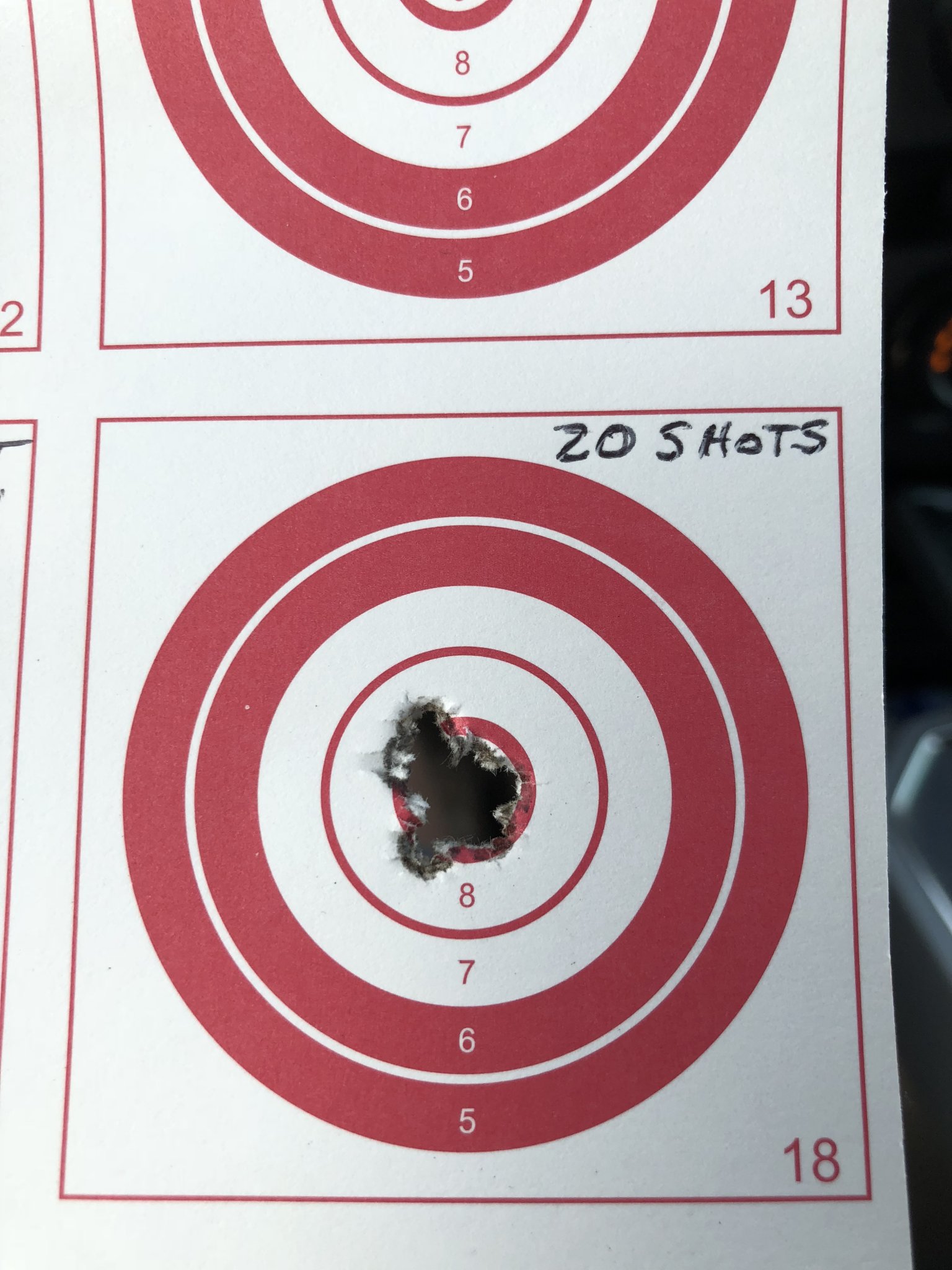

After shooting everything from CCI SV to Lapua Midas+ out of two rifles (chassis'ed CZ455 and Vudoo), my experience is the $10-$13-per-50-rounds labels are pretty doggone close in accuracy. The ~$7.50 labels can do well but there are more fliers. CCI SV and SK Standard+ can be amazing for the price, but I wouldn't compete with it.
I haven't gotten to the point of serious lot-testing for a specific ammo label - for the competitions I do, it's my perception that the return on investment isn't there. I emphasize "perception" because that's just my view. I reserve the right to change my mind in the future!
Also, I personally pay a lot more attention to images of multiple groups of at least five rounds each on a single target as opposed to a single bug-hole group. Yes, I've fired plenty of 0.1-0.2" 50-yard and 0.5" 100-yard groups out of my Vudoo, but to present any one of them as the norm would be a lie.

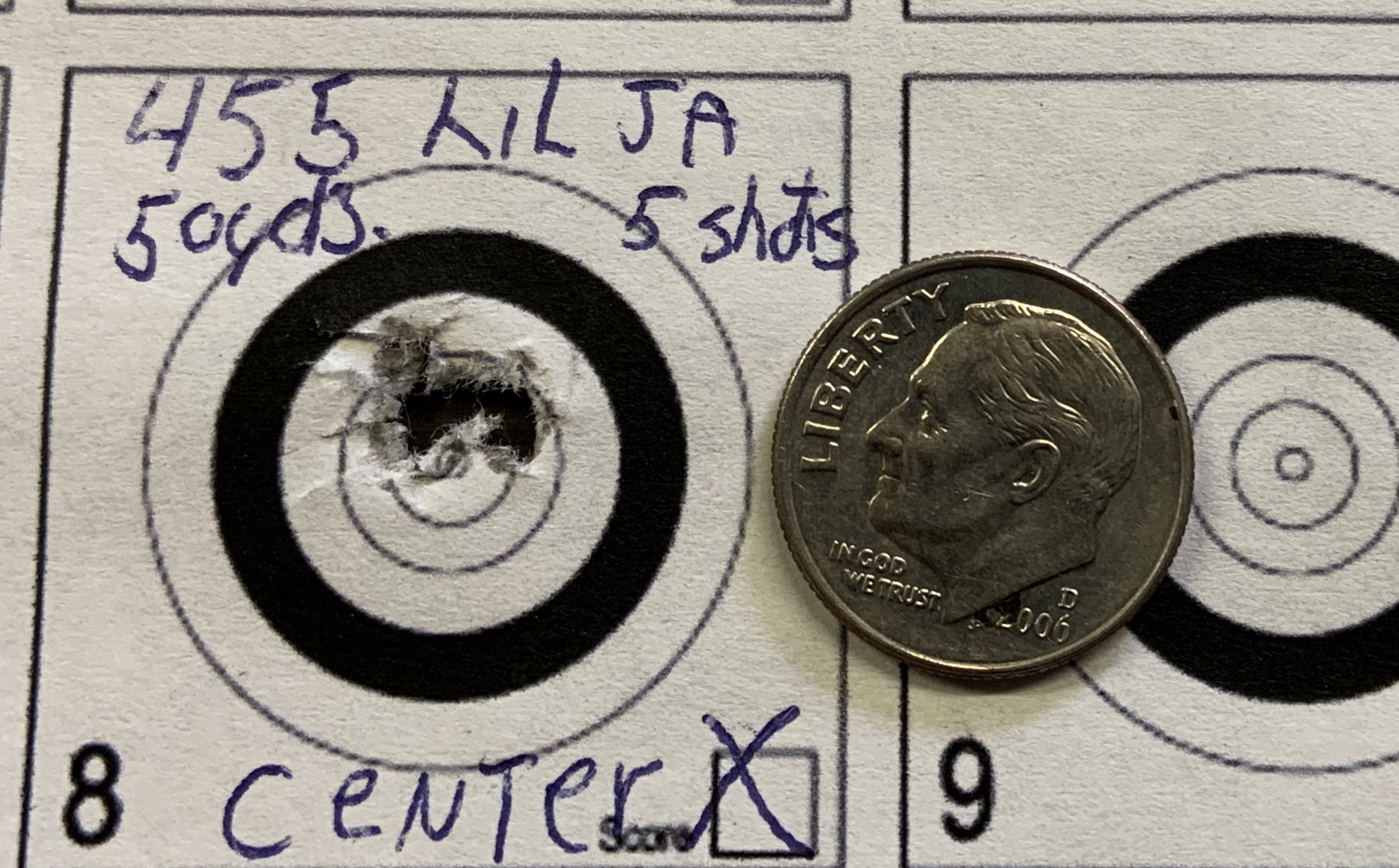

I started shooting 6X5s in 2013. I bought a Browning Mdl. 52C Sporter. I had a number of other quality .22s but nothing that could shoot with the 52. To start with I bought the two levels of rifle ammo from both SK and Wolf (the old Wolf) with two or three different lot numbers. This yielded virtually no information because I couldn't outshoot the ammo to begin with. I was learning as I went along and the 6X5s were shrinking but I still had ammo questions. The consensus of a lot of shooters on the old thread was that Center-X was the best bang for the buck. I ordered a brick of Center-X and it removed any questions about ammo. The change allowed me concentrate on my shooting and not the ammo.
As to the OP's question, if Center-X works well in your rifle, I would concentrate on it. After many random bricks of Center-X I've concluded that it's the only ammo I shoot in the accurate .22s. If you want to test lot #s then have at it. I'm sure there are lots that outperform others but the only time my shooting falls apart are when I don't shoot the .22s for four or five months and that's not the fault of Center-X. In the words of someone around here "shooting is a perishable skill".
