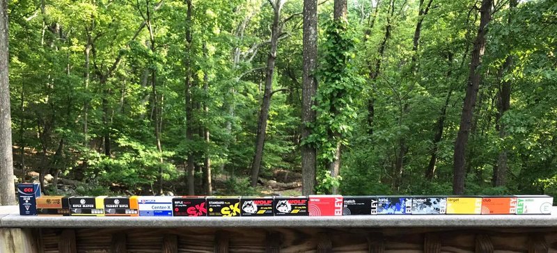

So I have purchased a bunch of different ammo to test out.
I've tried to keep each individual box of ammo under $20, and besides the box of Eley Tenex I got off the prize table the ammo listed falls below the price.
I'm just curious what everyone else testing procedures are and what level of cleaning between different ammo types.
Typically my rifle takes 30-40rds to foul and usually shoots good for about 500rds, so here's my plan:
Detail clean the rifle with VFG Pellets, Kroil and JB Bore paste.
50rds of CCI SV to foul the barrel and confirm zero.
3 patches of Boretech Rimfire Blend followed by dry patches.
Test the box of ammo.
Test next box of ammo.
AND so on....
Given the volume of this test, it'll probably be spread out over two days with a detailed cleaning (JB/Kroil) in between and refouling with CCI SV.
Testing will be:
(2) 5rd groups at 25yds
(2) 5rd groups at 50yds
(1) 10rd group at 50yds
(2) 5rd groups at 100yds
(2) 5rd groups at 200yds
Everything will be shot over the chrono and every shot logged. Then all 50 shots averaged, ES and SD calculated. This should provide a large enough sample size. Also, all atmospheric conditions will be logged at the beginning of each group using a Kestrel D3 Drop.
These are the boxes of ammo I'll be testing:
CCI Standard Velocity
RWS Special Match
RWS Rifle Match
RWS Target Rifle
Lapua Center-X
SK Rifle Match
SK Standard Plus
Wolf Match Extra
Wolf Match Target
Eley Tenex
Eley Match
Eley Edge
Eley Force
Eley Contact
Eley Club
Eley Target
Eley Action

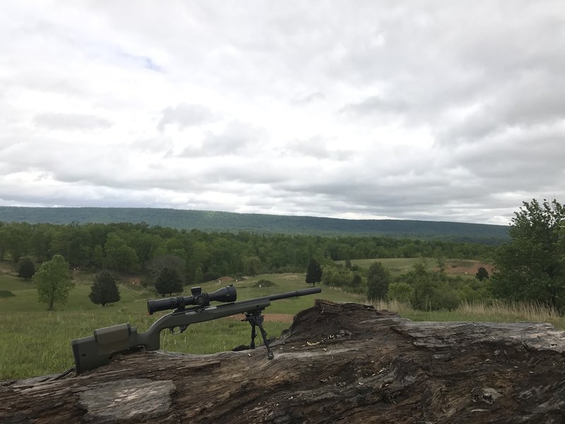

Little Info on the rifle:
The rifle started as a factory ruger 10/22 stainless, back when ruger was doing those ugly grey finishes on their stainless guns. This was actually the first gun I bought myself when I turned 18.
As its sits now:
Receiver: Factory
Barrel: Kidd LW 18"
Bolt: Factory, worked over by Trivettes for radius rear, firing pin pin, and head space
Trigger Housing: Factory
Trigger: Kidd "Trigger Job" Kit Drop in Single Stage (these are great btw)
Charging Handle: Kidd w/ Viton cushion
Mag Release: PWS T3 Leveler (these are simply the best design out there)
Stock: Vitor Titan with Cheek Raiser (I keep changing the scope so it's just taped on for now)
Scope Base: DIP, Inc 25MOA
Scope Rings: Seekins 34mm
Scope: Bushnell DMR 3-21x50mm, FFP 34mm tube, G2 Reticle
Random replaced parts: Kidd V-Block, Kidd Mag Catch Plugger, Kidd Receiver Pins, Kidd Bolt Buffer
I had a Kidd take down screw but that stripped out and I purchased the factory hex screw instead.
If I was to build this again I'd just buy a Kidd super grade to be honest, but this has been 8 years in the making now.

Sounds reasonable, except for the 25yd groups - I don't think I'd waste the time nor the ammo to test at that distance. Unless you're using 25yds as more of a way to season the bore with fouling of each succeeding type of ammo, and even then, I believe you'd get more meaningful results at 50yds.
I agree, 25 yards is a bit close unless the majority of your shooting will be at that distance. Shoot the ammo at the distance that it will be used for, you may have ammo that is killer at one yard line but falls apart at a different. I don't clean between different brands of ammo, I season the bore by shooting the ammo. Most of the time it will be 15 rounds (give or take 5 rounds) before the ammo is shooting at potential. *Don't be fooled by the first 4-6 rounds after switching ammo as a lot of the time you will get a screamer group, but it will open up before it settles in. (normally)* If your cleaning between ammo then your going to be very close to the same # of seasoning rounds, so why waste the time cleaning. With that being said rimfires do still need to be cleaned from time to time, but normally a good barrel / chamber can go 500 or more rounds before it needs to be cleaned I have seen some go much more than that.
Your greatest challenges to keeping all of them on an even playing field are going to be the atmospheric variations. If I were to shoot that plan this weekend, for example, I'd see anything from mid 50's to mid 80's / 50% RH to rain / winds 0-12 mph. The rest of your plan looks good.

Nice Pic - I recognize that log, lol. My favorite stage of all.
