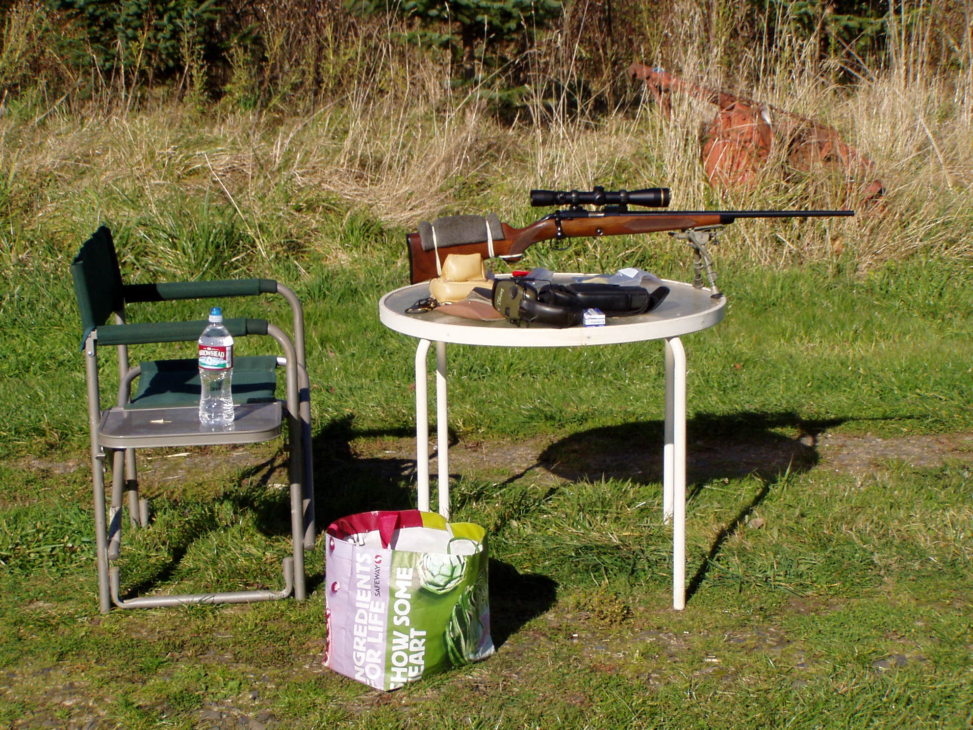

do you shoot bench rest?
Here's my bench. The rifle is a 52C Sporter re-issue with a Leupold 4.5-14X LR. The rifle is 8.5# with a 3# trigger. The picture is from the original 6X5 thread from five years ago.

Nice set up
