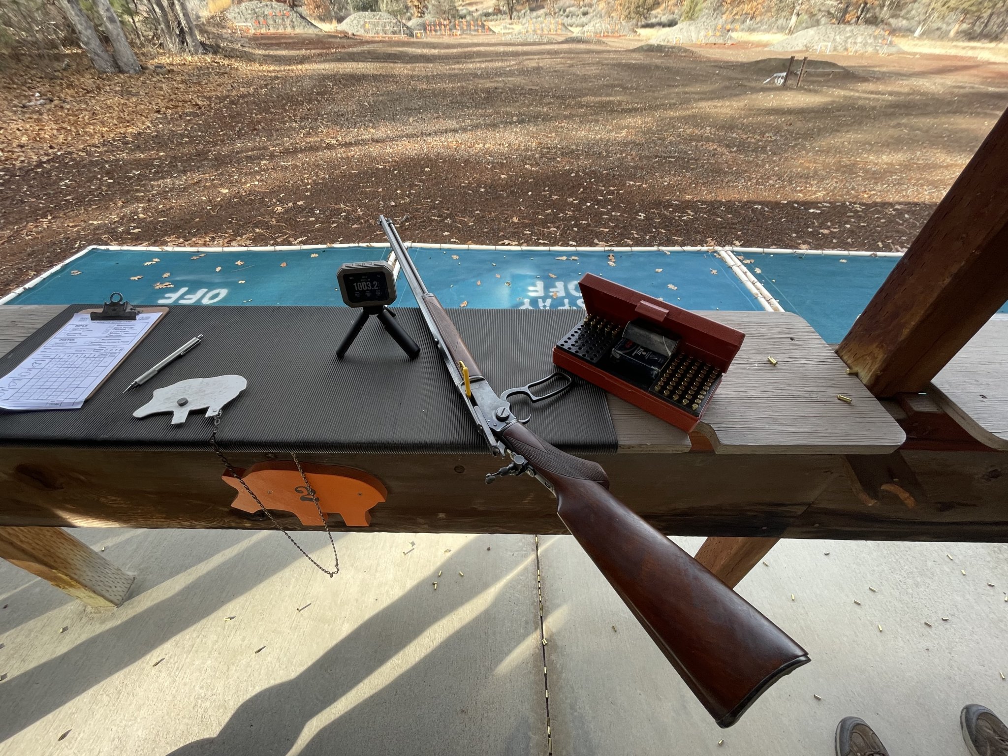

    A little background. I have been competing in NRA Lever Action Small Bore Silhouette for about 20 years. Currently, I am ranked as an AA class shooter working on my second or third leg to AAA.
    My rifle is a 1920’s vintage Marlin 39 (not 39A) with a Marbles Tang sight. My go to ammo has been CCI SV, high and hyper velocity have caused mechanical damage to this old war horse.
    The ranges that I shoot at are at ~500’ ASL and 3200’ ASL in temperature ranges from the teens to 110*F+.
    I am at a point where I am calling the majority of my misses, and am considering a more consistent ammunition without breaking the bank.
    Should I stay with what is working, or start chasing the elusive GOOD ammo?

    Came across this thread today. Still Running CCI Std. Vel. rather than chasing “new” due to time and availability. I still haven’t been out shooting the ammo.
    Here is a picture from January where I also tested my Garmin Xero. The high that day was low 40’s.
    Reactions: RTH1800
