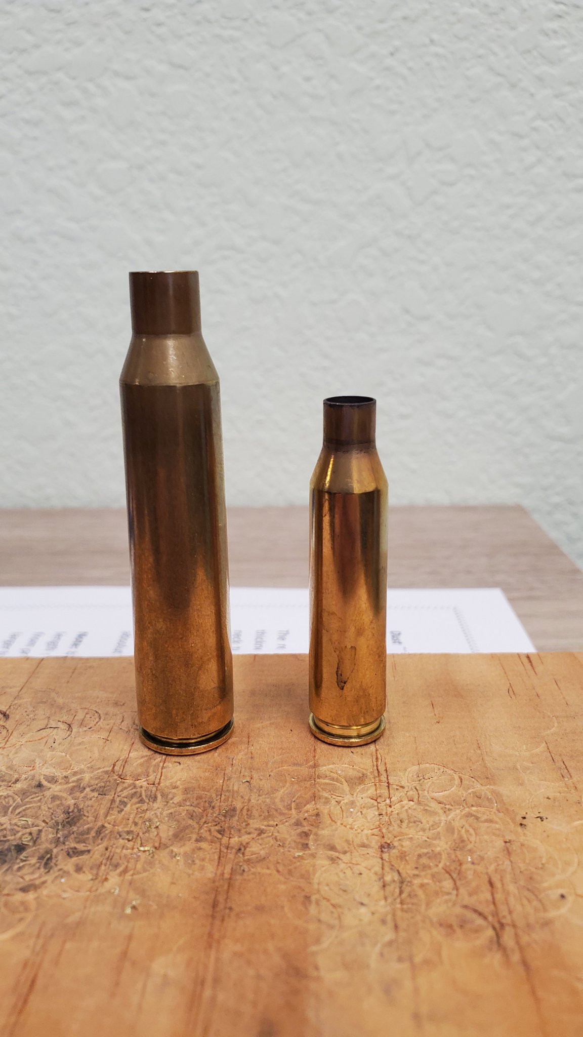

so I just got my AMP annealer. Found an "average" 338 lapua case (Lapua brand), used aztec, came back with code 0170. Cool. Next I got an average .260 Lapua case, ran aztec, code 0170...hmmmmmmm does this sound right to anybody??? I put correct pilot numbers in as well.
Here ya go
i dont have my settings paper here with me at work, but iirc the settings for my 6.5creed lapua brass is similar to my 7-300prc ADG brass...i think they are both in the mid 150s
6.5prc Hornady brass is 148
I just got my AMP in yesterday and ran some 6.5 CM lapua, once fired brass thru the Aztec and the code I got was 156. this was once fired, deprimed factory ammo.
Reactions: morganlamprecht
similar to mine, i was just AMP'n some 6.5creed lapua yesterday and my setting is 155
oh good...I was hoping I was on the right track with all this...I've never used one of these until yesterday, so i'm glad I ran into this thread...this thing is super fast and so easy to use! I think you and I know a couple of the same people...youre in texas...right?
Reactions: E-Tool
