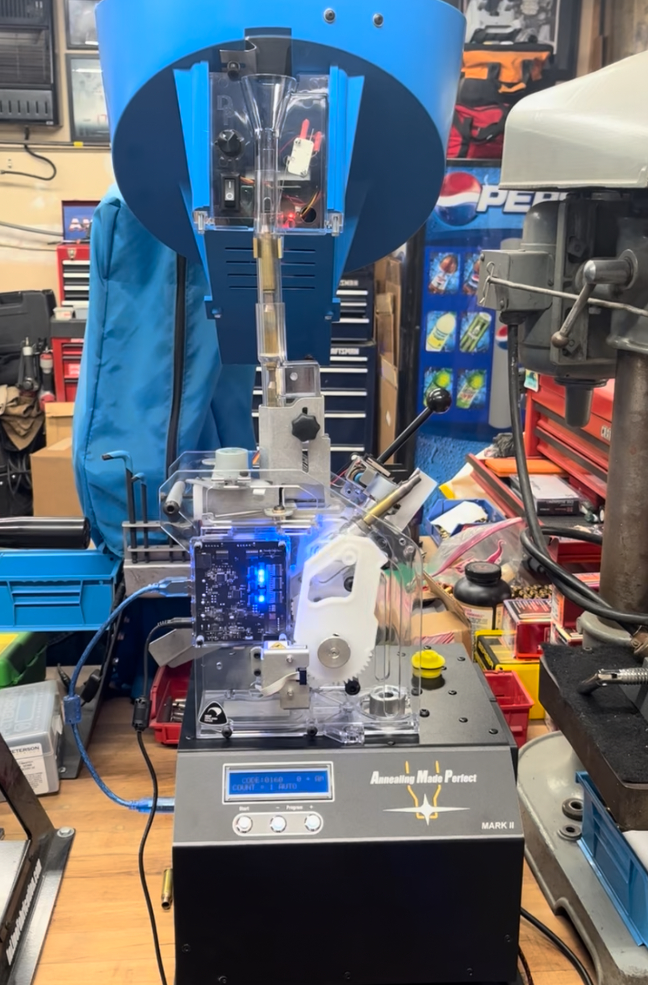

Just got my amp and I really want to add the mate with the Dillon feeder and creedmoor sports stand. Anyone running this setup? How’s it working? Finicky or pretty reliable? I’m loading 223, 223 Ai, 6 dasher, 25 creed, 7saum and 300 Prc, so I will be adjusting quite a bit. Thanks

I finally was able to grab one after having my AMP for about 2 years. As others have said it works very well if you set it up correctly. I run mine without a case feeder and just fill up the tube 5 or 6 at a time and that works great for me. That being said I only set it up the mate if I’m annealing over 100 pieces of brass or it’s already set up for the cartridge I’m annealing but that’s mainly me just being lazy.

I anneal every firing, been doing it before the amp with a giraud. I make it habit to do the same thing everytime I load. The AMP makes the process so much easier and more consistent than how I did it before. As far as changing calibers go, it takes a couple minutes and you’re good to go. I run 223, 22,25,6mm creedmoors and then 308 and 338 Lapua.. it’s no issue to change out the tooling and press start and then do something g else while the amp does its job.

Don't think the Dillion case feeder would make a lot of difference, if you can find a longer tube, manually drops the brass in works better.
The Dillon case feeder consistently rotates produce a lot of noise and AMP normally will anneal about 50-70 brass from a cold start before it turns the fun on in full mode, which is also quite noisy. It probably can do around 100 brass(depends on caliber) before the induction element over heat which requires 10-20minutes to cool down to continue.

I've done as many as 300 cases at a time ... mid-to-large size (300-BLK to 6.5 to 300 to 338-LM), and my AMP does ratchet up the fan speed after 50-75-ish cases, but I've never had it heat up sufficiently to need to even get close to shutting it down. After hundreds of cases, the exiting fan temperature is still just "slightly warm" at best. If yours is getting sufficiently hot enough after 100 cases to need a shut-down and cool-down ... you should call the AMP guys and discuss it. There's something wrong.

AMP advised to clean the induction area inside the hole as they suspect the sensor could be dirty causing the hot brass/pilot message showing on the panel.
I will see if it happens next time when I anneal any batch of brass(over 150) requires higher temperature/longer time.
