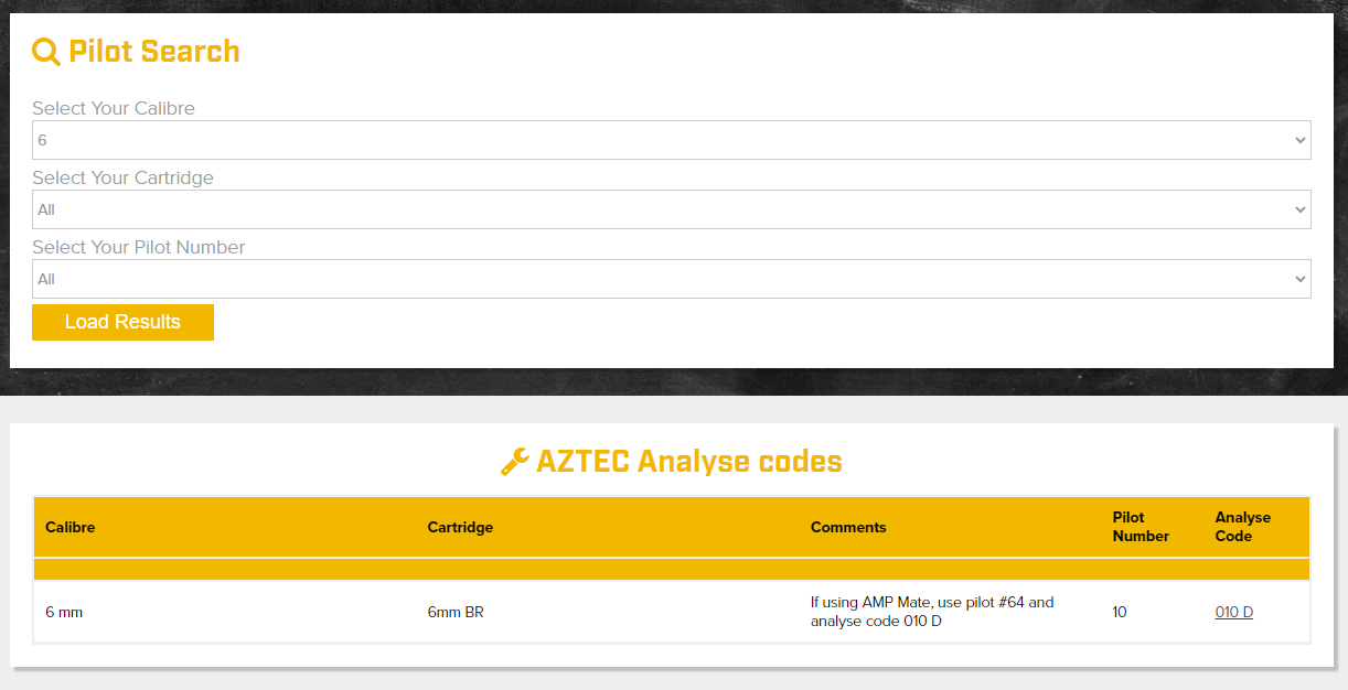

I don’t see any data on AMP’s site with regards to 6.5 PRC and the Lapua case. Has anyone got a program number figured out? I don’t really want to sacrifice multiple cases to Aztec. Lapua brass is tough to find and very expensive here in Canada.

Why would you need to burn more than one? Someone probably does have a Aztec number for it though and it's probably going to be the same so, not a terrible idea I guess to just roll with that

Before you ruin all of your brass ;) reduce the annealing time by 10% and do 3 cases and shoot a test group, then increase the time a little and do another 3 cases and shoot another test group. And so on and so forth until you see the group open up. Do this with a known accurate load. I’m telling you this because in my experience the amp overcooks the brass.
