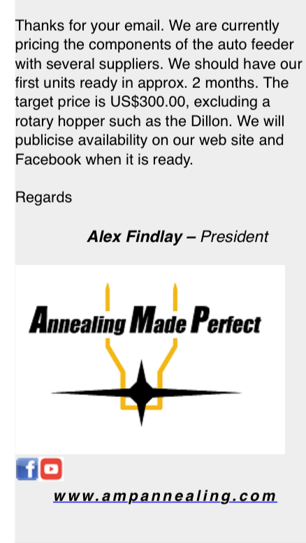

    Did just that... Click the photo for a screenshot of Alex's response. The summary is that they think it may be available in a couple of months and they are thinking it will be about $300.

    First - the AMP auto feeder is expected to come out in the next couple of months with an estimate price of $300. But note that according to AMP you will also need an autofeed hopper like a Dillon. These are around $300 themselves.
    Second - if you buy an AMP, they will test your specific brass and tell you the exact program to anneal that brass. It is free. In fact they encourage users to send them brass for testing and retesting. So if you turn your necks, you will get the exact AMP for your neck thickness.
    I'm leaning towards the AMP because I already happen to have a Dillon hopper, and the precision from the AMP just seems hard to beat. But I'm going to wait to see how their feeder works before pulling the trigger.
