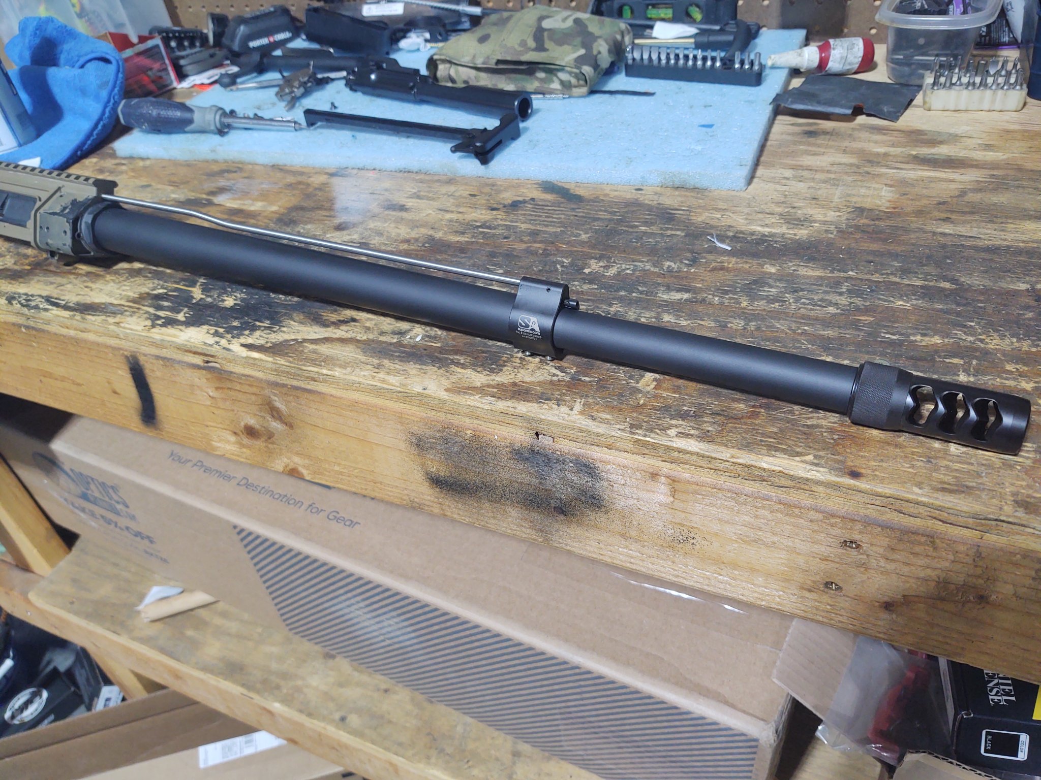

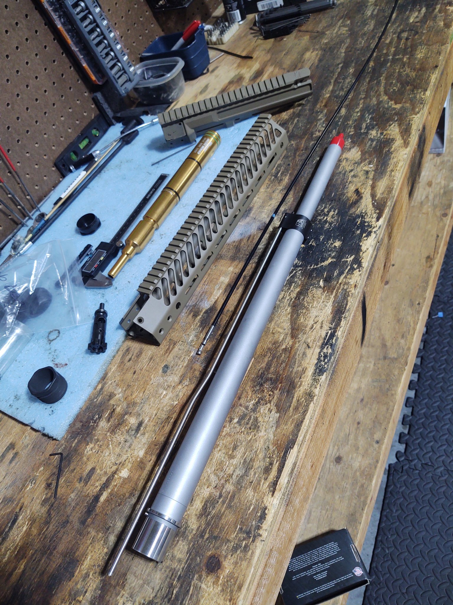

I run Bartlein four groove blanks on all my rifles in the following configuration. I'm assuming you'll be running 6.5 CM or 6CM?
22"-24" Bartlein / 1-8 Twist / M110 Contour with +2 Gas System/ .875 gas block Journal step down to .850 to the muzzle / 5/8x24 Threads.
View attachment 8093823View attachment 8093824
