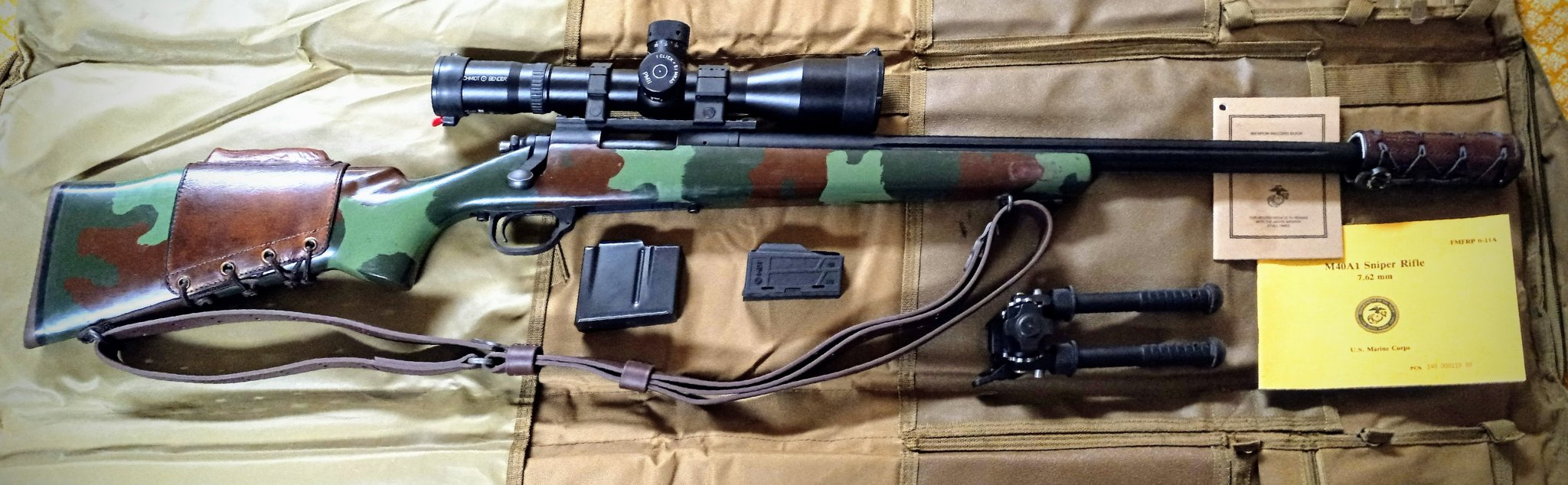

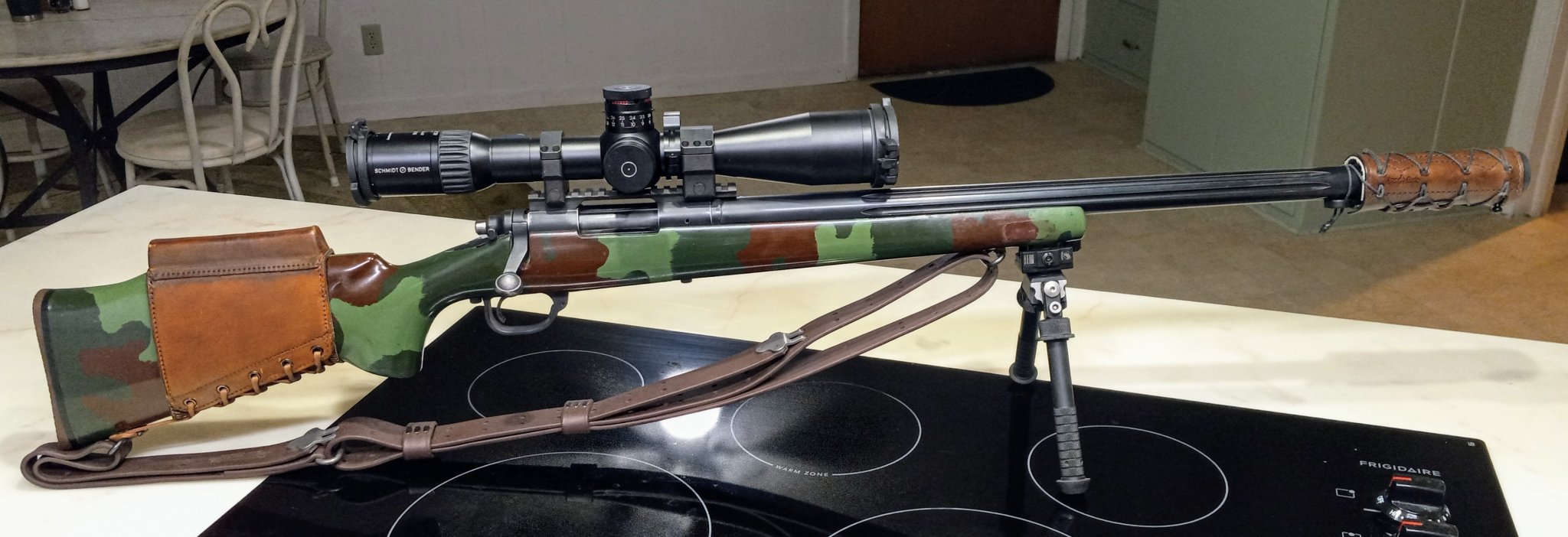

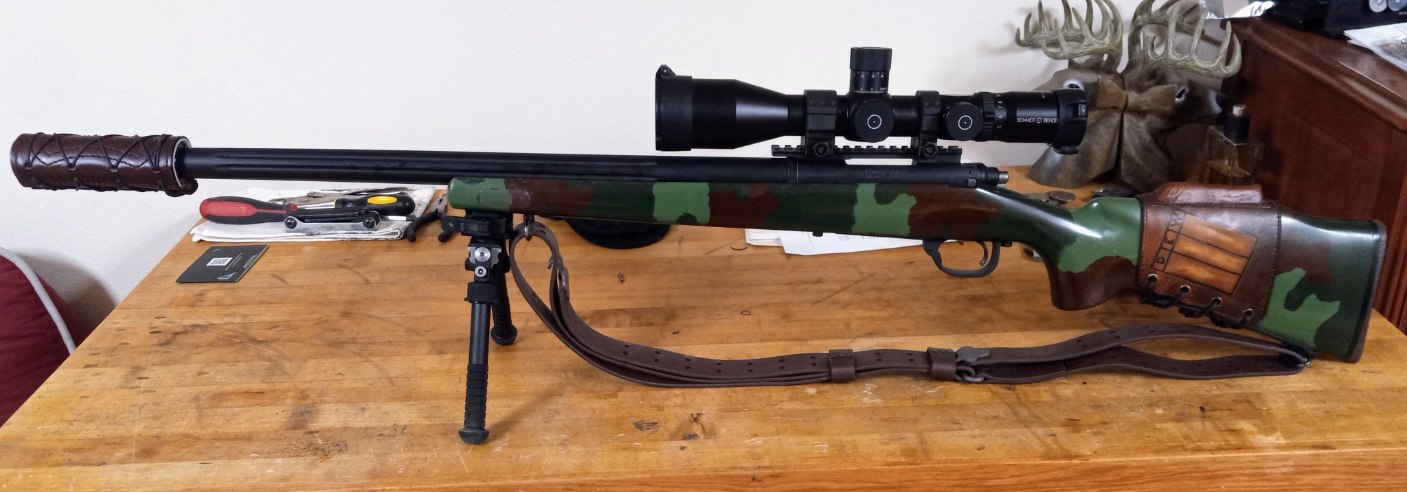

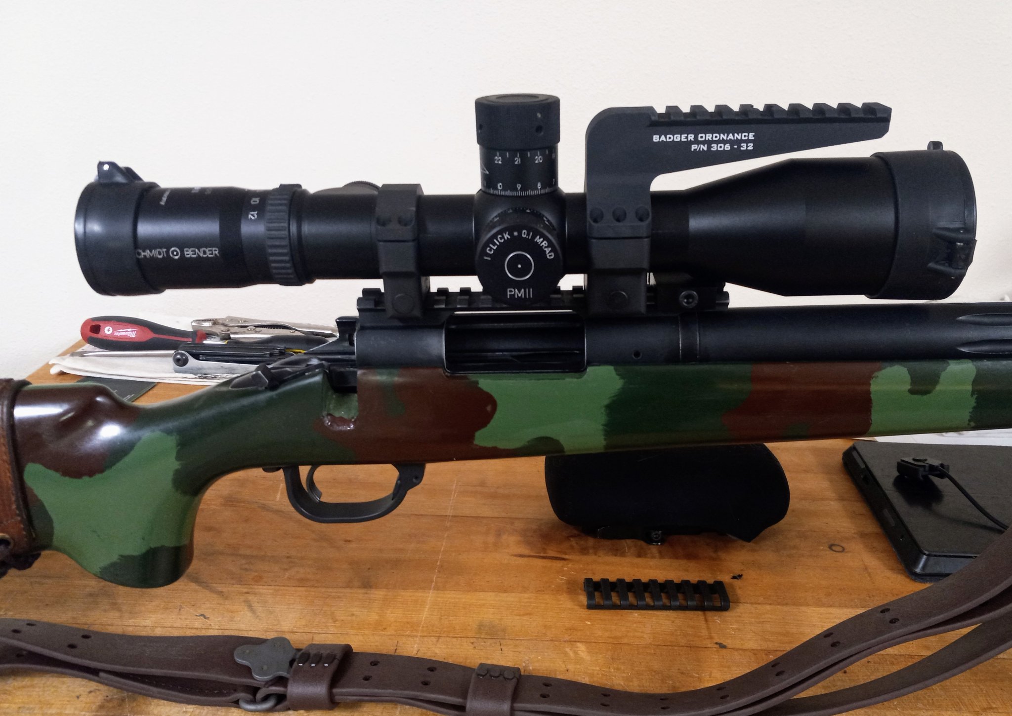

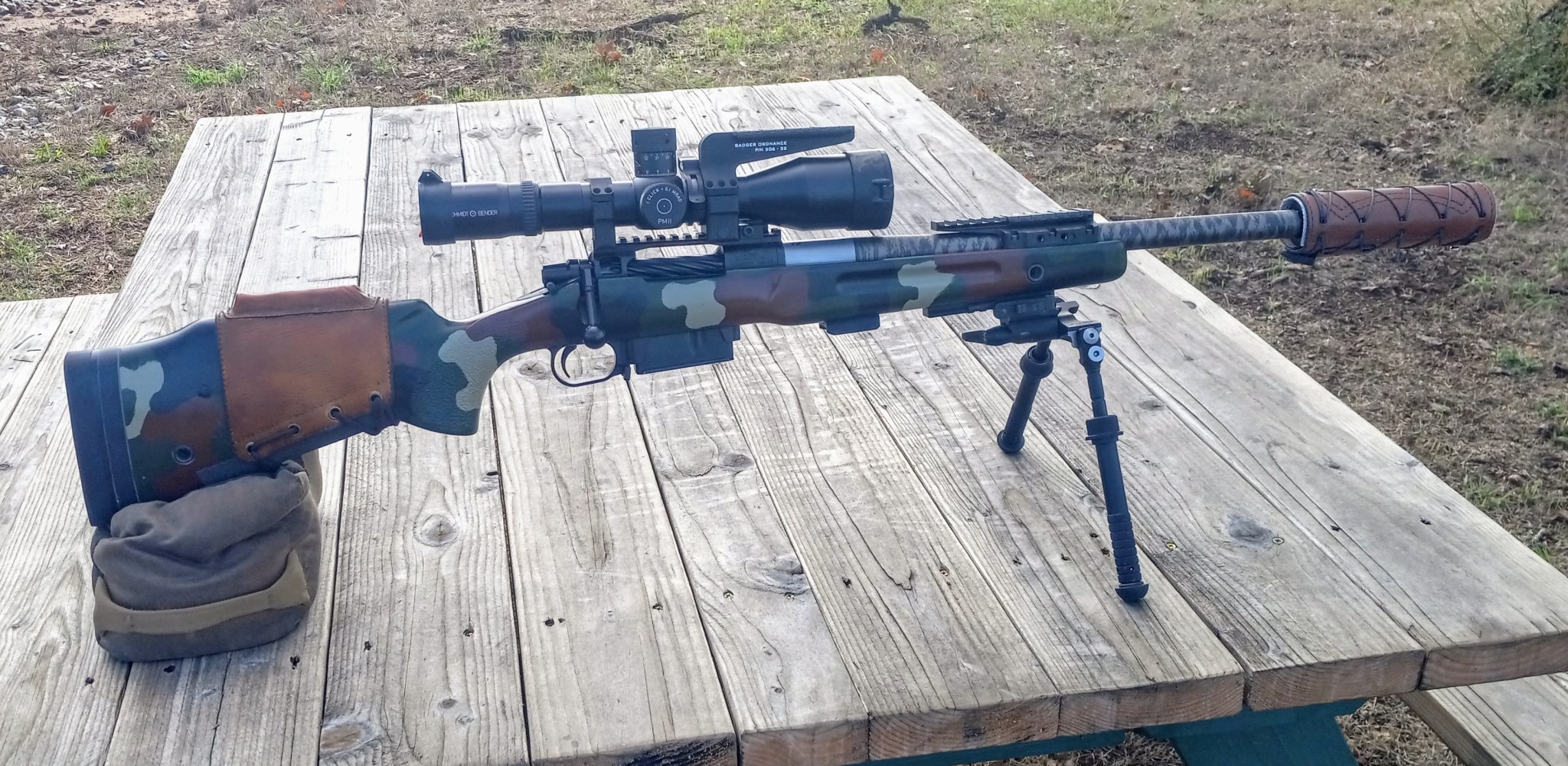

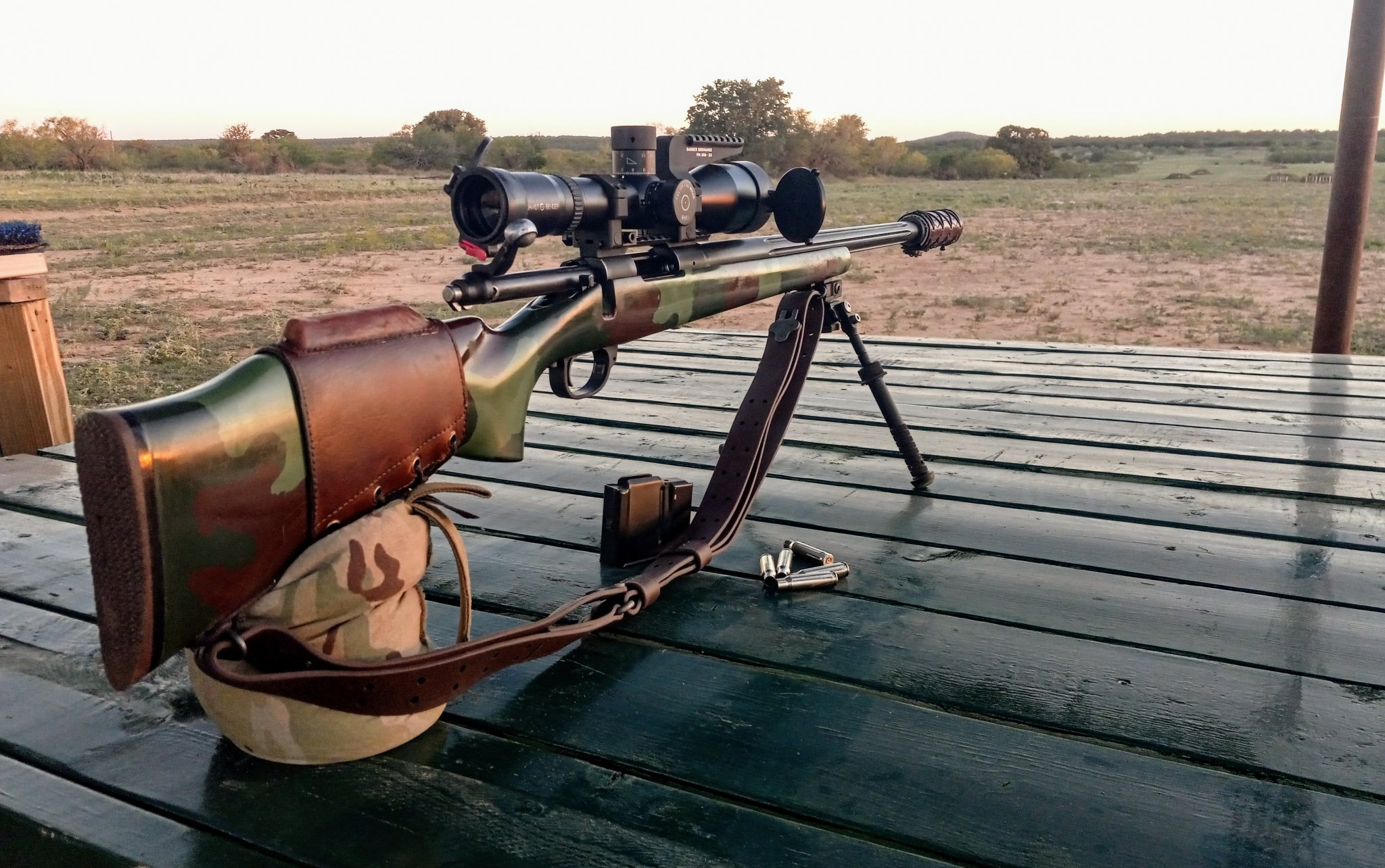

With a few minor exceptions of pieces from my own bin, this whole build came together from PX acquired parts...that in the beginning were never bought for one another lol. Its a pic heavy post, but I just wrapped it up and was proud, so figured I'd share.
I was originally scooping up a stripped G serial action for a different project and hoping I might stumble on another Obermeyer since a barrel came with purchase (appears to actually be a 1:12 Schneider, Eric Reid proof mark and GA Precision roll mark barrel). In that transaction, I was given a very gracious opportunity to get a USMC M40A1 return stock that had been pretty badly damaged.

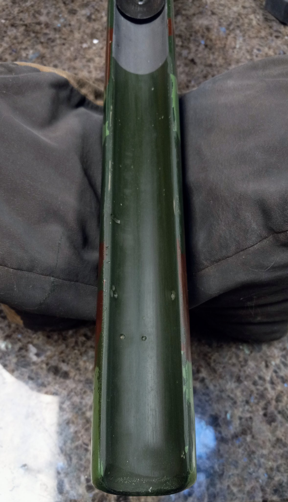

With a weekend worth of HARD (relative term) labor I repaired it via a Mcmillan kit and Devcon and wax and all kinda nonsense and then started to add correct minor parts. The Mark 4 scope and welded Model 7 base I was planning on using just weren't great, so that part got jumped to M40A3 vintage.

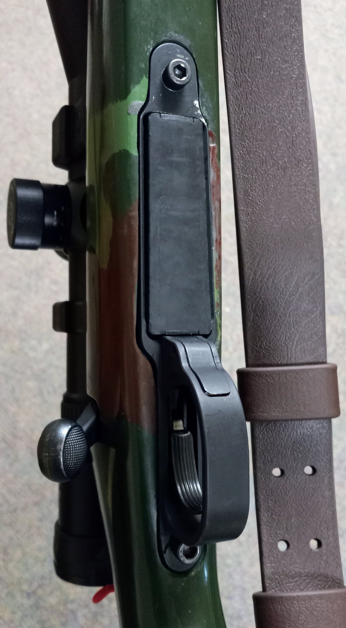

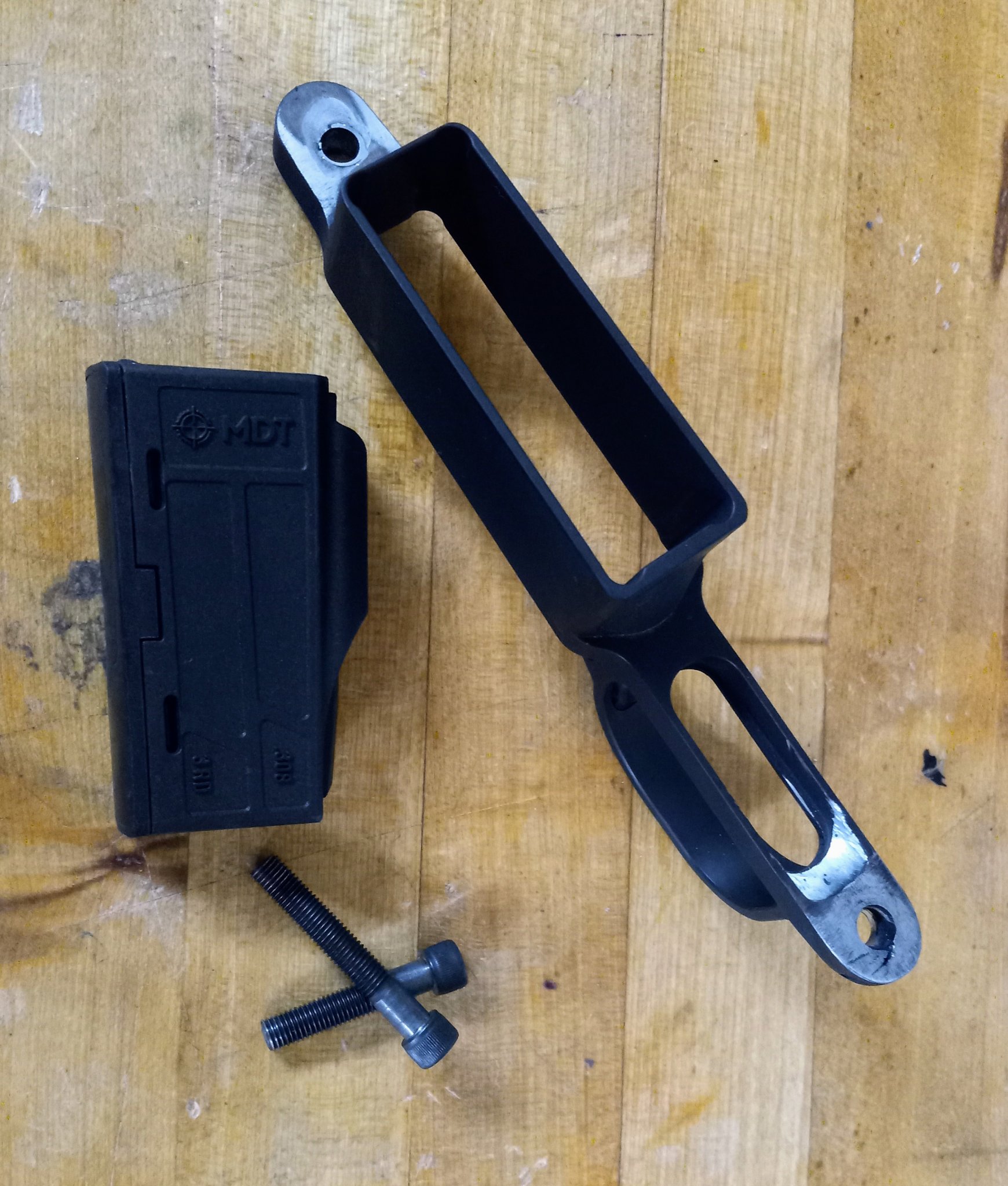

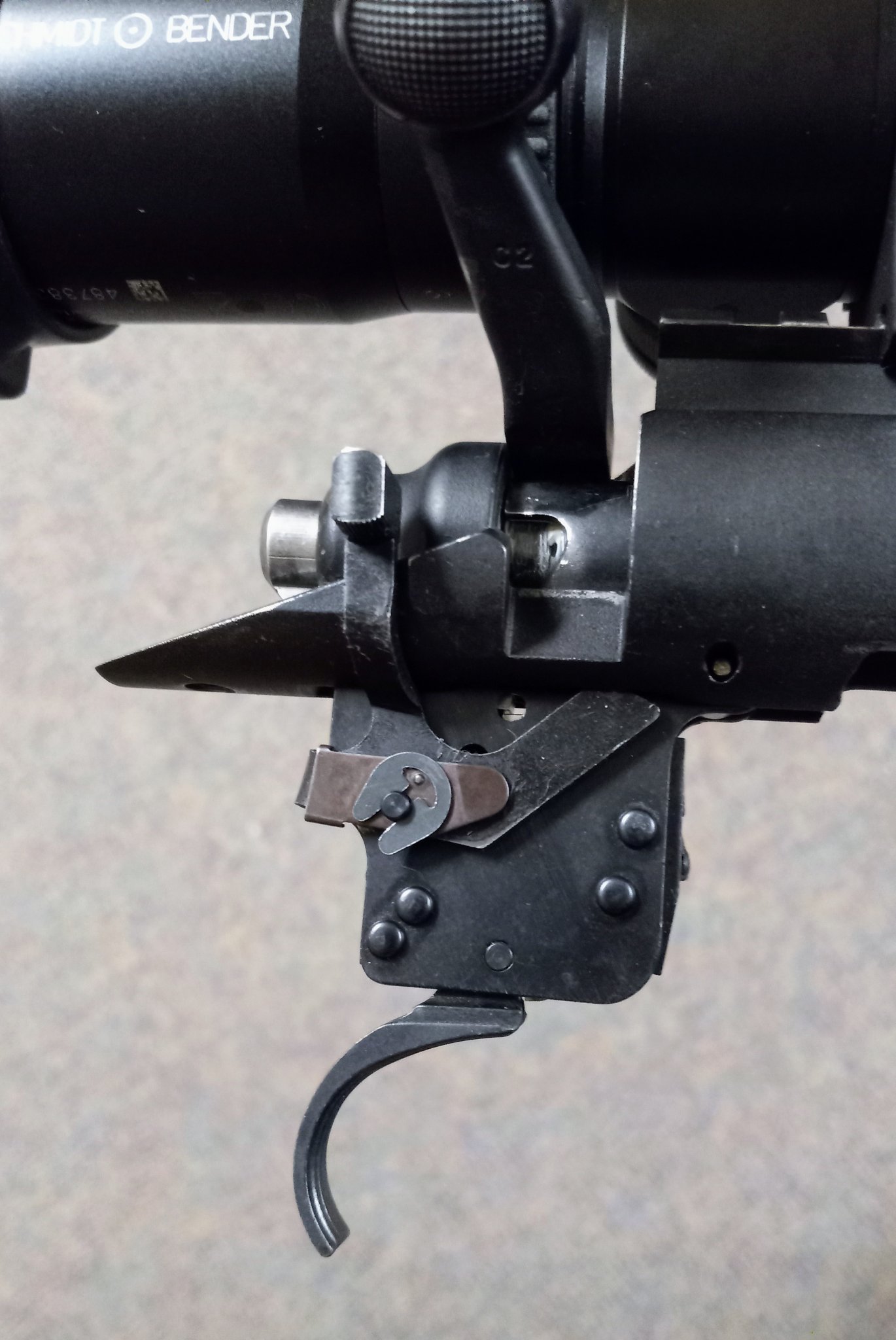

I welded up and redrilled a Grayboe bottom metal so I could have the "look" but run AICS mags. Added a 721 short shroud. Fresh 308 chamber cut and some length off the top (21", threaded now). DD Ross lug cuz I got one off here once. The balance was weird, so off the barrel came. SPR/Bugholes gave it 8 straight flutes.
GreTan spring and polished just about everything. Gutted a Walker to fix up a tombstone, split-sear trigger that was in rusty shape. Hung some leather accessories and a Turner Saddlery sling. Added the world's tiniest picatinny in front of the Wichita up front, just enough for a qd Atlas. Gave it a book set and suppressor, and here ya go!
Zeroed this morning with 150gr Federal Fusion, which it shoots mighty fine!!

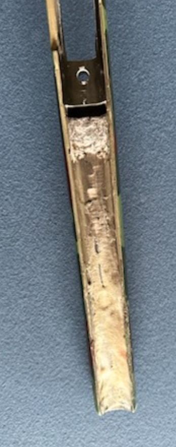

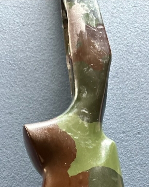

Looks like very nice work. Was that where all the damage was, in the barrel channel? Isn't that a very odd place for abuse? Or have I missed noticing repairs of far more damage elsewhere?
Had any number markings survived until your ownership to tell what rifle it once was a part? It looks like an 8 in the bedding by the front mounting screw hole but that could have been an impression from bedding your action?

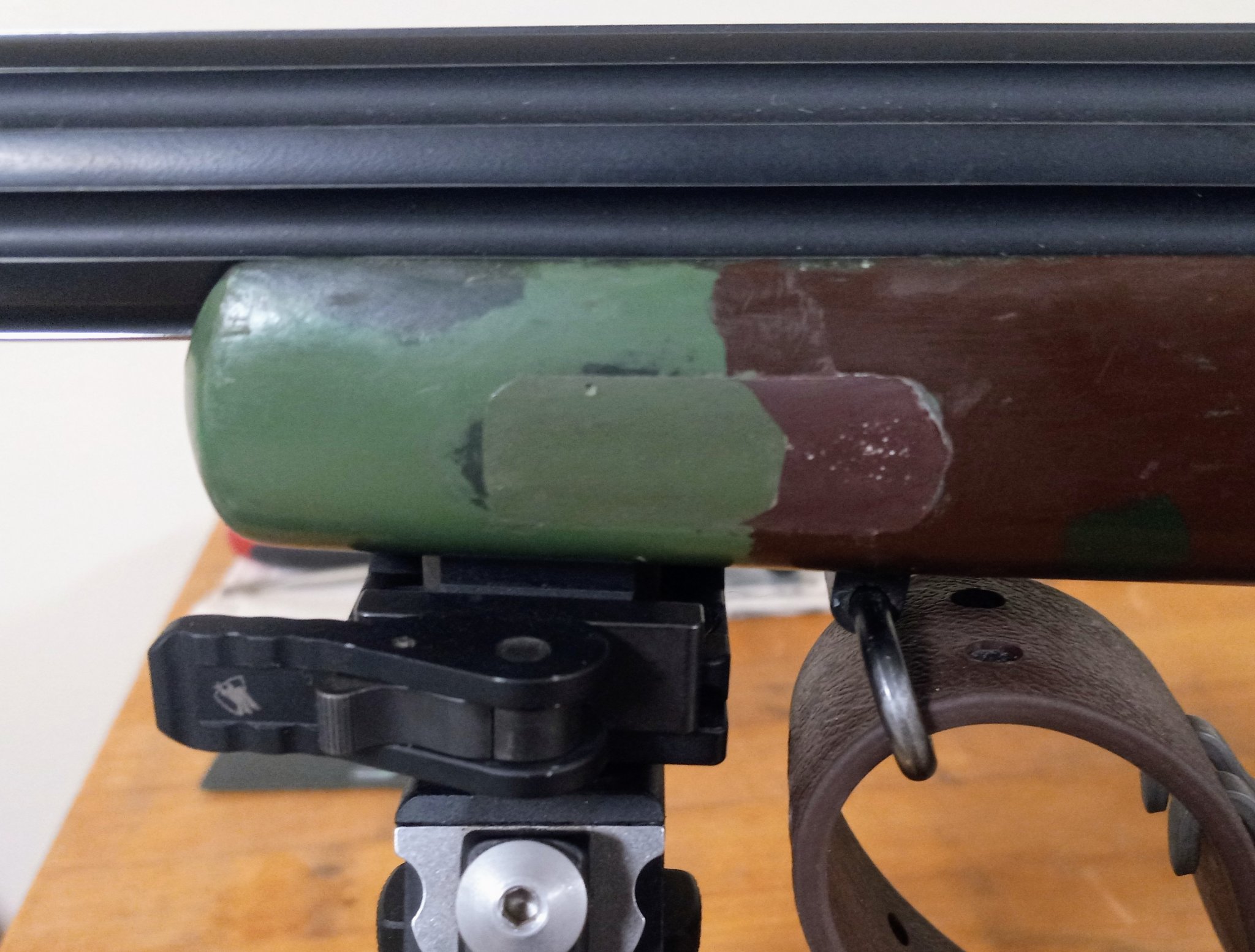

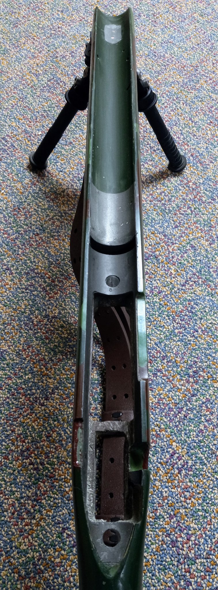

There was damage throughout. I didn't take good before photos...got too excited to start working. The rear wichita had been drilled out to accept a flush cup. The bottom metal had been cut horizontally along the sides for reasons unknown. There were two side cutouts and a deep barrel channel cut where it looked like an attempt was made to remove the interior steel. Its damaged but still there. Several vertical holes were drilled through for a picatinny rail. The "S" in the bedding was just a stamp on the action I bedded it with. Some of the external clear was abbrated back to bare fiberglass, which I just waxed rather than patched.
I know very little of its lineage other than its original rescuer being a respected cloner and it all appearing correct. Late 80s seems best guess. I could probably pop the butt pad off and see if any markings are underneath, but everywhere else would be sanitized by now.

I wasn't sure if that was an 8 or an S. I guessed wrong. You appear to have made a mod for the bolt release clearance.
So someone drilled through it multiple times to mount a pic rail? Ouch.
Could they have been attempting to mount, I don't know the proper name for it, one of those rail adaptors normally used on the A3? Part of it gets put in a cutout recessed into the barrel channel and the other screws down onto it to encircle the barrel and give 1-3 short rails at the for-end of the stock. If they did, someone should have measured a few times before the attempt because I think the stock design on the A3 was much wider and deeper in the front than the A1.
That sounds like a crime cutting the bottom metal. Those things were hand modified to begin with. Another ouch. Any surviving numbers on them? I'm still hoping to find the missing matching metal for a couple stocks.

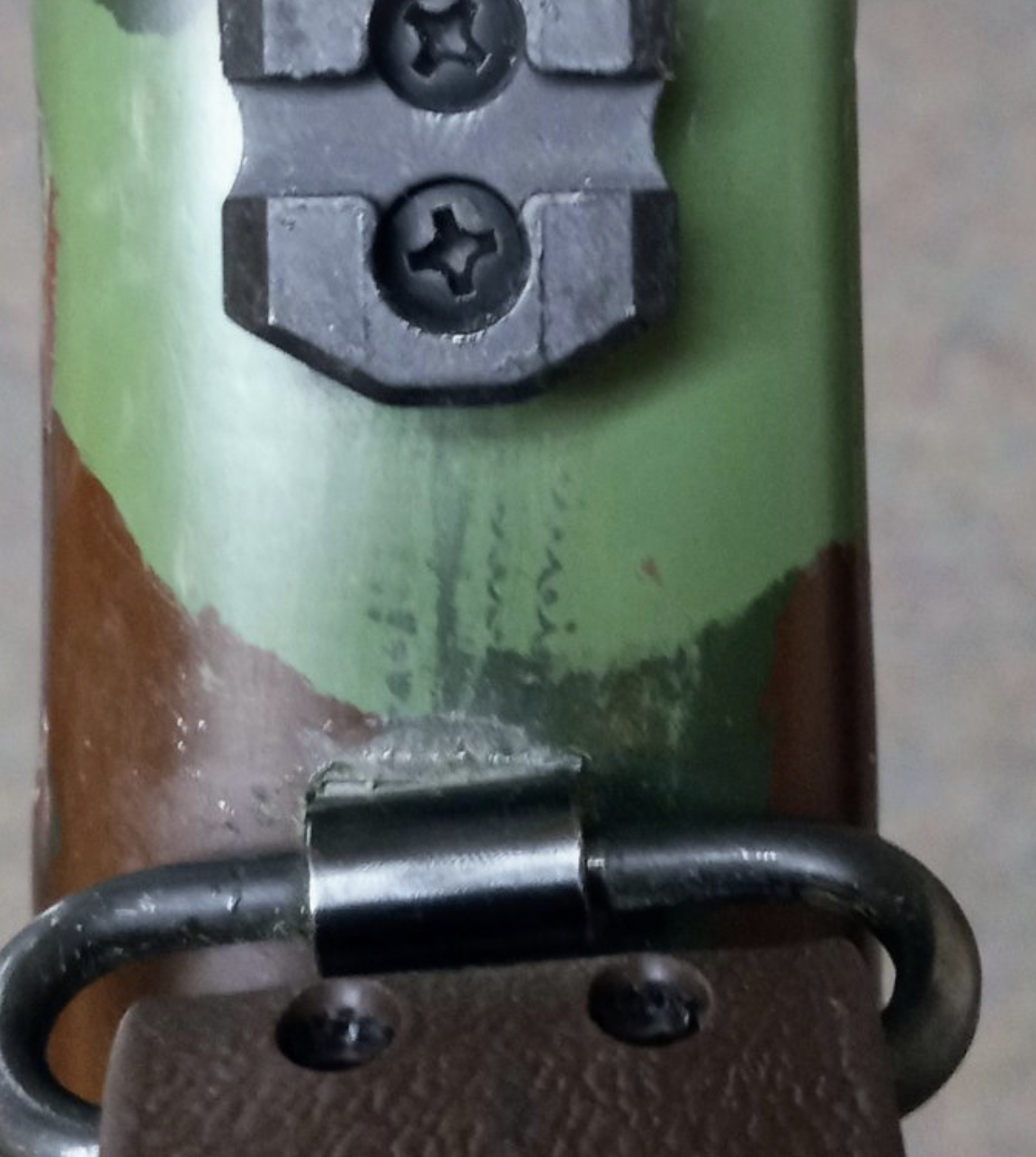

I've got moved swivels, very curiously on one. Both appear to have been moved about 1/2 inch forward and the original spots filled. I can see the remaining stud still there in the barrel channel. I can only guess that they were snapped off/moved at the same time.
A different one has the front swivel snapped off from I guess using a big pipe wrench which also gouged up the stock with circular grooves. I'm not sure if it was a school stock or what. It has DS painted on the side in some of the remaining paint and some old rotting tape with T or D18 and a marine's name written on it in marker. Remnant shadow in the paint from a data card I guess on the right side and very curious damage to the front of the stock that seems impossible to have happened if it was assembled. Maybe it happened when the swivel was snapped?
The last one has the front swivel loop removed and clear signs of grinding to shrink the remaining base for a Harris bipod to attach I guess.

Correct, I recessed it for the action from the parts collection, which has an older variant of that modification from GAP.
The bottom metal area damage could have been a drop because it was much worse on one side than the other.

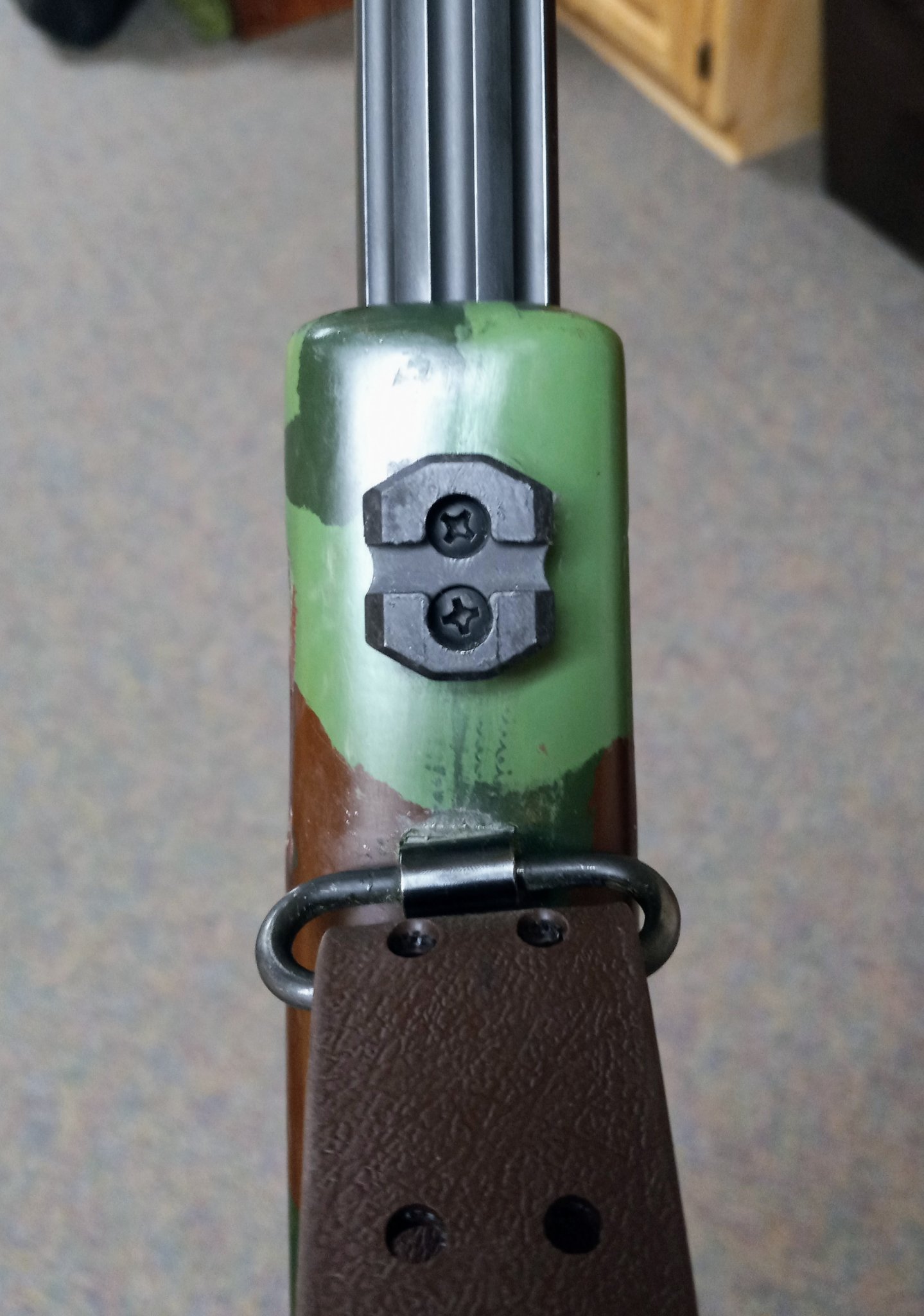

If you're referring to the PGW EFR seen on M40A3/5s, no it was not modified for that. I've put one of those in an A4 and to get it into an HTG would take some real sorcery and look ridiculous. An overarching clamshell like a chassis might have is an interesting theory though.
The side cutouts were probably not for more flush cups. They look like this:
She did get one upgrade today. A member here helped me locate a discontinued rail for the Badger rings, and it can run some of my toys now 👍 no stock mods required lol.
Had a thought on the metal damage, could someone have tried clamping it by the trigger guard in a vise during their super duper bad guy shooter build

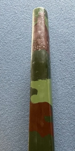

That strange part that mounted down at the end was the only thing I could think of as a reason for anyone to try hogging out the barrel channel.

That is a sizable patched area. They actually made a hole that big? To quote myself from earlier, "Ouch". Another thing I saw in the mk13 pictures was the inset bipod rail mounted in the forend with 3 screws and sizable holes/mount points seen in the barrel channel. Similar but not the same as the described 'changes' someone had done to it. I thought those type rails were long out of use. Everything seems to be going Arca-Swiss rail now over even pic rails for a 6 o'clock rail.

Another off the wall thought on the barrel channel damage. Could someone have actually wanted to build an SBR action with a integral suppressor? Probably way off the deep end with that idea.
I think by your descriptions in one para you're describing a MARS or MIRS rail, which wouldn't/shouldn't be in stock contact. In another para you're maybe talking about an Anschutz rail. While I have seen those in Mcmillans, for instance I have an A2 with one, they are inletted from the bottom. The barrel channel already accepts an M40 contour, so widening it further would result in some reeeally thin edges likely to chip.
If I had to guess, the stock probably passed through a few different hands and different things were done, undone, and redone. Different eras and ideas, maybe sat in a parts bin awhile too. It was a fully functional stock in bad condition. I probably could have dropped an out of the box 700 BA in it and it would've performed fine. Now it just looks better and is alot more "cleaned up" so to speak.
