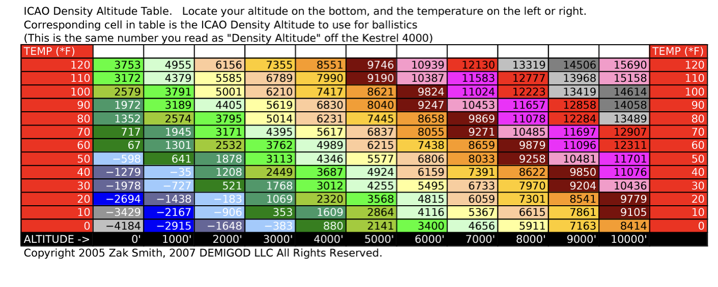

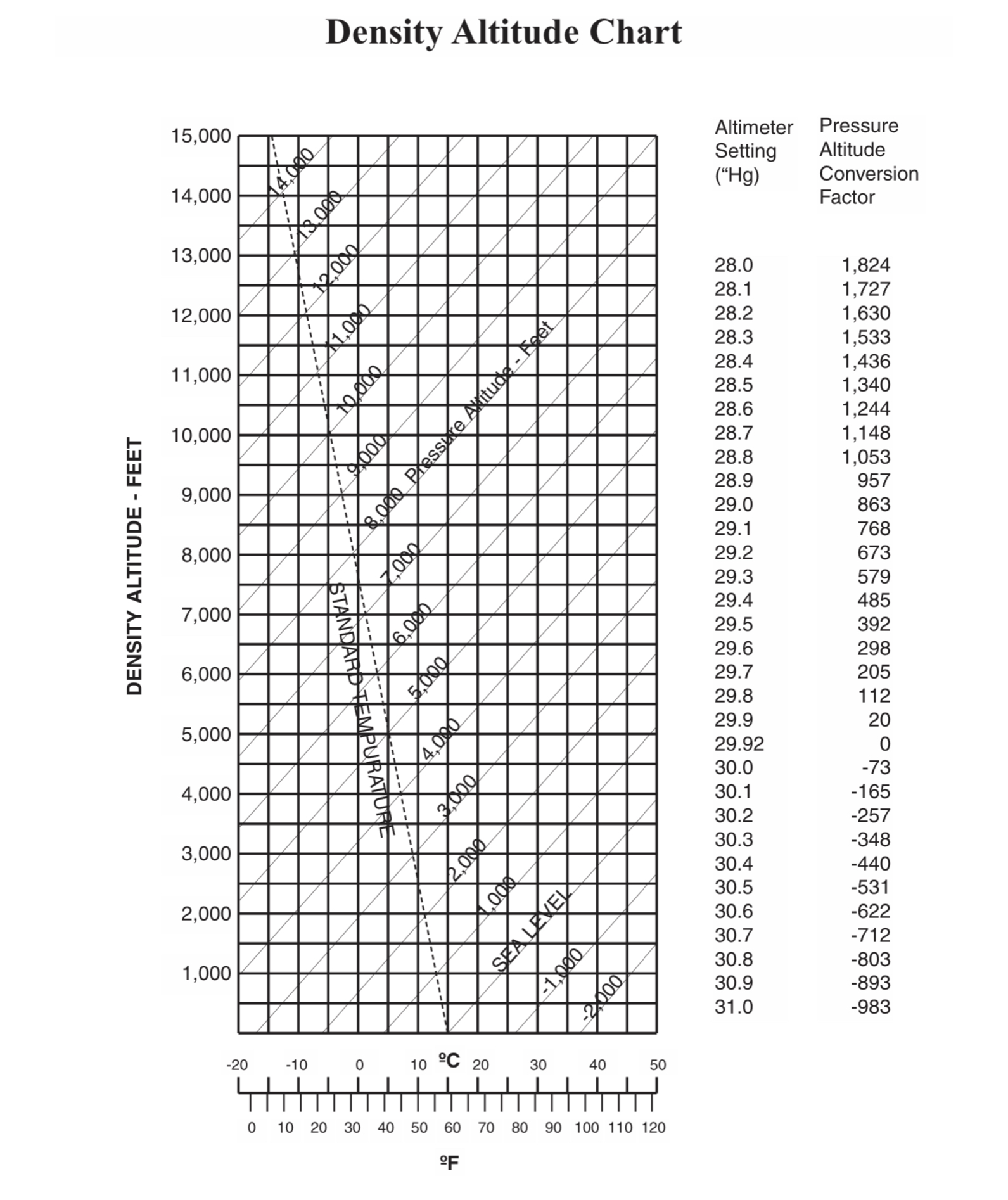

Hello,
I'm looking for an analog way of converting my atomosphric inputs to determine the DA. I have found online converters but I'm looking for something that works independent of electronics and avoids long hand math. Are there paper charts or practical analog calcultors out there that anyone knows of? I've spent sometime looking for them here and elsewhere but I've been unsuccesful in digging them out. I figure they must exist given much of aviation's history predates modern electronics. Thanks for the help!
take your temp and enter the chart there. Go up to your elevation and then go left to read DA. You can ignore the conversion factor on the right unless you are super anal about getting exact numbers, pulse it’s a correction from barometric pressure not station pressure.
the in your head method is to remember DA is standard pressure corrected for non standard temperature. DA increases 1000’ for roughly every 15 degrees Fahrenheit above standard. So using sea level as an example if it was 89 degrees, DA would be 2000’ approximately.

Somewhere along the line I got this. This isn’t my work, but the person is credited in the image.

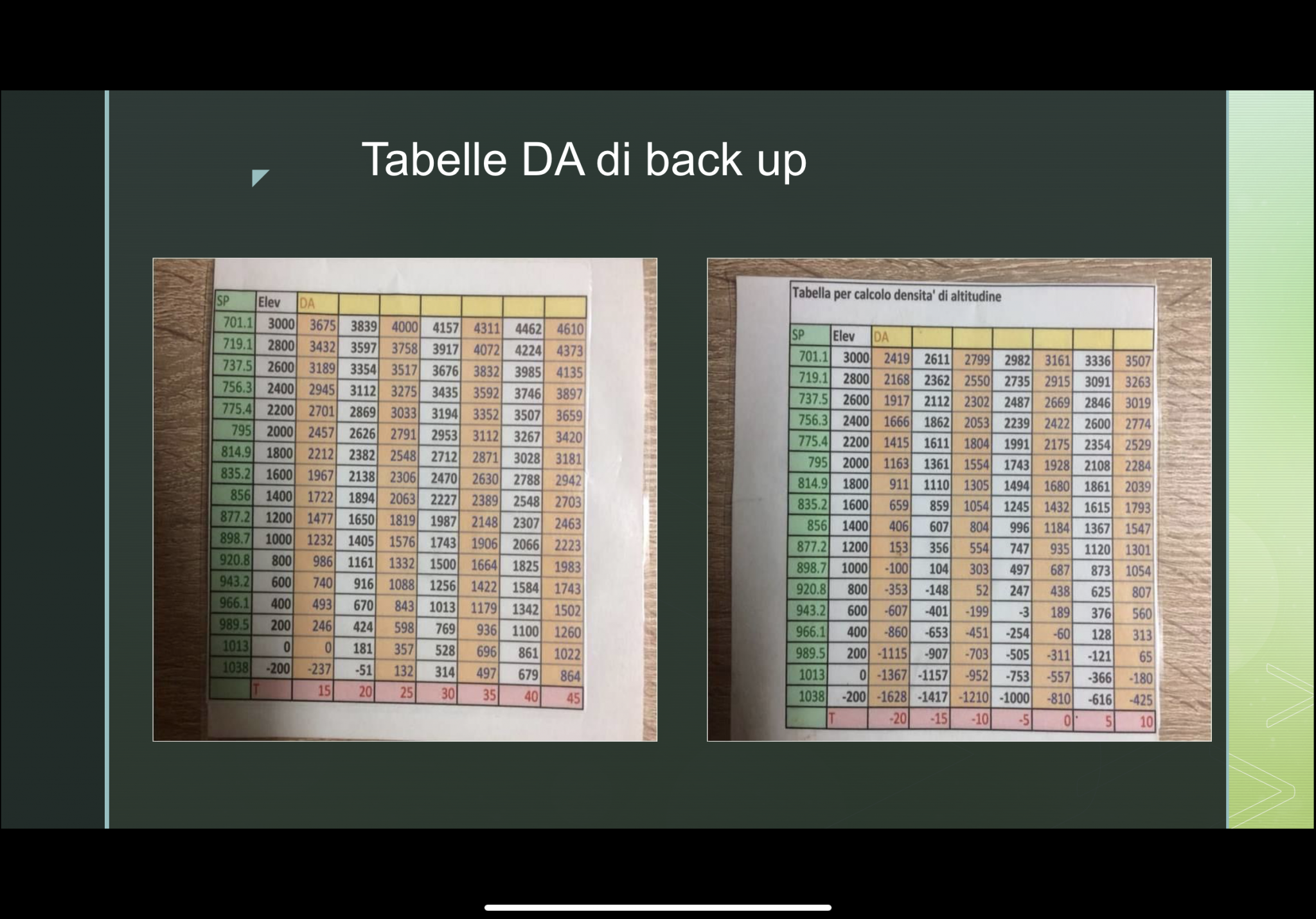

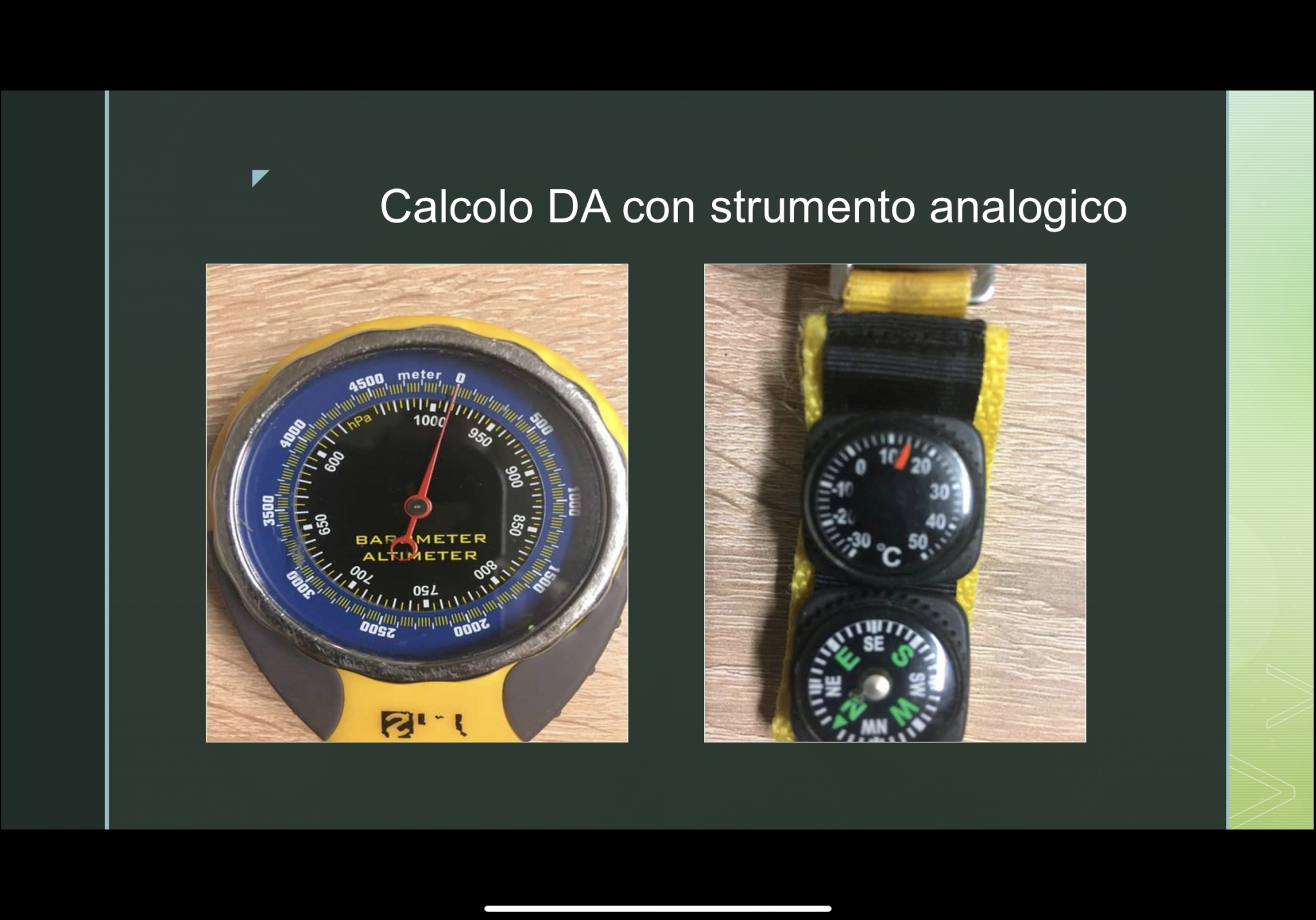

hello, I use this device, is an altimeter with absolut pressure, there is also a little temperature indicator and a compass.
you can have data to use with a table.
no difference with a kestrel
data are in metric, this table are from Field Firing Solution, there is a function to create and export DA table in excel format.

Thank you for sharing, this is an awesome solution! Completely analog from Sensors to determining DA. I like the tables you created using FFS. Might you mind sharing the excel table file? I ask because I use metric too and this table is perfect for my uses.
