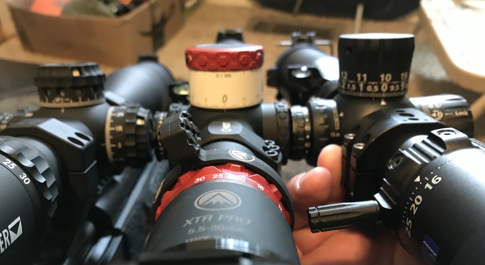

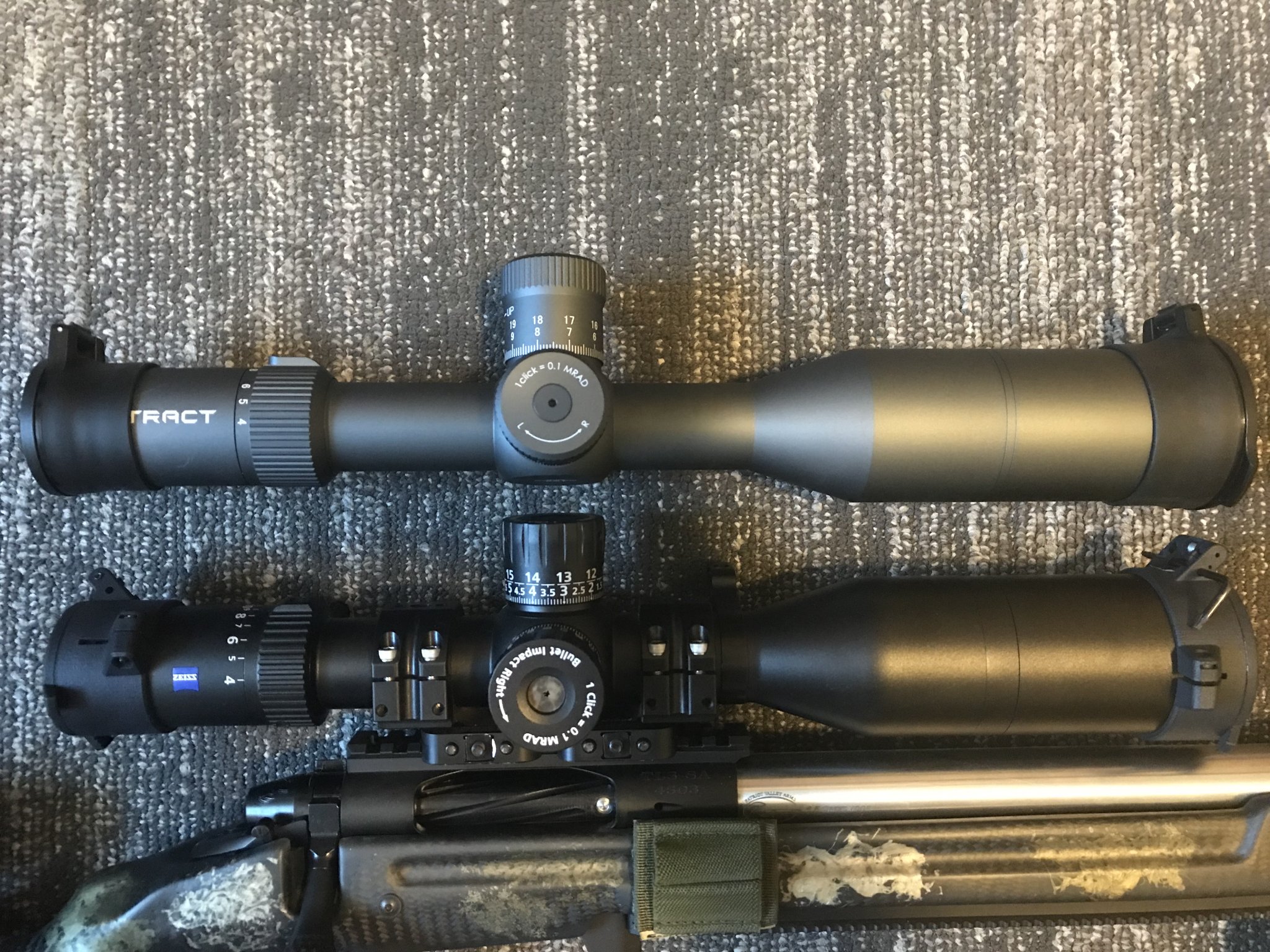

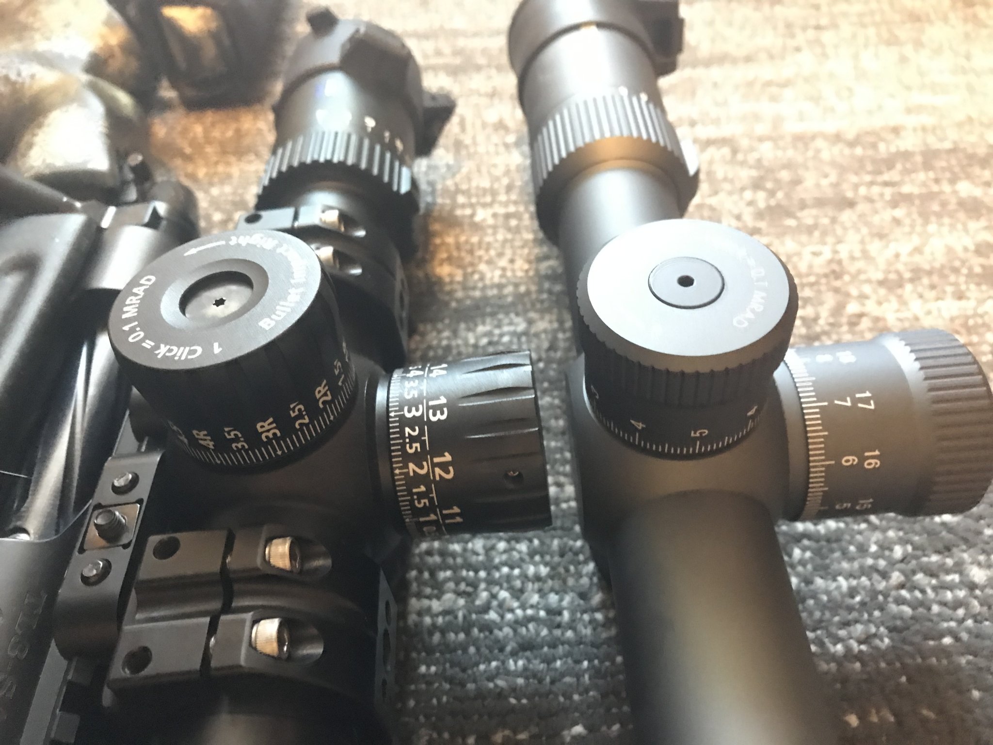

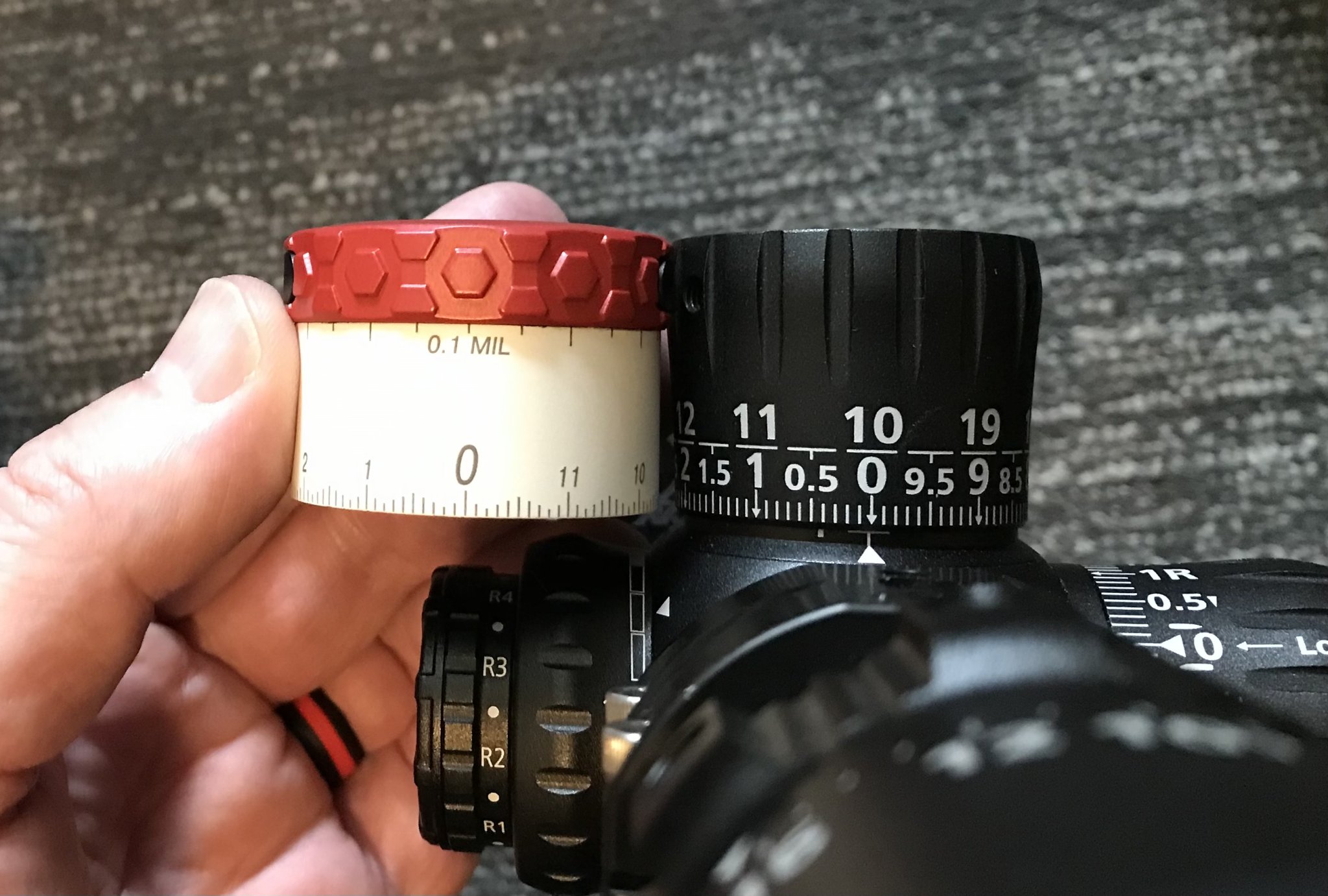

    First the S3 turret is not tall at all. No taller than most anything else in it's category. Below is a pic of the Zeiss and Tract next to each other. The Tract is taller once unlocked. Down below are pics of the Zeiss next to the Steiner T6 and Burris Pro and a pic of the Pro turret next to the S3 as it was hard to hold all three next to each other.
    Now with turrets gone, the glass in the two is very close with a slight edge to the Zeiss. I have used both in matches and they both work fine. Both reticles work well. The Tract fully illuminates and the Zeiss only the center mil. What is the use of the rifle it will be going on?
    You can get some red glare but I only find it if sun coming in from about 4pm position from behind. Never slowed me down in a match though.
