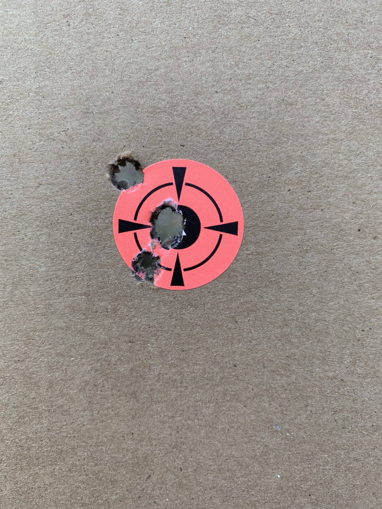

Took a short video of me shooting a five shot group this morning, looking for any feed back, don't be shy. Things I see:
- I lightly tap the trigger a few times before I settle into position, I assume I'm trying to perfect the placement, but once I find it I think my follow through is good.
- The first shot I was clearly not set up right as I reposition, but then I seem to stay in position for the next few shots (this was reflected in the group too, first shot was low and left, the next three literally went into the same hole, and I pulled the fifth, which I felt when it happened but can't see anything obvious in the video).
- It takes me a while to get my hand wrapped back around the pistol grip.
- Bolt manipulation is way slow, wasn't going for speed, but i should have ran it faster.
I had no idea I was doing any of this, except the bolt manipulation, I could tell I was dragging on that, video doesn't lie...

said group, bottom left was #1, top left #5
Agreed on bipod, felt ok at the time, does look high tho. I never would have picked up on shoulders or squeezing grip too tight, will work on those. Thanks so far.
