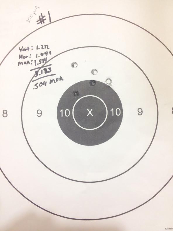

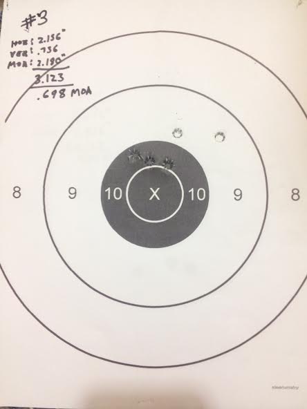

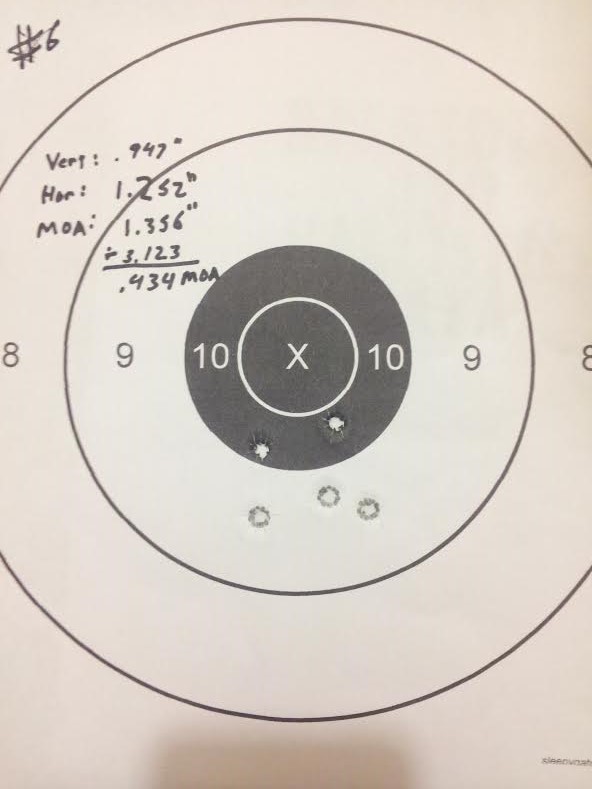

    Second half of my OCW development:
    Low wind, 2-4 mph max.Shot at 300 yards
    Savage 10FCP
    Criterion 20" Bull - 308 Winchester
    NSS Barrel Nut and Recoil lug
    Modded B&C Medalist Stock
    Devcon bedded
    Rifle Basix Sav2 trigger
    180 Grain Sierra Gameking
    Lapua Brass
    CCI 200 Primers
    Varget: 43.5 grains
    Adjusted from .005" Jam into lands all the way to .050" off the lands.
    These seem to show the most promise.
    Target #1: Cool barrel, Low vertical
    Target #3: Warm Barrel, Lowest vertical out of them all, but a lot of horizontal.
    Target #6 is the smallest group and it was shot when the barrel was moderately warm...
    Which do you think shows the most promise... Im not to good at judging these things.

    1st group is .005" jam, "3rd" is .005" off and "6th" is .020" off.
    The first two groups had .8mils of elevation...the last had .7. Overshot my correction.
    My question is which would you choose and why? Go for tightest group or least vertical spread
    Typically, one would go with the most rounded group, but realistically your groups are close enough to be statistically insignificant given the similarity in group sizes you got. I'd probably go with the .020" jump, perhaps a bit less, but the targets say bullet jump is tolerated fairly well and is not going to be a big player given what you've shown. Not sure what your other targets may indicate trend wise.

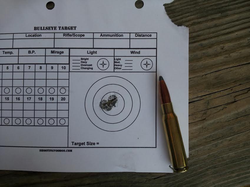

    Update.
    I went with the load .020" off the land.
    Chrono'd 15 shots today.
    AVG: 2544
    ES: 9
    SD: 4.2
    Here is the first group at 100 yards. 5 shots, cold bore. Props to Criterion and sierra...damn accurate hunting bullet.
    :cool:
