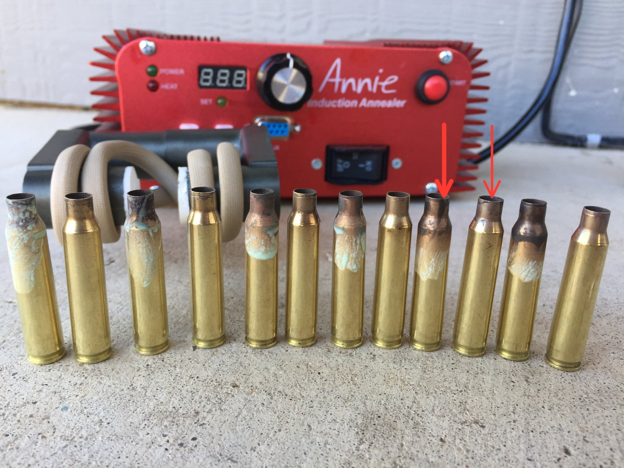

Just tried my first batch of brass with my induction heater and looking for opinions. First off the brass hasn’t been cleaned so that’s why the neck is black but do you guys see anything that looks like I over annealed them? I attempted to stop the instant I saw glowing. I sacrificed a few pieces doing the plier test but can’t tell any difference. Just looking for opinions for safety sake because I really like the gun im shooting them through
Visibly it looks fine but when annealing you should have a way to determine if you’re actually even annealing or over annealing. Something like the AMP obviously tests this. I use tempilaq for my bench source annealer.
It’s hard to tell just by looking at the brass afterwards. Different brass will discolor differently as well. My Lapua vs my Nosler brass is visible different when annealed even though they’re annealed to the same time/temp
I don’t see anything to suggest you’re over annealing
Thank you and I ordered so 750degree paint today for the future. This is all Hornady brass so I’m trying to get everything right before I use high dollar brass
The 750, I do a small stripe from the neck down to just past the shoulder. (It’s thick in the pic for demonstration purposes way back when)
I like to vary how deep into the shoulder vs the neck I center the case in the coil to try and time when the green chalky tempilaq turns to a clear liquid closer between the two, the neck will always turn first.
I like for the tempilaq to just turn clear below the shoulder, the necks get hotter, the shoulders gets to the 750 base line which is equivalent to what I think many argue the necks needing to get to 1k are after.
An example of the 750 turning clear just below the shoulders. Go further and it burns further down and turns and really nasty black goop that’s hard to steel wool off clean.

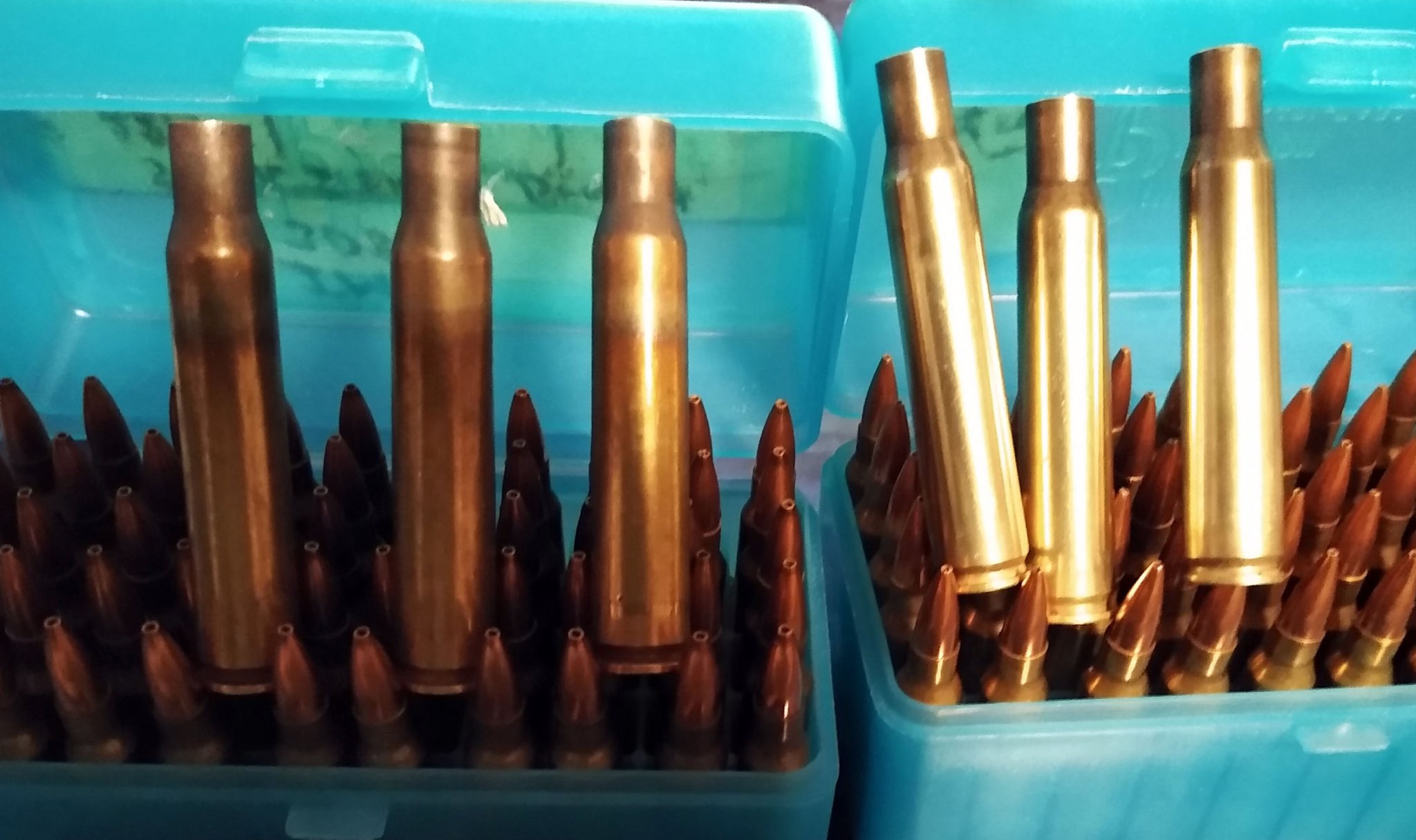

Two cases at each time, a tempilaq and unpainted, to show you can’t judge by looks alone. Cleanliness of the case has a lot to do with it.

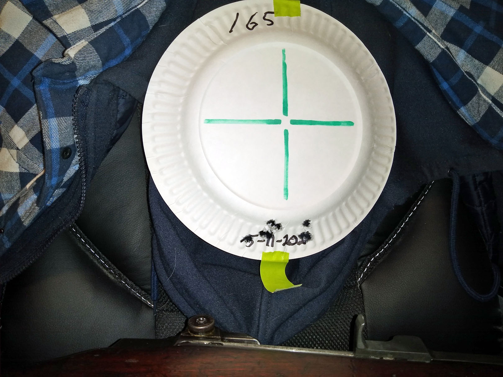

When I tested mine I used brass that was fired about 3-5 times. I loaded 5 rounds into that brass. Then annealed using the same method as I use currently. Loaded 5 rounds into that brass
Results:
Not annealed: almost 3 inch group at 300 yards. 30+ fps spread
Annealed: 1.6 inch group at 300 yards 19 fps spread
5 rounds per group.
This is what I did to determine if I was actually making any difference aside from tempilaq and everything I read about annealing

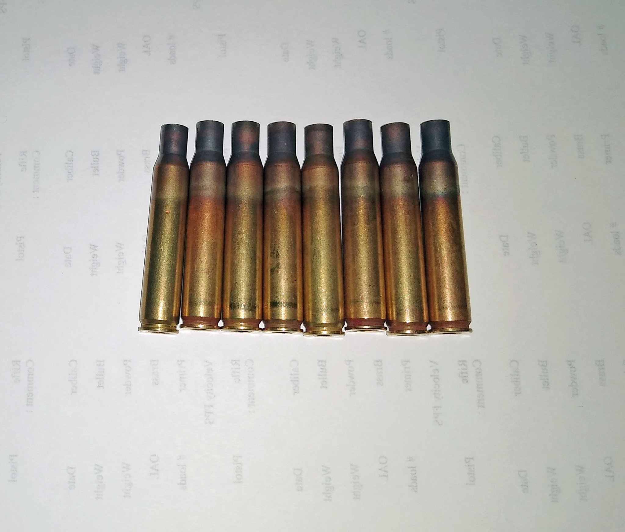

I set up MY annealer after changing the clamp and torch head . I also ran numerous test cases noting TIME rather than color ,of all calibers I reload for ( 17 ) . Then after verifying on an HV tester adjusted those time tables better .
I use an Annealeez modified ,NO earthly reason to put out ridiculous monies for an AMP machine . One can make a Really Good water cooled 1200-1400 watt , water cooled induction heater for perhaps $350-550 or less .
A close friend of mine made a very nice water cooled induction heater , he did the electronics ( his thing ) I supplied copper tubing and an extra Bernard SS circulation tank pump , off a GTAW /Heli Arc machine I had lying about . He mounted the whole affair on one of those 36" Rubber Maid polyurethane rolling carts . Has extra shelves underneath it's sweet ,was going to 3D print a trap door with a timer . Never heard whether he did ,as we moved .

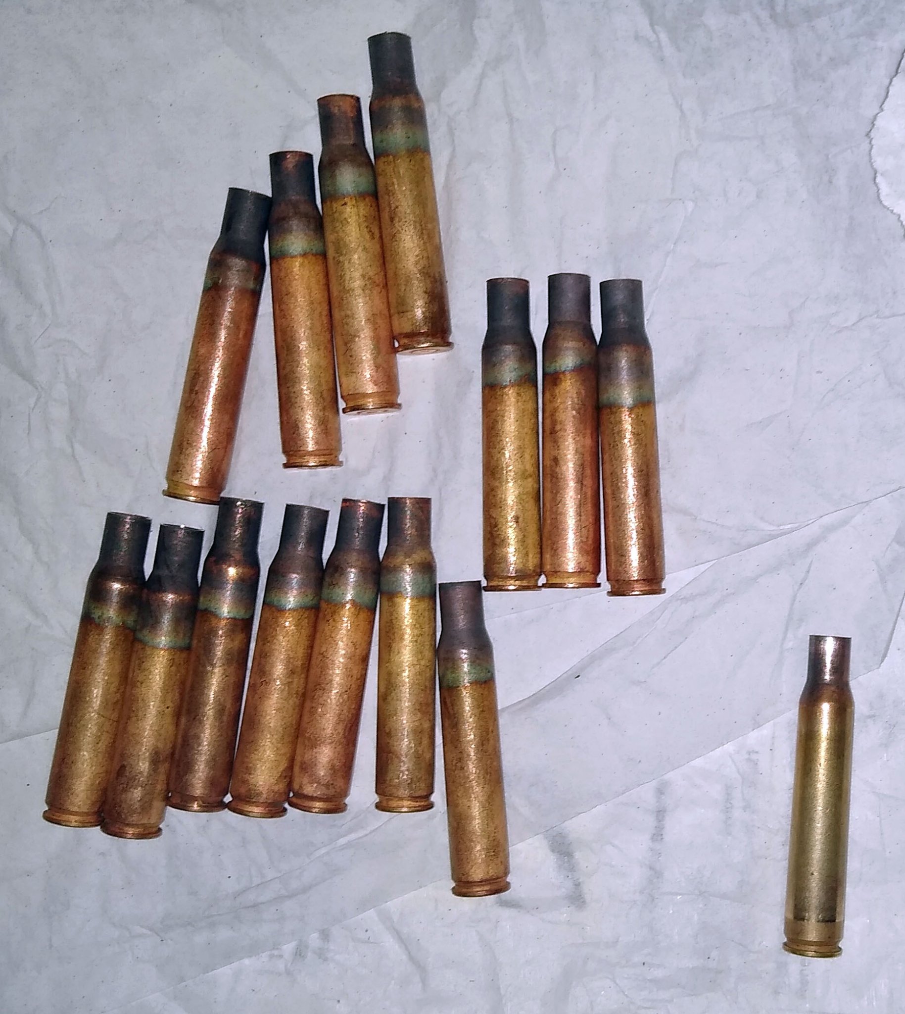

I don't quite go this extreme of Orange but close and I personally don't see a problem with how this fellow is doing his . I just try to replicate Lapua's witness marks and don't go too far down past the shoulder. The Body isn't where I want the heat ( Right or Wrong ) it's working for ME .
I do have access to super sophisticated Lab analysis equipment and checked ALL MY reloading cases on a vickers scale aka HV hardness tester . I worked nearly 24 years in Aerospace ,as a PHD. , R&D Chemist/ Composites Fabrication Engineer . What I didn't know ; I ASKED PEOPLE WHO DID KNOW . Then verified info by testing .

AMP hits about 1400°f. We understand just fine. Nothing happens to brass at 400°f for the length of time we’re subjecting it to.
Reactions: Holliday and Ex E6
Unless you get it hardness tested it’s hard to say how well it’s annealed? However if you see it dull red to an orange? Its annealed. And consistency is key. You don’t need the hardness testing done. That’s just be for piece of mind knowing you hit the optimum a hardness testing however let’s say instead of the 90HV you were 115HV. While it wouldn’t as good? It’d still relax the grain structure enough that you don’t have to worry about your second reload cracking a neck. Secondly, hitting the correct hardness of annealing doesn’t guarantee the best results. There are some I’ve read using an AMP and stated their accuracy was off. However if you’re consistent in what you’re doing and accuracy is good then I see no issues. Annealing brass is simply for longevity. Not accuracy. Consistency just ensure a constant neck tension throughout.
You are absolutely correct neck tension consistency is what's important . Now this will hurt peoples feelings : All MY brass I've tested ,New , once fired or partial annealed , vary in various spots on the neck . It's the nature of the beast .
It most certainly will extend case longevity .
NO one not even factory brass manufacturers are actually annealing brass cases ,it's simply a misnomer or mis stated phrase for " Partial Annealing " . As NO grain structure or lattice appears ,we reloaders are simply resorting ductility or malleability .
IF one puts a piece of brass in an oven say at 800 Deg. F. , after about 30 Minutes it will be truly annealed ( depending upon size of brass ) but a cartridge case will become totally worthless . Heat in excess of 400 Deg. F. to the body and especially the base will ruin any cartridge case . Those areas MUST REMAIN HARDENED ,so as to withstand pressure . Again proving Time with Temp works either for you or against you .
Partial annealing does happen at higher heat and less time duration . 750 -900 Deg. F. isn't enough , IMO but 1200 Deg. F. is . As to a long a duration time Heat begins to migrate down the body of the case . So as precision a flame one can muster ,aimed at the shoulder flowing onto the neck and as it begins to glow orange is enough . Measuring neck temperature accurately is beyond any reasonable control ,it happens too quickly and flame is present or an induction coil ,so measuring is dicey at best .
Partial annealing takes seconds not minutes or an hour and does restore ductility . HV about 115-124 ,after one sizing stroke . I've tested all of the calibers on Mine .
You know when people tell you " If you got your brass neck orange it's ruined or over annealed " , Total Bullshit !.
NO ; dezincification WON'T happen unless chemicals are present . Ammonia ,Vinegar ,Citric acid and so many more home cleaning recipes can and will cause that . IF not thoroughly neutralized . Any strong oxidizer, acid or even saliva will contribute .
The only practical way zinc come away from copper cartridge cases is by MELTING them .
To over anneal Brass is to melt it . Brass must be held at TEMPERATURE AND TIME ,for true annealing and NONE of us can do that .
Note what AMP states : At 400°C (750°F) for one hour, the neck was annealed to an average of 117 HV mid wall and 83 – 89 HV at the edges of the neck wall.
1400F? No it doesn’t. THAT would be OVERANNEALED. Max annealing temp for cartridge brass usc2600 is 1291F.

I was going to show various witness marks ,contamination from chemical partial annealing Etc. . :(
Some partial annealing of 7.62X51 cases ,as well as 5.56X45 . After some time and flame adjustments ,I was able to match Lapua's witness marks . I've never been successful at partial annealing any case and not having it darken ,the heat simply makes it happen .
One can however polish the cases to remove 90+ % of it ,so not the end of the world or a deal breaker .
The photo Raw annealed , note the green haze left after partial annealing ,due to MY error in leaving cleaning solution on Brass and not rinsing and neutralizing same . Case in far right corner of same photo shows all cleaned up well and were quite usable .
