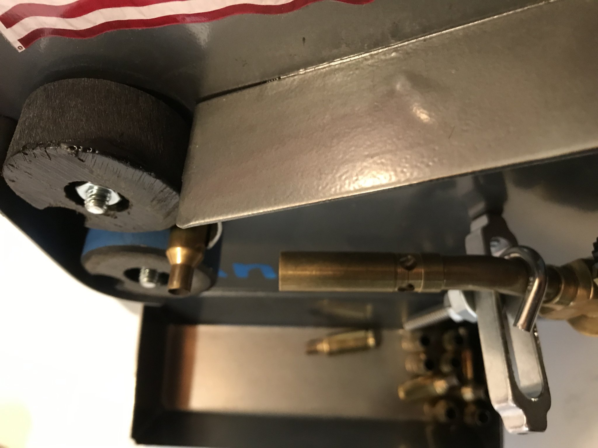

YES, I didn't think about it when I tried for the first time to anneal
my 6br brass. Had been doing 6 creed and adjusted the flame to the shorter
cases. Burned the edge of the wheel so bad, it got soft and left some of the black tar like on
the cases. I just took wheel off and thinned it down some. Didn't ruin any cases, just spent
more time in cleaning it off half dozen of them.
Probably the half ass way of doing it, but worked.
Reactions: 260284

Sheldon, I did that. The 6br case is so short it still got the top wheel hot enough to
melt it a little, so I just trimmed it down a little to fix it. So it will still
hold my 6 creed and 6br cases.

Let me know if theirs something you see that I don't.
You can see from the (crappy photo) how close the shoulder is to the bottom wheel
and now that I took a little from the top, it's down from the shoulder.
Should I slide the torch all the way to the cabinet? Still might have a 1/2 inch of room.
I kind of keep mine positioned there anyway, and just rotate it out for longer cases.

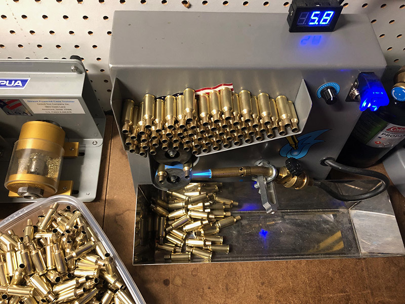

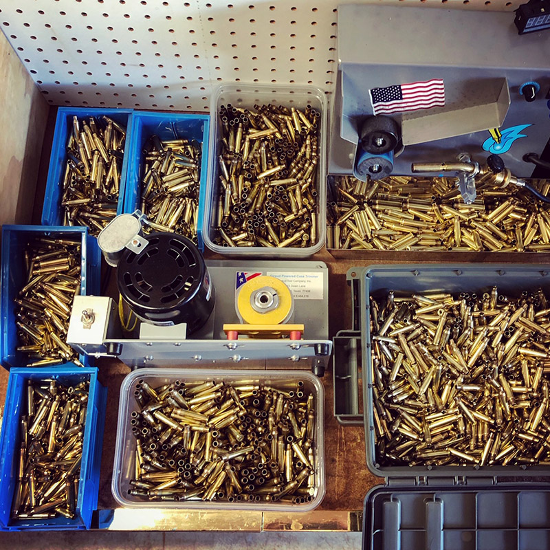

I have no doubt that other machines/methods are better, for any number of given reasons. Speaking only for myself, I have to have an auto-feeding one. I do other stuff while the cases are annealing, and I would find it a hassle to have to attend it constantly. I don't even have to watch it as long as I'm hearing a consistent plink of them falling into the pan.
ooooh, shiny! Are those pin tumbled or agitated in corn?
what is that digital readout you have on top? And can you share which regulator you have? I’ve read some threads on mods but most seem to be rather difficult.
It's a small volt meter I got off ebay, something like $10 or $15 if I remember right? It connects to the wires on the motor control and gives you the ability to repeat speed settings over time.
The regulater is a Goss, I think it was about $85 with the gauge. I'm using the stock torch but had to modify it to get the flow rate to work (pin size drill into interior of valve).
A bit of tinkering to get it all set up, but has been going strong for a while now and I'm really happy with how it runs.
Reactions: FishDr
