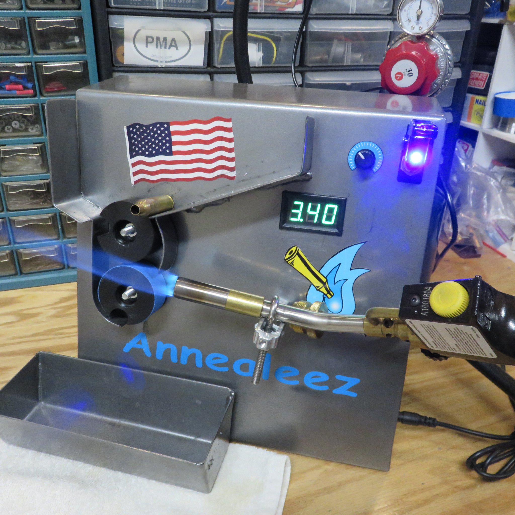

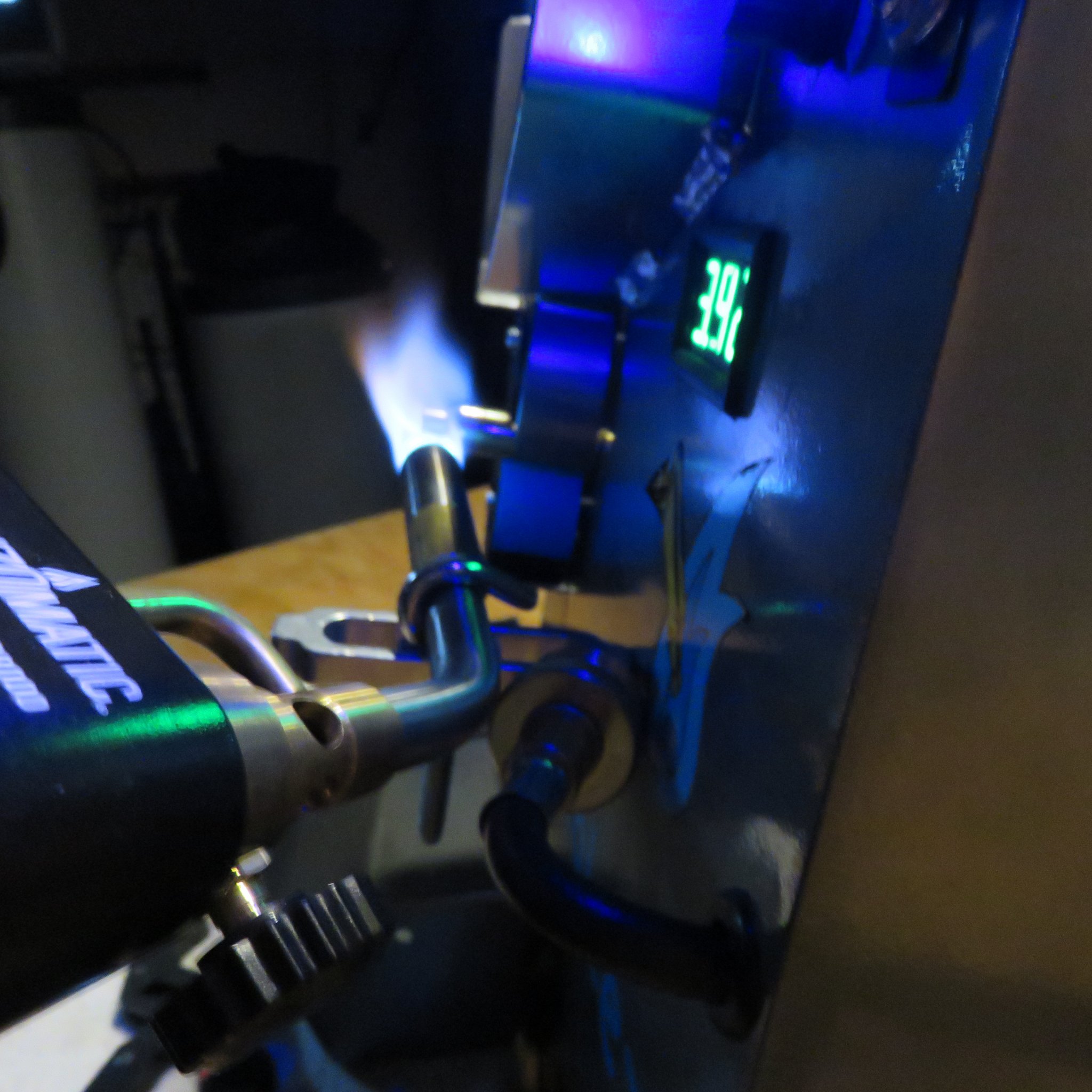

To be sure to avoid any melting of the wheels, I angle the flame where it's not parallel to them, but is pointing away from the wheels (like from the inside towards the outside of the machine). The flame is still on the proper area of the cases . . . just at an angle. This was only a particular issue for me when I changed to a somewhat large swirl flame torch head. Also, as you can see in the pics below, I'm using a regulator and I found that the regulator didn't really change anything with regard to the flame except to keep it consistent over the time it took to anneal all my brass. I don't do shorter cases like 223's and my wheels are the standard size ones.

Yes, I very well know it's a swirl flame torch head and I chose it on purpose replacing the pencil flame head that came with the Annealeez. I find it does very well for me the way I've got it set up. I have a swirl flame torch head that is small and can work will with the smaller cases and narrower wheels. I was after a more intense flame to speed up the annealing process to help minimize the amount of heat traveling down the body. This works quite well for me.
