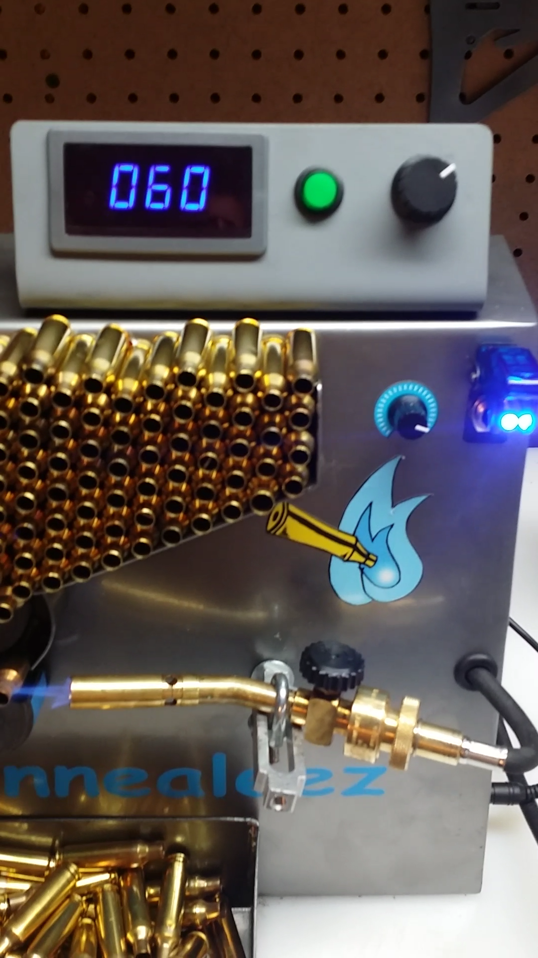

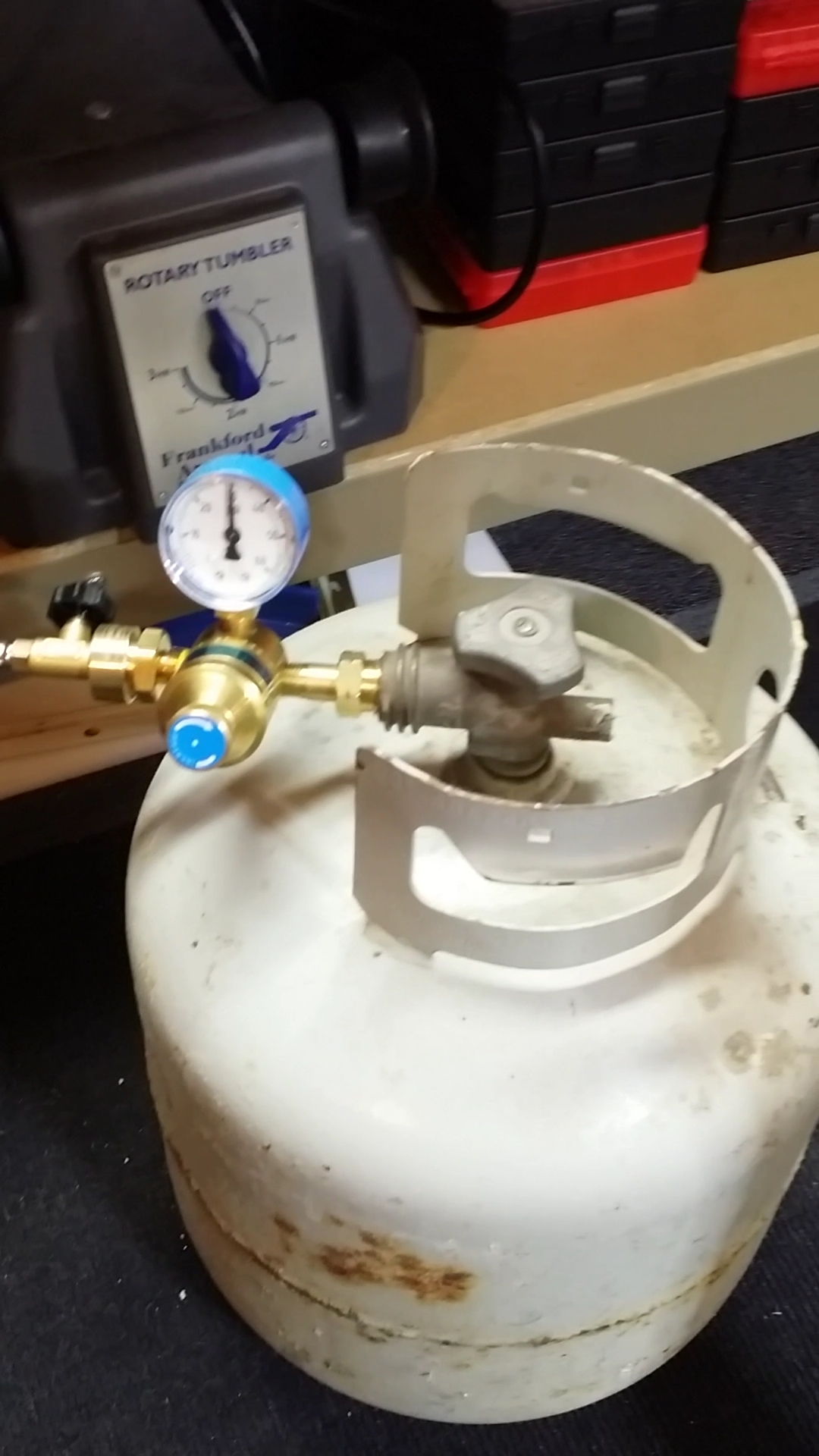

Annealeez with a goss ep70g regulator a pwm if you want numbers to reference in the future , to make setup faster. Also a couple Mr heater fittings so it can be run off a grill tank. Super consistent and still under 400$
The bench source was like $150 more than the annealeez with the modifications. Most importantly the Annealeez is automated the bench source you have to constantly reload the table. That is a time killer . For me that alone rules it out.

Normally it's set up in the garage shop . Irregardless I don't watch every piece being annealed. I set the regulator at 30psi and set the pwm for whatever brass being annealed. Other than that I load the hopper whenever I notice it's getting low. Loading individual may work if you are doing small amounts but I wouldn't consider anything but automated for larger batches .

Once I learned the machine and it's nuances, I've been able to get very repeatable and consistent results without the regulator.
I run a 5 gal on the Bench source and no regulator.
You can use the little bottles too.
