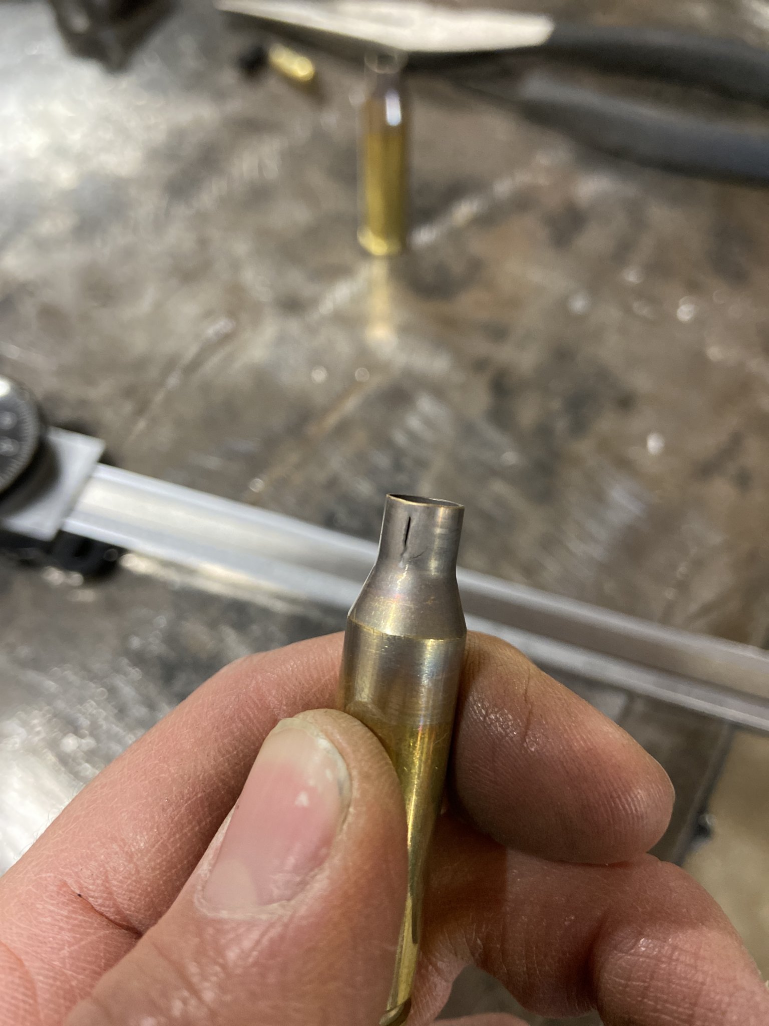

I got 11 firings out of my 260 rem Lapua brass before I got split necks. Also by that time a lot of the primer pockets were very loose. (LRP)
