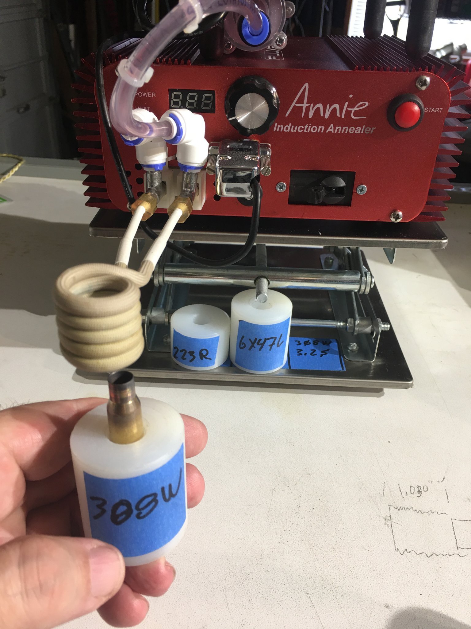

I am looking to purchase an Annie. What could setup so you recommend? Water cooled setup versus the ferrite coil setup. Why one way versus the other? Any help would be greatly appreciated. Pictures of setup would be awesome.

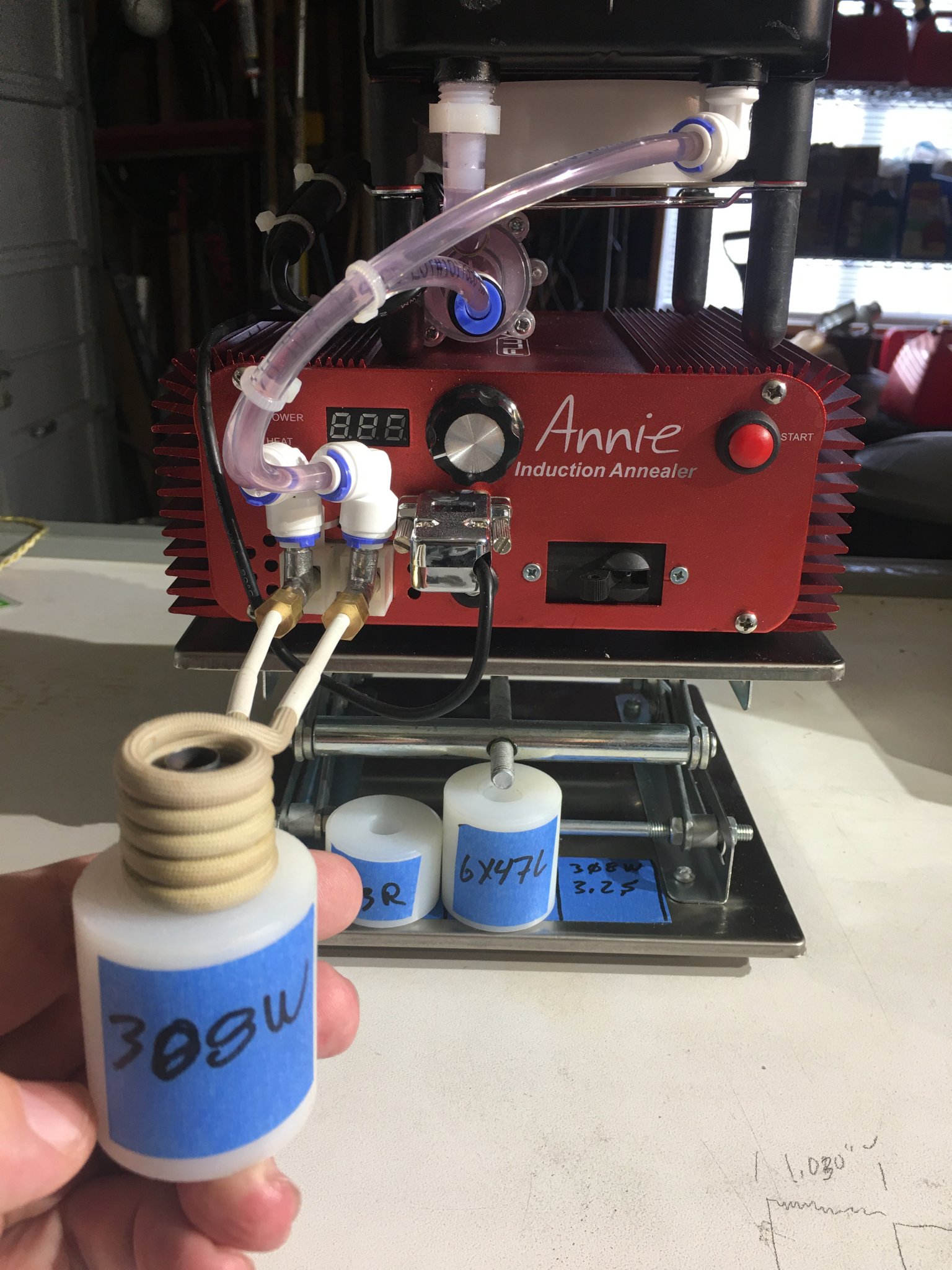

I, on the other hand, went water cooled. I'm a bit of a gear hear. Made Delrin (?) holders for .223, 6 x 47L and .308W. The process is really quick, works well. I have no doubt that going air cooled as Spife suggest will work just fine for you.
BTW, if you have any problems, don't hesitate to contact Garrett. He's a standup guy !
