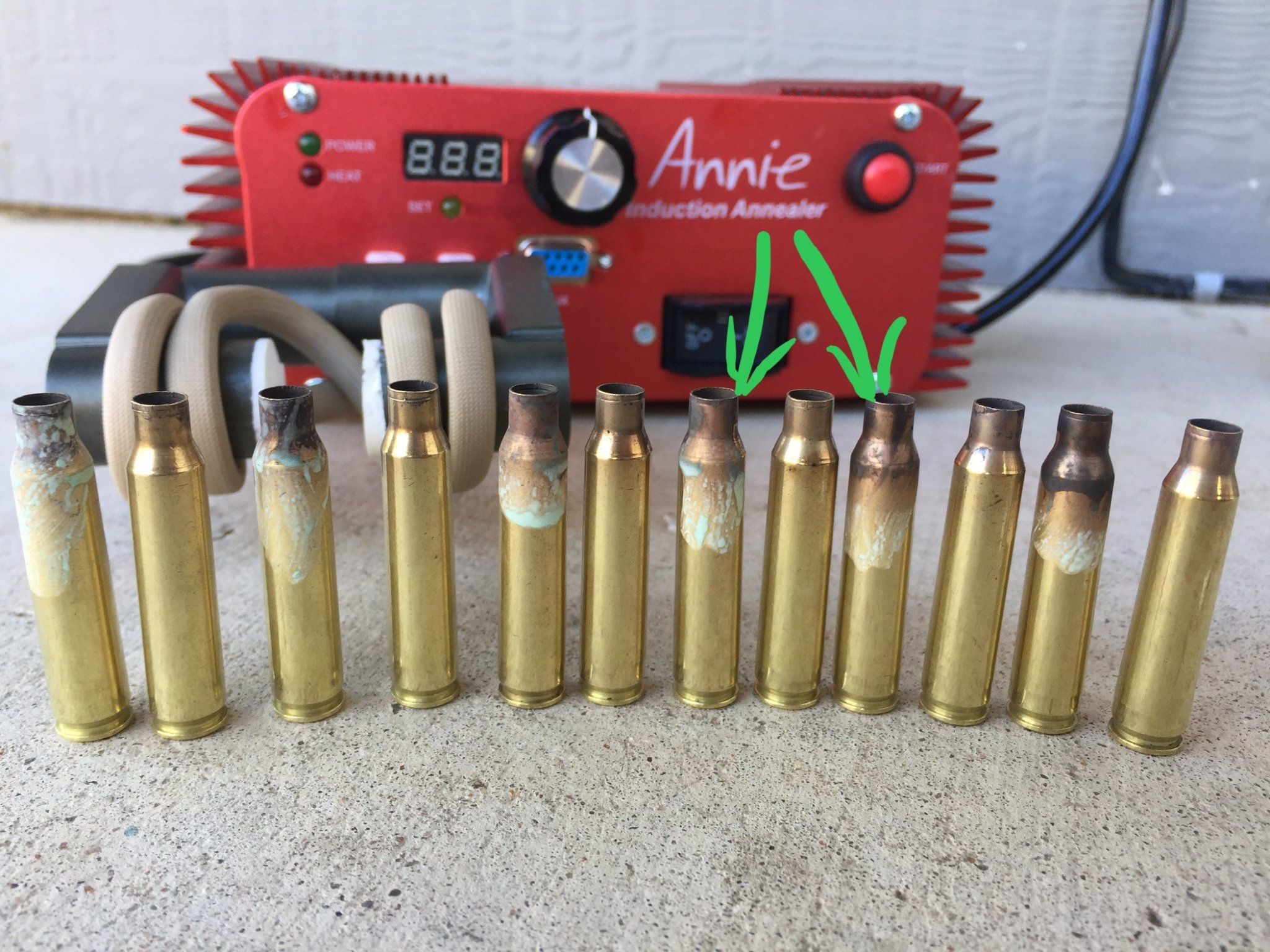

Get some 750 tempilaq and a bottle of thinner. Once the tempilaq gets almost empty it’ll have started to dry out a bit with lots of goopy dry stuff so just pour some thinner in and shake it up and it’ll redissolve some of that build up, it’ll last a long time like that.
Put a thin layer of tempilaq on the outside of 10 case necks and let it dry until it’s powdery looking.
Grab some scrap brass to run 10-20 cases through to make sure it’s hot.
I don’t have the water coil but with the normal depending on how deep you position the neck and shoulder in the gap will vary how much energy goes into each and thus how soon or late each will heat with respect to each other. I like to keep it around the shoulder-body to mid shoulder in the middle so that a bit more energy goes into the shoulder which has more material. That’s in an effort to have the neck and shoulder turn the temp close to each other.
And then start with a creed case at 2 seconds and see what you get. Then 2.2. Then 2.4. At some point when the tempilaq starts to go clear (and then black if you keep cooking it) you will know you hit your temp, I go until it just gets started down the body a smidge. Do a couple more to verify and you’re done. The necks will always go before the shoulder though, can’t help it but that’s alright.
Steel wool 0000 will help you clean the tempilaq off those cases, scraping with another cases rim helps too.
In between these two examples with the green arrows that were .2 seconds apart is where I would try to set it at.
There is a non lacquered example case next to each to show that you can’t tell on bare color alone.

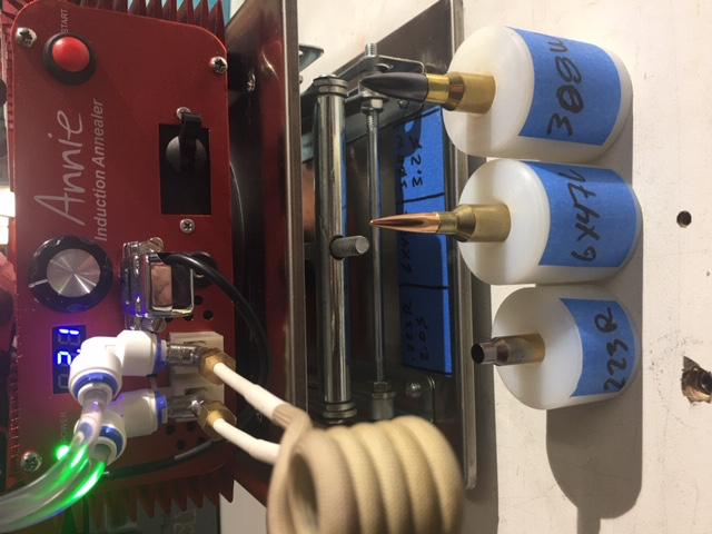

In lieu of the drop table, I made these Delrin shell holders. I just load a round of brass into the proper size holder, run it up under the coil until the top of the holder hits the bottom of the coil and press the start button. Simple and works like a champ. (loaded rounds for visual representation only......).

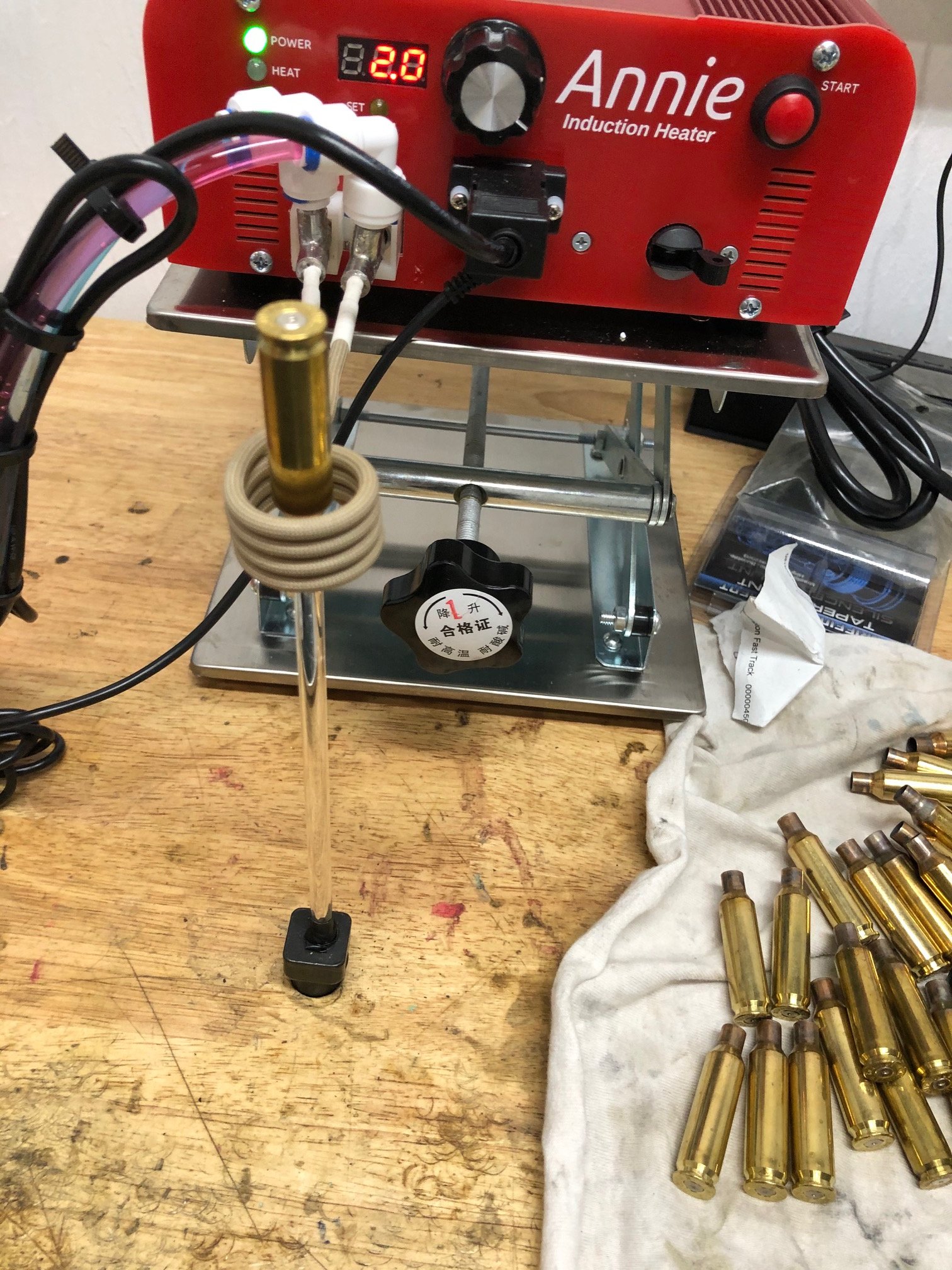

I think the glass tube ideal I seen on another forum is the best ideal yet. You get a solid glass rod smaller that bullet size and mount it to the surface. Glass rod needs to be cut to right size to allow upside down case to sit at the proper coil height. Put case on glass, annel, remove case with your hand.

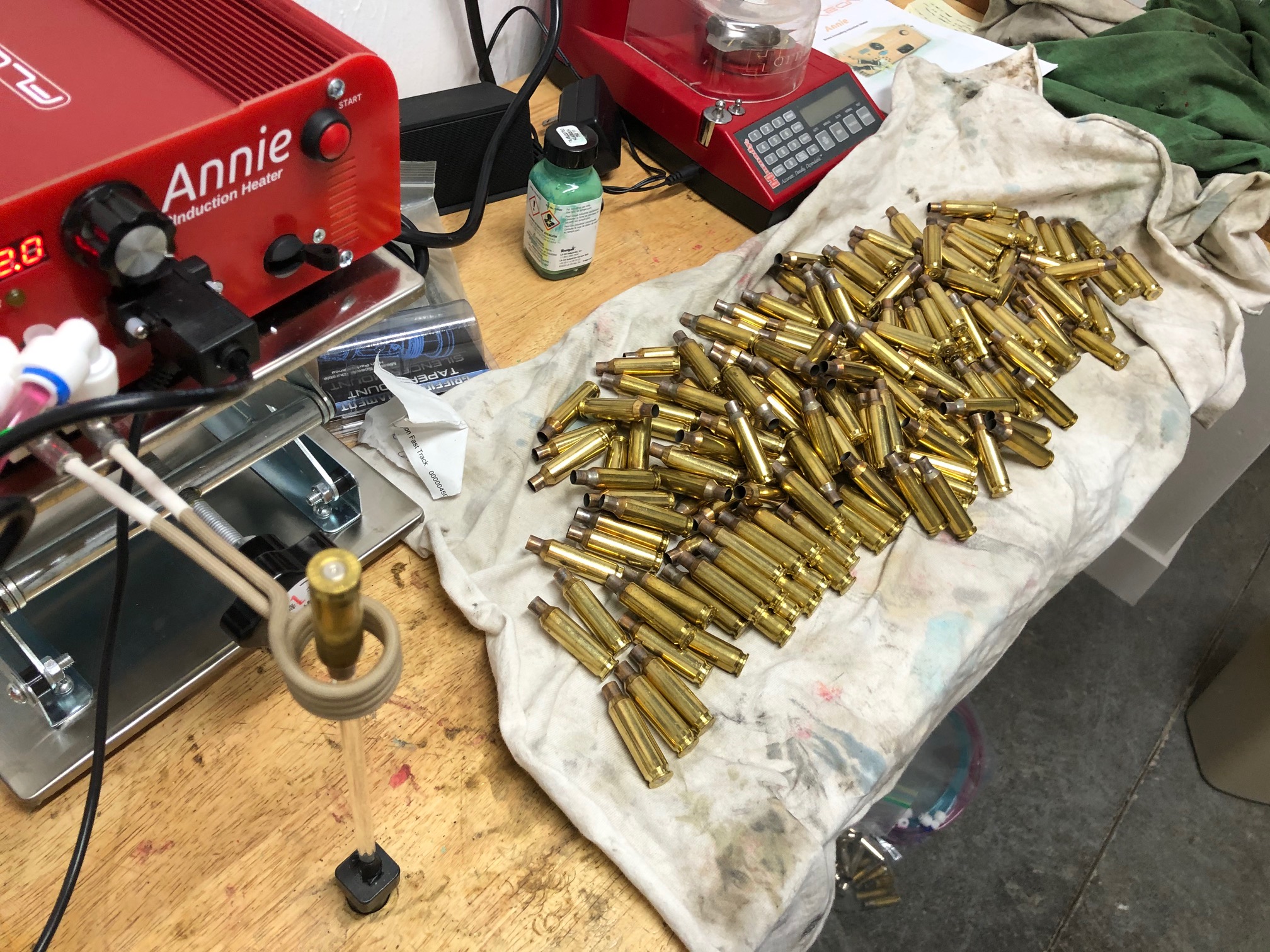

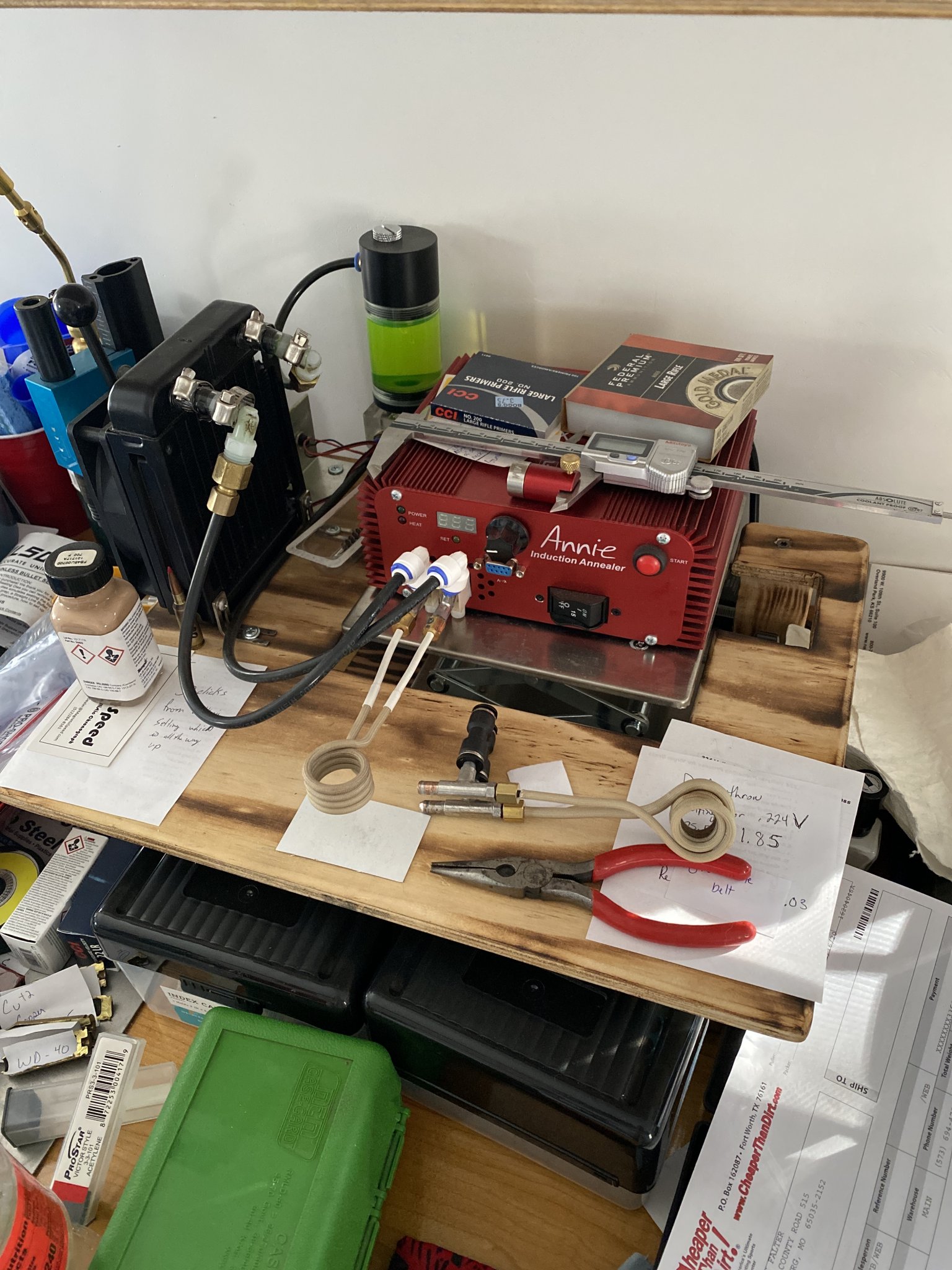

Just annealed 200 cases of 6.5 creedmoor with the Annie. Went through them really quick and am pretty happy with it. I got two coils with it, large and small. The small one is plugged up and water wouldn't flow through it. Must be some solder stuck in it when they built it so I was stuck using the bigger coil. I think the smaller could would be better for 308 class brass. Tested with the tempilaq and ended up using 2 seconds for the Hornady cases. This stuff is kind of an ass ache to use as It really never went clear. At 1.9 seconds it was still kind of green and 2 seconds was pretty much black.

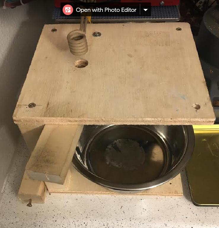

nice setup. mine is not nearly as refined. I only use 3 legs (removed the one in the 430 position) to allow a larger space and easier access for a metal dog bowl. I also offset the hole in the table top, allowing the leg in the 730 position to act as a 'stop' for the trap door.

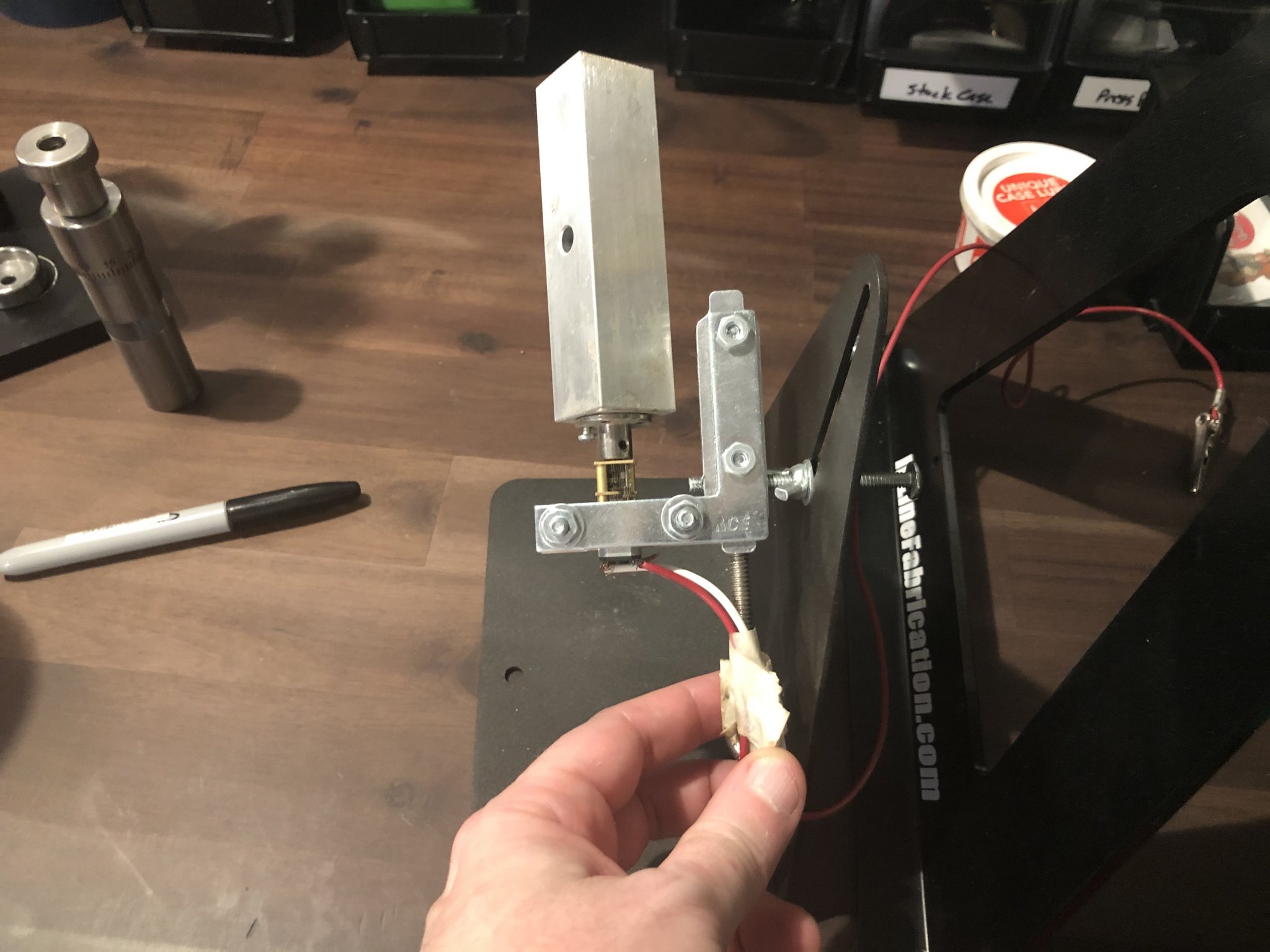

Here's the basics:
- Started with the Anneal Rite stand and torch holders, though if you have time and a little skill, you can easily make alternatives.
- Modified the case holder by adding a bracket and electric motor so it would rotate - this is pretty important. Powered using a 6v battery (one of the big flash light ones)
- I set the torches such that the very ends of the flame meet where the case holder/case will be. This means it takes longer for each case to heat up, but I find that to be an advantage (except from a time perspective).
- I have a metronome app on my phone and used that for basic timing.
- Drop a case in, rotate it into the flames
- I aligned the case height such that the flames hit in the middle of the shoulder taper
- As the appropriate time approaches, watch closely at the base of the shoulder for the color change. Because it is heating slower, you have a bigger window for consistency.
- As soon as the color change progresses past the shoulder, dump the case out.
Pic of the main mount and case holder:
