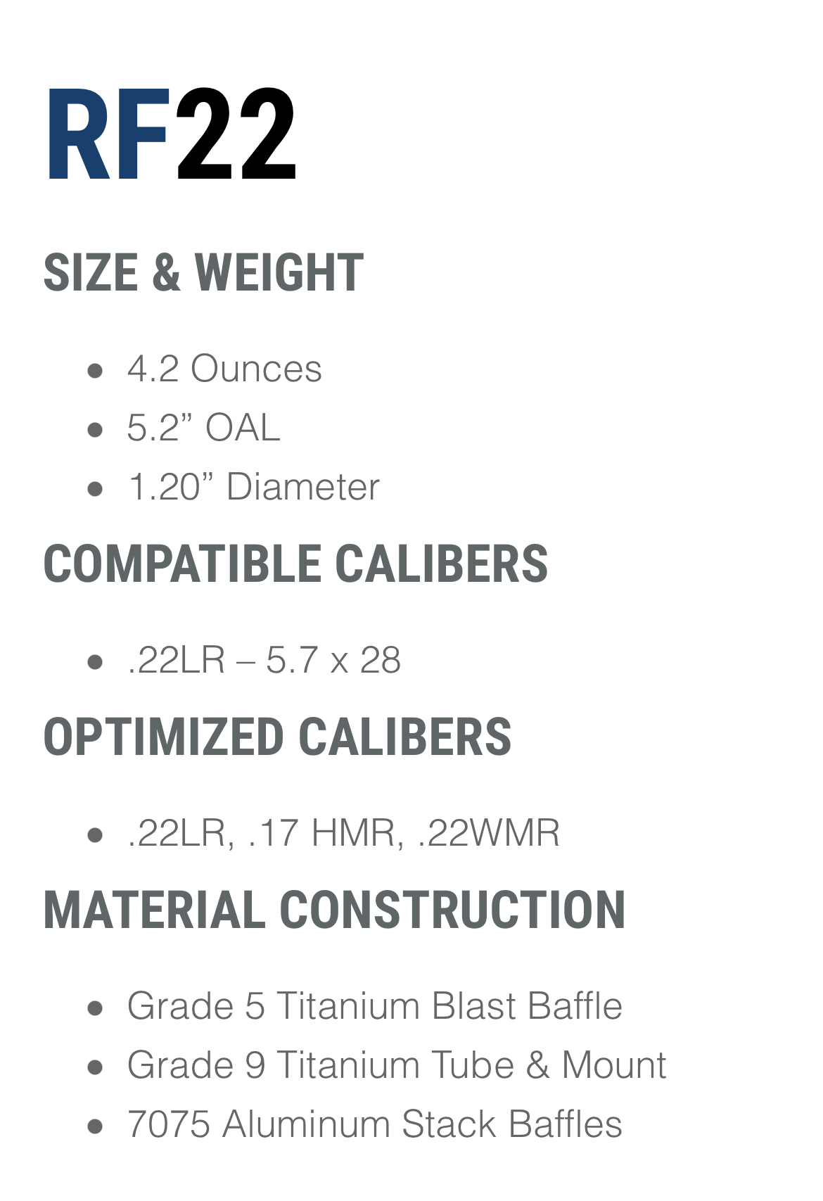

    Group buy pricing: 10% off for individual suppressor purchasing
    R30K $855.00
    Rf-22 $405.00
    Combo $1190.00 15% off for the combo
    R30K $807.50
    RF-22 $382.50
    MSRP:
    $950.00 R30K
    $450.00 Rf-22
