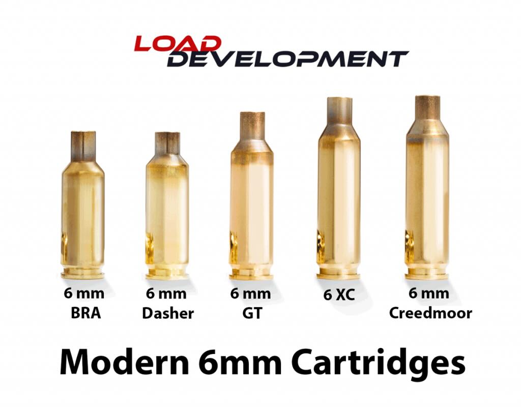

I'll chime in with the results of some of my research, but zero actual personal experience.
The 6 GT is a tweaked version of the Dasher that has a slightly longer overall length. The goal in doing this was to correct the feeding issue. Essentially, the cartridge is now long enough so that the bullet is in the mouth of the chamber by the time the mag lets go of the base.
Ballistically, the GT and Dasher are pretty much the same with the GT having slightly more powder capacity. Both seem to be very easy to achieve great accuracy out of. Your assessment of less recoil and less cross wind performance is pretty much also what I have read. Especially compared to the 6 CM. They can shoot the same bullets, so the real difference is how fast you send the bullet out.

I’d say the dasher is less recoil for equal performance in reasonable winds.
If you have to have factory ammo then stick with the creeds, everything else would count on loading for, just do to periodic unavailability.
But I would leave the tikka a 6.5 and make the custom a dasher. You’re gonna like it.

Comparing some numbers from Hodgdon: (Dasher vs. GT, Varget, 107 Sierra MatchKing)
Dasher:
31.8 gn Varget2,916 fps51,900 CUP
GT:
34.0 gn Varget2,909 fps61,800 CUP
So, dasher gets you to the same velocity using less powder and at lower pressures.
The main marketing point for 6gt was the lack of a need to modify standard mags to get it to run reliably. There are guys who change their setups for the new thing for a competitive edge more quickly than others, who stick with what they already know works. Dasher is very very popular, but requires investment (reloading, buying specific magazines, etc)

6 GT definitely seems to be superior to Dasher in repeating guns and by extension PRS. Dasher was designed to be used in single shot guns, so feeding wasn't considered. The 6 GT was designed by GA precision, a maker of mostly repeating bolt action guns, for use in PRS style games.
The benefits of Dasher or GT over Creedmoor is simply that they are less powerful. This means
1) longer barrel life
2) less recoil
3) less powder usage.

That's something to consider. The way I read it, 6 CM should be lighter recoil than 6.5 but still heavier than 6 dasher/GT, right? Being able to buy factory ammo is a benefit, but I'm also debating if, I go to a 6, if I should just go all the way so I'll have a perspective from the opposite end of the spectrum. Part of this build, I think, is a valuable chance to try different stuff from what I've got already - hence why I'll likely be chasing a different brand chassis, different trigger, etc.
Yes 6 CM will have more recoil than the 6 Dasher/GT, simple physics. Same bullet being pushed faster via more powder = more recoil. Should be a little softer than 6.5 CM depending on load.
Honestly the PRB link you have in your first post spells it out... Any of these calibers will be competitive. The fact that 2nd and 3rd place were taken by guys with 6.5 CM should tell you something. (Your skill is the weakest link in the system)
Correct me if I'm wrong, but it seems like you don't really want to spend all the additional money and time at the reloading bench for a specialized cartridge. That's why I say 6 CM.
The BR/Dasher/GT stuff is cool though. Just be prepared to expand your current reloading equipment, time, knowledge, etc. (which is half the fun, if you can afford it)

Everything is a trade-off. There's no one correct answer when it comes to cartridge selection.
6mm and 6.5mms certainly get the job done in PRS. It's the little nuances between the two that have their own balance of benefits vs compromises, and it all depends on what you want to achieve. When it comes to pure "competitiveness", cartridges in both calibers are incredibly effective for PRS comps.
If you want a 6mm for the sake of trying something new, I would definitely say go for it. You can always have another barrel in 6.5 Creedmoor as well. Which 6mm is up to you, there's a lot of great choices. Depends on what projectiles you want to shoot, what velocity, barrel life, whether you are willing to fireform or not, etc.
Swapping to a 6mm isn't going to suddenly make you more competitive in PRS. Plenty of comps are won with 6.5 Creedmoor still. I wouldn't do it for that reason. But just to try something new, it could be a lot of fun. After shooting 6.5 Creedmoor for a lot of years, I swapped over to 6BRA and I absolutely love that little cartridge. I still enjoy shooting 6.5 Creedmoor and have a couple of barrels chambered up in it, but my 6BRA is just a fun little cartridge to shoot and easy to reload for.
Another factor to consider is where you are located.
I know guys in the western part of the country who deal with more wind have moved back to the 6.5 to help with the wind. Like in CO, ID, WY, Etc…
I know guys who shoot heavy 6.5, 150smk and 153 Bergers, at like 2600fps and they have great splash and really easy to spot trace.
If your more eastern and not dealing with a ton of wind all the time maybe 6mm is better for you.
Just a thought
Reactions: _Thor_ and kthomas
Thanks for all the advice everyone - I'm leaning towards a 6 dasher or 6 GT at this point. I'll definitely need to improve my reloading setup and practices before that, as my 6.5 CM reloads are not up to snuff. I think before I fully pull the trigger on a 6mm, I'll try to get my 6.5 CM reloads at least as good as factory match ammo. I'll probably be posting in the reloading forum to improve my current methods.
