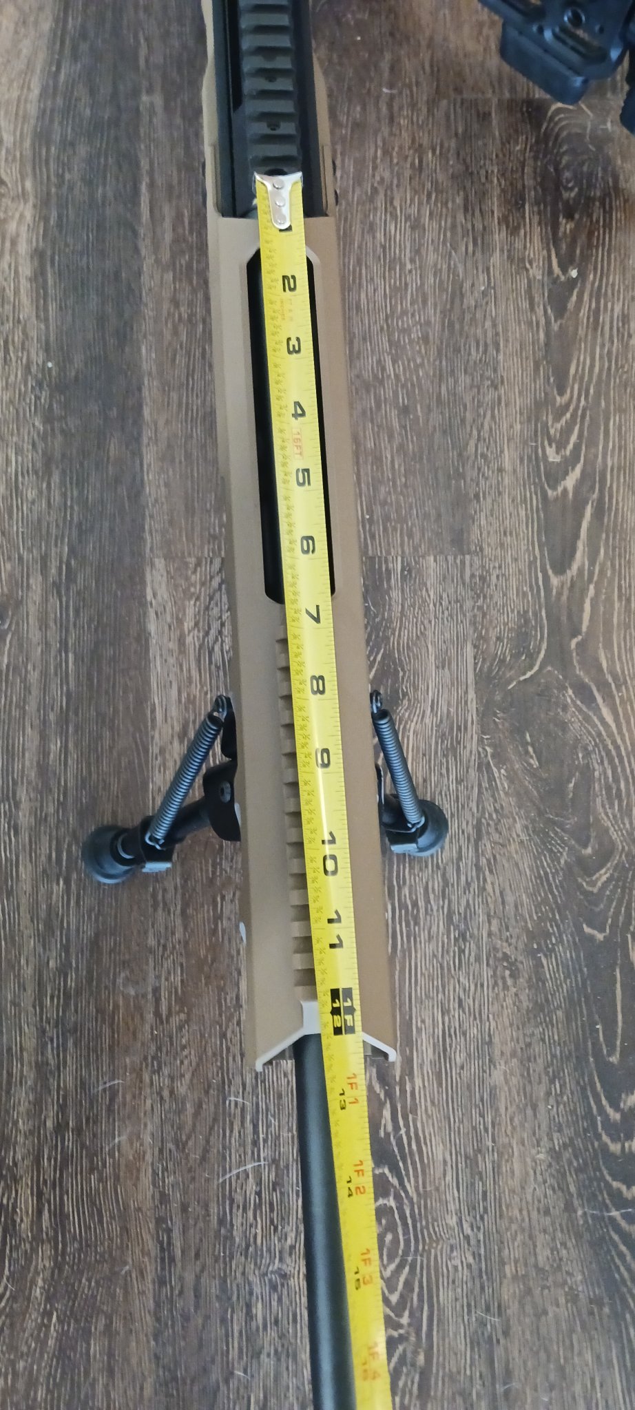

can anyone with a tikka t3x and krg enclosed forened tell me the length of the forend from the end of the action to the end of the forend (or effective minim barrel length)?
Thanks y'all
I believe that the enclosed forend is 4" longer than a standard forend. You should be able to calculate from that.

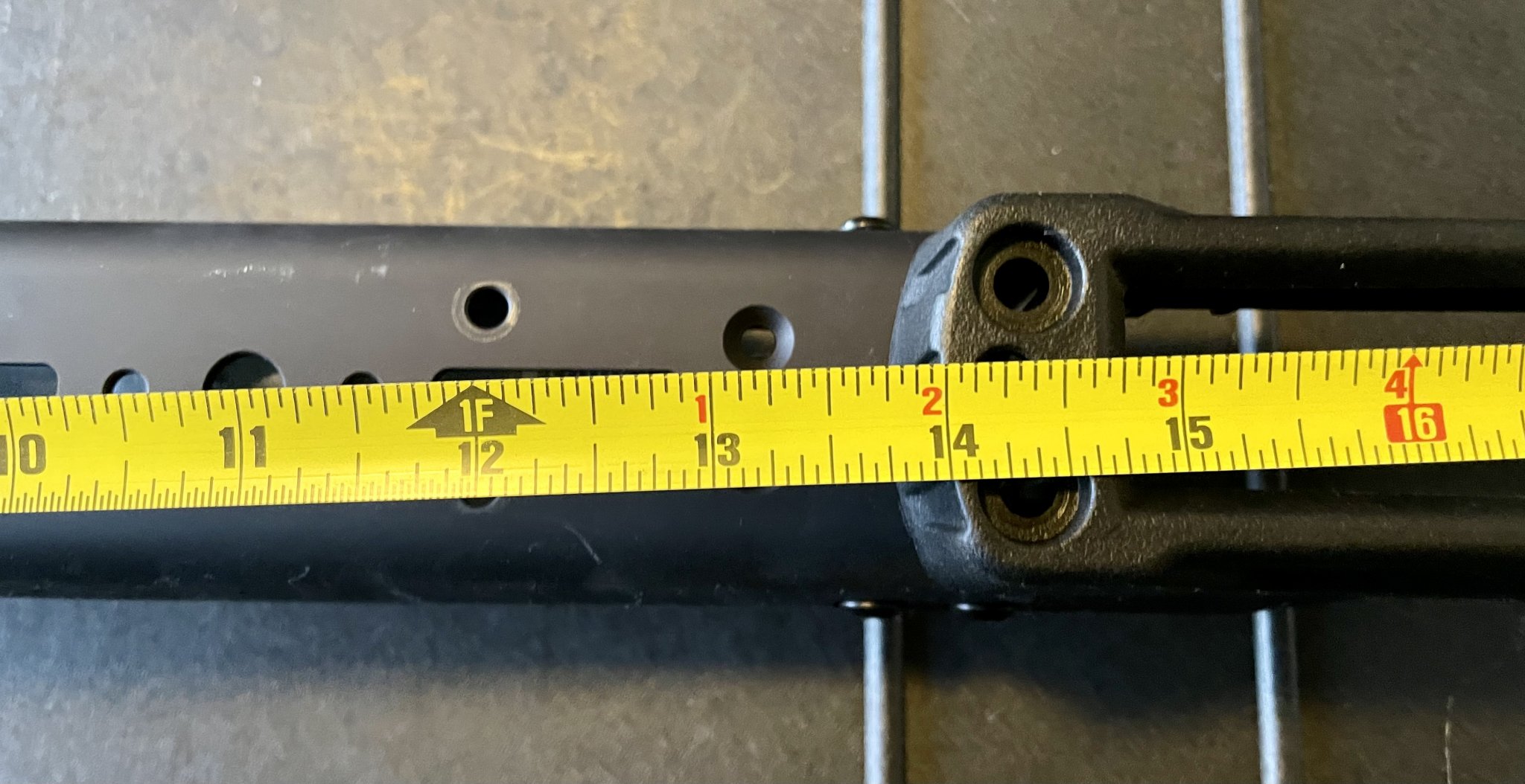

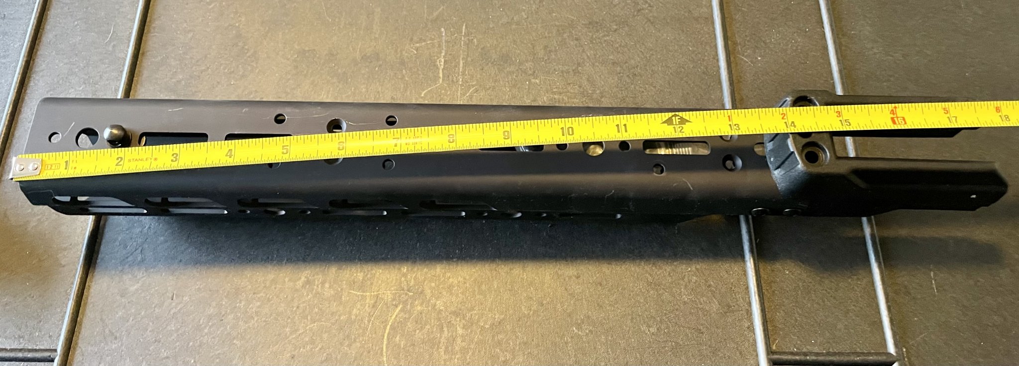

I don't have an action on hand yet and was wanting to go ahead and get my barrel chopped before it gets here. I remember seeing a ~13.7" measurement somewhere but cant remember where i found it or if that was from the action or total OAL of just the forend.
Don’t have the Tikka but I have an extra forend here to measure from the end to the mounting screw holes.
HTH
…. One-handed-photo on the run
