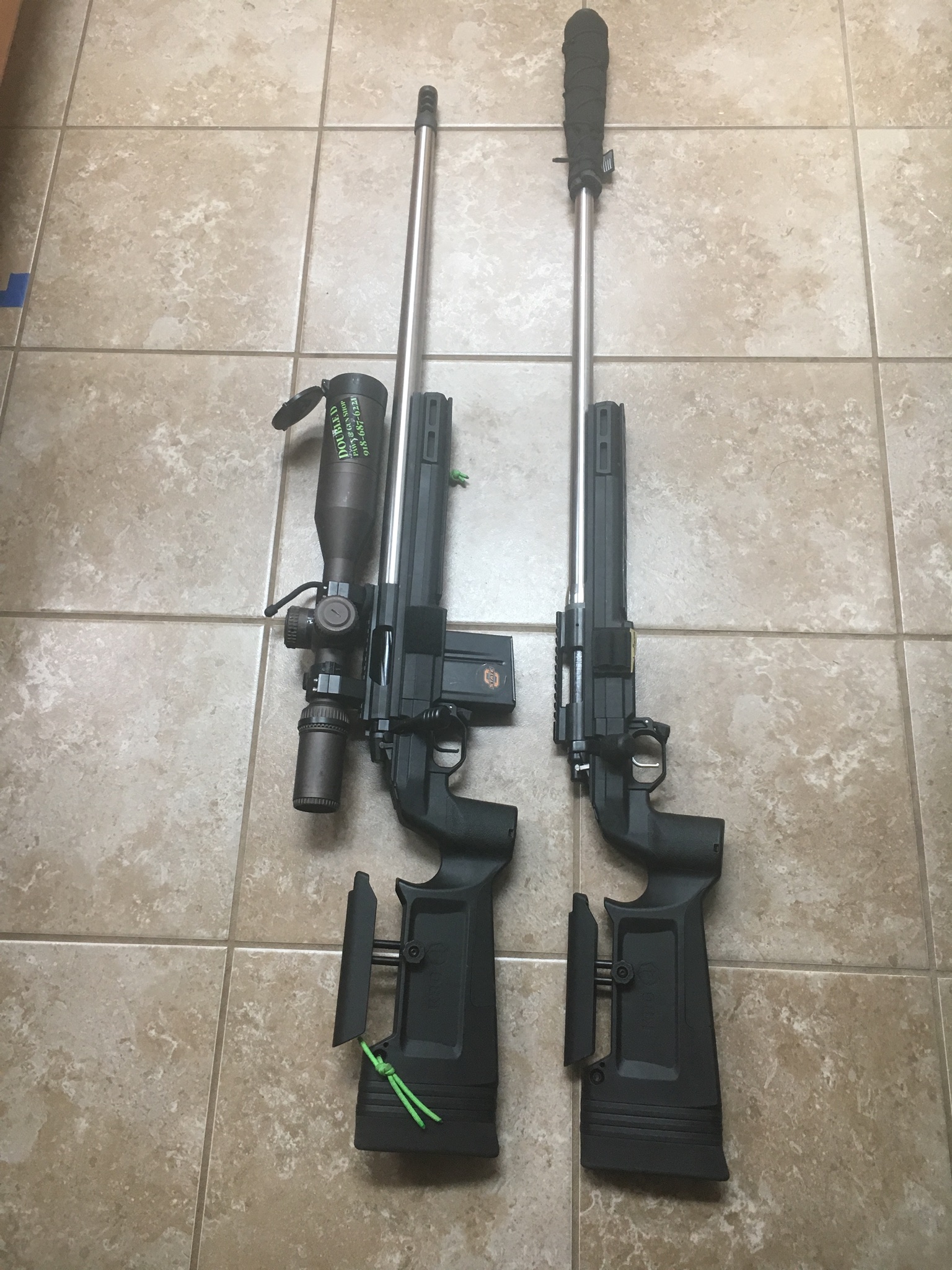

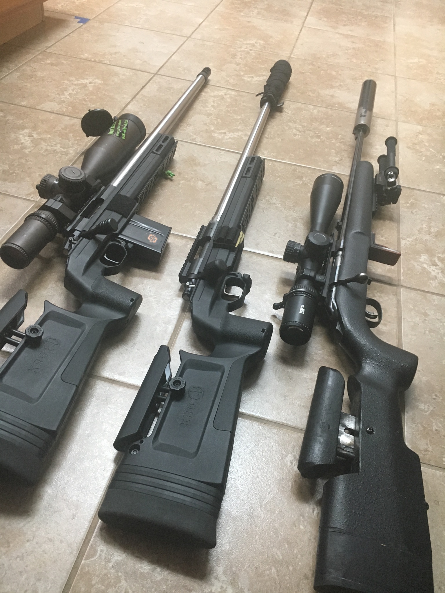

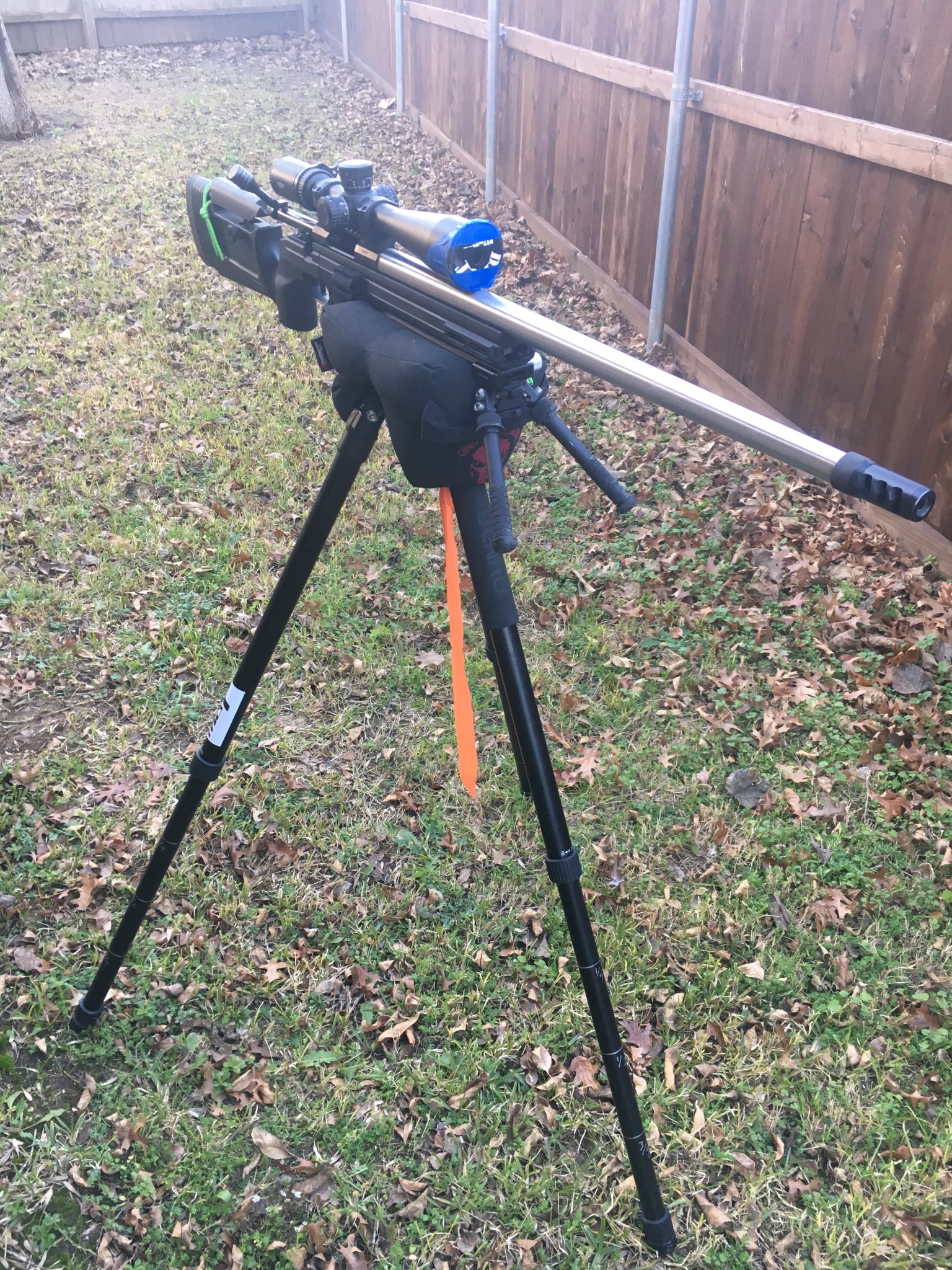

    Nice bro! Sounds like a bitchin setup. Are you running a Chasis?
    Yeah it’s a pretty sweet setup been running a KRG Bravo and it works great and is priced really well for an entry level chassis I’ve been running the ARCA rail which I can switch my bipod back and forth as well as run it on my tripod. I’ve got my first rifle a trued Remington 700 I’ve built in one as well.
