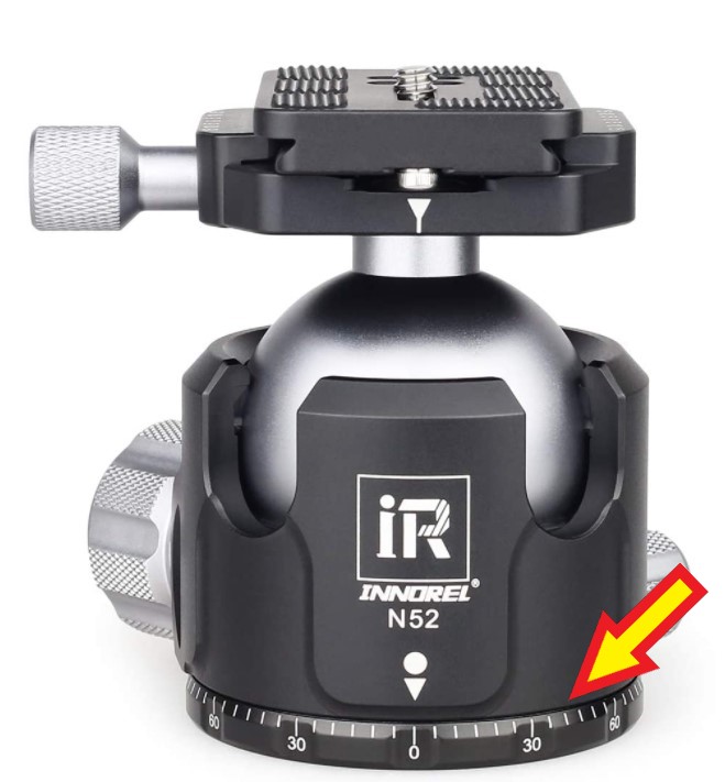

Got my son an Innorel ST344C tripod with an Innorel N52 ball head for Christmas. of course we had to make sure it arrived in good condition so opened them up to check them out and make sure it was a viable for long range shooting. I was VERY impressed. Tripod is extremely sturdy. Leg locks lock firmly and the thing just doesn’t wobble. The N52 is just as impressive. Very nice machining and extremely smooth travel in all axis. Locks up tight with no movement when needed without excessive knob tightening. My only criticism with the tripod would be the leveling base. Haven’t tried it with a rifle in it but it is pretty much all or nothing in its travel with no happy medium for friction that will allow movement but still hold it in place. That might be different with the weight of a rifle on it. All things considered this combo is a heck of a value.
John
Not much. I have a lightweight Slik that in comparison to the ST344C, is not nearly as steady. My son previously had an RT90C with a ball head similar to the N52 that also worked very well. Both are head and shoulders above my Slik. This one seems to be just as sturdy as the RT90C. Have you tried the ST344C or the N52 ball head?

My son and I both have this setup now and spent several hours using them with binos and spotters along side a RRS tripod a good friend of ours has. The RRS legs are sturdier , no doubt... But... they are marginally more stable, not anywhere close to what the 3x price difference would have you believe. The Innorel 52mm ball head is very smooth and stable, holding my 15.6 pound match gun without issue. The Arca Swiss adapter works perfectly with the MPA chassis. It is easy to find a friction setting that allows smooth movement yet will hold the rifle’s position when you are done moving it.
For the $, this setup is a no brainer. I, like most, would prefer to be able to buy a RRS setup, but for those of us that can’t afford it, the items linked in the OP are a great option.

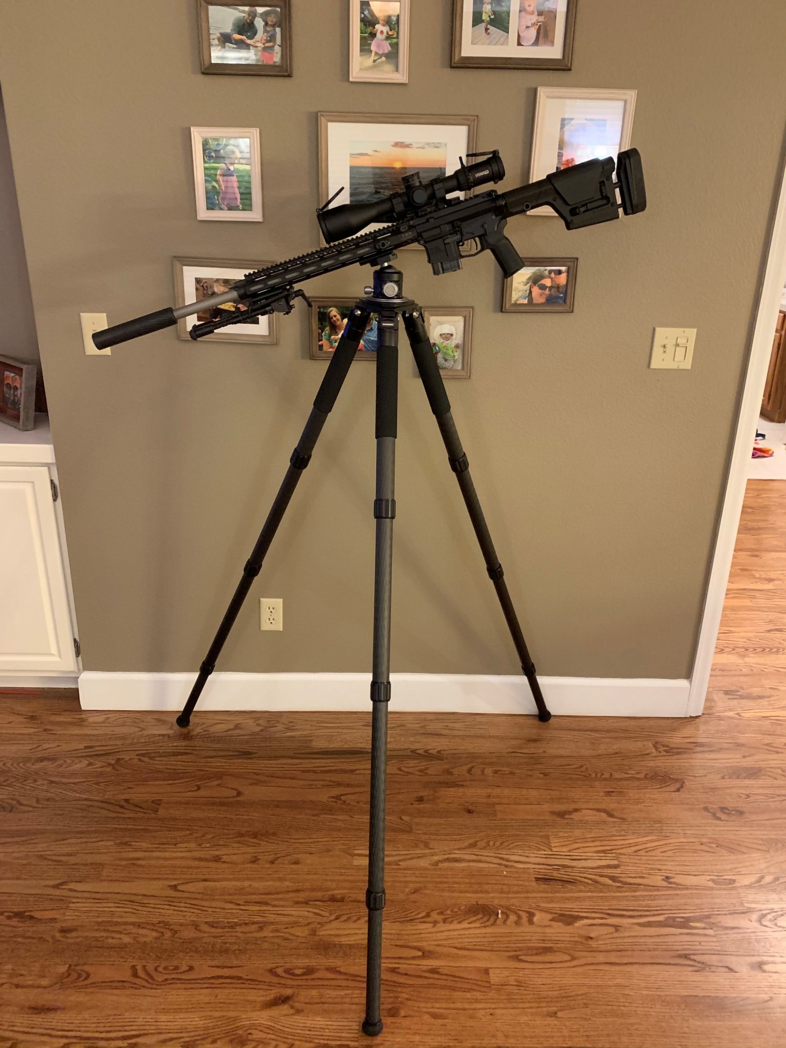

Here’s some pics.
John
Nice looking setup.

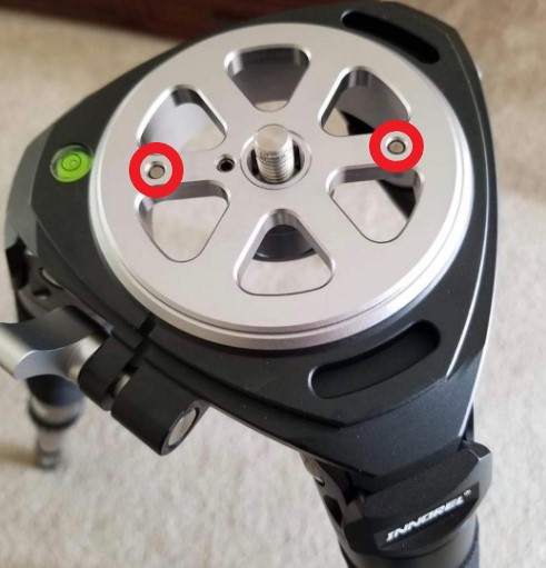

Let's talk mating the head and the legs. This was an area where I had to MacGyver things a little bit to get it to work to my standards. The ball head screws down onto a stud and then is assisted from the bottom by two set screws that work to prevent the head from unscrewing (shown here from above)
The thread mating on the central stud is a bit on the lose side of things which forced me to crank down pretty tight on these set screws to prevent the head from spinning off. This created a new problem where the pressure exerted upwards on the base of the ball head cause it to deflect enough to provide enough interference that it would seize the rotational pivot shown here.
My solution was to remove the set screws and, using a drill and sharp bit, dimple out the underside of the ball head to give the set screws some lateral lockupwith the head. I got the whole thing assembled with some blue Loctite on the screws and central stud. Everything is rock solid now and the pivot is good to go without the excess pressure.

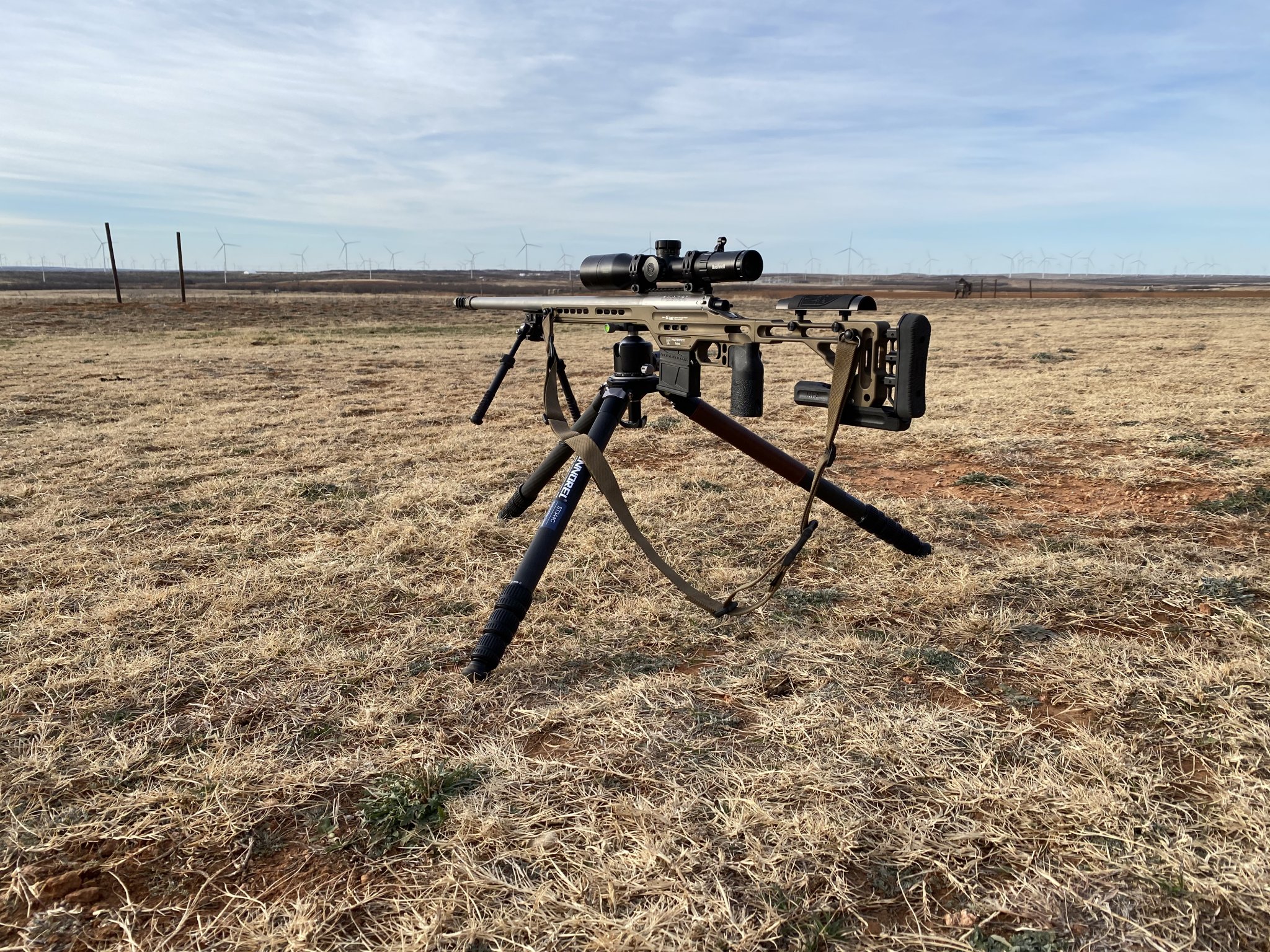

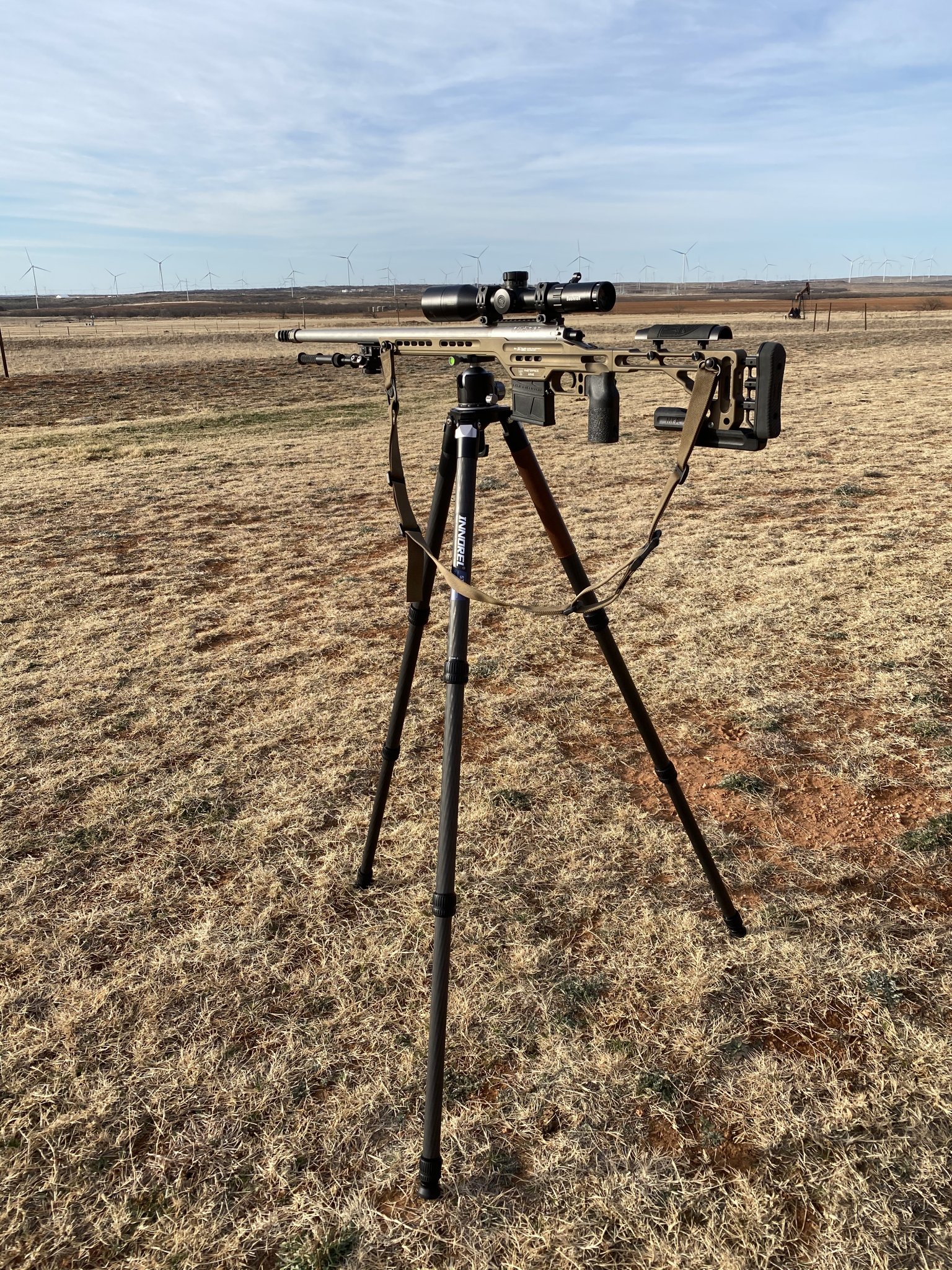

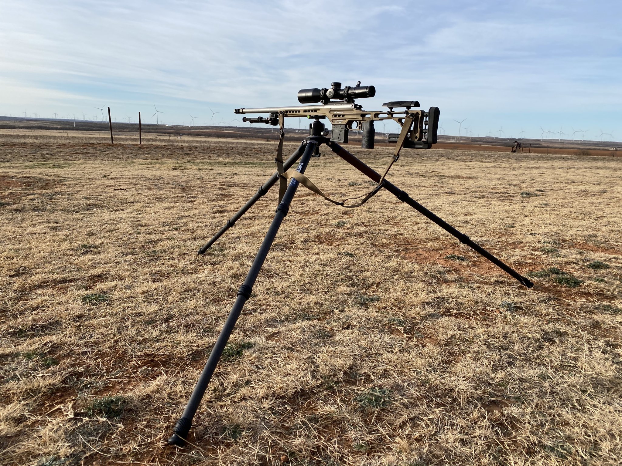

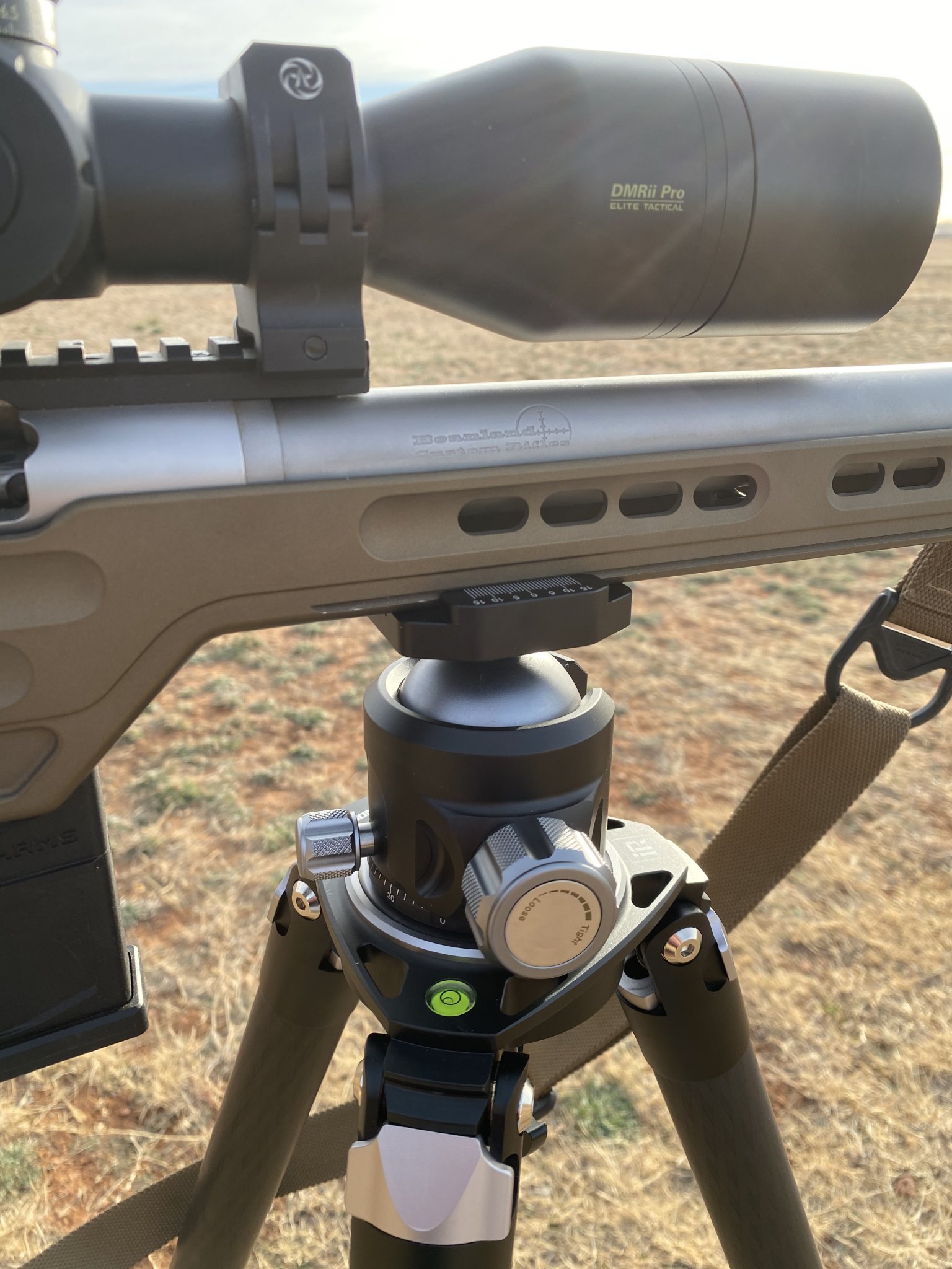

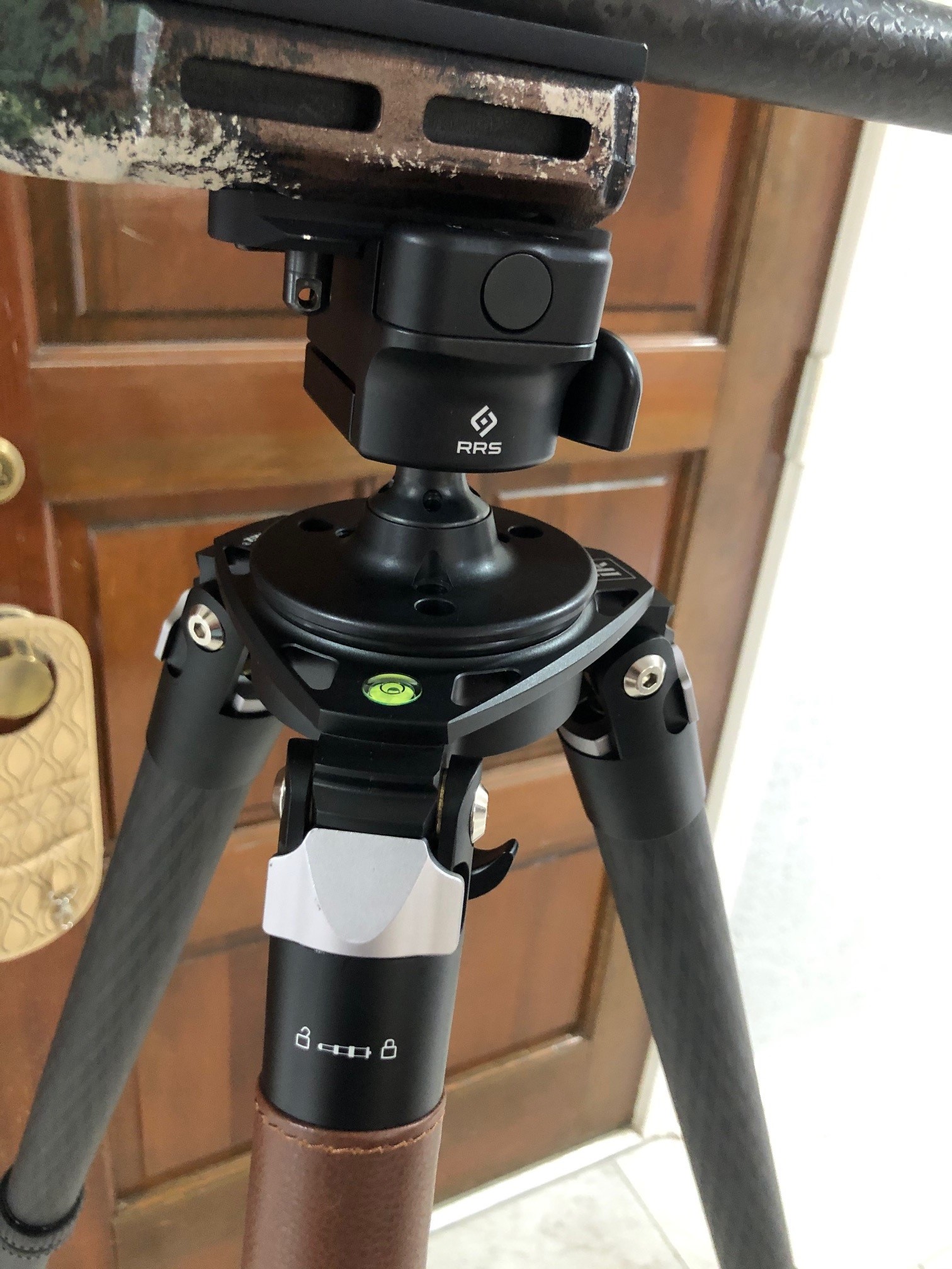

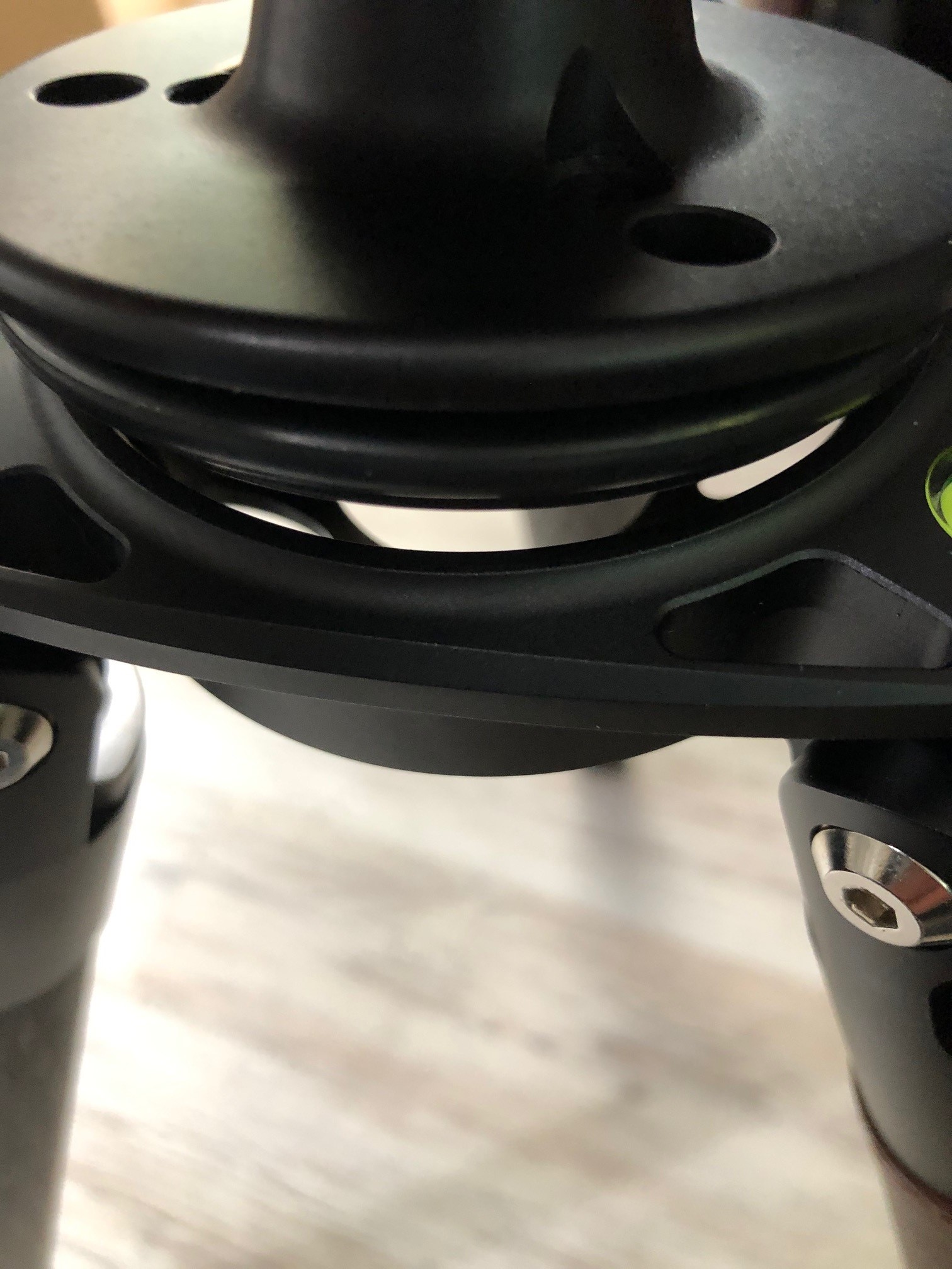

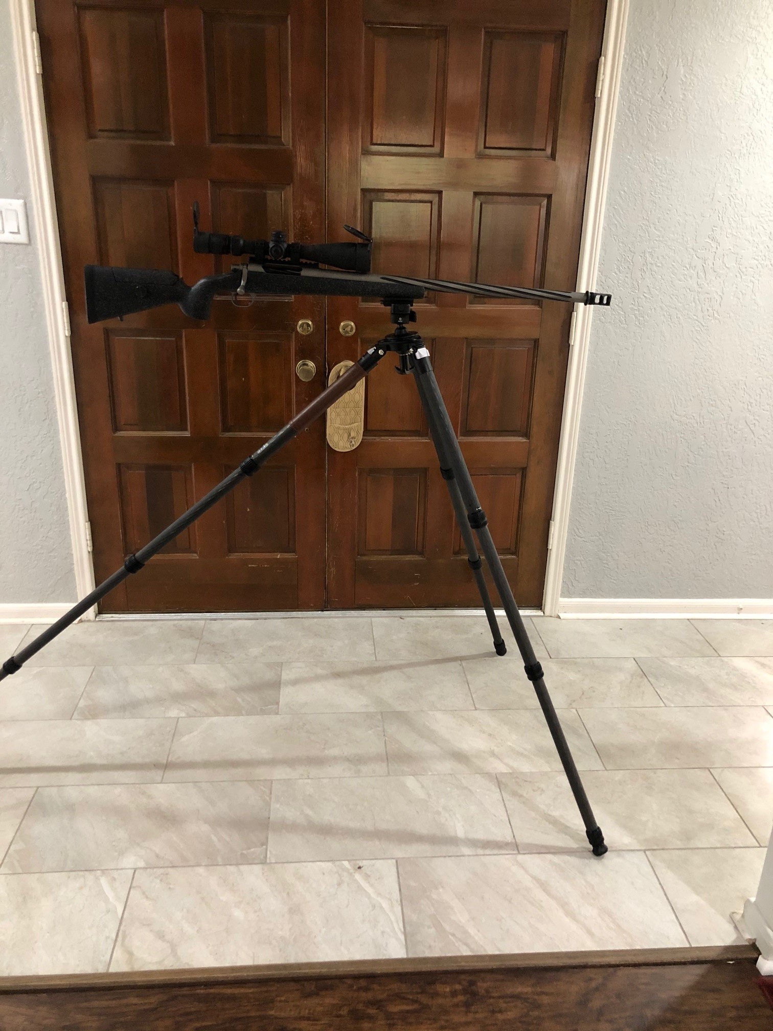

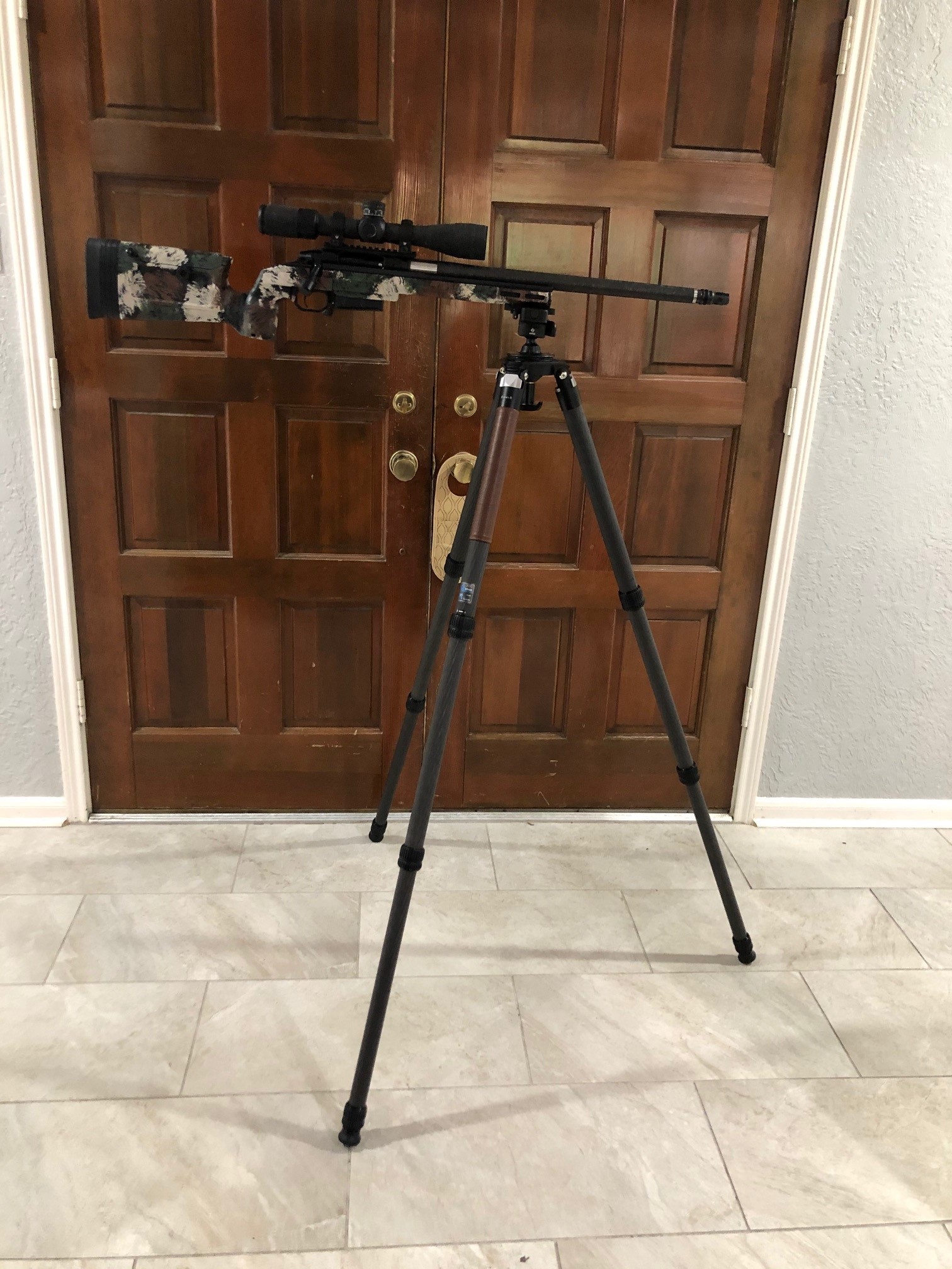

Welp, I bit the bullet and bought an innorel ST344C tripod as it checked all the boxes for weight, heights, etc. With this tripod's purpose being used for 90% hunting related activities, I figured what the heck.
I wanted to use an Anvil 30 with this commie pod so I ordered an RRS series 3 adapter plate in hopes that it would work. It kind of does but doesn't fit extremely tight so I had to get creative. I ended up getting a 3" long 3/8-16 stud to use with the included handle and put an O-ring on the bottom of the adapter plate under the lip. Surprisingly, it is actually really damn snug and no wiggle at all. Pictured is my 12 lb 6.5 and the 14.5 lb 300wm hanging from the pic rail (waiting for arca plates to arrive). Seems sturdy enough. I will take it to the range this weekend and see how it goes. If it doesn't workout, thankfully the commie pod has a 30 day rental policy and I can return for a refund through Amazon.
