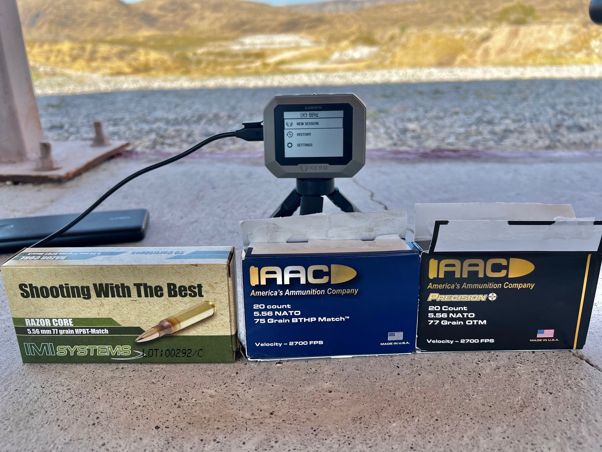

Ammos tested:
IMI 77 gr Razorcore HPBT Match ($0.83 / round)
AAC 75 gr BTHP Match w/ Cannelure ($0.60 / round)
AAC 77 gr OTM ($0.62 / round)

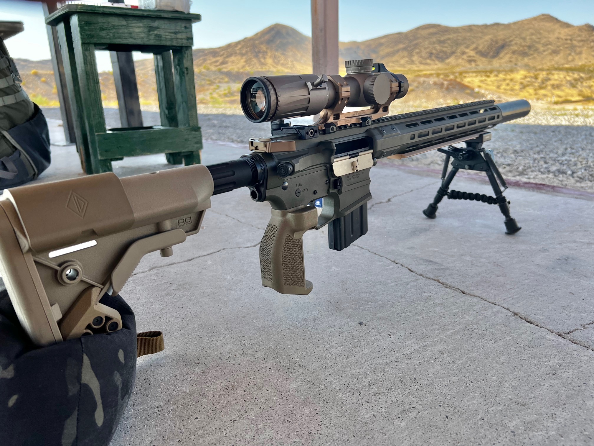

Rifle Specs:
16" Rainier Match barrel, 1/8 twist

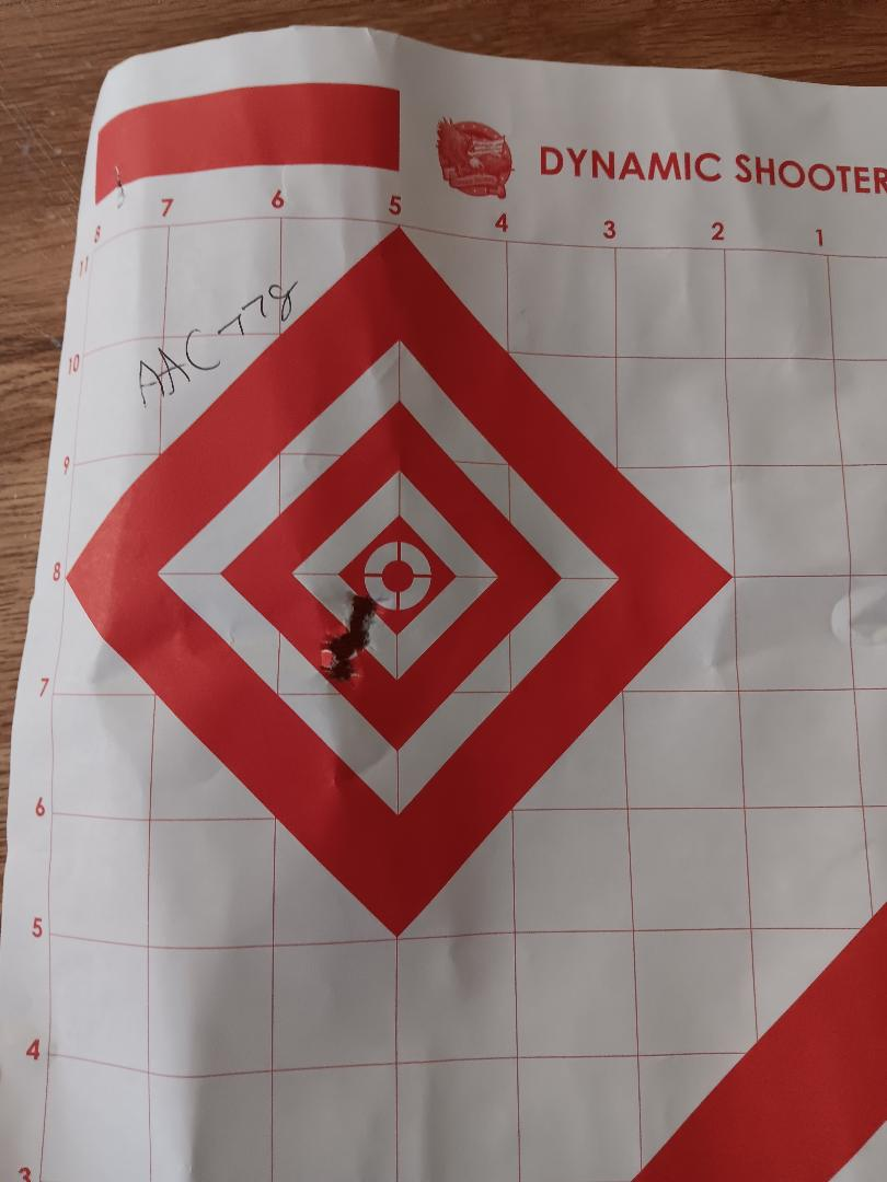

1. AAC 75 grain BTHP Match - 0.547" (0.522 MOA)
2. AAC 77 grain OTM - 0.618" (0.590 MOA)
3. IMI 77 grain Razorcore - 0.730" (0.698 MOA)

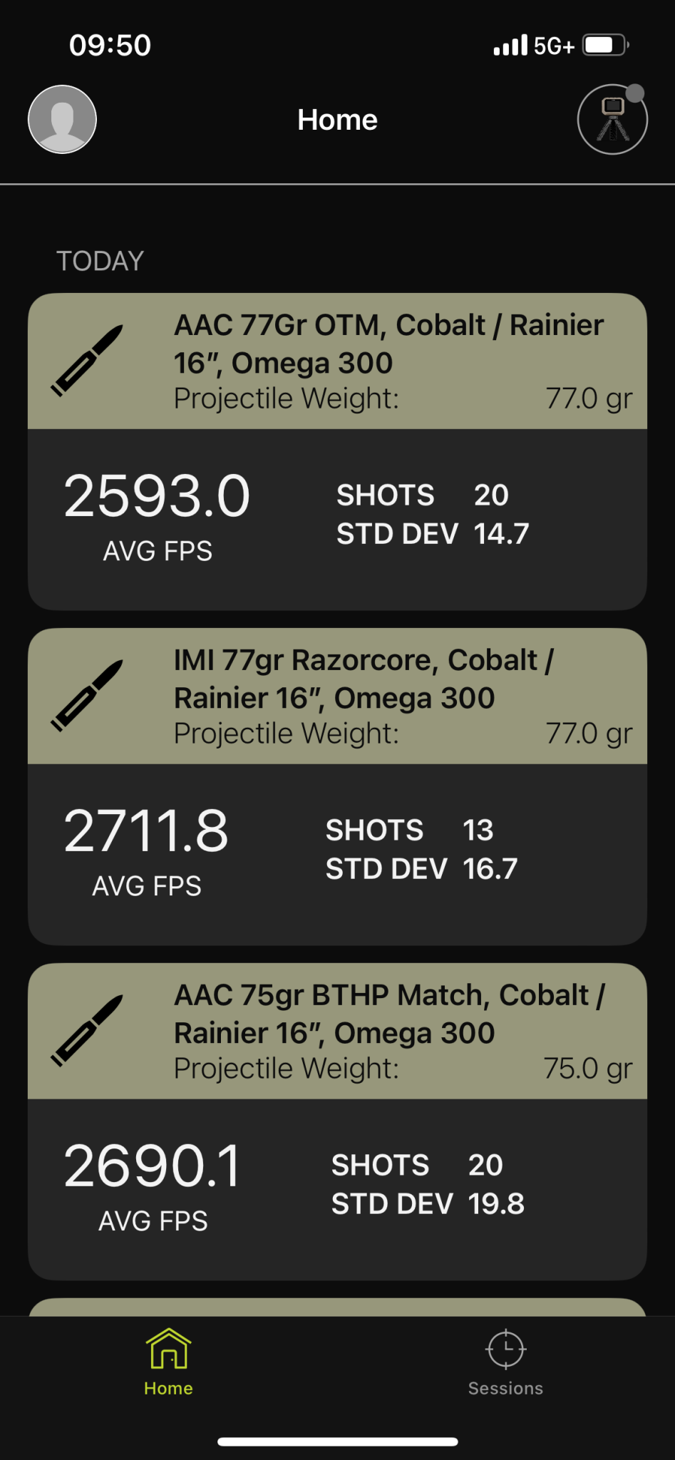

Chrono performance:
1. AAC 77 grain OTM
Avg: 2593 fps
SD: 14.7
ES: 54.8
2. IMI 77 grain Razorcore
Avg: 2711 fps
SD: 16.7
ES: 58.1
3. AAC 75 grain BTHP Match
Avg: 2690
SD: 19.8
ES: 68.5

*Oh side note: the reason the chrono data on the IMI was only 13 rounds, my Garmin Xero didn't save my first session for some reason, and I only had 13 rounds left. But this was comparable to many previous sessions I had saved for the ammo.

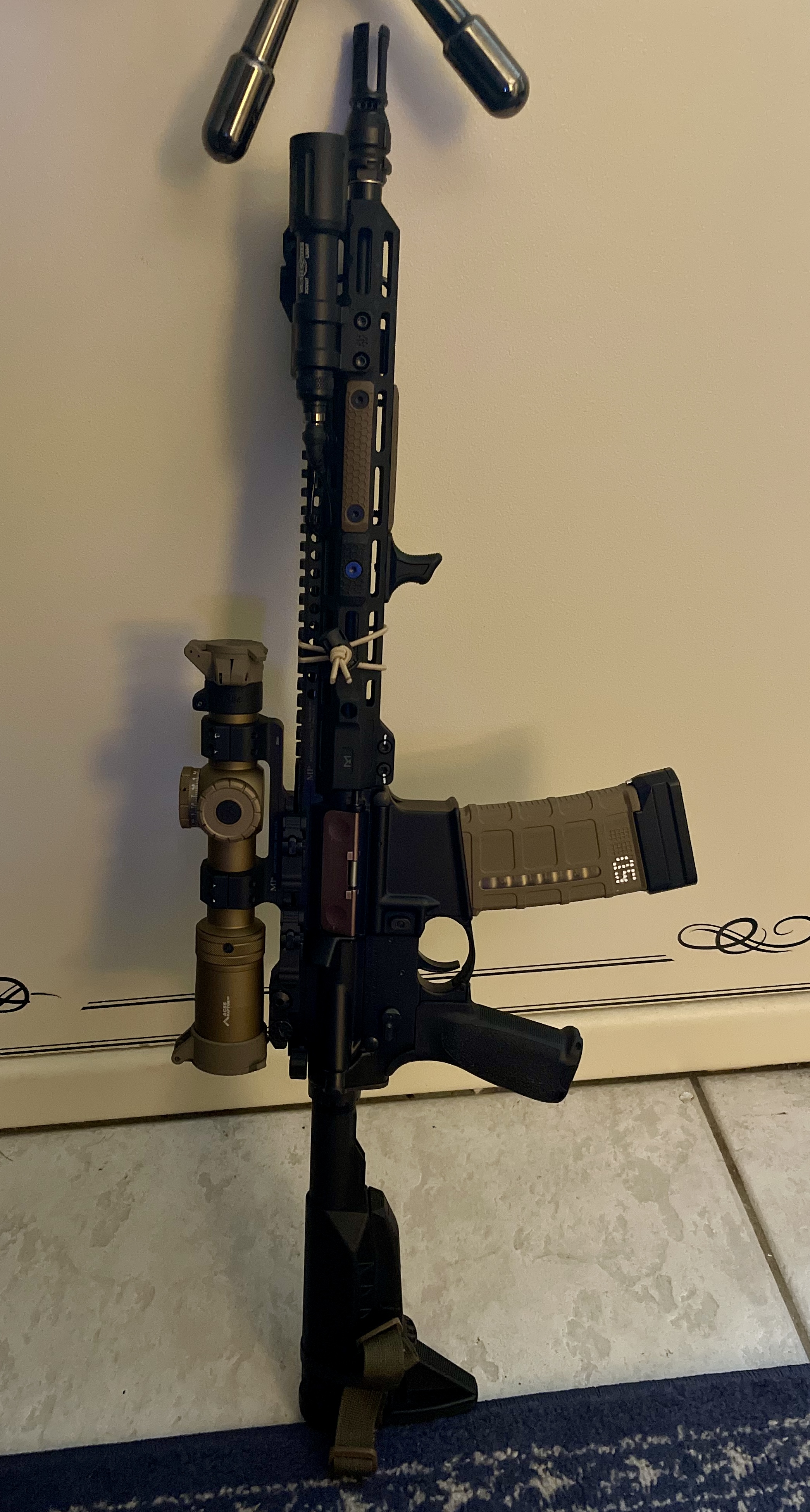

Interesting... With the 77OTM I had great results at 100M but big vertical dispersion at around 500M. I don't have a chrono but took this to mean it had a big velocity spread. Some other chrono testing I've seen shows a big velocity spread for this load. The 77SMK from AAC had much less vertical dispersion.
I wonder if they have managed to tighten up the velocity spread the newest batches? Or perhaps it just shifts from lot to lot....
By the way, what pistol grip is that?
Grip is from Anarchy Outdoors.

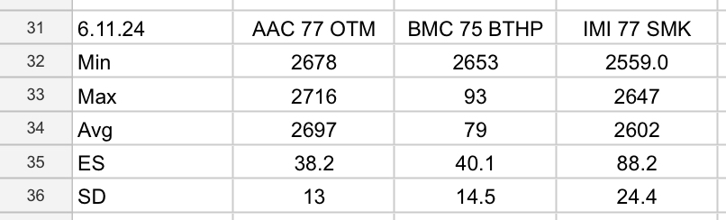

good data from all. thanks. i’ll throw mine down here too, from a garmin xero. 3000feet and 90 degrees
AAC 77gr OTM
16” LWRC IC 2558fps
16” FN with M4-2000 can, 2705fps
IMI 77gr
16” LWRC IC 2680fps
AAC 75gr saber black
11.5” caracal 816 2498fps

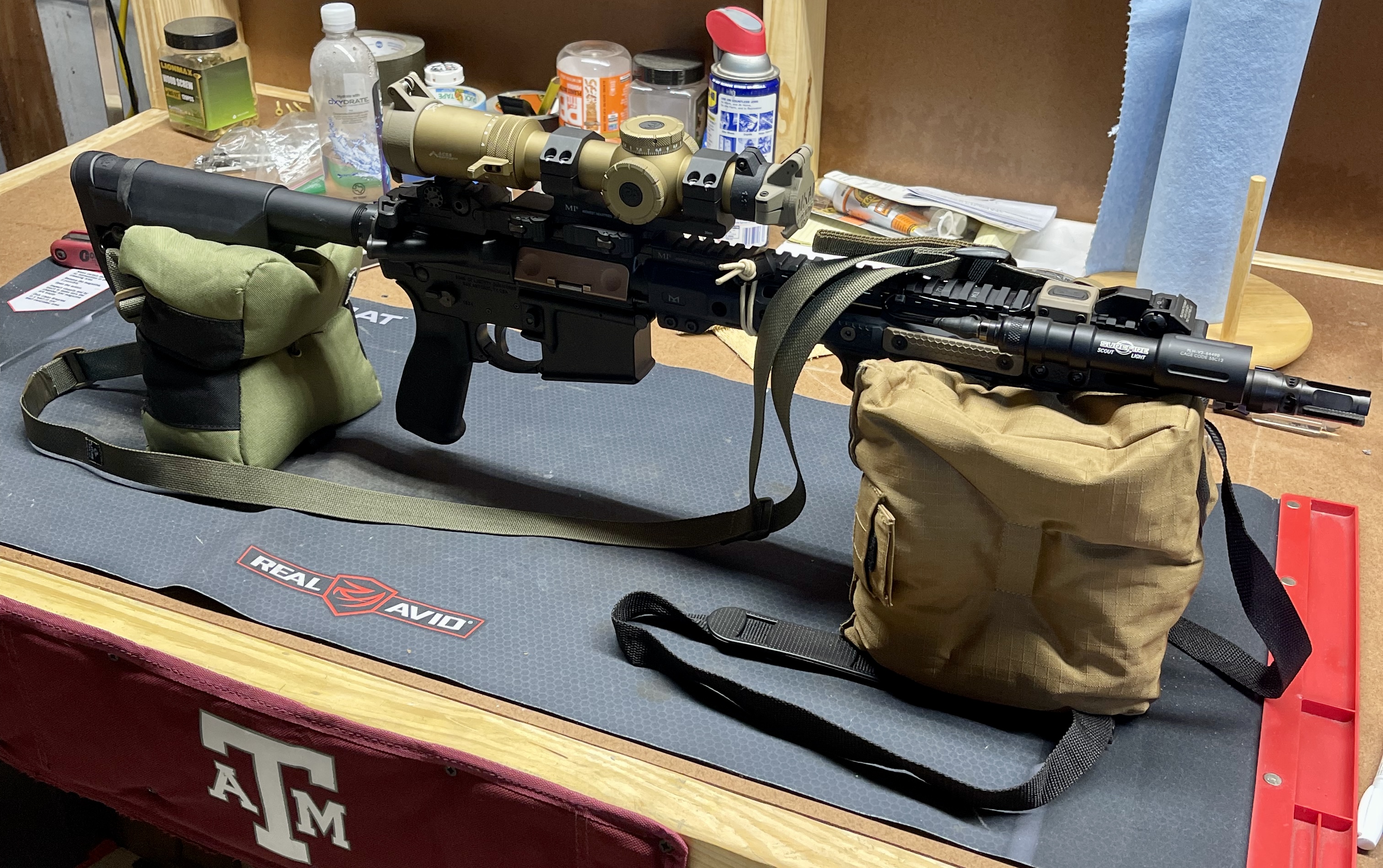

As a side bar, I’m going to put 100 rounds through each of these tomorrow. I’m starting at 50, as both need to be sighted in and the bull barrel target gun is a brand new build.
I’m just ready to get out of the house, get some fresh air, and work on my FUNdamentals.
Once they’re dialed in, I’ve got 100 rounds of AAC 77gr to try out. Based on y’all’s results, if I’m not shooting small groups, it’s my fault. The guns are capable and so is the ammo.

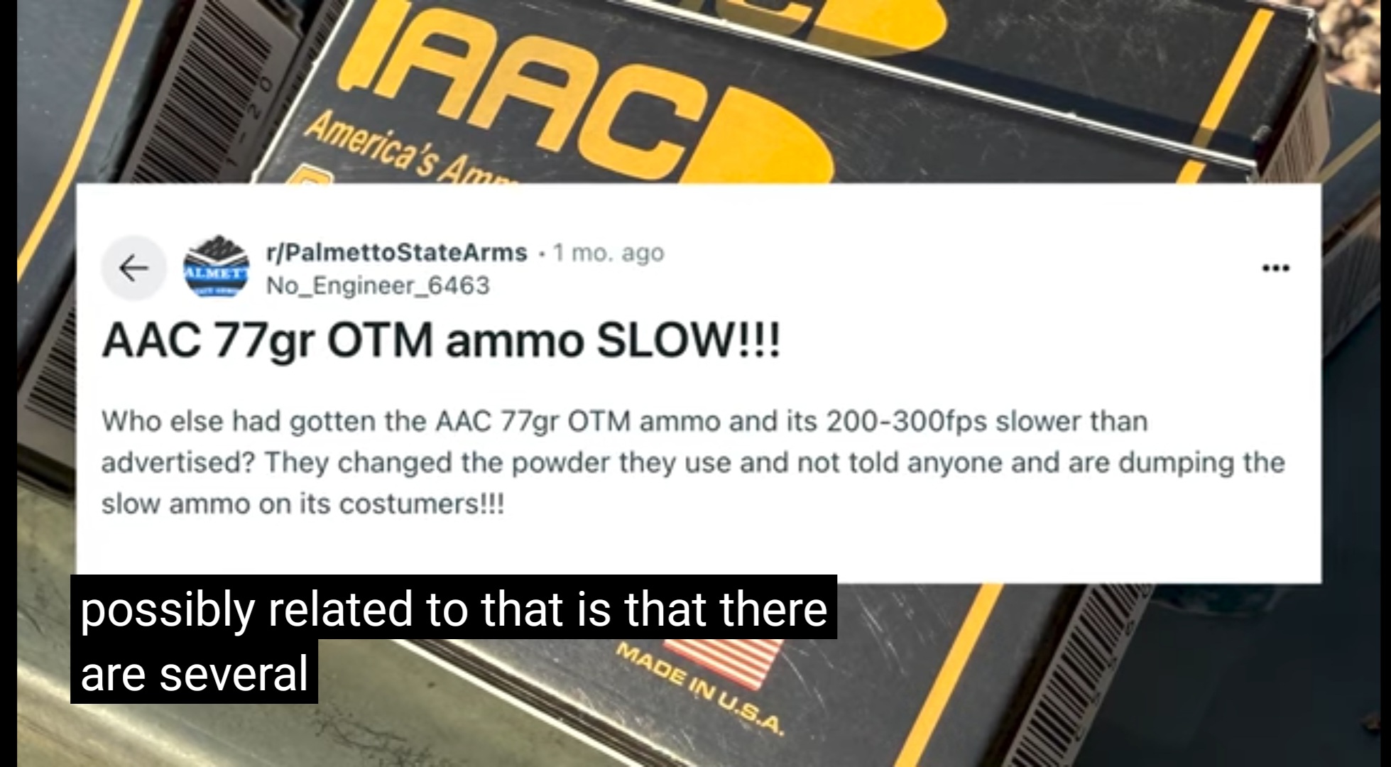

So I just learned AAC is now selling 2 different versions of the 77 OTMs - one labeled 2700 fps and one labeled 2550 fps. There has been talk floating around IG this week that recent lots of 2700 stuff is actually down in the 2500 range, too. I have 600 rounds in the mail and will test it out once it arrives.

Jamin has said the lower speed is a result of a different propellant currently be used.
Same brand, just not as optimum as the previous used one.
