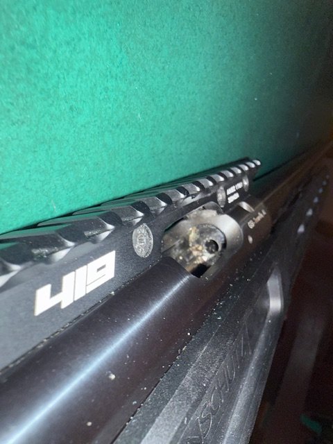

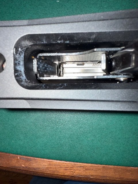

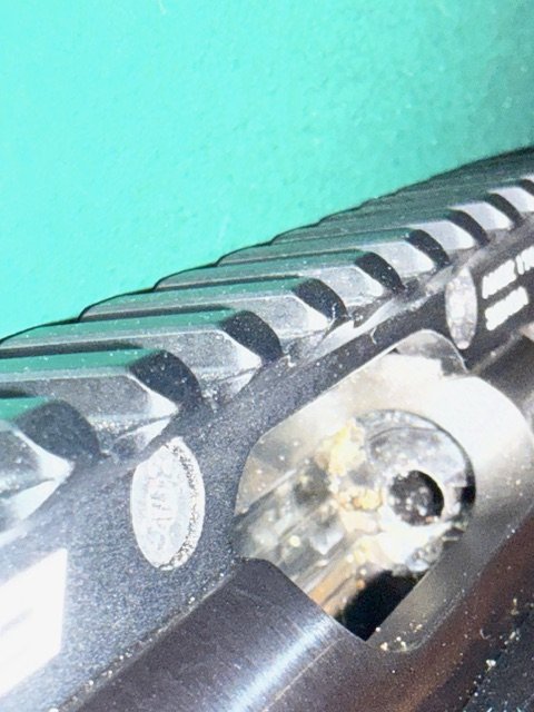

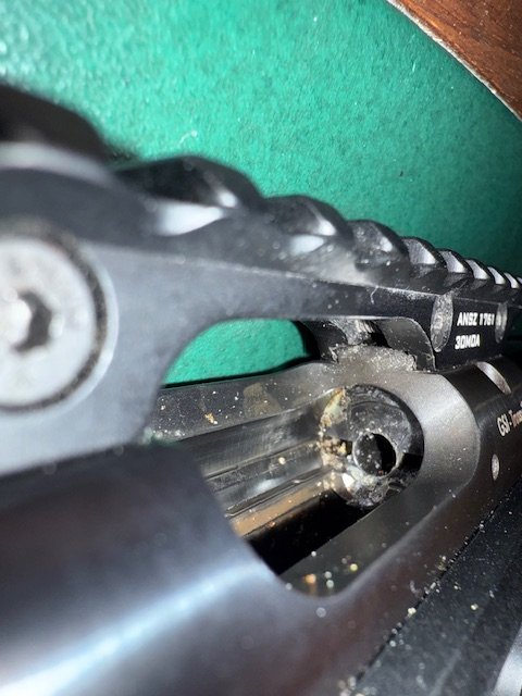

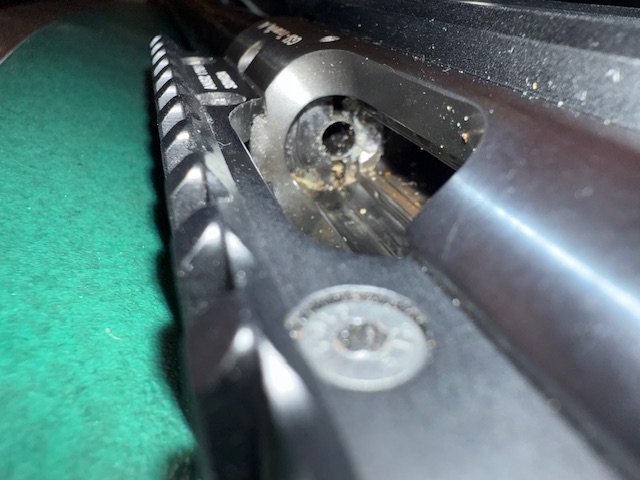

I found a Anschutz 1710 at a DFW (Allen,Tx) vendor. I'll attach photos. Please tell me what I am looking at inside the action. The salesperson said this was from inserting a chamber flag. I told him that's ridiculous he expected me to believe that. I told him that, then he replied he would send it to be re-barreled. I came back to check if it was sent and it was still there, exact same condition! Not even an attempt to clean it up!
The chamber inlet bottom it appears to be very rough, perhaps cracked?
Also what throws me is the 22.75 inch barrel. It's that a normal size? It was NOT threaded.
Buyers beware.

Depends on the shop. I used to see them all the time when I would check out pawn shops. The debris looks like unburned powder and brass scrapings. Anschutz rifles use a pressed and pinned barrel and there are only a few places I would trust to change the barrel.
Looks like it just needs a good cleaning, PO didn't, or the GS took it to check it's overall condition, and didn't bother to clean it afterwards.
Google says this model has a 23" barrel, with a 54 action, but it really depends on the model variation(s), etc. Find some pics on google to match the rifle above and go from there.

I only see magnified, unburned powder. Nothing that 5 min of cleaning would not fix.

I have never in my like seen unburned powder in a 22LR in my life or any other caliber for what that matters. Powder is dark grey, not yellowish. This is the poorest used 22 chamber I have ever seen. Even suppressed my 22's don't look like this. The accumulate carbon, lot's of it. No threaded barrel so no suppressor on this one.
How could there be unburned powder on a rimfire? Maybe I just never witnessed it.

It is powder residue that is captured or sticks to the inside of the case. As you eject the case the contents of the case are shaken and the debris falls out. Add to that the bits of brass are scraped from the case as it is chambered and ejected and just builds up, very very common.
I have never seen unburned powder in a 22, ever. Sure I see a bit of brass now and then, but this residue is not brass or powder.
Maybe is just not very very common in any of my 22's (unburned powder)? Maybe I'm shooting ammo that completely burns.

My public service memo to anyone in DFW, If I were in the market for another Annie I would not hesitate on this one , it would come home to a quick cleaning and a trip to the range. Having owned, cleaned and shot Annies, Walthers, Winchesters from what was shown here There is nothing wrong here.
It appears to me that the OP had two questions. " Is this bad condition?" The answers have been an overwhelming...........NO. The second question was asking "what am I looking at?" Some members went to great length to give him an explanation.

It appears that it was not cleaned. It appears that it was shot alot. Looks like there is a lot of carbon/powder built up underneath the scope rail. The action appears like they maybe occasionally wiped it out. It also appears that they left the action open and rolled it around on a dirty rug.
It appears to be a dirty used rifle.
