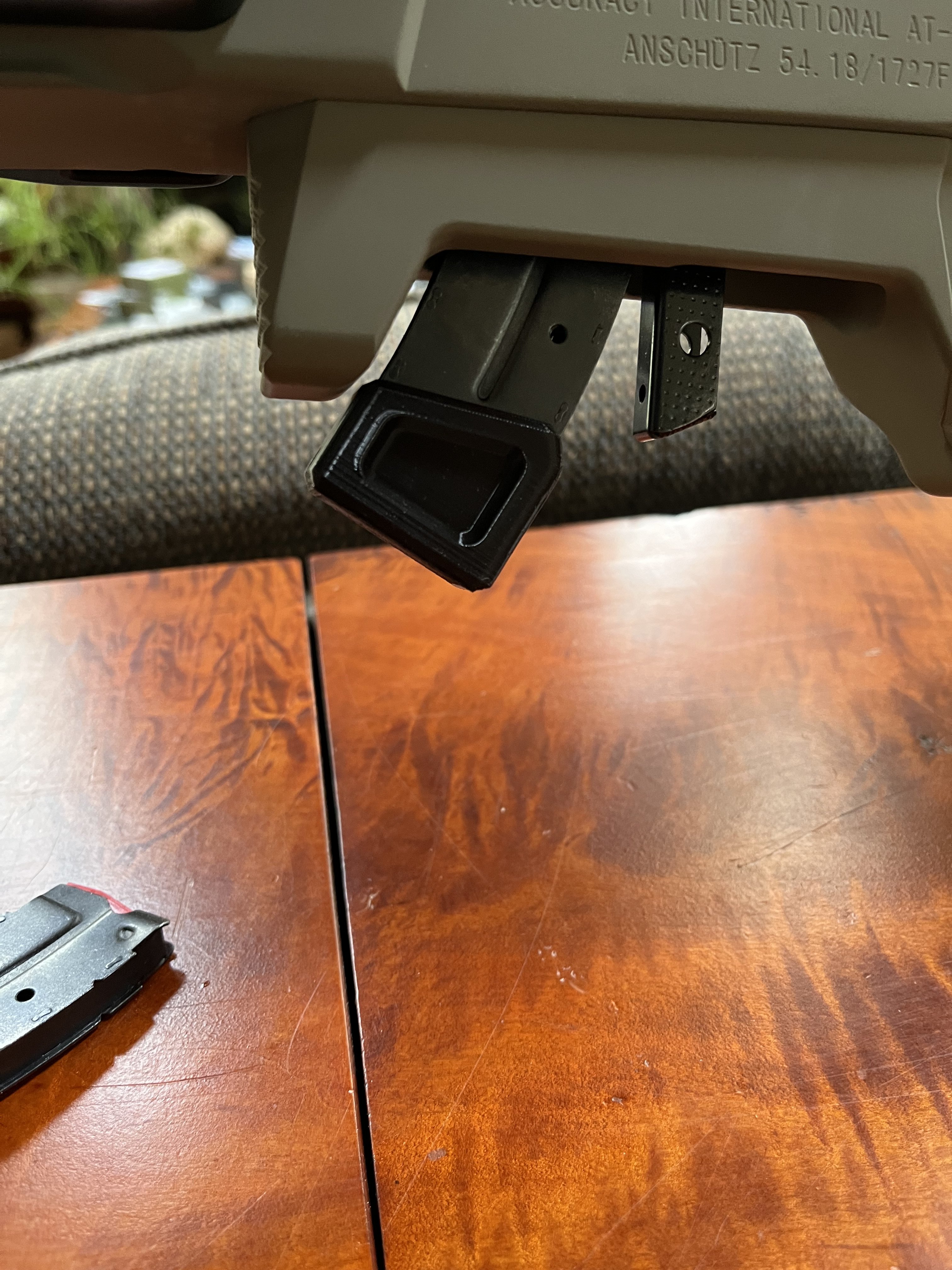

    I just picked up one of these rifles and the Achilles’ heel of it in my mind are the magazines. You’re forced to do a reload on a 12 round stage. Is anyone currently printing magazine extensions? I tried to get my L3 I magazine extension for my CZ to work and it is a no go.
    I have not found one
    I bought a couple of these. Wound up having to buy two Savage mags to rob the springs and followers. Then there is some minor fitting to the follower.
    Do they work? So-so at best with a full 12 rounds. If you have never owned an Anschutz then be advised that the magazines are not perfect. Mine run great 99.5% of the time but you must take care not to get "rim-lock" when loading them. In fact, in the downloadable manual it has a section devoted to loading them.
    I wish, even with what seems to be some issues, L3i would come up with a plus rounds mag for the Annie.

    With some attention to detail, and careful assembly they work perfectly. You have to modify the savage follower. Great 12 round magazines.

    I used Savage magazines, remove minimum material from the follower. It must travel without binding (at all) the length of the magazine body. Good Luck

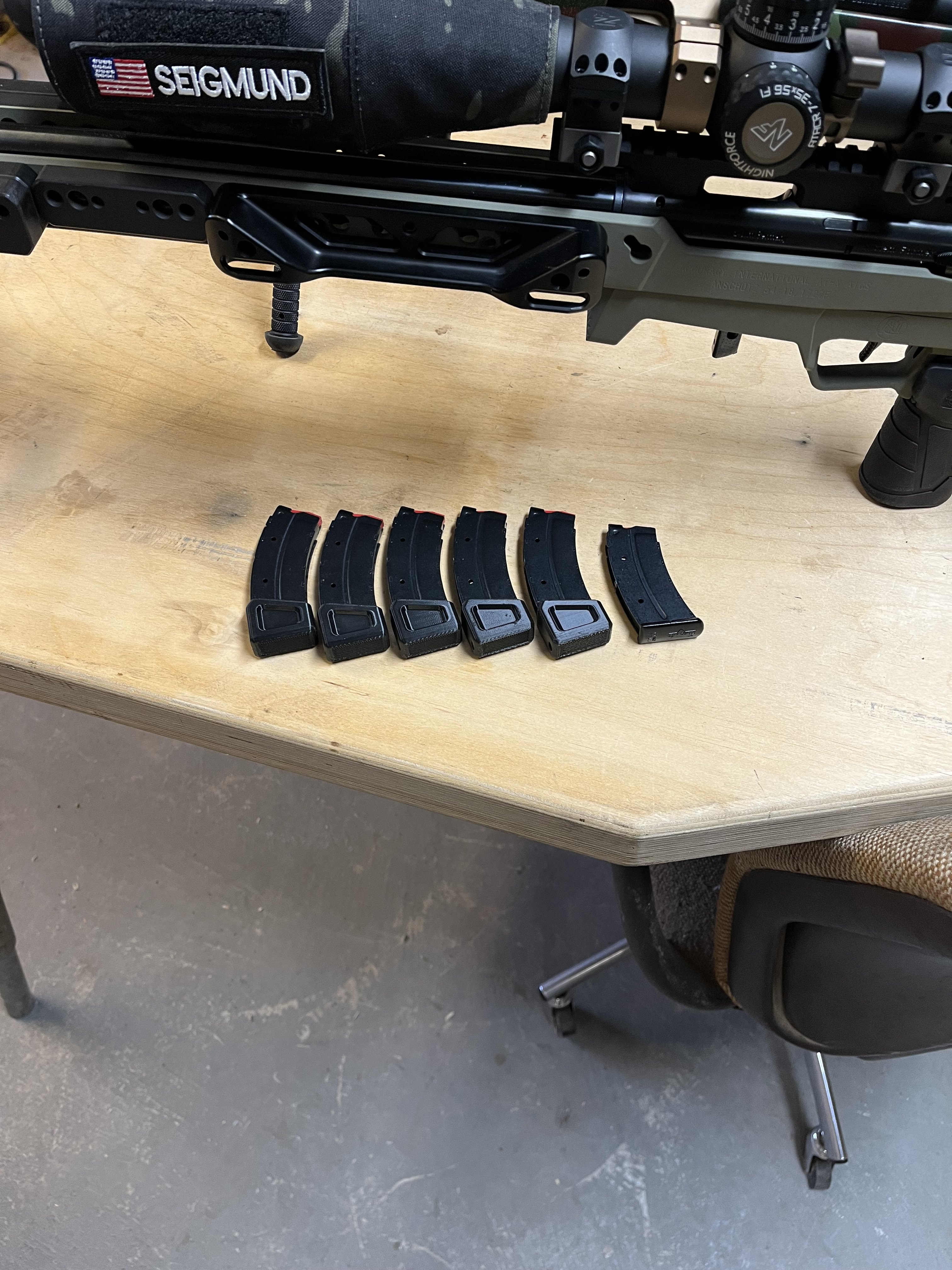

    View attachment 8679111View attachment 8679112
    I ordered two more extensions last night and happened to see the same seller has safety mags with flags so I ordered a couple of them as well. Then, of course, I ordered two Savage 99 mags to rob springs and followers from. The good times never end (until the credit limit is met):LOL:

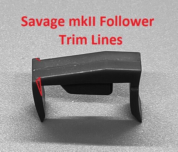

    Tried this and couldn’t get it to work. What magic do I need to do?
    Savage 99 or CZ spring and follower?
    The followers have to be trimmed. There is a YT on it that shows how but I didn't find it very helpful.
    The Anschutz magazine has an indention on either side at the top rear. you will need to trim the follower so it can come all the way up on the mag body.
    Look closely and you can see the trim lines in the pic below.
