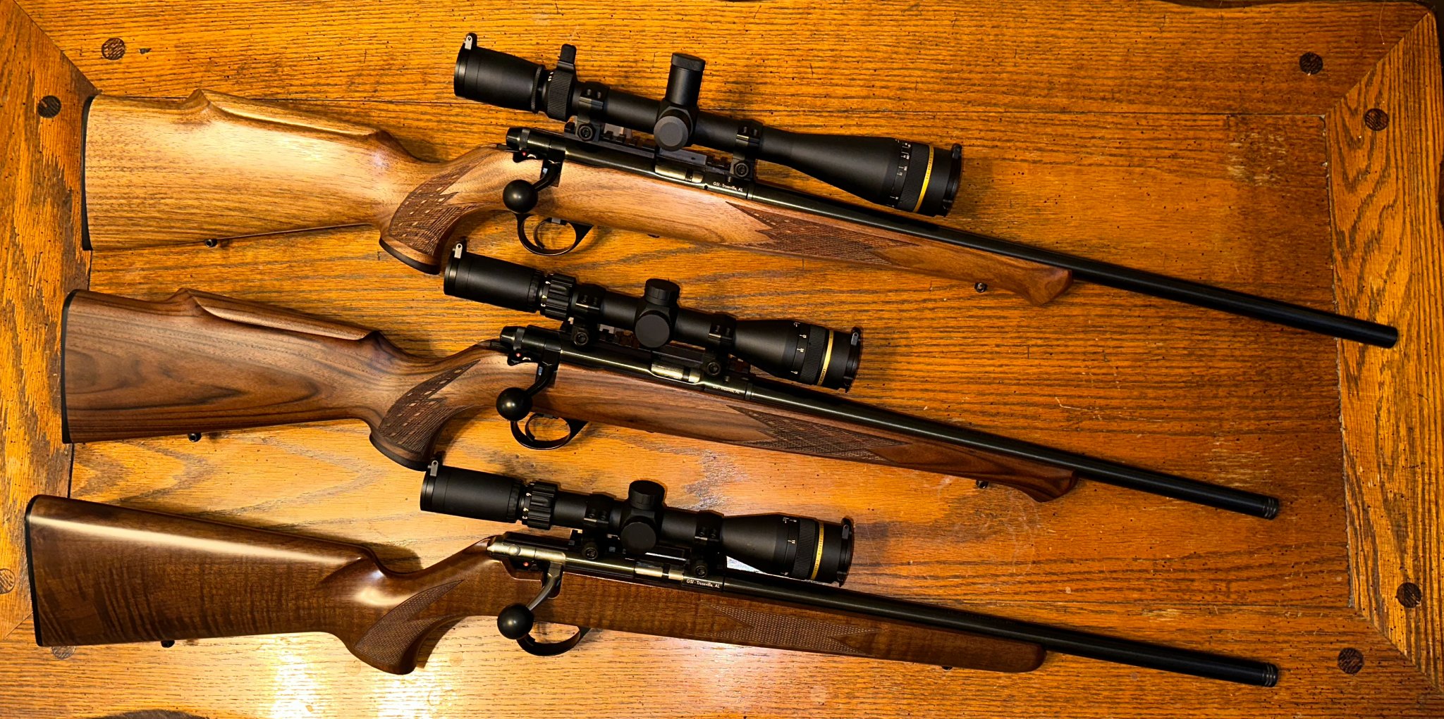

Since we all like pictures, my Anschutz collection, minus the Weatherby Mark XXII (Also an Anschutz 1416) that is in the vault with them.

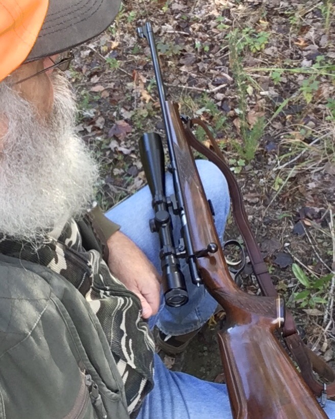

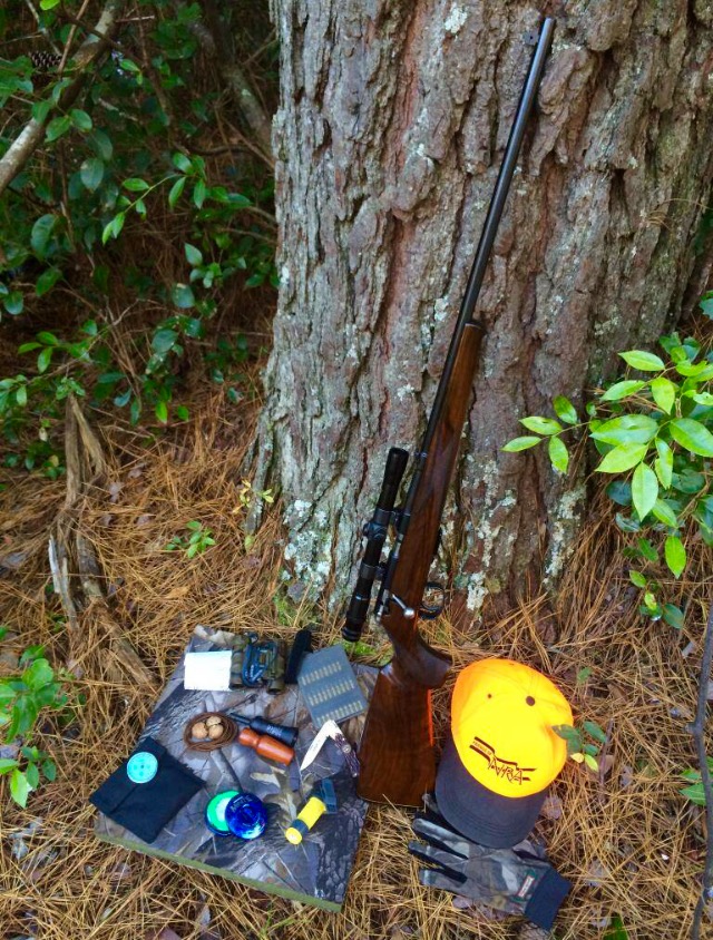

For my personal taste, when it comes to hunting rimfires, I prefer less plastic and alloy, and more walnut and steel.
The early SA54’s were a machinist work of art, as were the somewhat lighter 164’s
The stocks are very comfortable, balance is great, and offhand accuracy puts the blame on you for the misses, cause it sure isn’t the rifle. With modern glass there is nothing to hold you back from trigger to target.

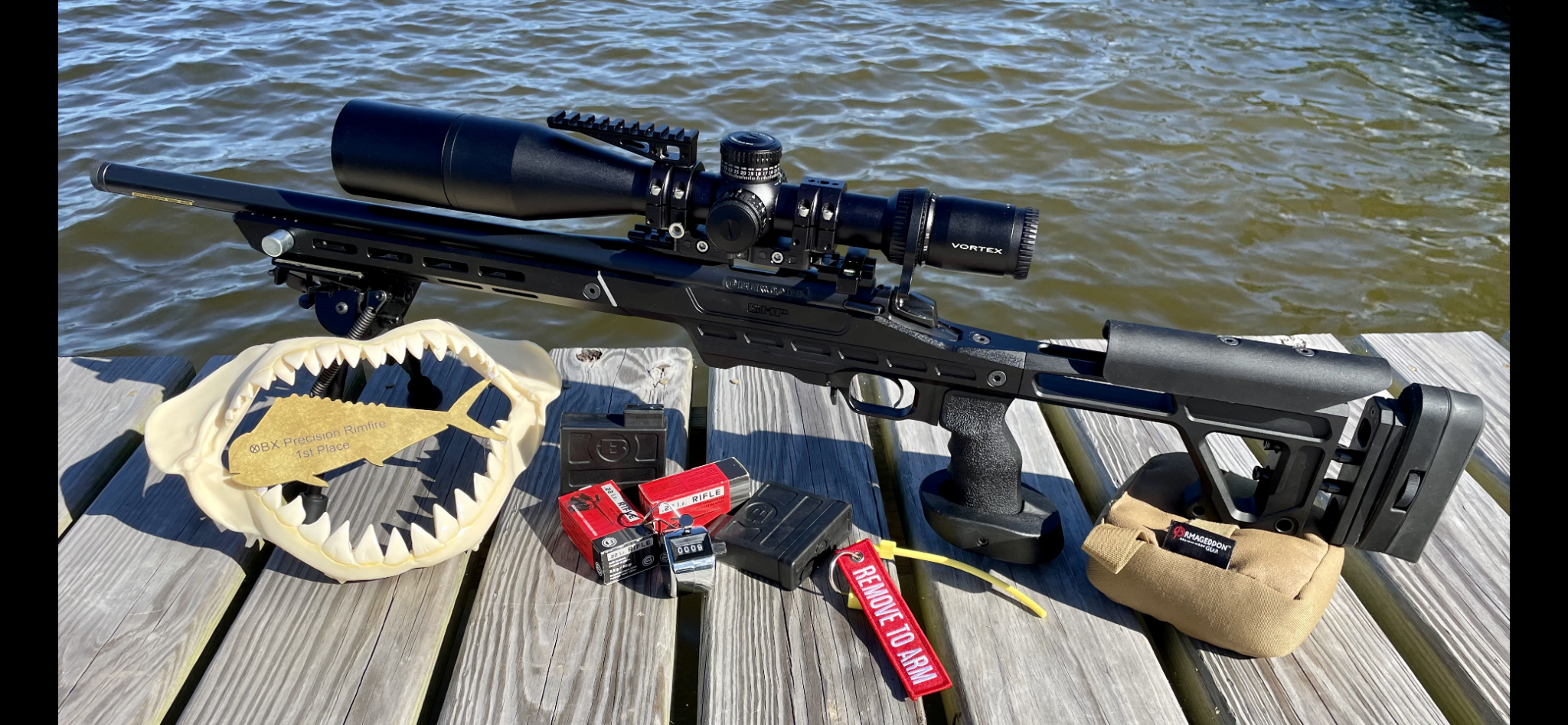

I’ll also add, I’ve carried my B14-R hunting as well, because even though it is my barricade match rifle, it still must earn its keep off the range:

Damm what's the barrel length on this bottom rifle, nice looking rifles I do like the wood stocks.
