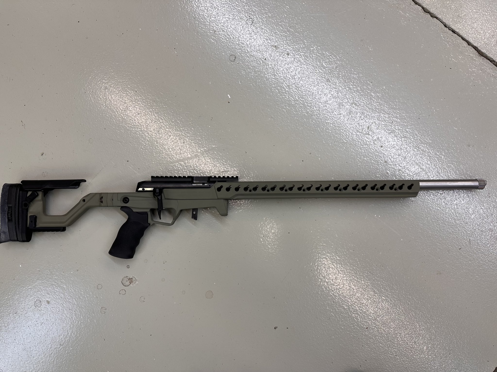

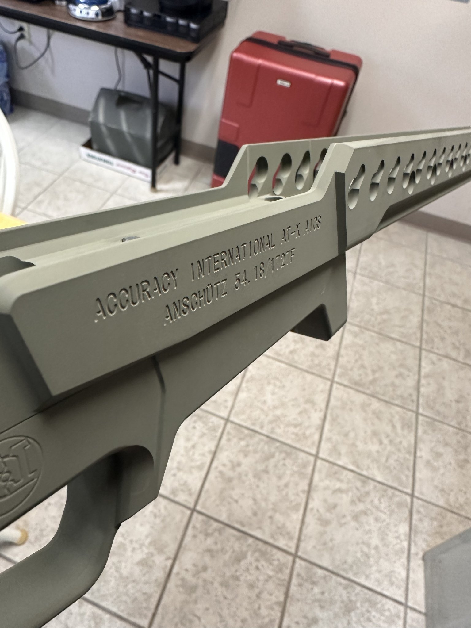

The first photo shows a Fortner with an unthreaded barrel, and looks maybe a little thicker, is that an option?

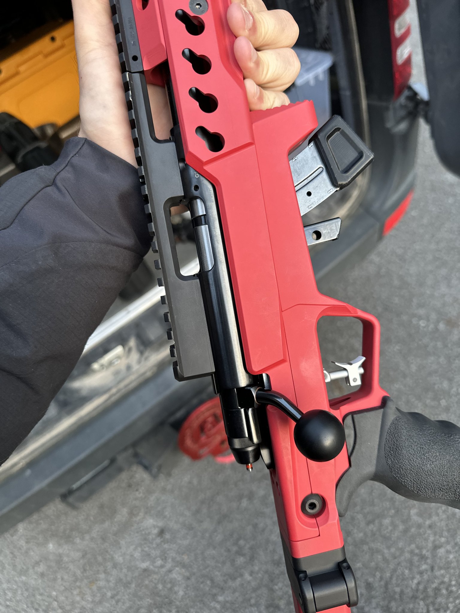

I am a total AI fanboy, but this chassis prevents you from working the bolt normally. As in opening with your trigger finger and closing with your thumb.
At least that is the way it looks to me from the cheap seats.
My 1727 lives in a GRS stock. I had to do some stock work to get it more comfortable to close. Now it is wicked fast to open and close.
Correct. If you’ve run a Fortner like normal it will be a new motion as you can’t get on the bolt cap like the grs stock or biathlon stock.
