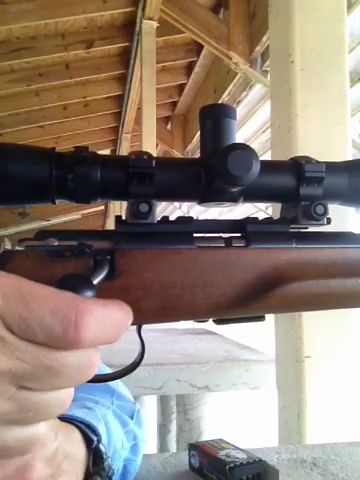

I guess I got lucky in that mine brought the stud. The Leupold is a 6.5-20X with a varmint reticle. I didn't buy it for this rifle, but it was on another rifle I use to own. The only bitch I have for this rifle is the fact that I/we have to modify the extractor to get it to work properly with all ammo. Piss poor from a great company like Anschutz to keep putting this rifle out and not admitting the problem. Here's a short video of waht I'm talking about. It's frustrating to no end. I have found that it does it less with uncoated ammo such as Eley. Wolf is great ammo, but feels like they coat it in snot.

Wow talking about having fun and encounter something like that.. thnk god thst never happen with mine l.well i tried a lot of bulk ammo so far and all good.. i think ive heard that the older 64 version with darker checkering had this problem.. if your came with stud its def older version..i think DIP sells the parts
