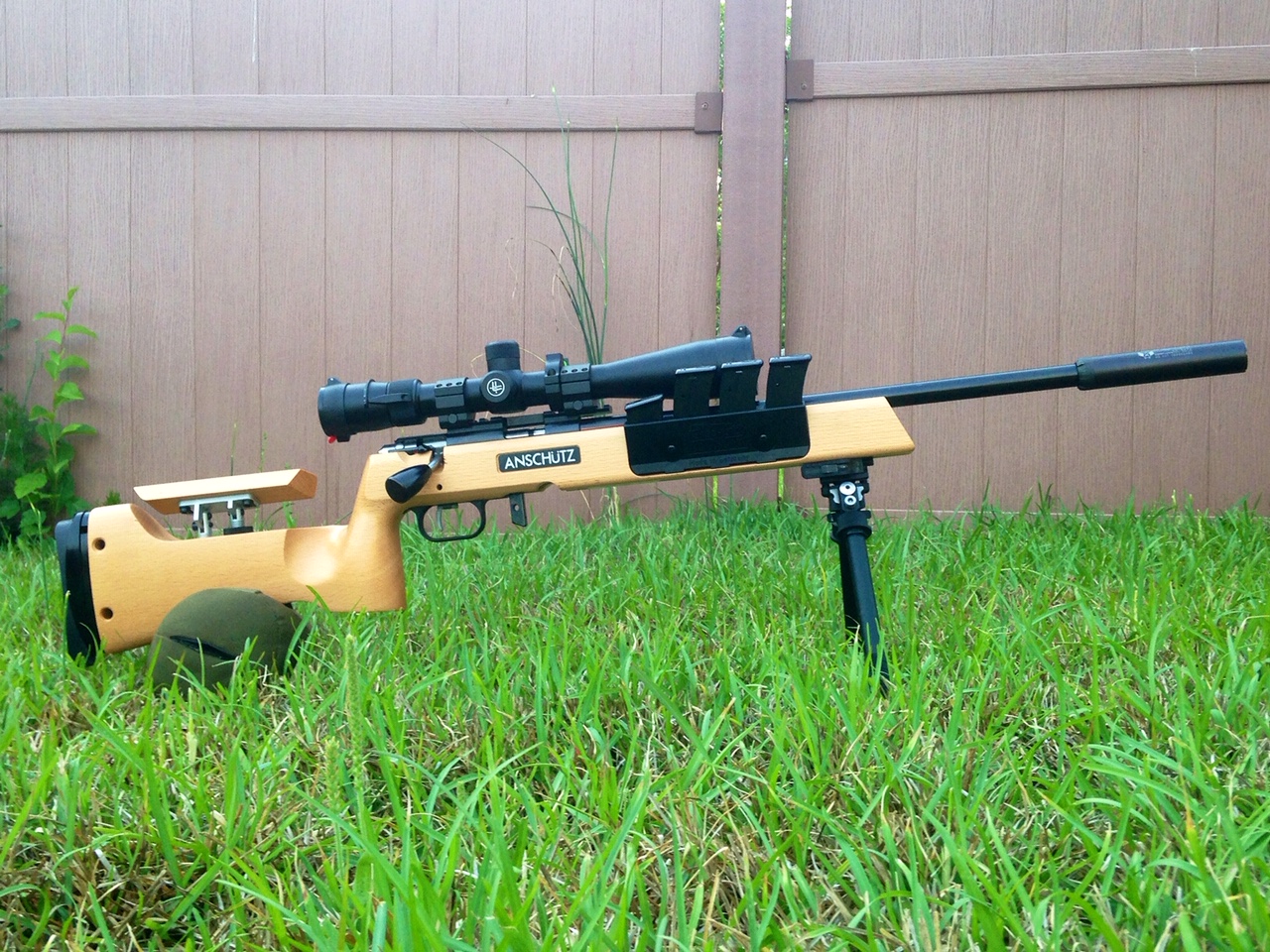

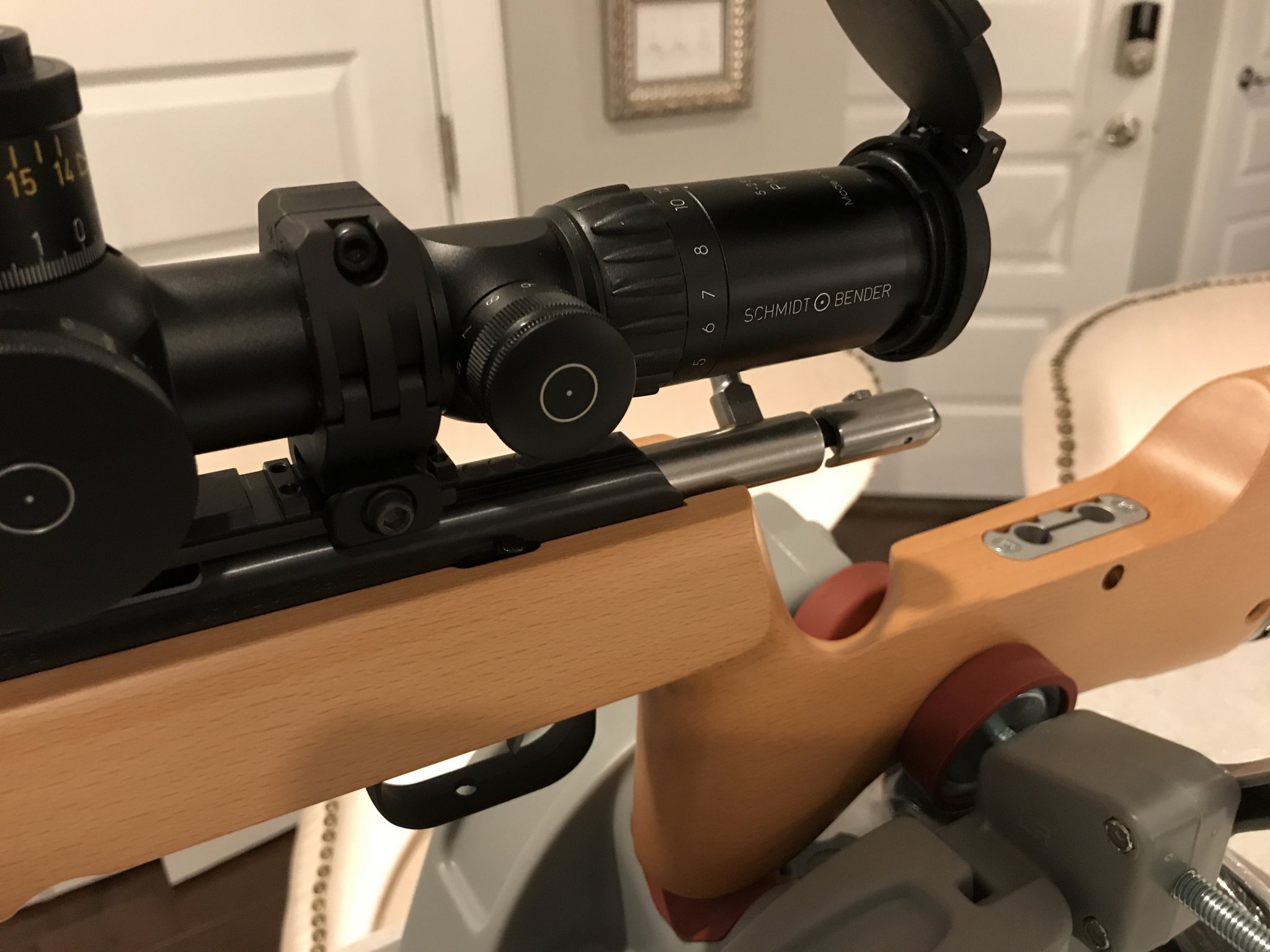

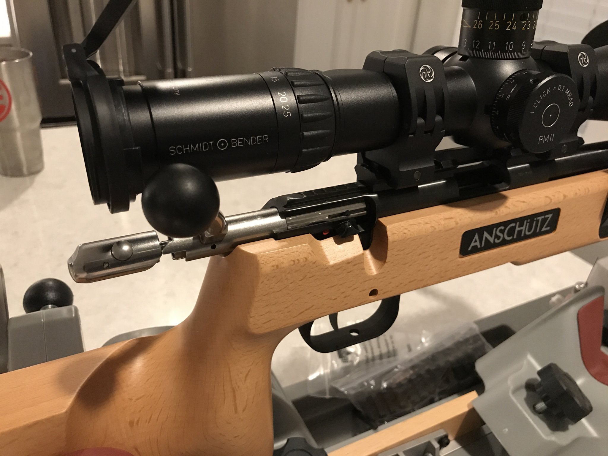

I’m feeling really dumb for having to ask... I just assembled a new 1416 and can’t get the bolt in. When I depress the bolt release it doesn’t have an effect -Help! Feeling pretty stupid

I actually had the same issue when I got my Anschutz, but eventually figured it out. Try pushing the bolt release forward towards the muzzle while simultaneously pulling the trigger and inserting the bolt at the same time. Hope that helps.
Winner winner chicken dinner.... I pulled the trigger and it went right in. I was afraid to pull it and damage something - always been told not to dry fire a rim fire. Holy smokes is the trigger feel light - no idea what it measures but it is really lite to me

Don't feel dumb.... Same thing for me. Took me five minutes to get it in. My 1416 has a 5098 trigger... 175 / 450 gr. yours should be set at 180 gr. ( 6.3 oz. )

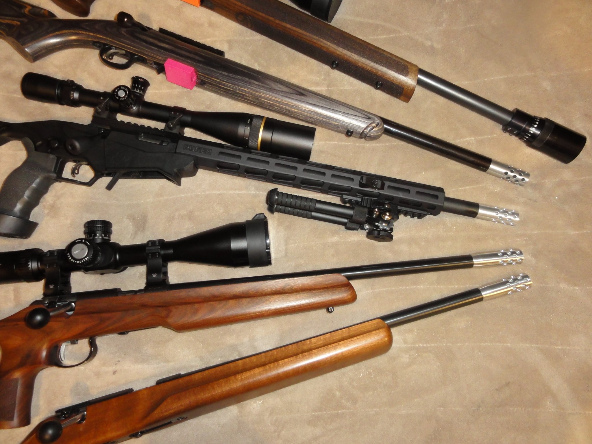

How do you like your impressive set-up? Afraid I don't have your kind of cash. I do like my new tuner.

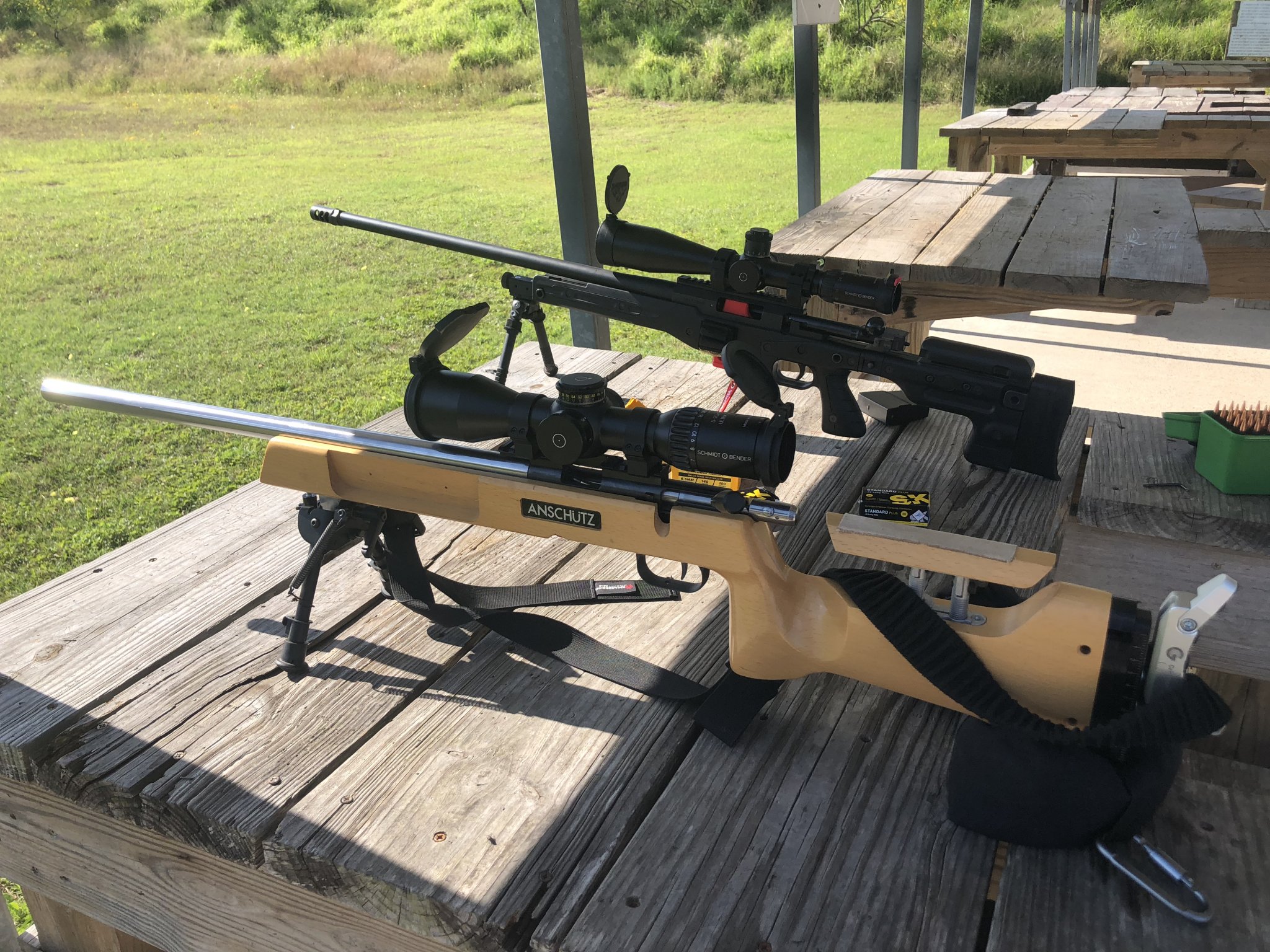

Btrain, do you know if the stock on your Annie is available to purchase after the fact? I have a 1416 and would like to have an adjustable comb stock and have never seen those stocks available as an aftermarket item.
p.s. how do you like your 1416?

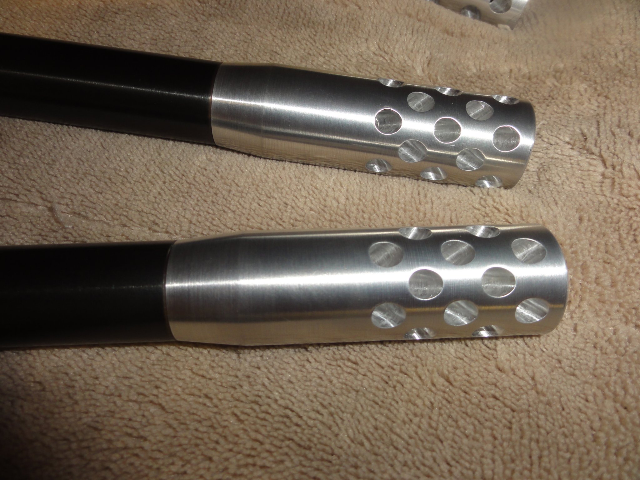

Hello Monster..... I was just at Boyd's stocks and they offer a decent looking Pro Varmint wit adjustable comb. I was looking at the blue one, with the high gloss finish. I have two Annie's with the short barrels. ( 18" ) and did not want the stock to be too long on the muzzle end. I even had some brakes made up to make the gun a little longer. The Boyd stock for my short action is about 1.5" longer than the standard Annie stock shown. I'm off to the CZ 457 section now.

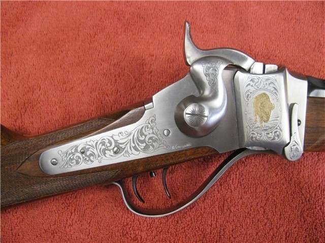

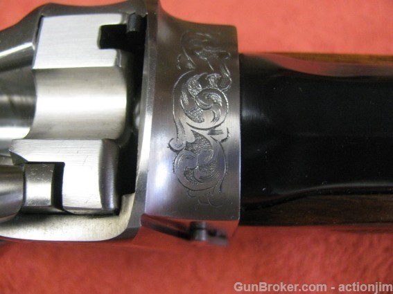

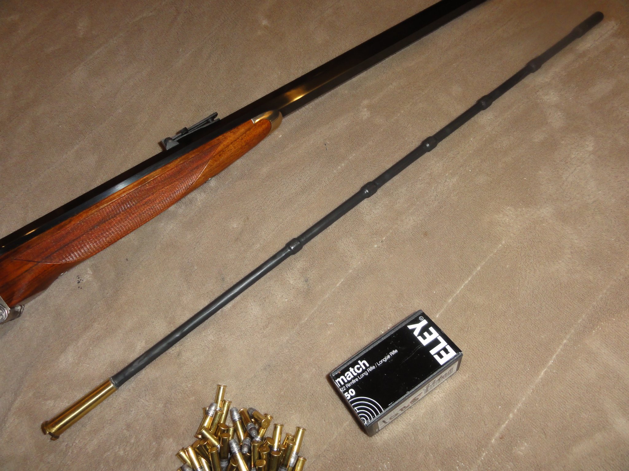

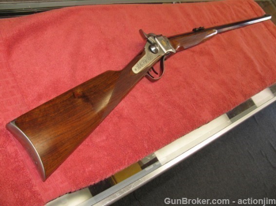

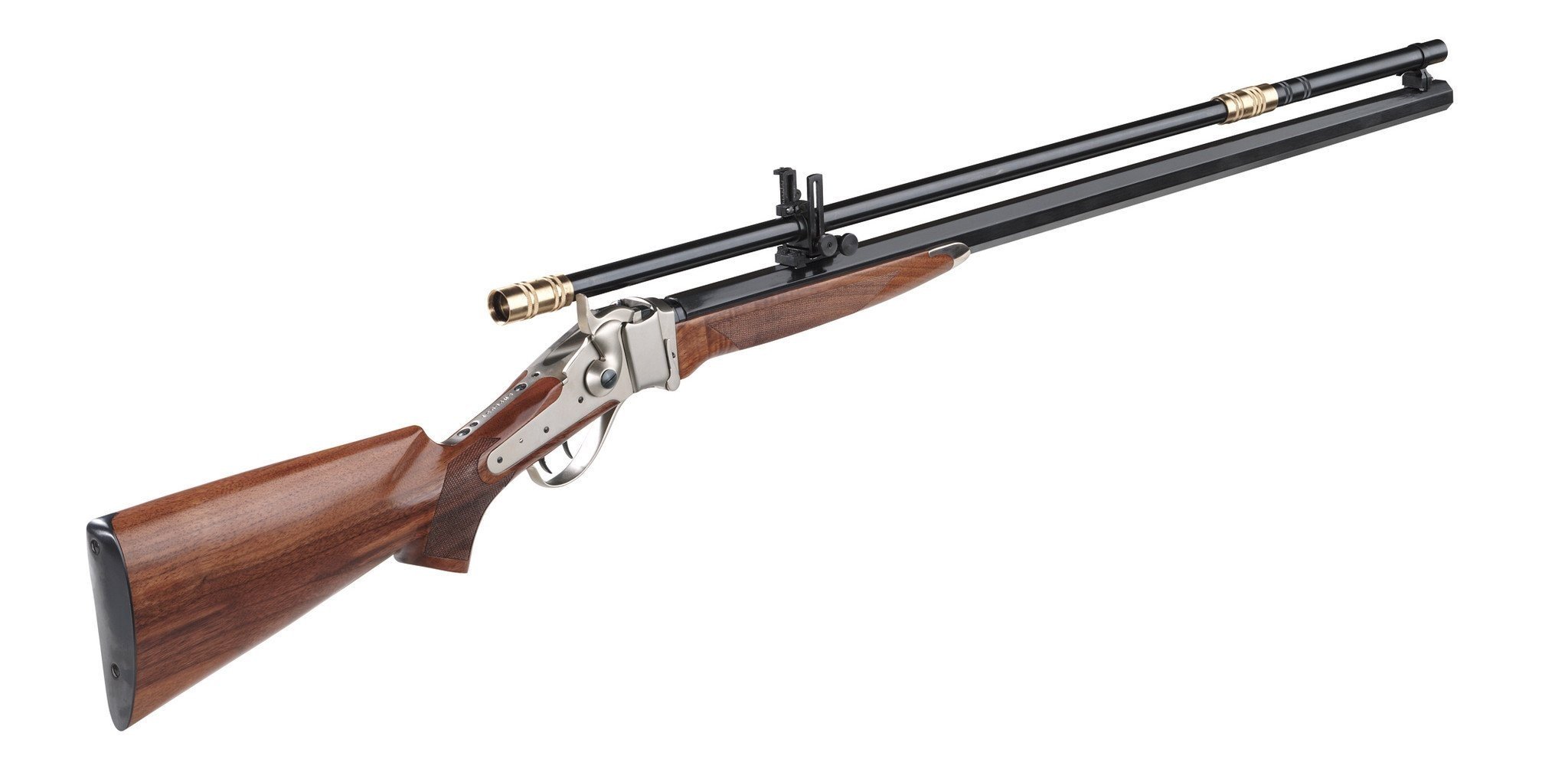

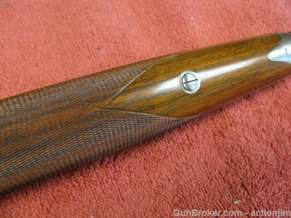

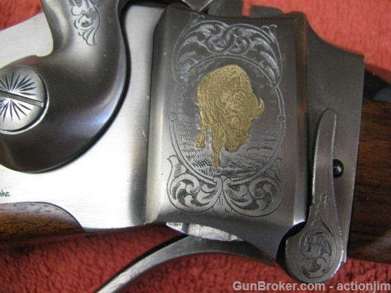

AirGunshawn - I saw a miniature Sharps single shot rifle in .22RF at SHOT several years ago - might even have been the 1st SHOT I attended in 2005. Is that what your little Sharps in the photos is? Beautiful rifle!
Hello Flatland,

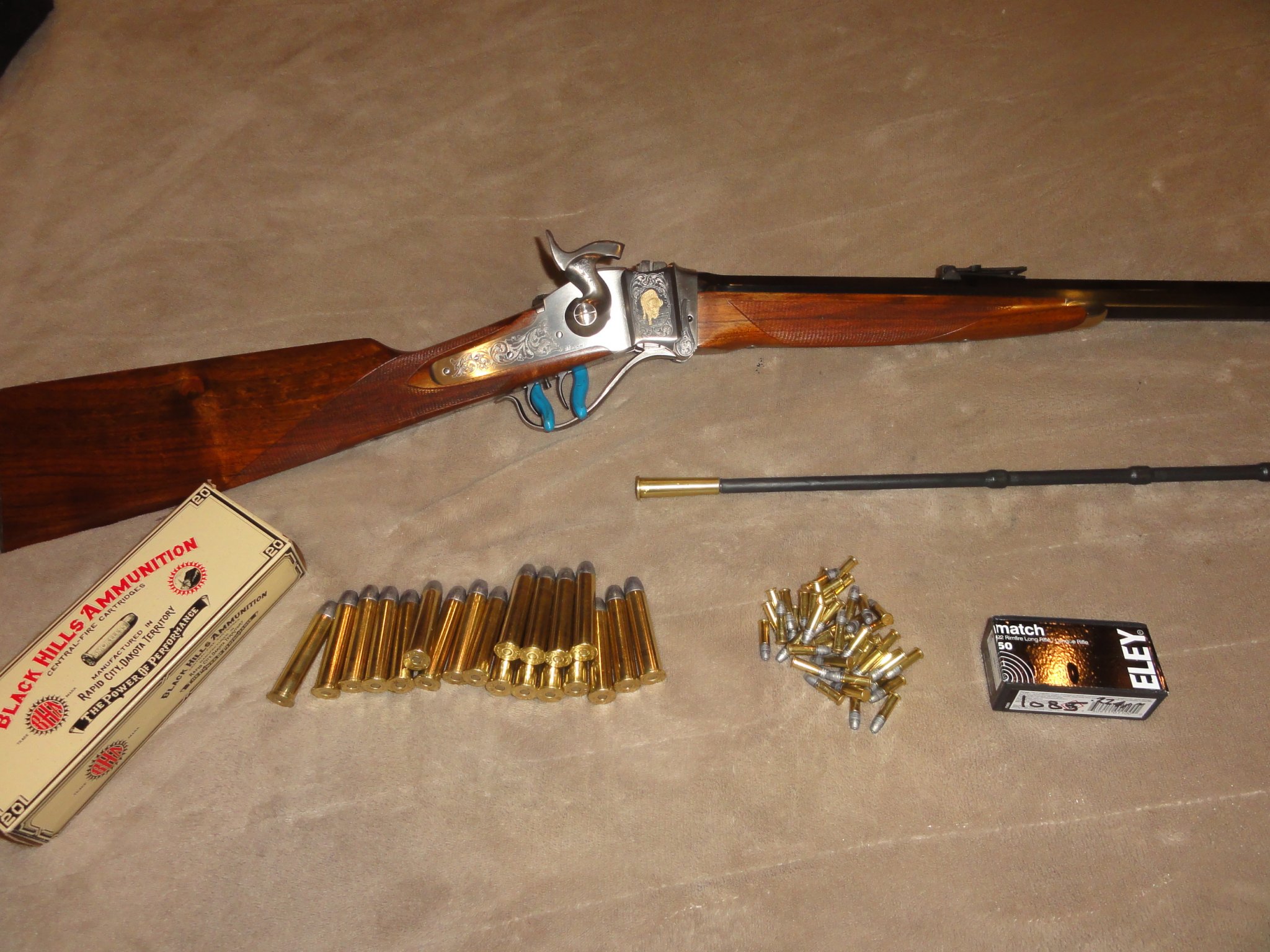

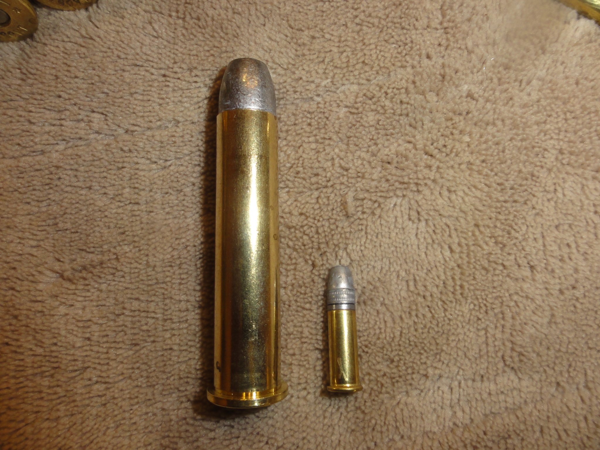

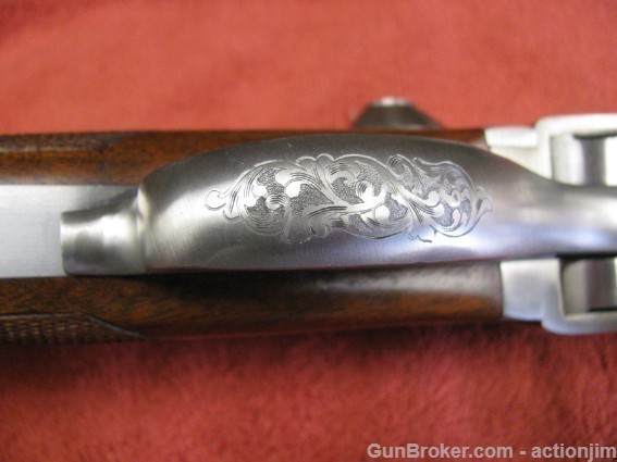

I have also seen a .22 caliber Sharps on the net. It looked like a hoot to shoot. Mine is actually a full bore 45-70 and I have a Buffalo Arms, Dave Crossno insert to convert it to .22 lr. I just ordered a Hi-Lux Malcolm 6x for it the other day. I hope to have it before Saturday so I can shoot with Brittany. It should look about like the last photo which is a stock photo. thank-you.... it is a very nice gun and thus far, it still is very near to LNIB. Flawless. At 1.50$ minimum to fire the 45-70, it just made sense for me to buy the insert. It allows me to get all of the shooting enjoyment I want. And the 45-70 kicks a bit even with an 11 pound gun. I was looking at a Quigley type with the color case hardening.. I'm glad I got this one.

So you know Dave Crossno - what a coincidence! He did a lot of work on a Win High Wall for a friend of mine that I used to shoot BPCRS with. He turned an old original high wall into a beautiful 40-65 for my friend, who then sold it to me after he'd gotten into a Stevens 44-1/2. I took one or two photos of that high wall with my first quality digital camera, but none of them came close to displaying the beauty of the wood on that rifle. Enjoy your 45-70 - I still recall watching those big-assed 500+gr 45 cal cast slugs disappearing out the top of field of view while I was spotting for my shooter while shooting at the rams at 500M - only to come back into view as they arced down towards whichever ram we were trying to hit. The arc of the 525gr 45 cal lead bullet was pretty high, and made it hard to give my shooter a call on whether he was high or low as the bullet came down at what looked like a pretty steep angle.
I sold the high wall after both the guys who'd gotten me into BPCRS quit the black powder game - often wish I'd have kept it, but used the proceeds to build a Palma rifle on a Nesika K, and had a lot more success & fun shooting that rifle over the years.
Flatland,
Actually, I don't know Dave, I have only spoken to his wife. Dave died two years ago. I called another company about their insert and they told me that I should buy Dave's as it is a better unit. How often do you hear that. Dave's website has a beautiful 44 1/2 shown.
The engraving was done buy a master engraver from Colt. I try and make certain my guns are dialed in so that everybody enjoys the shooting experience. I is way more fun when they do well. Having dynamic or exploding targets helps too. It is instant feedback. So many guns, so little time.

Those Blonde target stocks were an overun a few years back (2014-15) that Anschutz-NA were able to acquire for the US market. I recall they only had about 100 of those 1416 rifles available at the time. The stocks were never sold individually in the US to my knowledge.
Mine is awesome and super accurate other than a pronounced cold bore flyer issue, which negates it being a hunting rifle. :(
