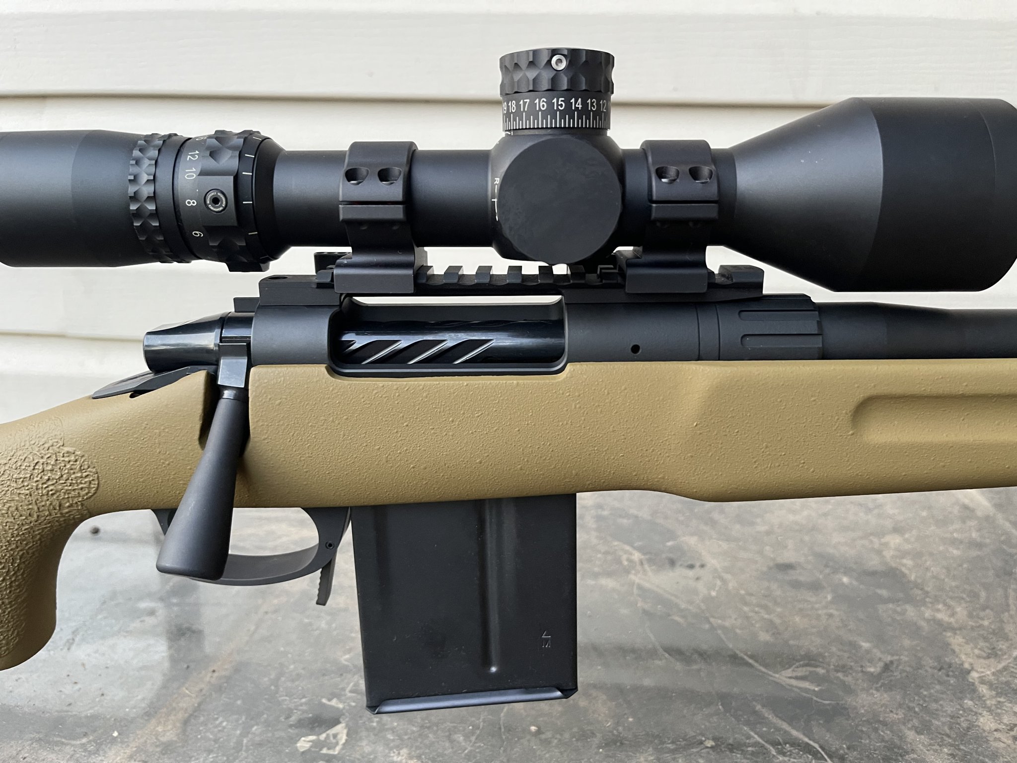

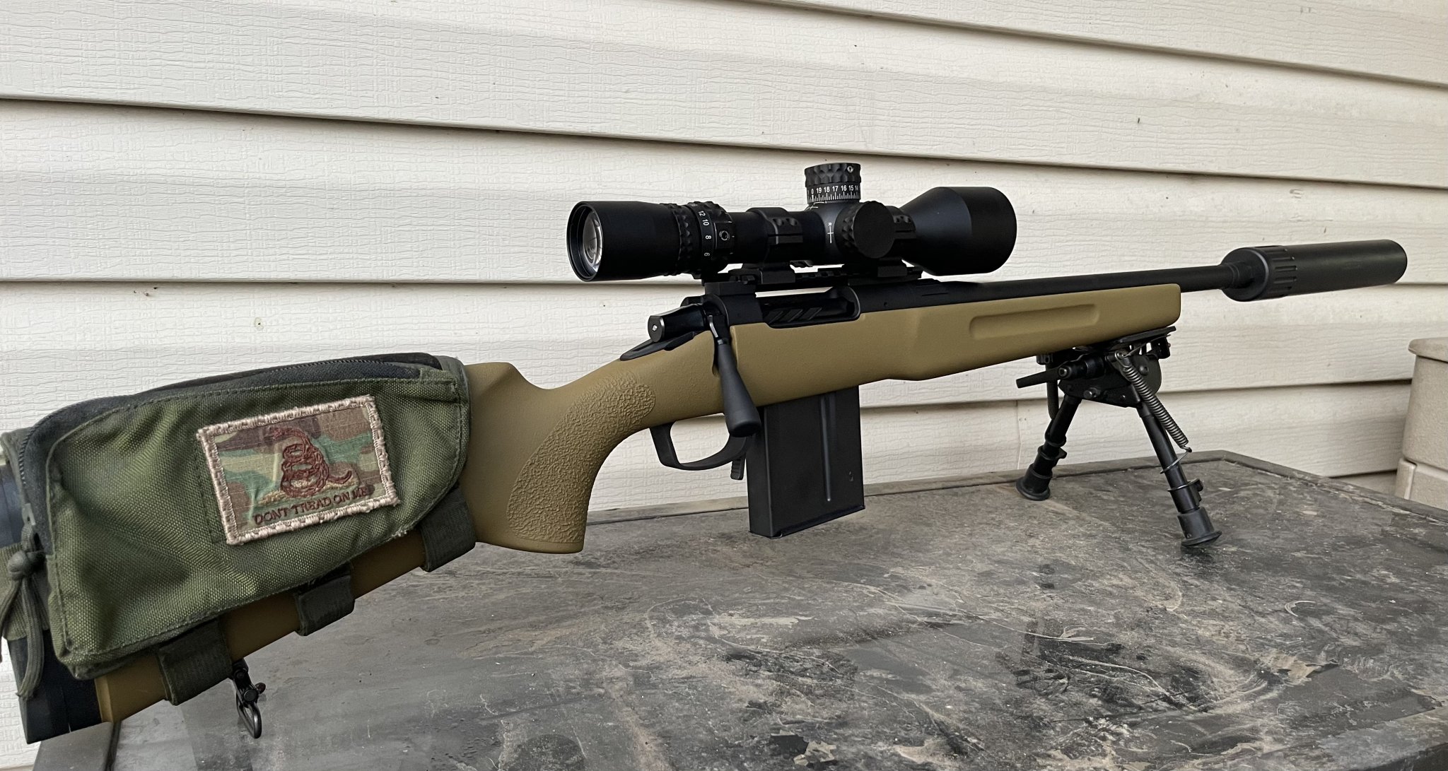

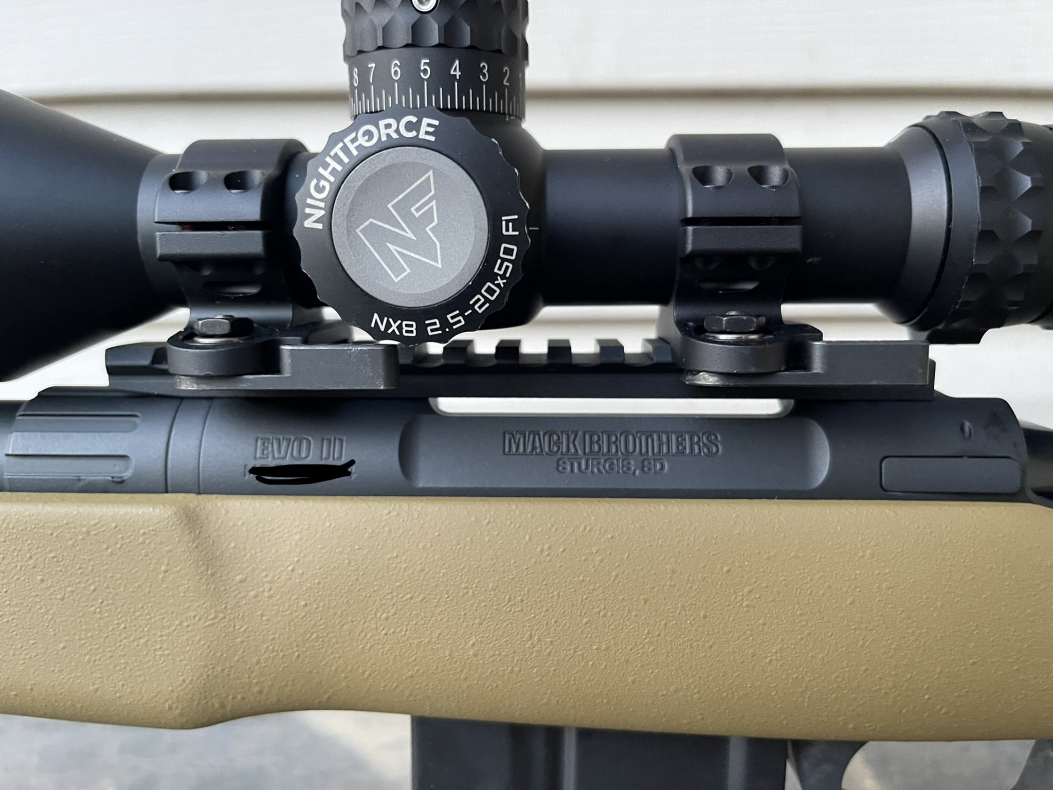

    Hey boys,
    Just finished ordering all my parts for an 8.6 Blackout bolt gun.
    • Faxon 16” 1 in 3 fast twist barrel
    • Mack Bros BDL Action
    • McMillan A1-3
    • Badger M5 DBM
    • Trigger Tech trigger
    • Badger EFR
    • Nightforce 2.5-20X50
    • Will use an AAC Titan 338 can with thread adapter.
    Plan is to hunt pigs with 300gn subs, and shoot LR steel.
    Should be a fun rifle. I’ll post pics and groups when I get it together. 🤙
    Anyone else here built one?

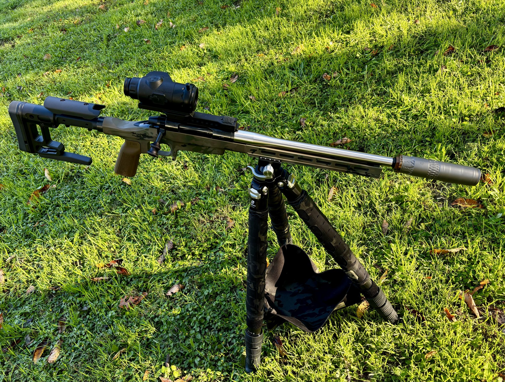

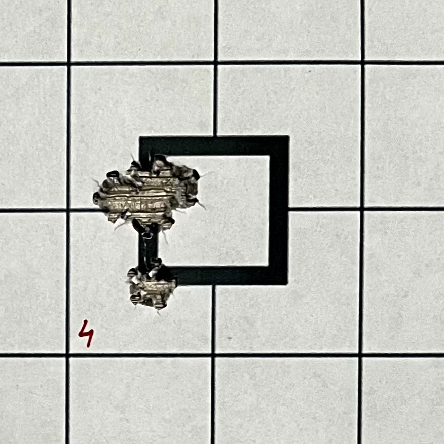

    I have a Sig Cross with a Mos-Tek 1:6.5 twist. I mainly shoot the 350gr Maker Rex and 300gr SMK.

    Not trying to poopoo anyone's build. Just asking for perspective. I kinda went down the rabbit hole of 8.6 for a bolt gun but then I realized. If I wanna throw a big piece of metal down range, why not just build a bolt action 458 socom. I need to buy a bigger can if I get a 8.6 so might as well get a 50 cal size can
    That works too!…buuuut, I don't know of any longish for subsonics range capable bullets that are in .45 cal that will expand, at least to my knowledge. The BC’s in the .338 help with slinging the subs passed 150y to 200y relatively easy in comparison.
    I bailed on 1:3 twist once I saw the reports of supers coming apart and destroying cans. Just be aware of what you’re slinging. Solids should be ok in supers. Probably bonded but damn it’s risky.
    I don’t want to just throw a big piece of metal down range; I want to accurately shoot a high bc projectile at subsonic velocity and remain 1-2 moa or better past 500-600yds.
    Of course I have better options to shoot distance with, this is just a fun project.
    I have zero interest in shooting supers. The 1:3 stabilizing characteristics for high bc subs is the only reason I would consider this caliber. Super quiet, super accurate. Anything more than that, almost any other .338 loading is superior.

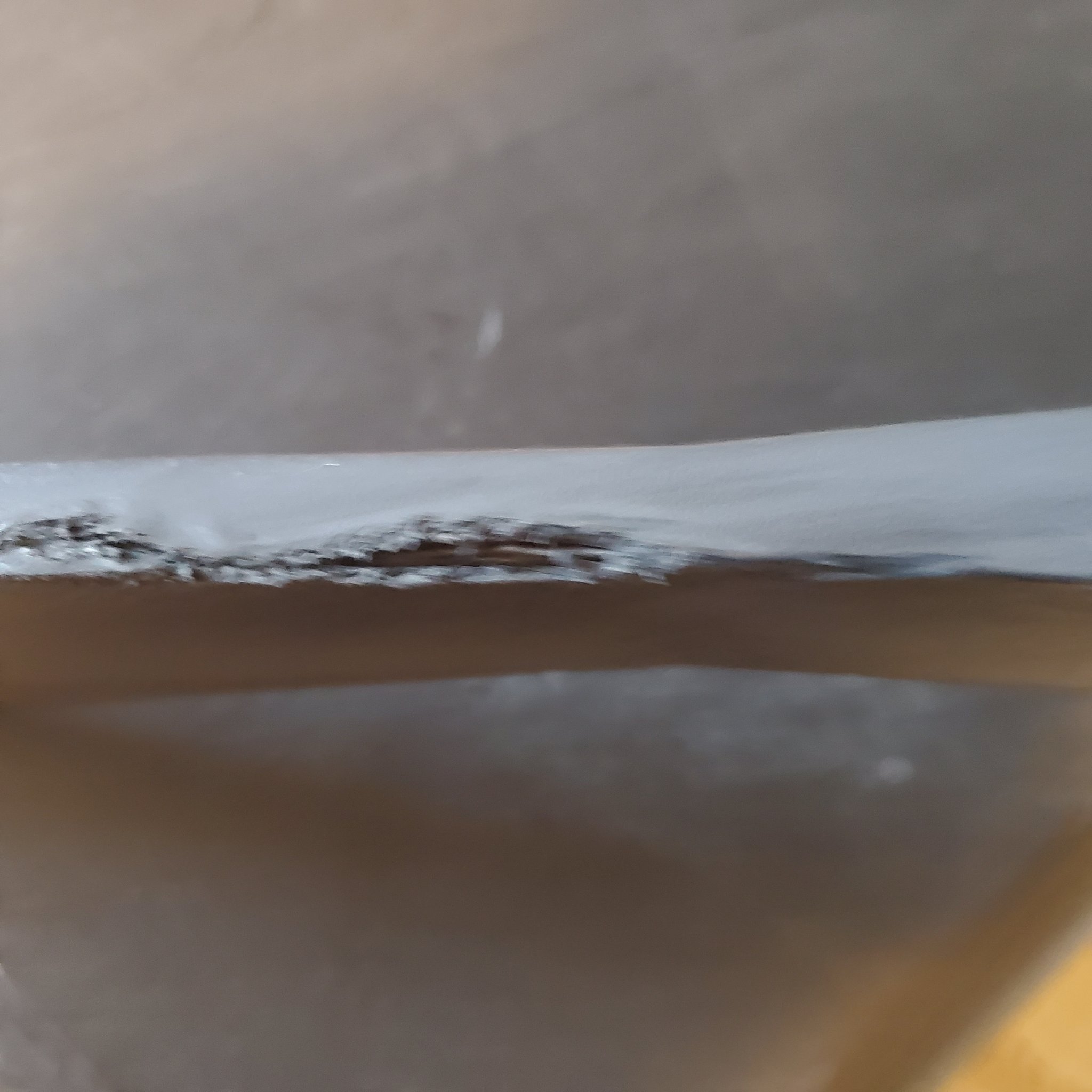

    I’m with you there buddy! Here’s 350gr Makers opening up mid flight. Dont go passed 1060 fps with those.

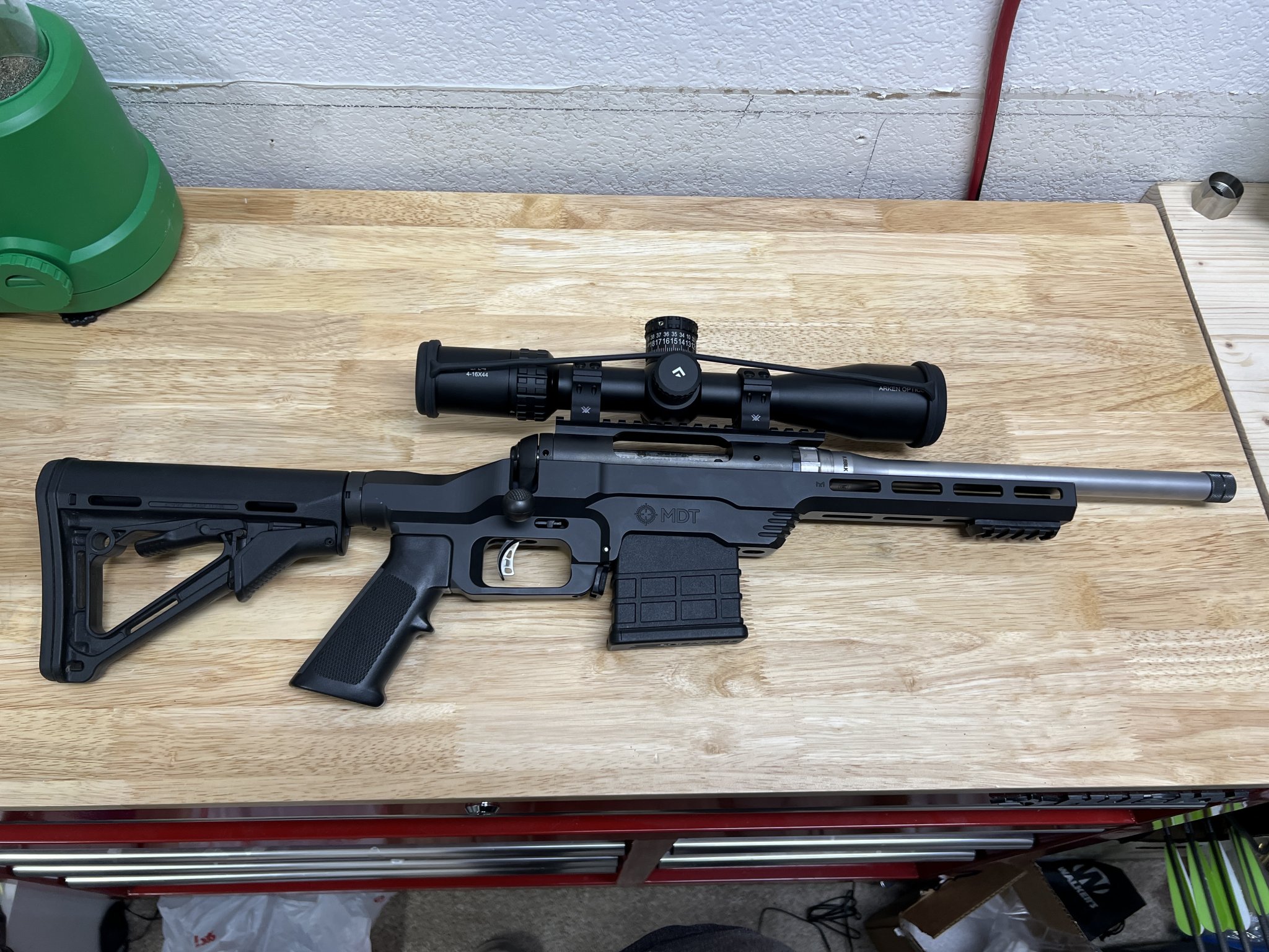

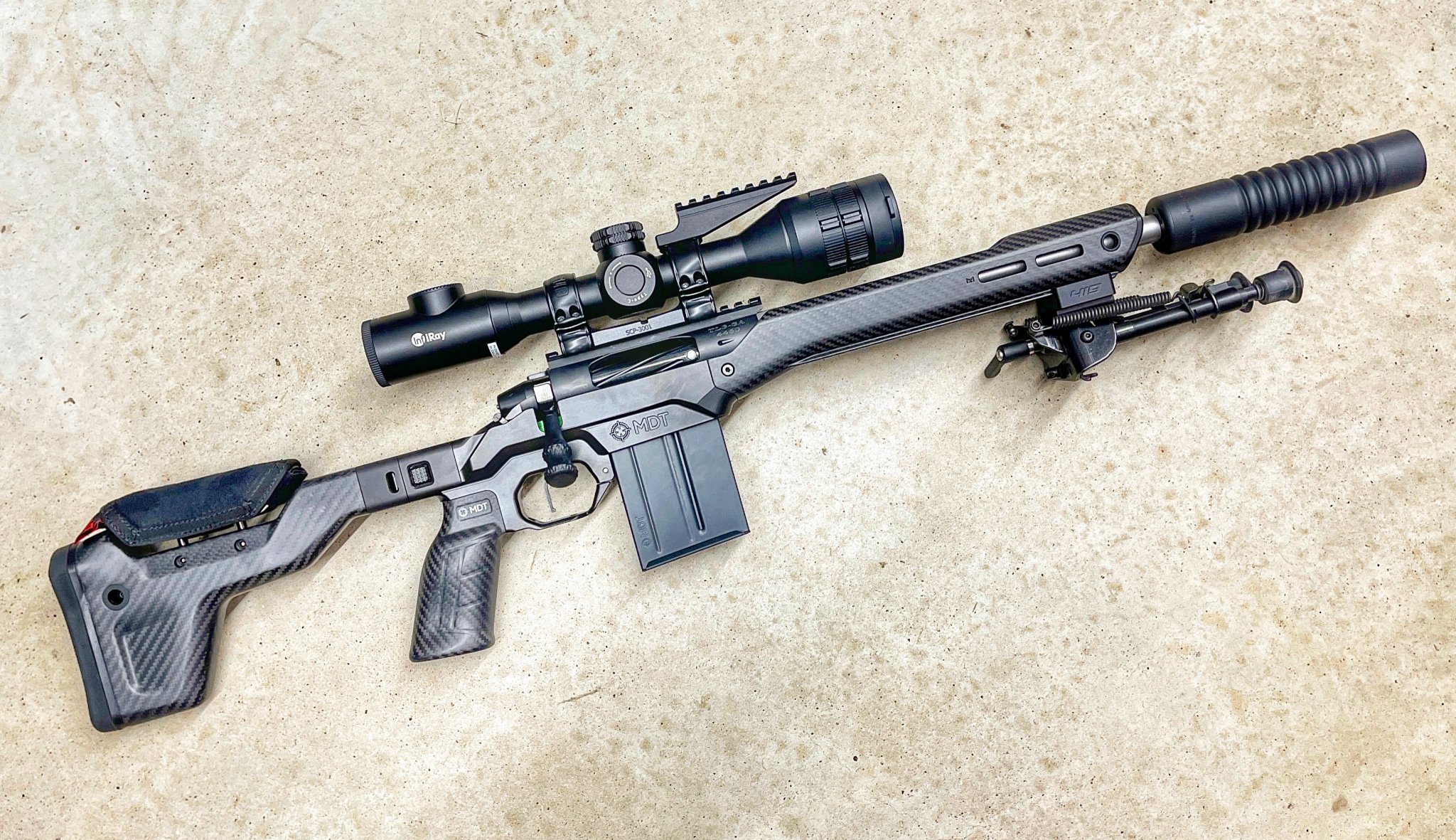

    Finished up my bolt build a month or so ago. It's a bit of a Franken Gun. Started with a doner Savage 10 Youth 7-08. Put a Mos-Tek 12.5" 1.3 twist on it. Had an MDT Chasis I bought years ago on a Black Friday discount. I decided to put my new Arken EPL4 4-16 on it for glass. I love this gun. It is more accurate than I expected for 12.5" easy sub MOA with Gorilla ammo. I will start upgrading it soon. Need a better trigger and grip. I ordered a Tromix compensator while I research
    which suppressor I will go with. (Ruged Alsken 360 or Q pork Chop are at the top right now)
    Finished up my bolt build a month or so ago. It's a bit of a Franken Gun. Started with a doner Savage 10 Youth 7-08. Put a Mos-Tek 12.5" 1.3 twist on it. Had an MDT Chasis I bought years ago on a Black Friday discount. I decided to put my new Arken EPL4 4-16 on it for glass. I love this gun. It is more accurate than I expected for 12.5" easy sub MOA with Gorilla ammo. I will start upgrading it soon. Need a better trigger and grip. I ordered a Tromix compensator while I researchView attachment 8119466 which suppressor I will go with. (Ruged Alsken 360 or Q pork Chop are at the top right now)
    I have the Rugged Alaskan TI in purgatory at the moment. Seems to be a great option based on the specs alone.
    I originally started with the standard Rugged Alaskan and Q Pork Chop as my top contenders. Then the Rugged TI was announced at shot show. It weighs nothing and should be an excellent fit for this round. I keep waiting for them to hit the street so I can watch some reviews. Q still has not released the 5/8x28 XL Cherrie Bomb. They only offer the M18 version.

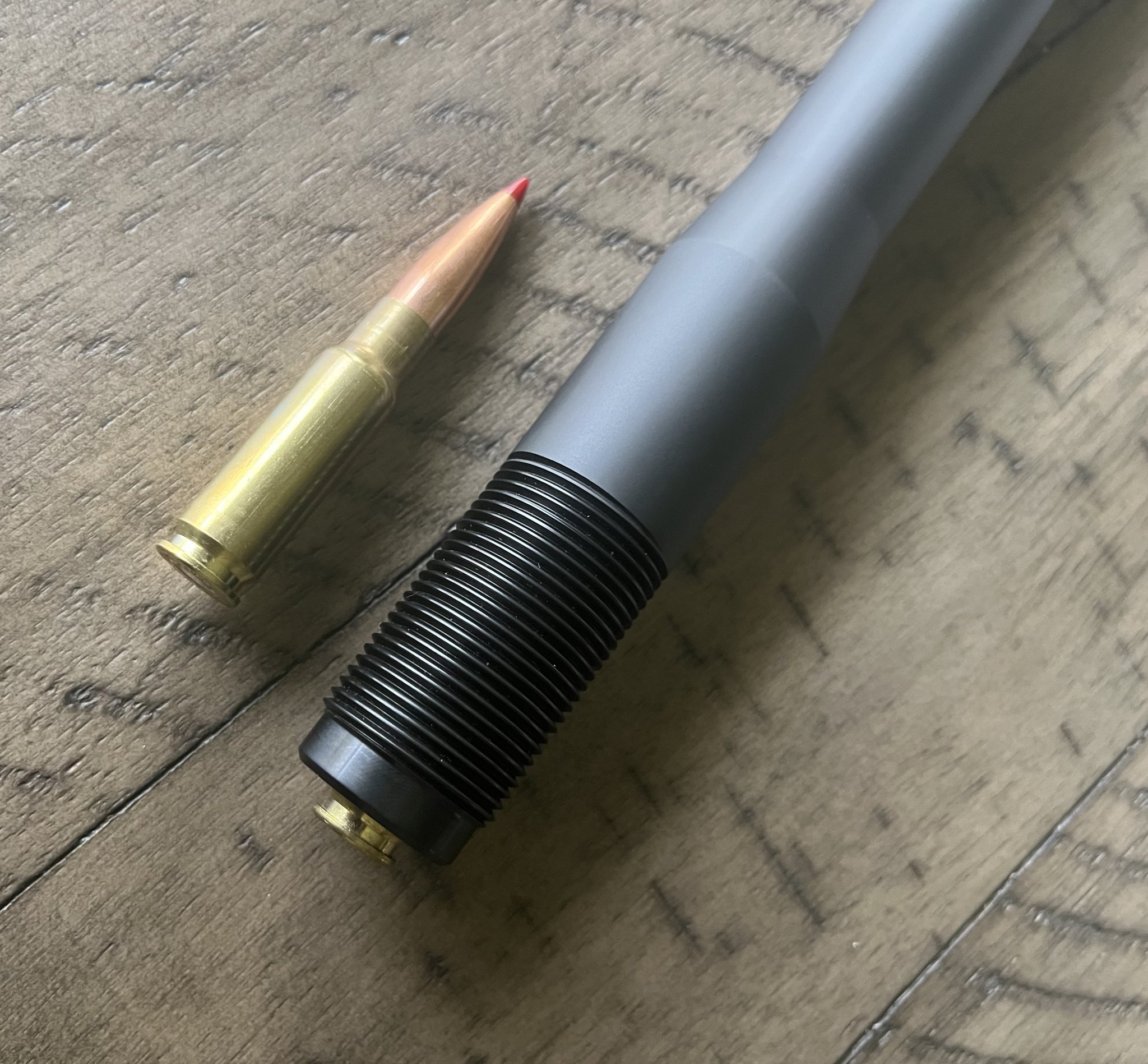

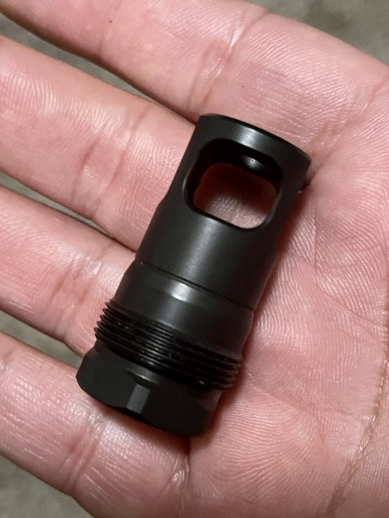

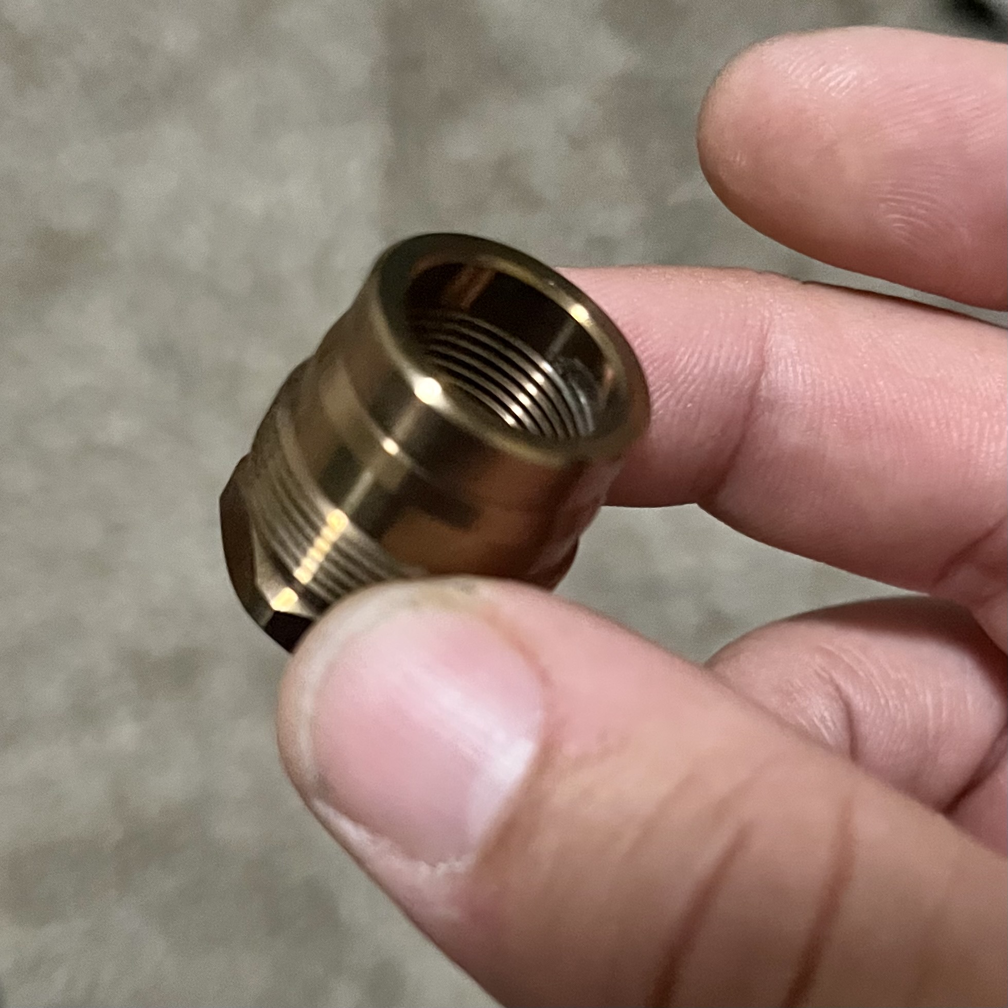

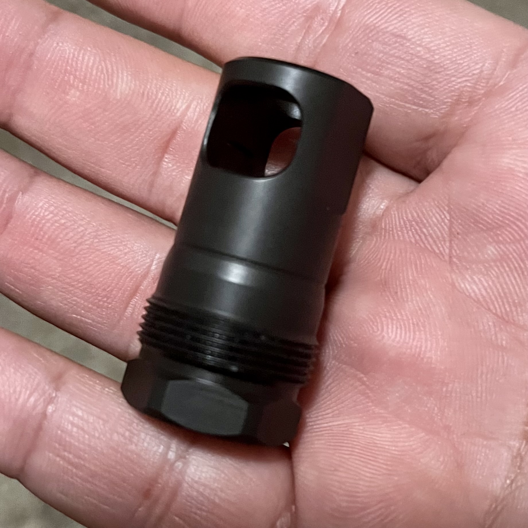

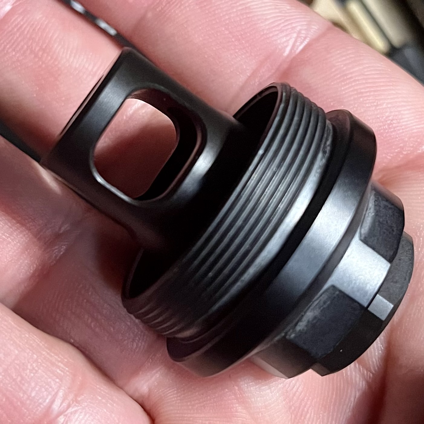

    I have 5/8x24 cherry bombs. I have our machine shop open them up but there are better options that work with the plan B like the Reardons https://hansohnbrothers.com/shop/rearden/accessories/muzzle-brakes/rearden-spb-brake/

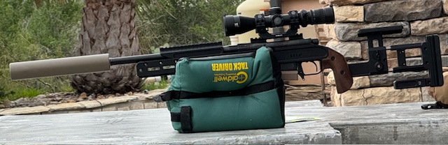

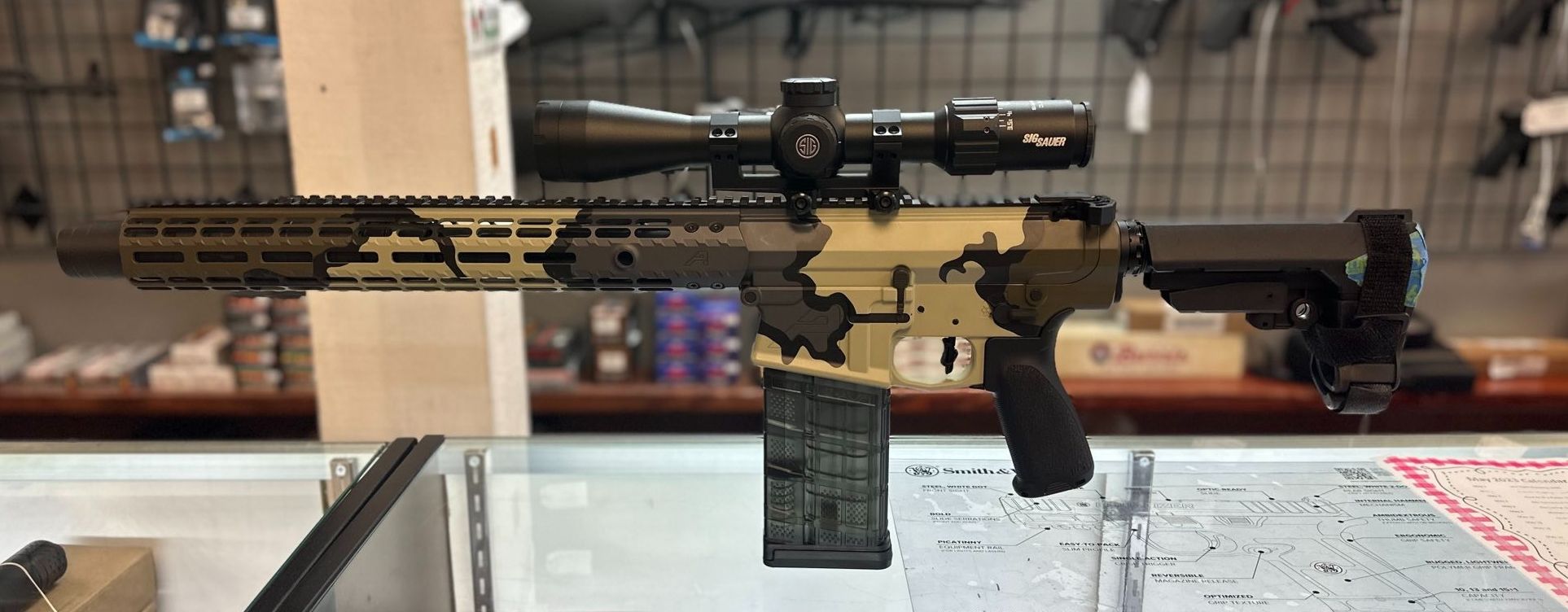

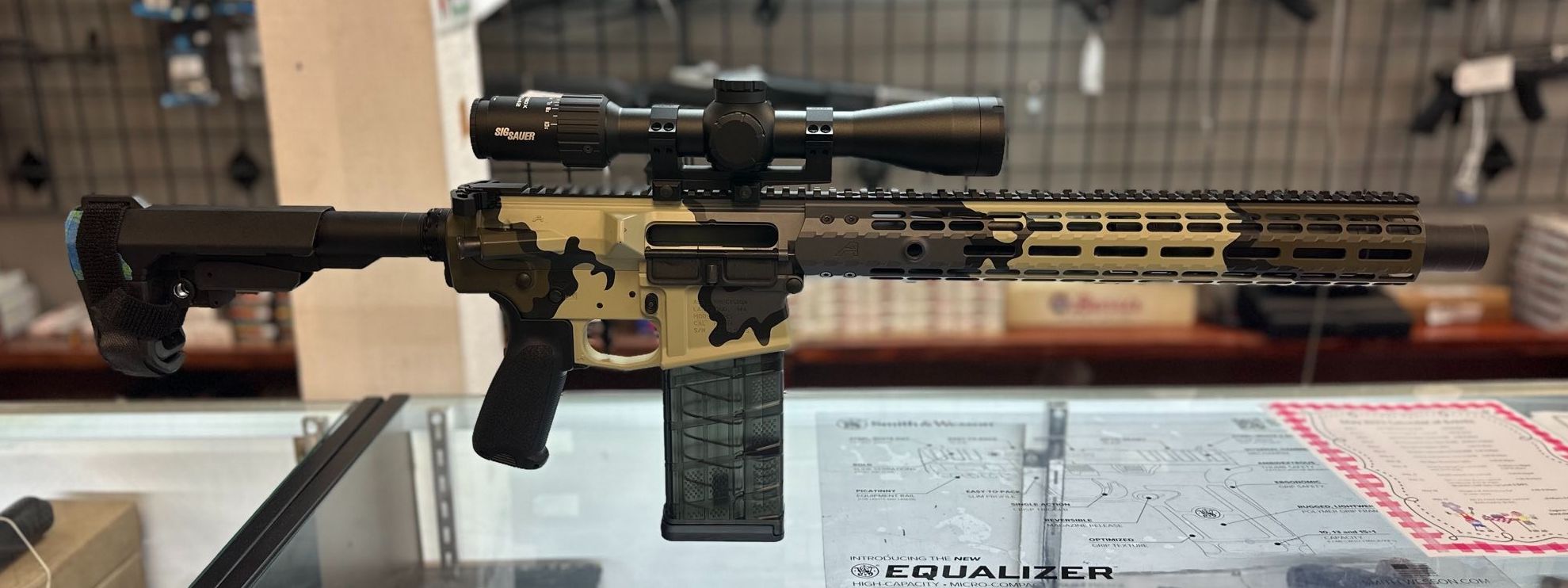

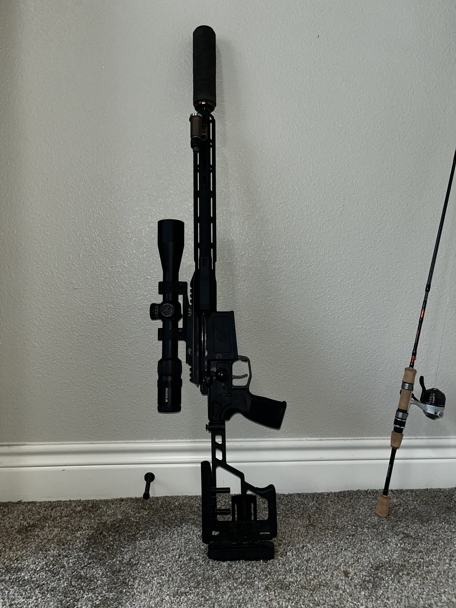

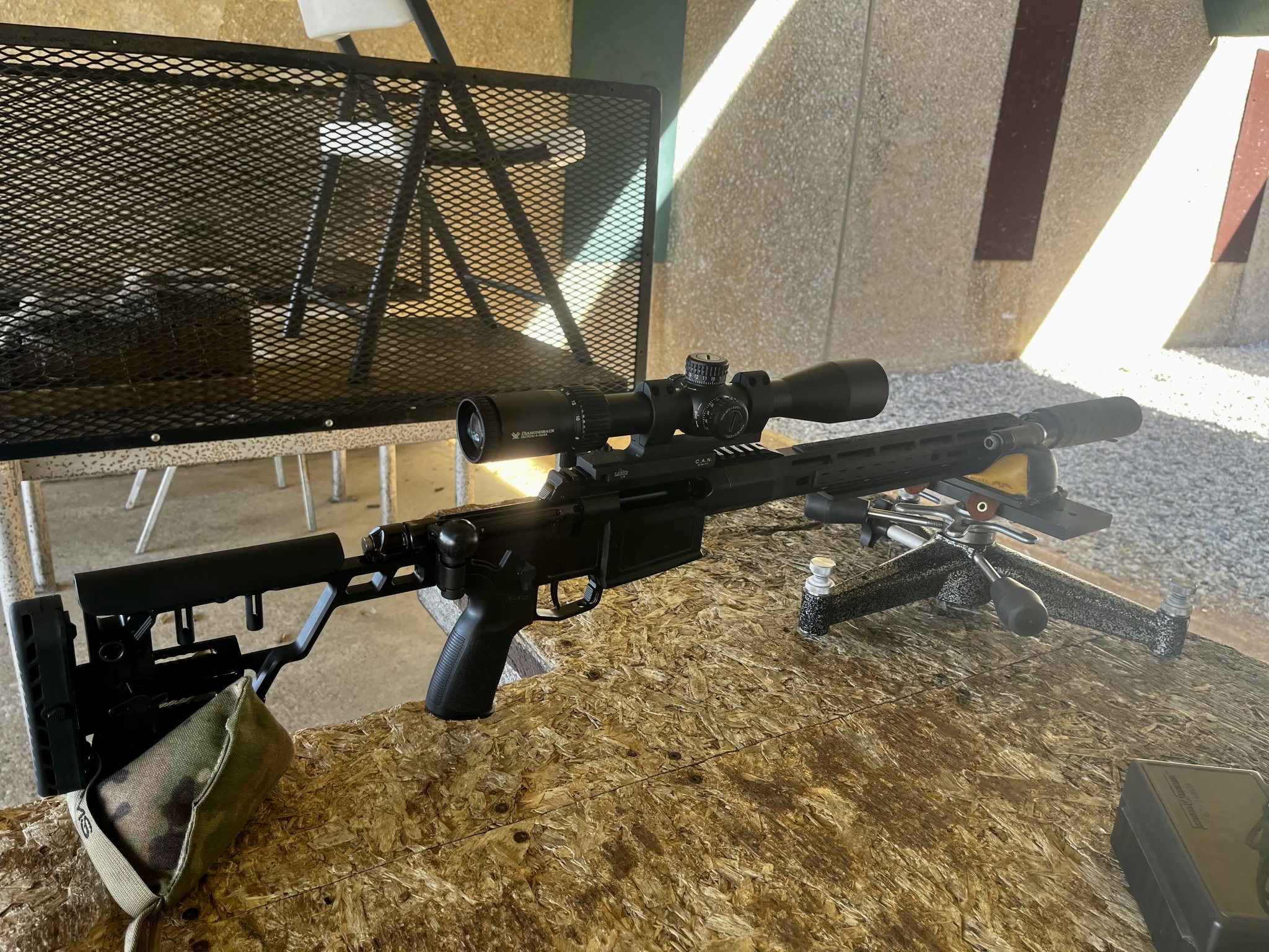

    I’ve had mine together for a while now. Pork Sword, Faxon 12”, Timney Elite, Hybrid with Rex adapter. I’m waiting on the stamp for a Porq Sword. I’m hoping to work out a good dope chart to have realistic drops for both subs and supers. The 350 Makers are excellent out of it.
    Reactions: Mattcard1

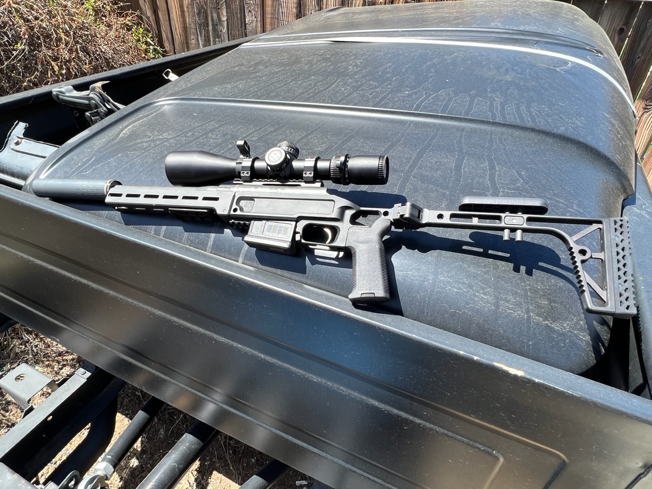

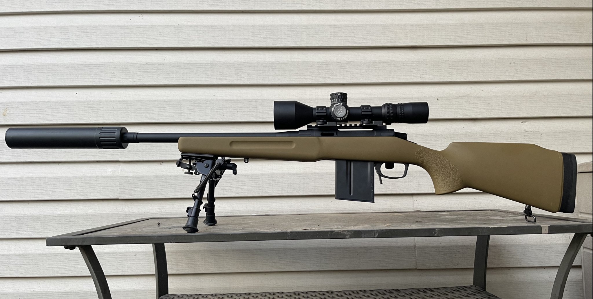

    Just built, first time on the range, awesome caliber, suppressed 22 bolt gun quiet - big ass chunk of copper.
    Dope chart for 285 subs is good to 300, now I just need a piggy piggy to wander out and test pass-through.
    I'm just starting out with it, but love it so far.
    Reactions: DacianMH
    Love the chassis and March scope. Great build!

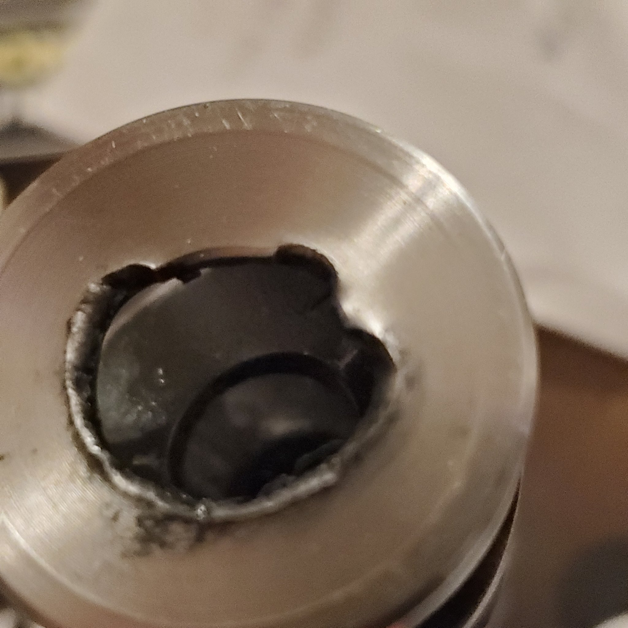

    Get a different barrel...the Faxon 3 twist is junk, torn rifling, pits, and galling. The 3 twist IS the problem. Gave up on it after more than a year of messing with it, and ordered a 6.5 twist 338 barrel blank more than enough twist for anything you'd shoot in 8.6 Blackout. Also have a reamer on hand I expect the new slower twist barrel to be a big improvement in accuracy and more versatile with respect to different bullets and velocities.

    It’s not that it’s “all terrible”. But when it’s terrible it’s really terrible if a can is on it

    Yep, pretty much all horror stories with Faxon, and only compromising success...

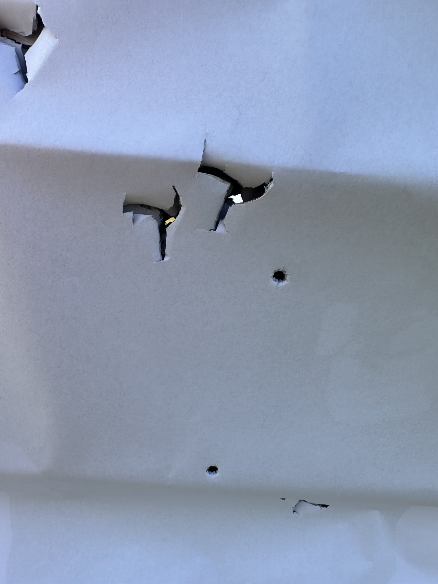

    Kinda fun put the muzzle within 2 feet of a cardboard box shoot for center and also hit the outside of the box with bullet shrapnel as the bullets come apart... anything infront of the muzzle is peppered...somewhere dangerous.
    Be sure to take off the muzzle devices.

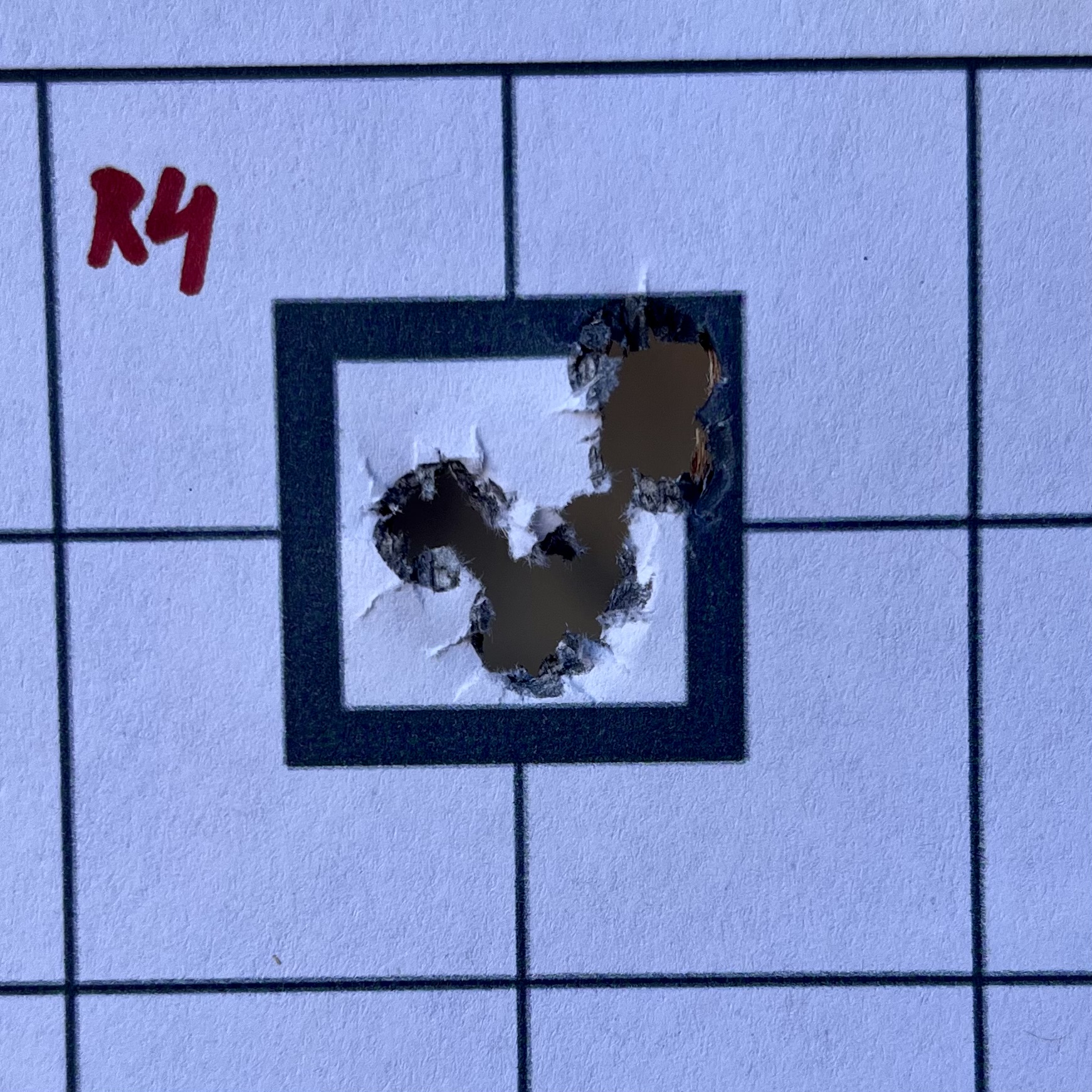

    The first lead bullet fired, from Faxon load data, a recommended lead bullet load for the 225 gr Hornady bullet .... blew up after leaving the confines of the barrel destroying the muzzle brake and the magnetospeed bayonet. About $275- $300 in damages. The absolute worst cartridge I ever messed with in the Faxon 3 twist....That is all hype, and worse than unnecessary So I did purchase a 6.5 twist 338 barrel for better accuracy and lower S/D with subs, easier on all bullet jackets ...and super capable with lead...like a 300 Blackout...So yes the 3 twist has absolutely nothing positive to add to the 8.6 blackout cartridge..and I've shot it alot, and can not recommend it. I have the 8.6 blackout reamer, waiting on the barrel maker, I will chamber my own. Also have a 10 twist 510 barrel for the 300 whisper, ordered, but waiting on the chamber reamer and barrel.

    You make my point beautifully. I fired 20 rounds of Gorrilla Ammo 280 solids (I think) from my 16" faxon and got nice 5-shot groups. I ran through a Thunderbeast arms 338BA, zero damage to brake or can. All rounds impacted as expected, all made nice round holes with no petaling or opening up unexpectedly.

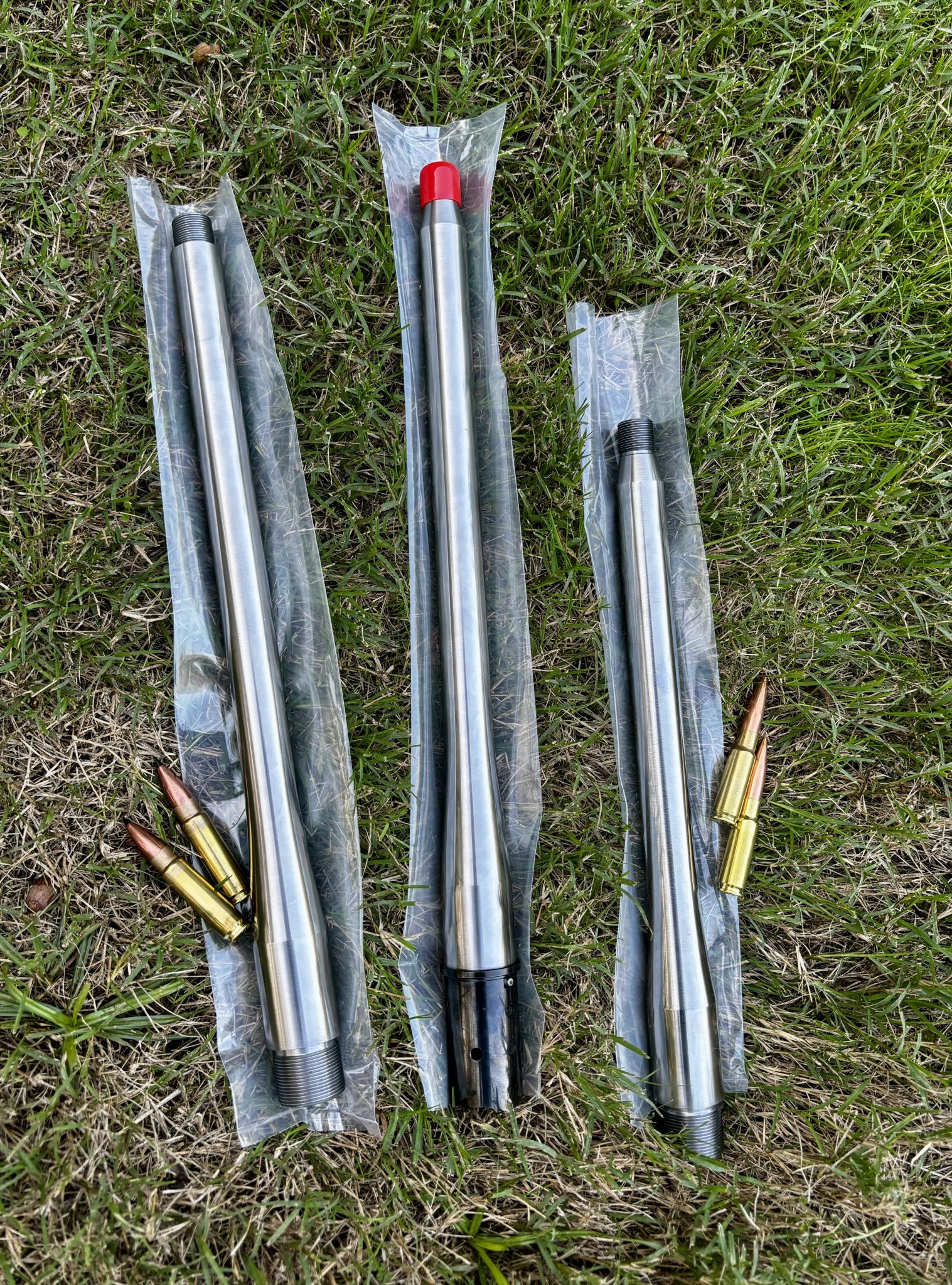

    I have a finish reamer for 8.6 and am waiting on the barrel maker for the 6.5 twist. Faxon wil not change the twist rate as I checked right after I purchased the 3 twist and the negative experience. They are under licensing agreement to make only 3 twist. So I buy barrel blanks in the desired twist 6.5 to 8 twist would work. Just like the 300 Blackout. I reworked a Remington 700 action for this build for free, as I already had it. But can make an AR 10 barrel also..just a little more machining involved with barrel extension, gas block journal, gas port, and profiling. I would definitely go for the 6.5 twist.
    I May use my 3 twist AR 10 for fire forming cases...other than that I'd remove the barrel extension and give it away, or use it for scrap metal projects...the barrel extension is the only thing worthwhile on the Faxon 3 twist...Faxon earned their negatively on the 8.6 Blkout, some of their ,"other products" may be okay, and I have a few, but this 3 twist project should have never left the shop for consumers to use...IMO. Following their on site load data one load was way over pressure and blew a primer on the first shot plus destroyed equipment. I contacted them about one set of load data abd the dangerous 3 twist ..it took 2.5 months to reply, in the meantime others were posting blown primers for months before removing the way over pressure load data...too slow to respond to a very negative situation.
    Reactions: DacianMH
    They are better in every way. I have a 6.5 twist from Mos-Tek and everything shot in the 1:3 shoots better in the 1:6.5 and can maintain a 3” group at 300y.

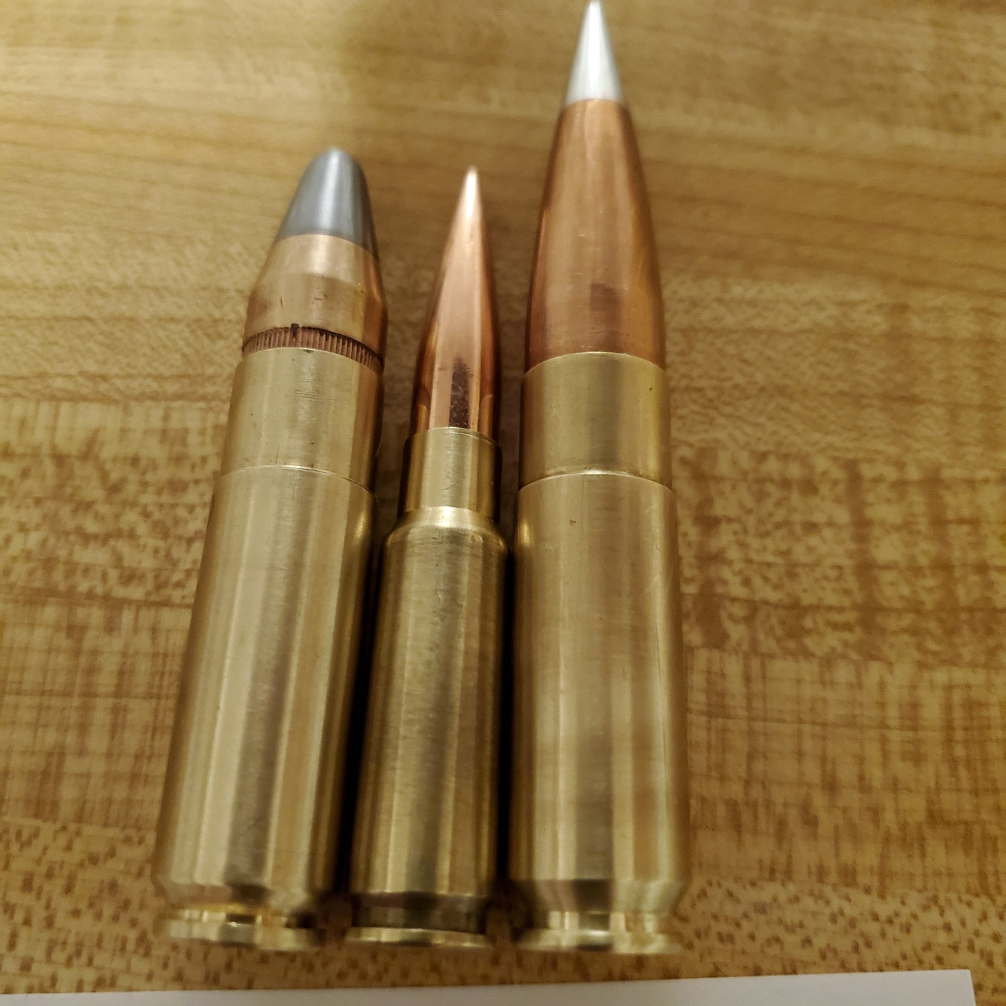

    Easy is use 338 Lapua./ 416 Rigby or turn the belt off the 460 Weatherby, but they are expensive, shorten, form, turn necks..for bolt gun. Some versions use the 460 Weatherby brass, as is. My reamer is for 338 Lapua.
    AR 10 , additional steps..the case heads need turned down to .525" to .528 " and new extractor groove installed... to fit the KAK AR 10 magnum bolt head, they use in the AR 10 300 WSM, the AR 10 will not be as versatile as the bolt gun, but ridiculously powerful with supers in 300 to 500 gr range...for an AR. It will also shoot military ball, tracers, and armor piercing rds.for more plinking fun. Notice the cases in the photo are rebated 338 Lapua as these heads are turned for the AR 10.
    Oh ok so something like the one in the middle pictured with the case head turned down to .473 to fit a 308 bolt face, to the left is a 375 Raptor and 8.6 Blackout on the right of it. Made from 338 LM Brass necked up to a 375 cal. I love seeing projects like this, I hope it comes out excellent for you!
    Yes these projects are cropping up all over for the AR 10. Using shortened 338 Lapua cases for more case capacity, to maximize the AR 10 as it exists. And doing reciever mods for 2.940" to 2.960" cartridges. Case capacity is inching up toward 100 grs. Mine are edging to 90 gr capacity now. I went whole hog to .510 caliber, just start at the top. I have a bunch of 50BMG brass but its already borderline ridiculous. Just buy a Barrett. For me, It's just a hobby, trying different things to see how they work. These energy levels are beating the 458 Win mag out of an AR-10...then there is the recoil, to consider. Even subsonic when the bullets get heavy. I'll find out when the barrels arrive.
    You have the 1:6.5 twist mostek?!?! I have a bad Faxon and i am just going to cut my loses and go mostek. I have the 1:3 twist on my ar but I have no issues with that. The Faxon on my bolt gun is wildly inaccurate. After reading posts on the 6.5 twist, is that the direction I should go?!

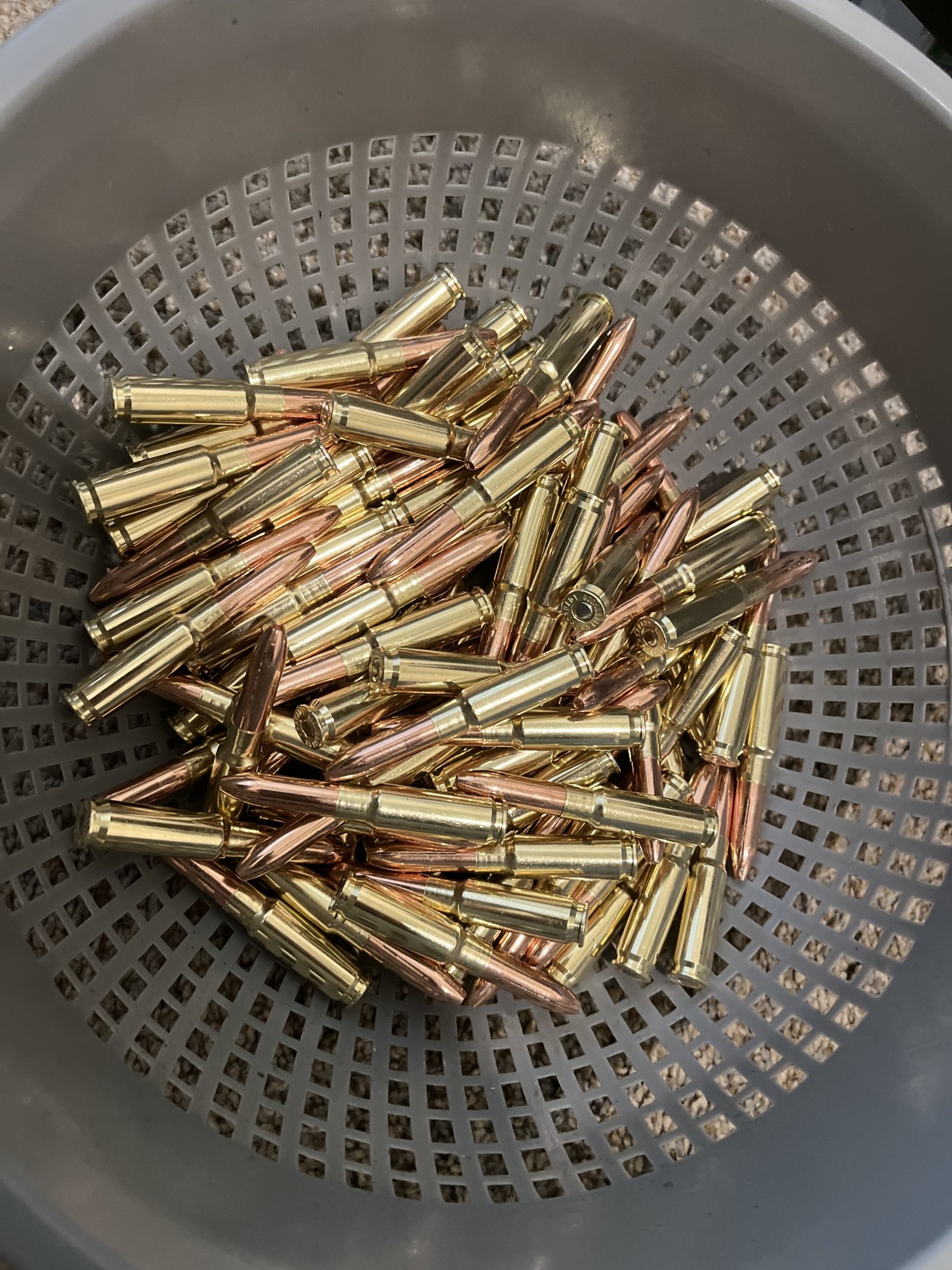

    Yes, I’ve tested alot of 8.6 barrels, I needed to because we’re manufacturing the ammunition. Out of all the barrels tested, the Mos-Teks and the Q’s have been the most consistent. Even the 1:3 Mos-Teks are a good to go, but the 1:6.5 lets you also use many other bullets that the 1:3 cant.
    We will be offering 1:6 only ammunition in the future…from what I’ve tested I can push a 165gr Maker Rex or 160gr Barnes TTSX 2500 fps safely from a 16”. I also lost no stability with the 350gr Makers either but they’re not ideal for the slower twist and don’t expand completely. Paul is going to release 1:6 compatible projectiles soon for the 8.6 but there are already 338 Spectre bullets that’ll work in the 8.6 now. You also don’t get as much copper fowling letting you go longer between cleanings. You won't regret going that route.
    Reactions: DRWilson

    By the way, with all the "fuzzy faxon bores" stuff, I took a close look at mine: not fuzzy, looks very crisp though I didn't put a bore scope on it.
    My guess is the earlies were more problematic than the later - though that could just be bias based on mine not shooting like ass.
    No, you are correct…they had some issues with their barrels and there are still some out there. If you have a good Faxon don't sell it because there seems to be a good number of inconsistent barrels out in the wild. I’m sure, as a large manufacturer, they would fix any issues they may have but sometimes thats too late for a company’s reputation.
